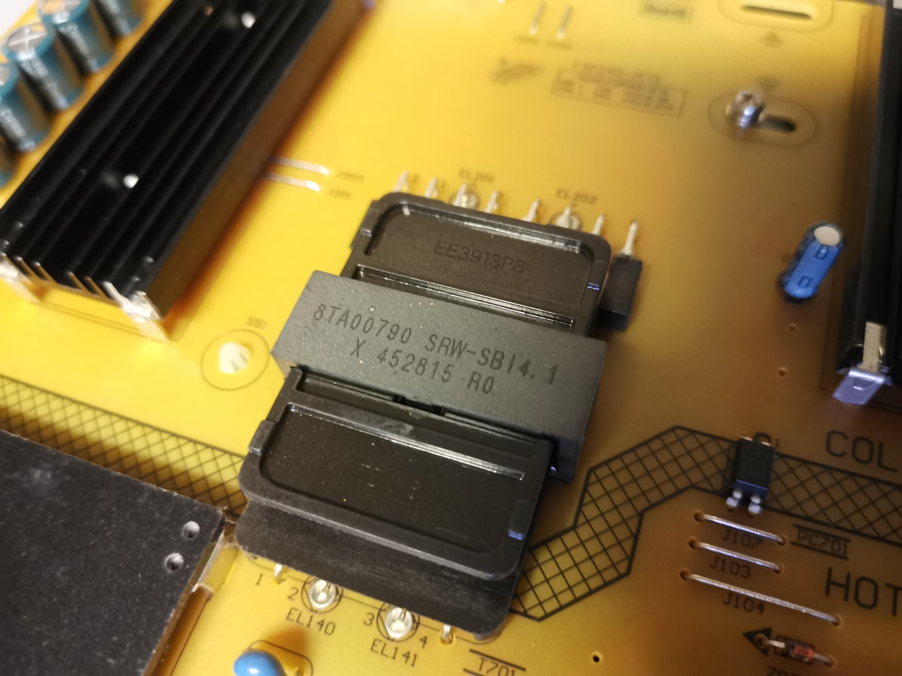

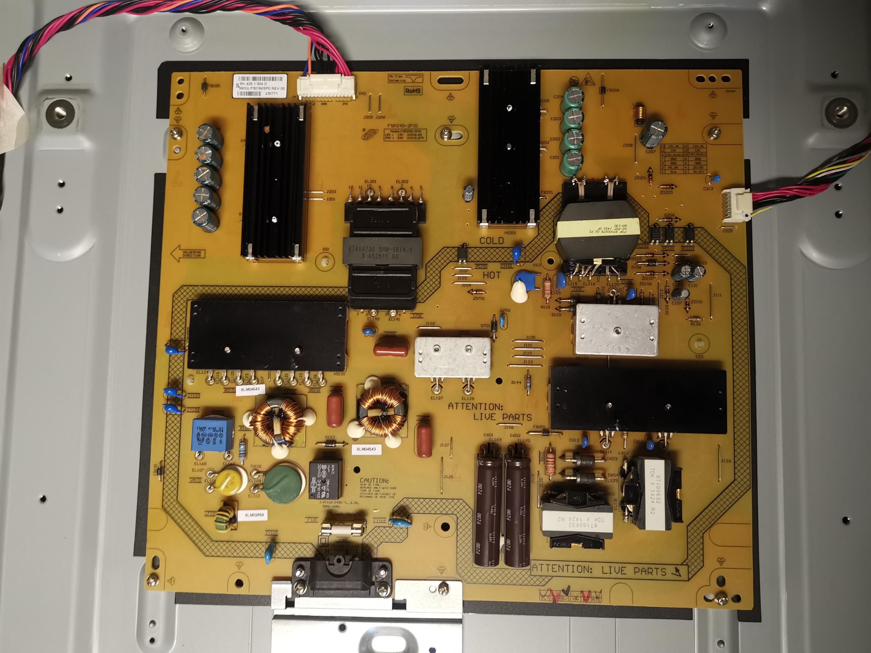

    Hi all!

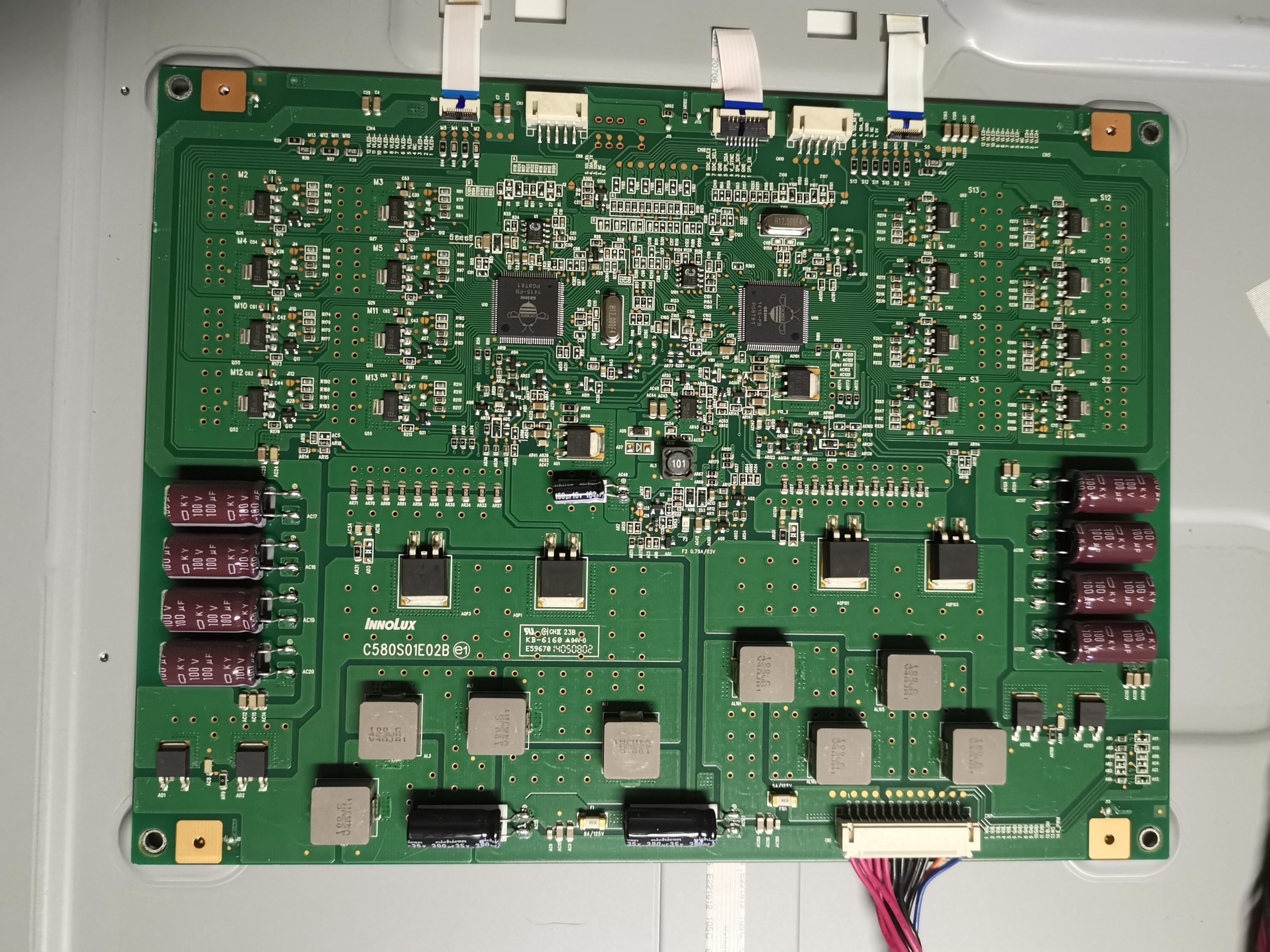

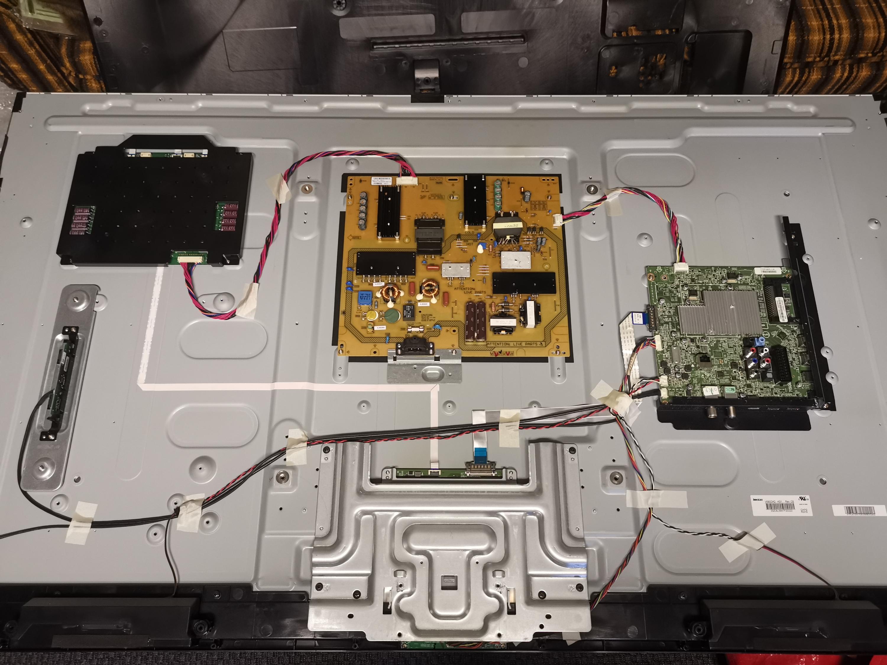

    A few days ago my TV suddenly turned off while watching Netflix from my media PC. Only connected cables were HDMI and TOSLINK. It immediately started doing this loop where the power led turns on for a second and then turns off. You can also hear a click inside the TV every time.
    I tried the easy stuff first like disconnecting everything including the power cord but that didn't fix the issue.
    Now I opened the TV to check if there are any bad capacitors but as far as I can tell, they look okay.
    I've attached a few pictures and a video (.zip-file) where you can hear the click and see the led. There's also a close up picture of what I think makes the clicking sound. I can't find this part sold separately anywhere and I'm not sure what that component is called..?
    So.. Is there a possibility that this clicking is caused by some other failing component and the component I think is clicking is still OK?
    I haven't measured any voltages yet and I'm not quite sure where to begin at this point. I'm writing this on my lunch break so it'll be a while until I get to work on it again. If I'm missing any crucial information, please let me know.
    Thank you in advance for your help.

      Thanks a lot for the service manual and tips!

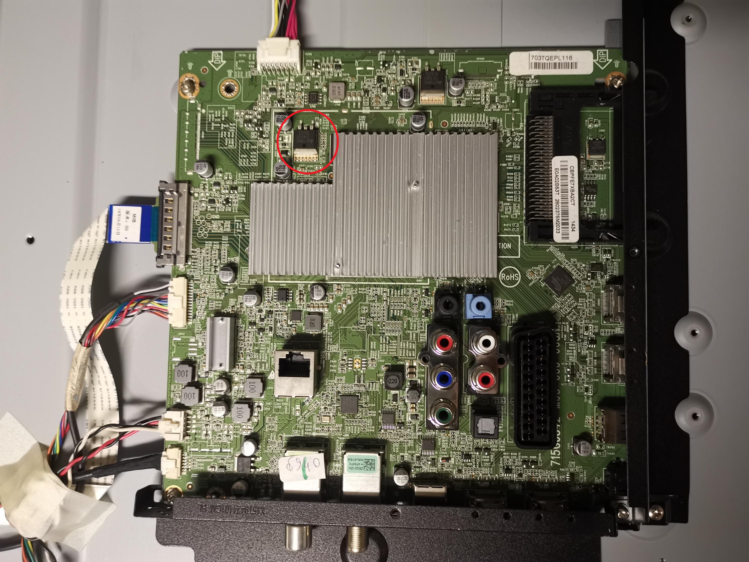

      I checked everything and when I unplug the SSB board (or what I called main logic board..) clicking stopped. TV was completely silent until I plugged in that board.
      I then went and removed all the cables from SSB board one by one (speaker wires etc, excluding the one between PSU and SSB) and after removing the flat cable (CN408?) the panel lit up and no more clicking. That cable goes to the IR/LED board I think.
      I gotta spent some time reading the service manual. Not quite sure what to do next but at least I got a lot closer.
      If nothing else, I have a wicked 58" led lamp..

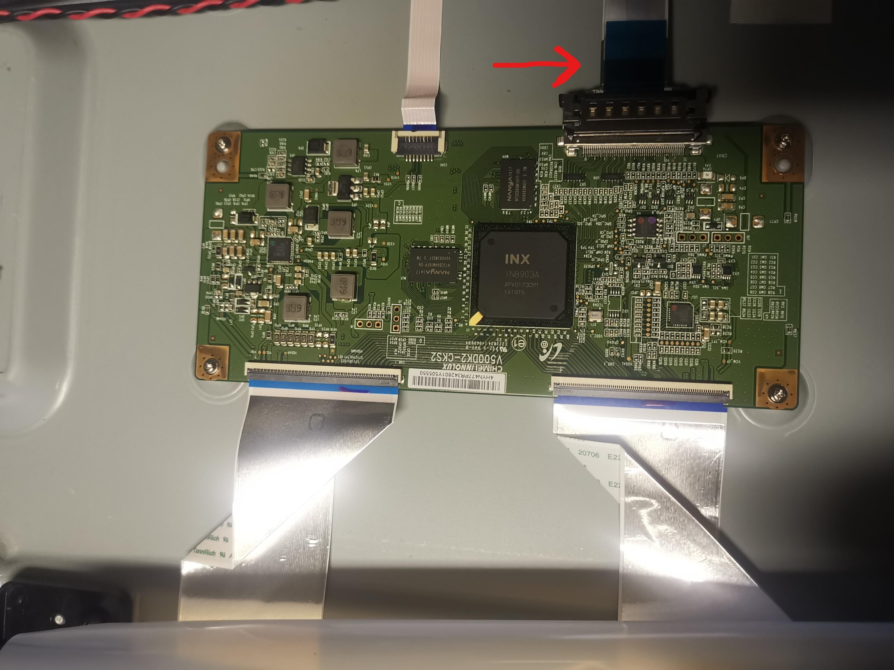

                Re: Philips 58PUS6809/12 doesn't turn on - LED turns on for a second and TV clicks
                Originally posted by William1967
                Check if the power regulator is soldered correct, it's a problem i've seen before.
                Thanks for the suggestion. I checked and it seems to be fine.
                Originally posted by Maalobs
                Is it a blinking pattern, though?
                If I understand his description correctly, the TV is stuck in a loop where the power turns on momentarily and the power LED lights up, then the TV immediately turns off again to the sound of a click, then the loop repeats.
                Doesn't seem to be a blinking pattern. It's exactly like you described.
                Unplug the mains power and do a resistance measurement on each power rail on both the powerboard and the SSB against GND, to check that there is no short circuit somewhere that forces this behaviour.
                Just tried to measure continuity between GND and some power rails but seemed to be OK so far. No beeping.

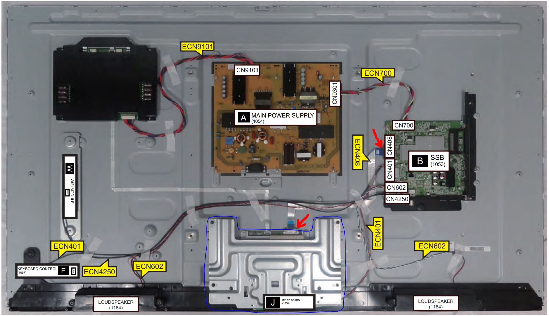

                Originally posted by Davi.p
                Sorry i misread a little pass of Tyrmas, so by disconnecting the led/ir pcb and maybe also button pcb, the short circuit go away, but to be more precise watch the manual at p.38 and tell me exactly which cable you disconnect. If i read well in this model SDM is entered by remote, also by standby, if not it is unuseful.
                The button PCB doesn't seem to have any effect. And I think I actually made a mistake earlier. It's most likely not the IR/LED board cable I unplugged, I think I just got confused looking at the picture from the manual that I've now attached.
                Red arrows show which cable I removed. By removing that cable, the panel lights up like I described earlier and the clicking noise is gone.
                Now the blue line I drew is where I probably got confused. I thought IR/LED board and the pcb behind that cover were one thing. I have now removed the cover and yeah, should've realized this before. The LED-part somehow made me think about the panel... So the PCB behind that cover is what causes this issue. I attached a picture of it too. I also tried to remove the smaller white cable from the board (next to the one I removed) but that didn't do anything.
                Really sorry for the confusion! I really shouldn't use my lunch breaks on this.
                  Ok as my last post edit the fault is in the tcon or the panel, now things get harder cause you don't have schematics on that, i don't have a pc now, i can't edit the photo of where to test, so make a magnified photo of the left part of it where there are grey squares and i can read the silkscreens, or simply test in diode mode all Qxx , Dxx components to find a short...

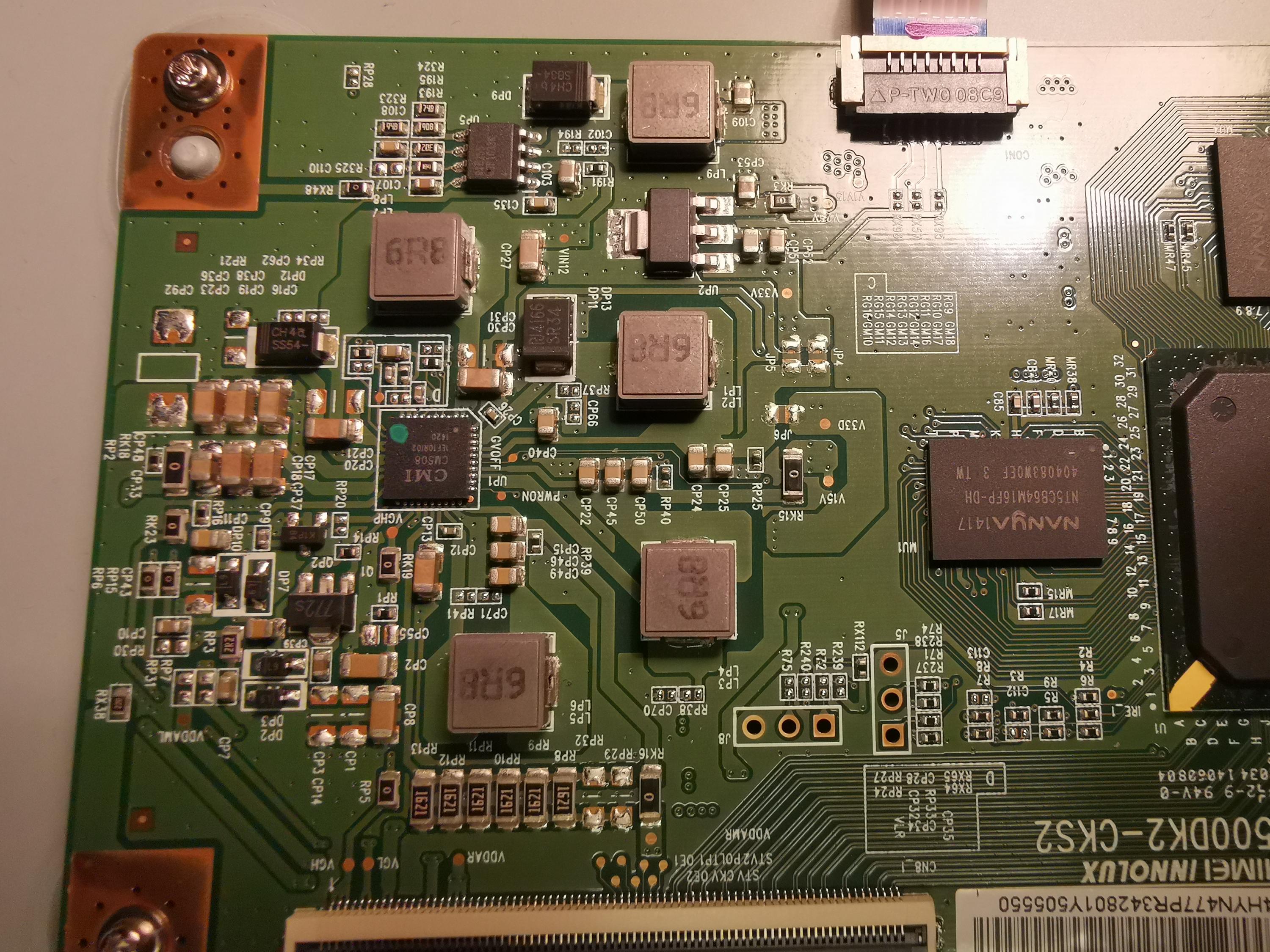

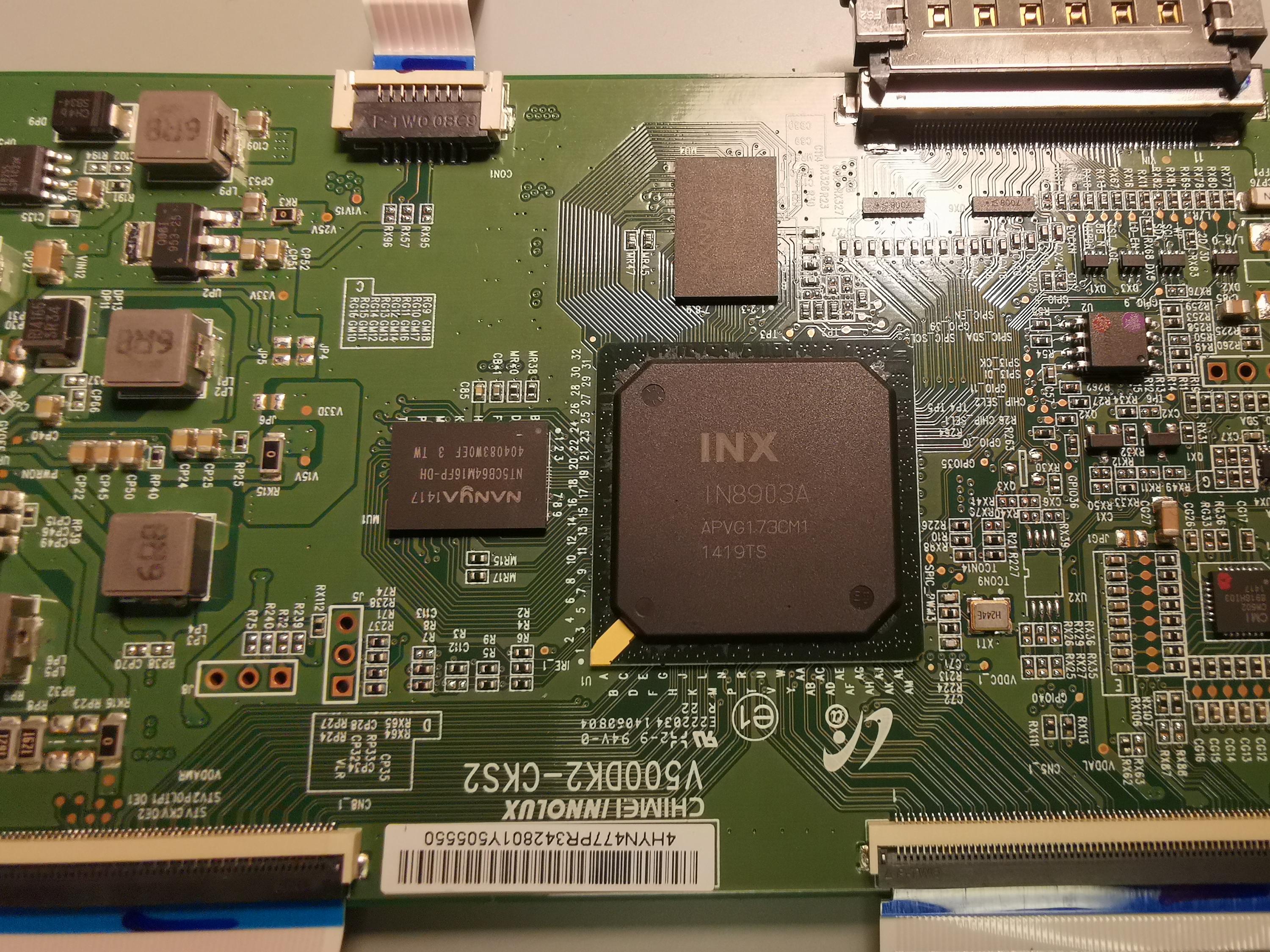

                  • Tyrmas
                    • Aug 2021
                    • 8
                    • Suomi
                    I attached a few pics. I hope they are okay. Lighting is a bit awkward, sorry for that.
                    I'm going to check the components tomorrow if I have time.
                      up2 has also to be tested, for short, in 3,3v, out 2,5v,

                        Check fuse and then check all SMD capacitors on tcon board, maybe some of them are in short circuit
                          Finally got time to get back to this. I've spent a few days trying to find shorts or get some readings but no luck.
                          I can't seem to get any voltage readings from the tcon board. I get around 0.1-0.5 volts before the TV reboots (for example on up2 in). If I remove the tcon cable so that the TV stays on I get basically nothing. I also removed the two flat cables going to the panel and that doesn't change anything so I think it's safe to say that the panel is working. What I find weird is that I can't find any shorts with continuity testing.
                          PSU outputs correct voltage everywhere.
                          I checked that new(?) working tcon board costs around 15€ so I might just order one and see how that goes unless there's something else to test.
                          • Tyrmas
                            • Aug 2021
                            • 8
                            • Suomi
                            I hope I don't get in trouble because I reply to my month old thread, but I managed to fix the TV so I believe it's fine since someone might be able to get something out of this. Also, the replacement tcon board came yesterday so there wasn't really anything to update before that.
                            As you can guess, I wasn't really able to replace any components or anything since the "bootloop" made it impossible (at least for me) to get any voltage readings and I couldn't find shorts anywhere. So I bought a replacement tcon board.
                            I just replaced the tcon board and the TV works again. No issues. So while I was able to pinpoint which board caused the issue (with some help), I couldn't fix it the way I would've liked.
