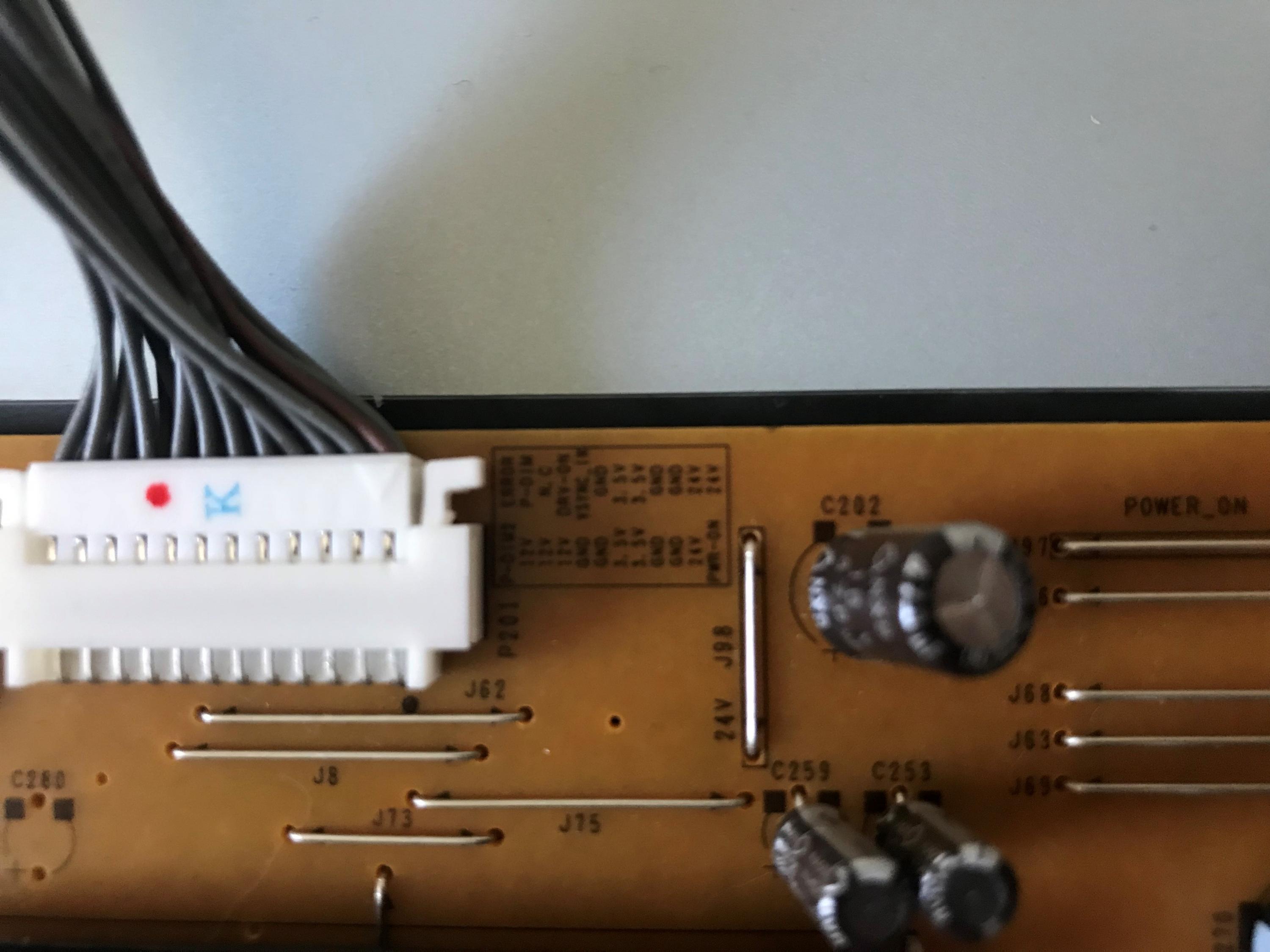

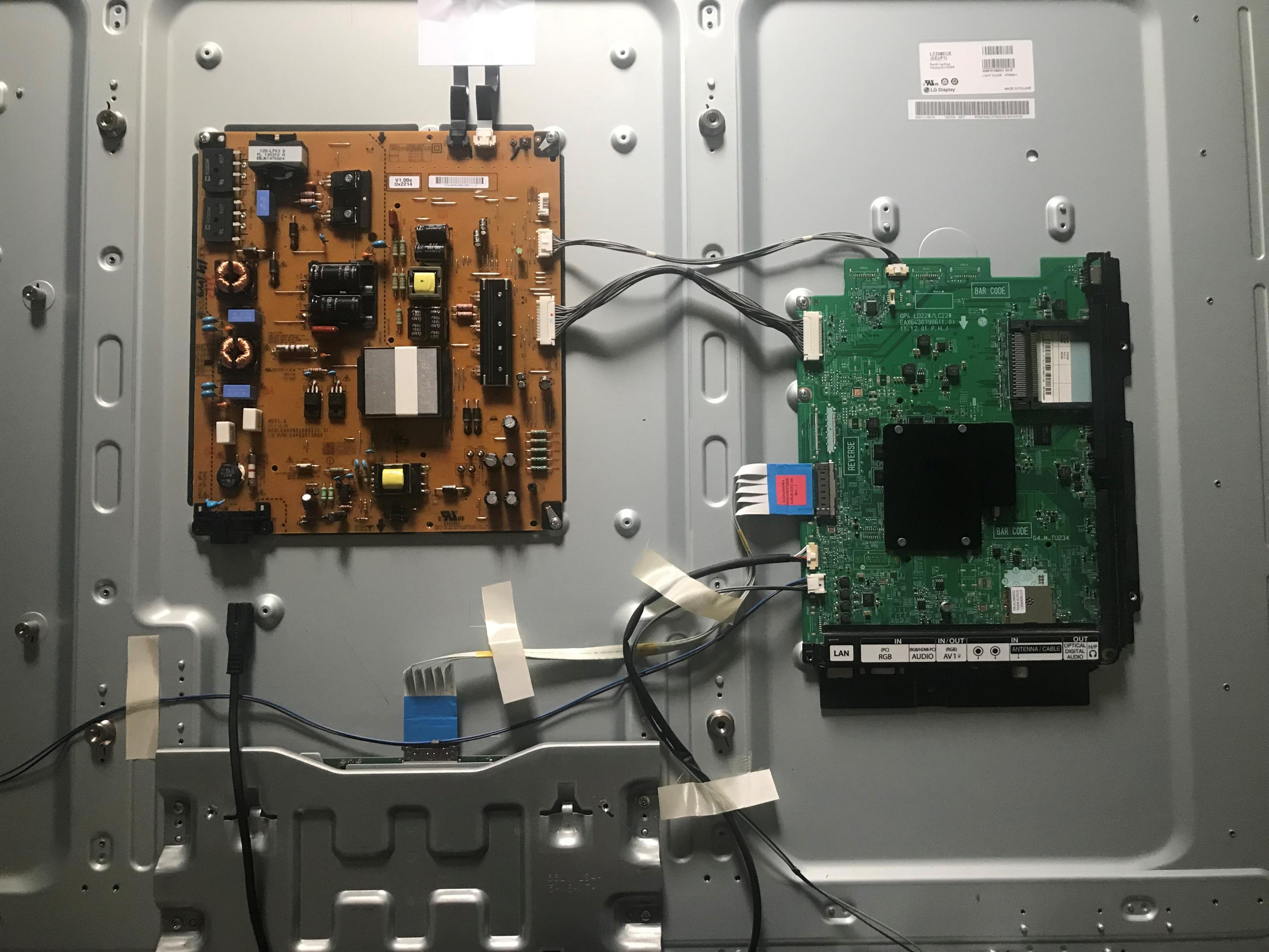

    Hello everyone. The tv wont turn on. It got a red standby light that blinks as when pushing power on button. The tv has been laying for about 1 year now but what happened was that i was plugging i an antennea cable or maybe vga(cant remember which one it was ) and it just died instantly. Attaching pictures of the tv and the boards. I alson took some voltage readings as in one of the attached images. Someone who can point me in the right direction on repairing it? And btw, the readings i got was when plugging the powercord in and measured it in standby mode.

        Re: LG 55LM620T-ZE Not turning on
        All the secondary voltages appear to be up and running but you don't give the voltages for DRV_ON or ERROR.

          I saw now in my first that i wrote what could be misunderstood. To clarify, when I plug the cord in the red light goes on and stays like that until i press the power button, then it starts blinking and keeps doing that for a while before it goeas back to a static light. Some additional info is that i have a green led on the powerboard that after the tvhave been connected for about 30 secs start to blink. Blinks 5 times pauses and then 5 times again and keeps going like that.
            Everything that is left out in the "measuring" picture i have a 0V on.
              I noticed that on the pin labelled N.C (Not Connected) you have 12V. That is not right. I think there is an error in your readings Perhaps you could label the pins as pin1 ERR 12 V, pin 2 PS-ON 3.5V just as an example.
                DRV_ON is missing and should be around 3V to activate the backlight led circuitry. It's a signal from the mainboard so you may have a led fault giving an Error response turning off the DRV_ON signal.
                Can you check what voltage is at PWR_ON when in standby and when you switch it out of standby. Some PWR_ON need to the voltage on the pin to go low to come out of standby and some need to go high to come out of standby.
                  On the N.C pin i have nothing. The text inside the box labeled CONNECTOR is taken from board. To the left inside the box there are (at least how I think it is) the suggested values for the left column of pins and the ones to the right are for the right column of pins. The numbers underthe label READINGS are my measurements of respective pin in each column.

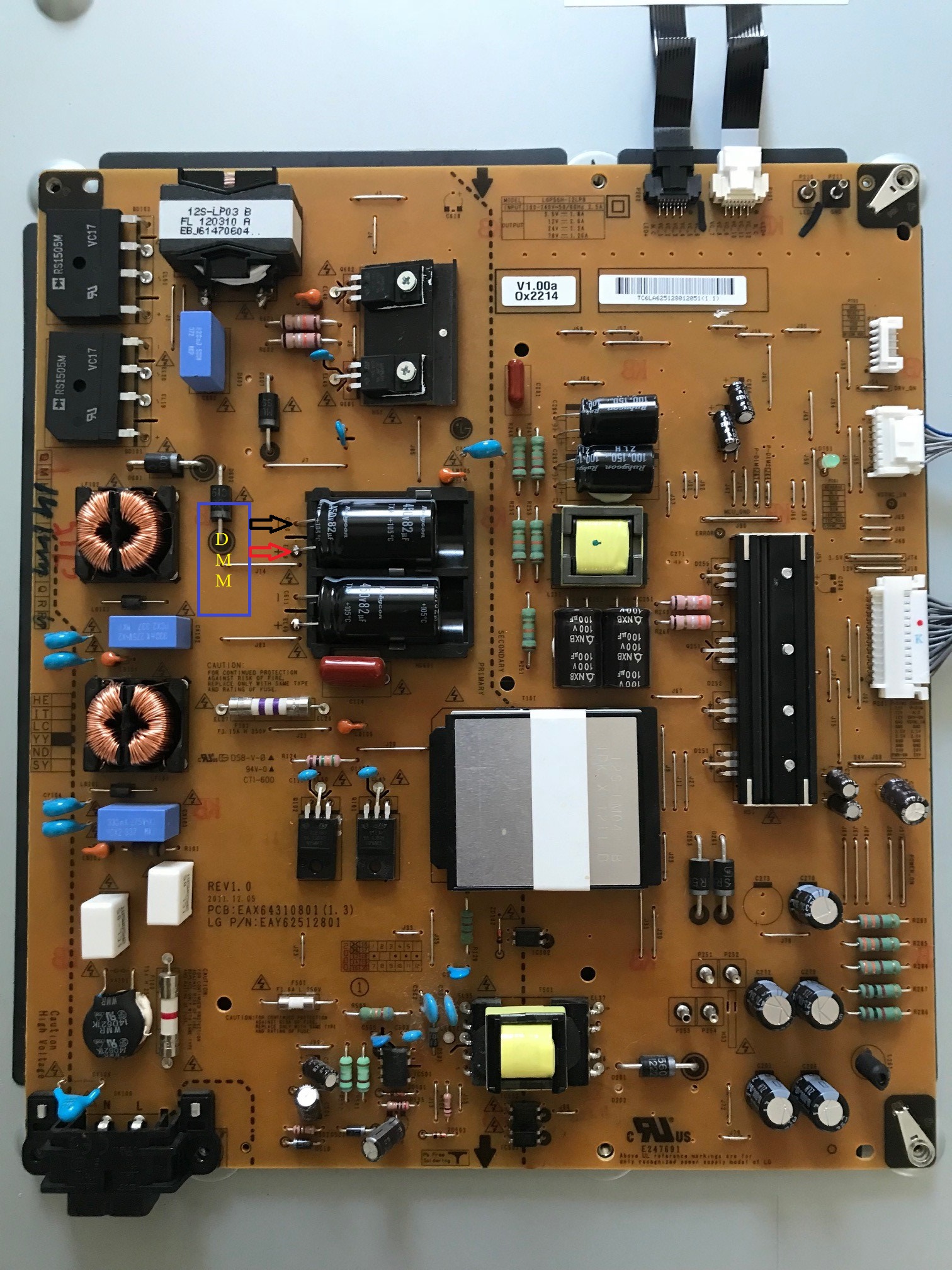

                        Based on what you show, the PWR_ON is fine otherwise not ALL the switched power supplies will be putting out. You can easily verify if the PWR_ON is OK or not by checking the DCV right between the two legs of the main filter cap, if you have close to 400VDC then the PWR_ON signal is OK otherwise you will not have PFC Boosted Voltage on the main filter cap. The PWR_ON may be stuck ON at this point if it does not toggle to 0V (= off). Some power supply boards do use <1V = ON, 0V = OFF instead of typical 2 ~5 V = ON, <1V = OFF.
                        You do not have Dimming control on one of the pin but not at the other P-DIM pin? Backlights ON signal is not present.
                            Originally posted by budm
                            https://www.badcaps.net/forum/attach...9&d=1530363633
                            Main filter cap? Is that the 2 big ones on the board? I have 400V on them as soon as i plug in the cord.

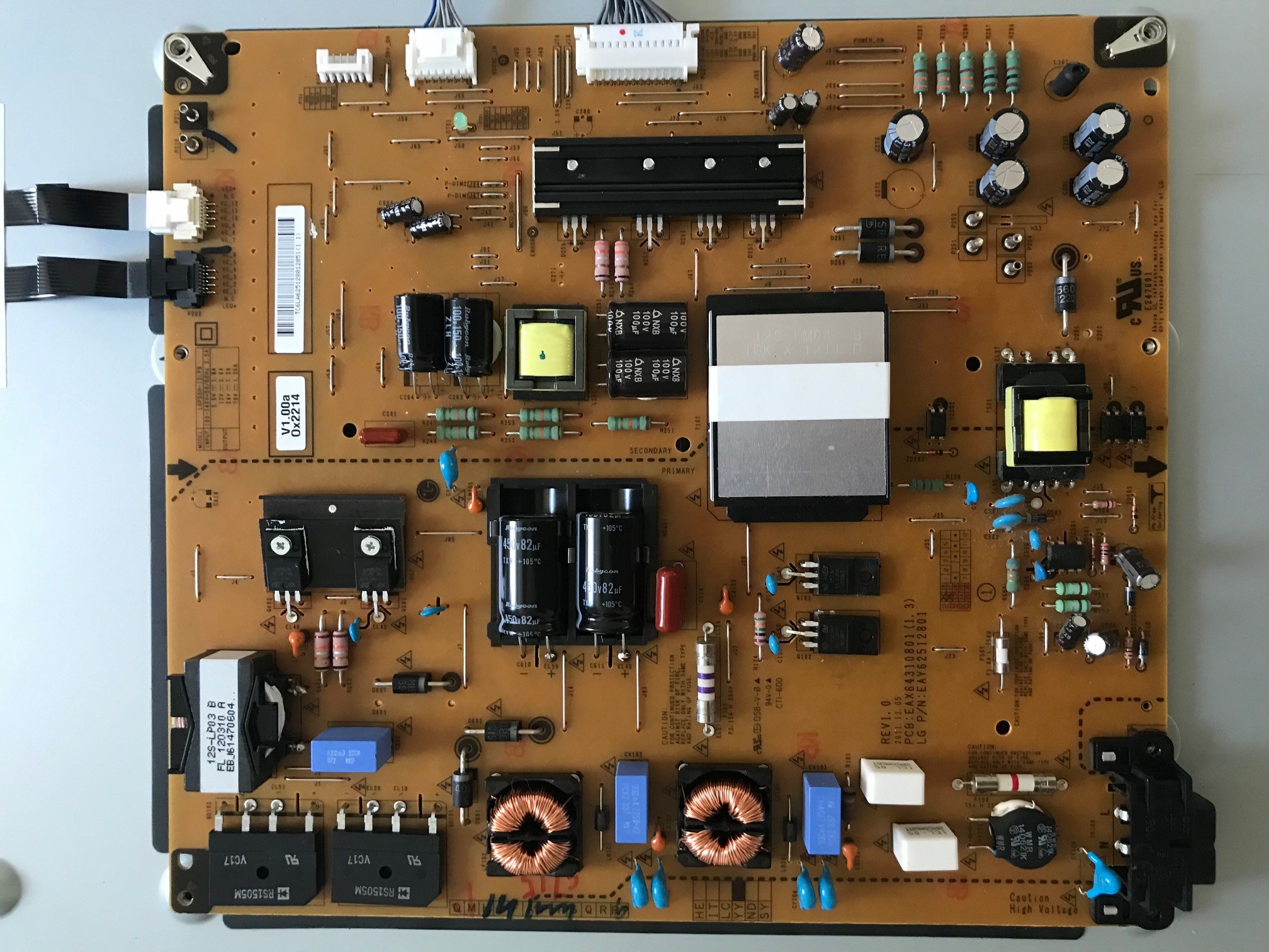

                                  Place your probes across either of the two large capacitors with 450V written on them. Do not let the meter probes slip.
                                    With the connector (P201) disconnected i get 328V and when connected i get 400V.

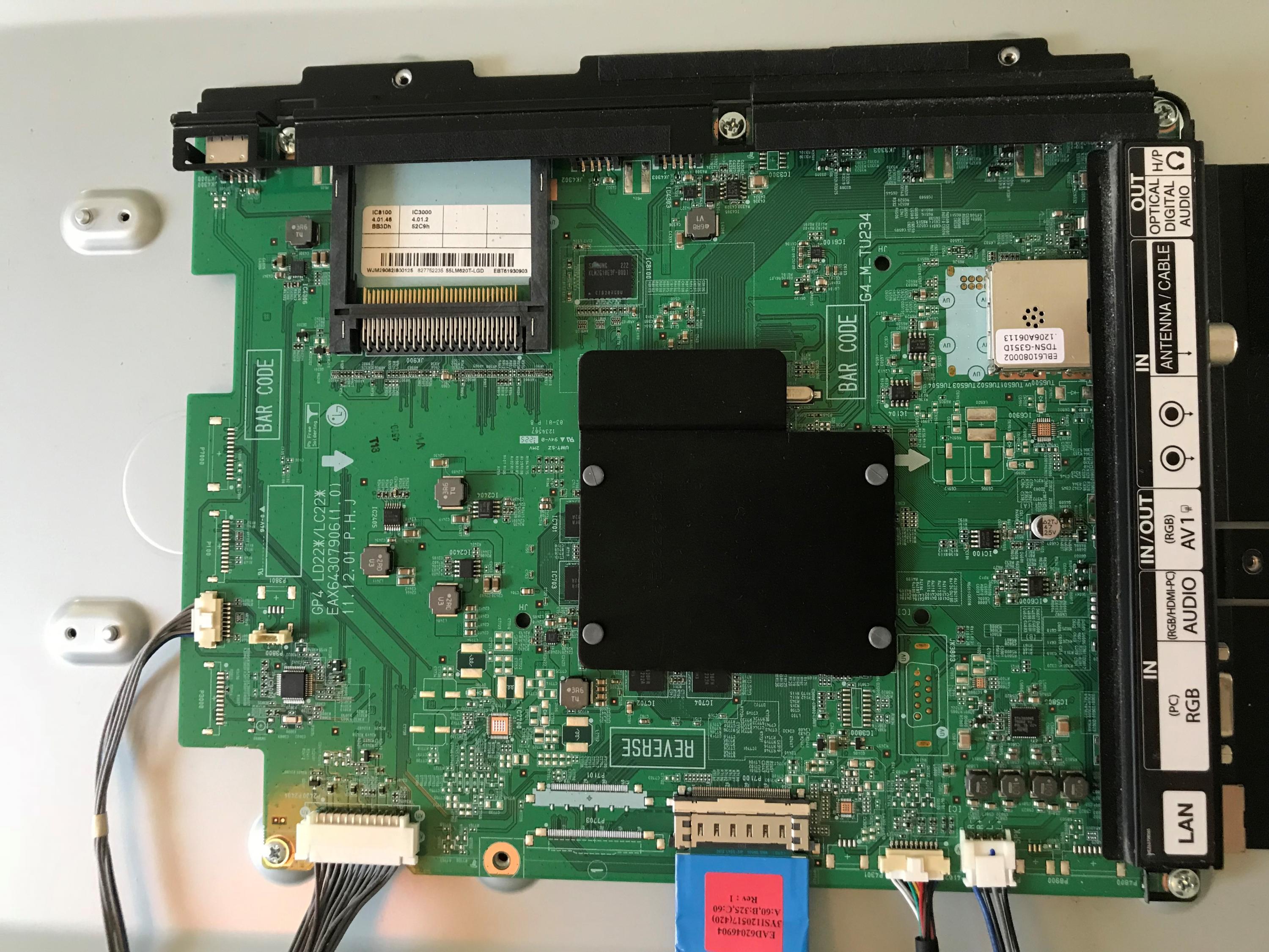

                                      ok, so your main is stuck on. i'm not sure if you can get an eeprom for this board, or you would be looking at a replacement.
                                        So getting a new mainboard (and just to be sure, that is the one to the right in the photos of my tv?) would probably be easiest soultion?
