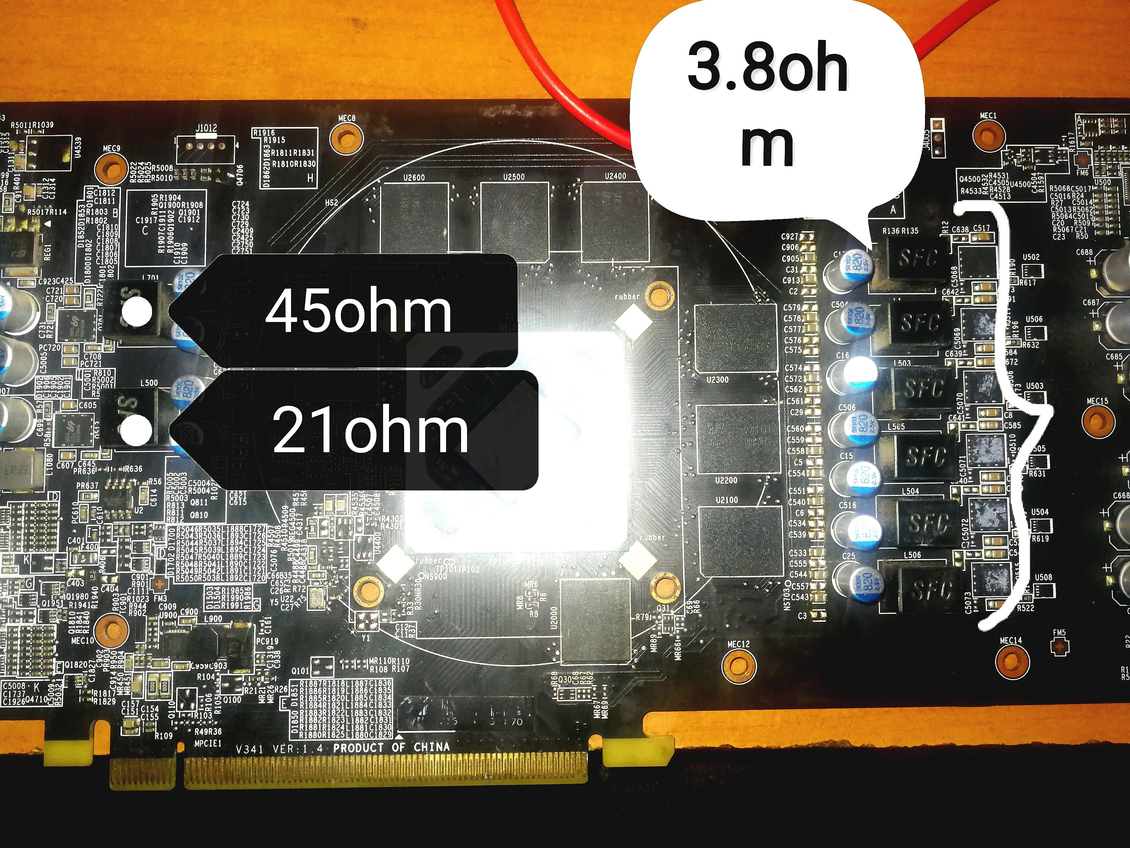

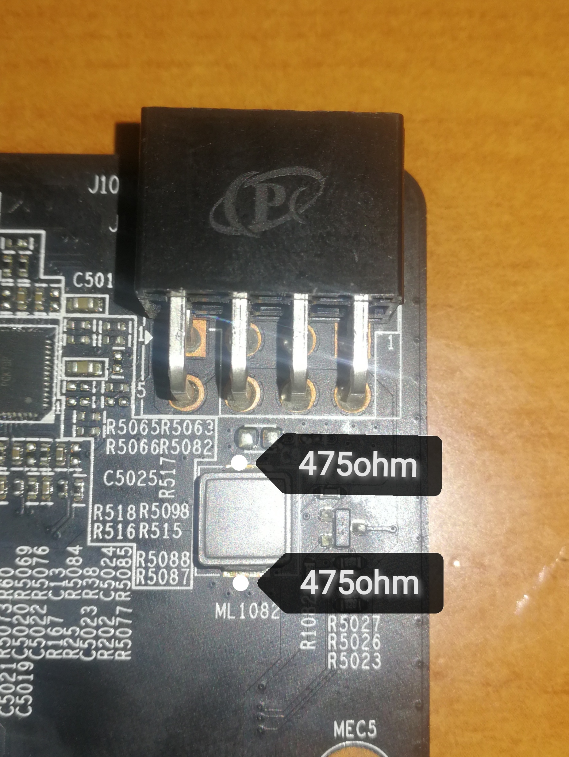

    Forgive me if I am wrong, but I tested the 3 PCIe 12v power pins on the left(550ohm) and the 4th one from the right 3.3v (400ohm), and there is no short, i tested the 8pin connector (475ohm) on the power pins to ground, and I have tonl switch the multimeter probes so it doesn't show an erratic readings because of the capacitors.
    Now after my understanding of GPu repair these look fine, so I started testing coilsI will post pictures instead, because I dont know what most of them are for.
    Click image for larger version  Name:	IMG_20240418_091932.jpg Views:	0 Size:	1.20 MB ID:	3254979
    now I don't know if these coils are all for vram, since there are 8 coils and 8 memory chips I supposed they all should be the same, but the 2 on the left are reading differently?
    Click image for larger version  Name:	IMG_20240418_093130.jpg Views:	0 Size:	4.33 MB ID:	3254980
    I have several questions.
    - Can you power the card without the 8 pin connector? Does the PC boot and post without it, can anyone test this for me please.
    - What should I test next? I have read several articles and watched many videos, but I cannot pinpoint on this exact card.
    - Can a molex to 8pin adapter power this card enough to post? Since I have seen most people use it, and there are 2 12v pins connected to each other instead of being separate, does that do anything since i read somewhere that the gpu 8 12v pins are separate and not interconnected.

    why dont u first see some videos on youtube, so u have some starting knowledge. there are hundreds of them. msi schem and BV are widely awailable so find them.
    PCIe power MUST be attached to post, else u dont have post o just screen that tells u that PCIe power is not connected

      PCIe power must be attached for this specific card? Does it show the "plug in power cables" screen, if anyone has this card please try it and reply to me.

        if u watch some videos u know starting sequence and what to measure first
          First: you need boardview (MSI) because MSI boardview can be same structure of all this brand model
          Second: you need road map voltage and mesure follow this
          Third: All High members are so uncomfortable because you didn't post the result after mesure, and can't how to help you.
          Road Maps Voltage for AMD Graphics Card
          12v Rail,3.3v Rail (have first, if 3.3v short stop mesure because gpu was dead)=> 1.8v => 0.9v at GS9230 (or GS9238,APW8713) => 0.9-1.1v GPU => 1.35-1.75v RAM => 0.9-1.1v Boot
          And result after when you were informed of block?
          12v Rail => ?
          3.3v Rail =>?
          5v Block =>?
          1.8v Block=>?
          0.9v Block (GS9230,GS9238,APW8713)=>?
          0.9v GPU Block=>?
          1.5v Ram Block=>?
          1.01 Boot Block=>?
          If all results are good last you flash bios on your graphics card
          The sub 12v from 8pin PCIE it supply for vrm 80% and main 12v rail supply for vrm 20%

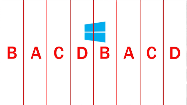

                        Hello, after I managed to boot my PC with the MSI armor rx580 OC 8gb with CSM disabled, i went durect and booted Linux mint in CLI mode, did both direct mem test and dmgg.
                        But dmgg is showing that all chips are faulty
                        But when I specify only 4 chips it says no problem all chips are good, now the lspci -v is showing this card as a 4gb card is that weird, was the bios tempered with or anything?
                        these are the results, thank you!
                        Card crashes when loading drivers and showing weird dynamic artifacting on uefi bios

                          So when you post picture with crash image,i think you should check with mats, and replace ram chip was fault. RX 580 so cheap. Try and get experiance
                              i dont know how u get courage to advice something, when u advice test AMD card with mats. U better learn something before advice any of this crap
                                chaos-theory
                                this dmgg test is crap. never get normal result from it.
                                u can use tserver or agt
                                this picture can u maybe serve better, but rx580 have more problems with balls under gpu than bad ram chips
                                  Originally posted by ktmmotocross View Post
                                  chaos-theory
                                  it's ok! with me,i think rx 400 & 500 series usually i meet 80% ram chip fault when display signal out crash and 20% is fault at gpu. Thanks for your pic

                                      I made some researches and it seems to be caused by either bad vram contacts or GPU contacts.
                                      So I went and did ./agt -mccfg
                                      And it's showing the vram manufacturer as UNKNOWN
                                      Very weird since it should show SAMSUNG, I researched more and some people implied that the channel A0 vram chips is responsible for defining the information about the vram chips, so I had to reball the vram chips, and saw that D1 has discoloration so I decided to remove it to to see if it's causing the artifacting, that's how I got here, the card is going into bios normally but full of artifacting without both vram chips present, and I still get the same errors.
                                      I didnt want to use dmgg because the results are not reliable in this case as it's showing all chips are faulty.
                                      I really don't know how to proceed, here are some pictures to show the artifacts with and without the 2 vram chips installed.
                                      Some of the artifacts are static and some are dynamic.
                                      Without vrams llvmpipe
                                      Caption
                                      Artifacts with vram installed
                                      Please keep this thread as it's very important to me, I have done plenty of researches and I need experience here instead of luck, thanks everyone!
                                      mostly bad solder joints under gpu
                                        Have you encountered that error before? Do you think reflowing can solve this?
