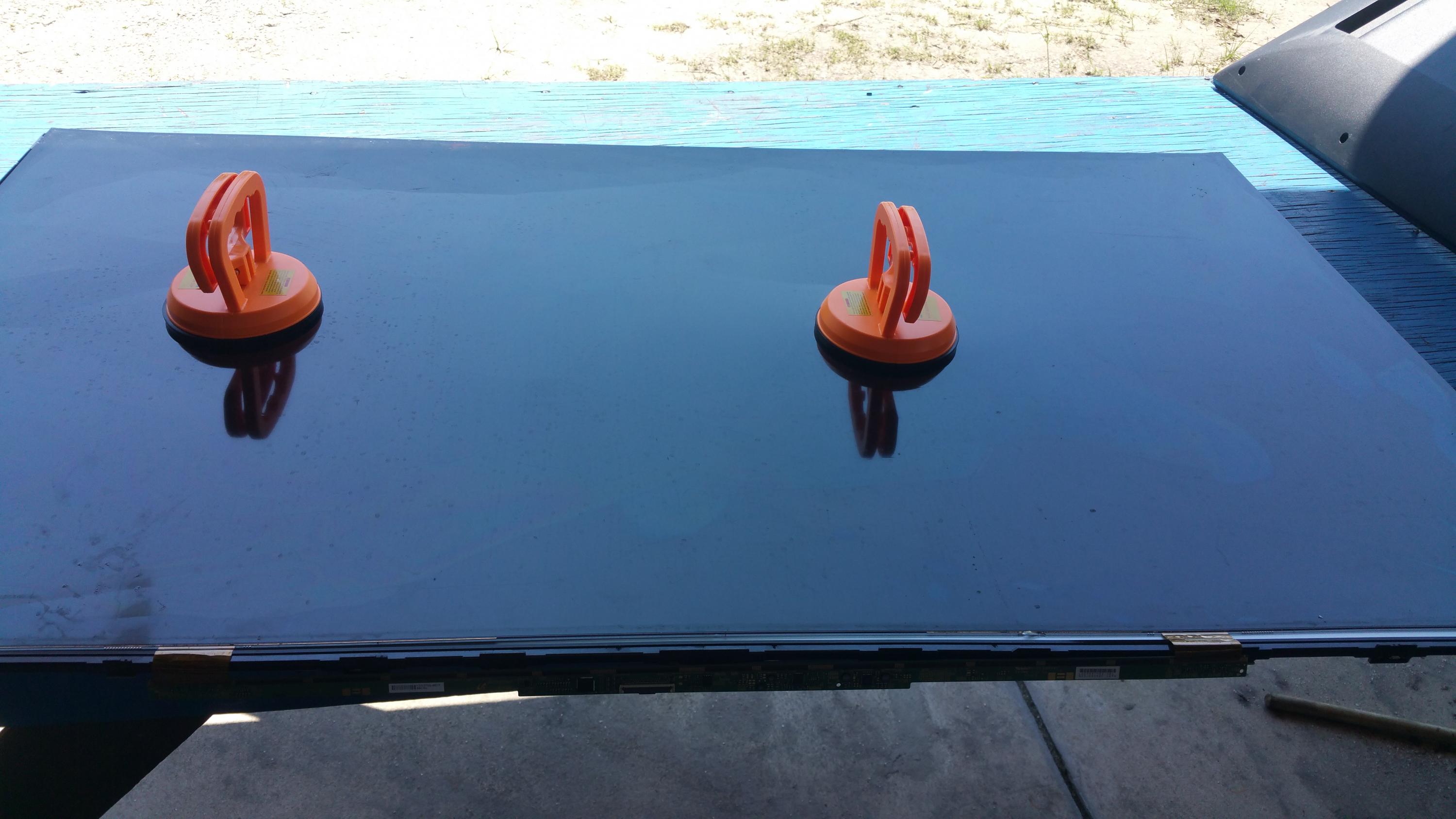

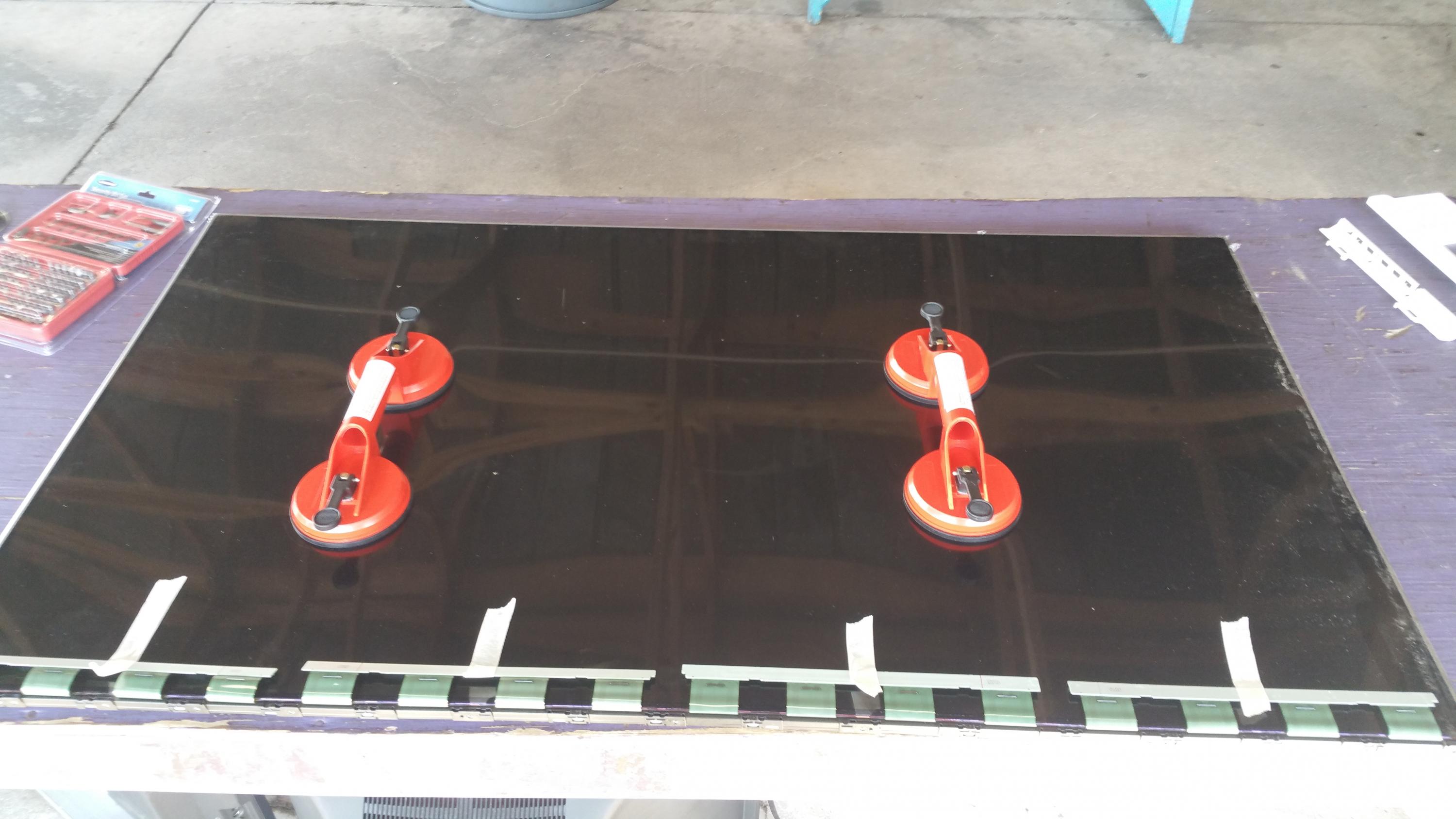

                                      Well, I gotta say... If I had had these nifty doodads, I would not have destroyed at least a dozen TVs....
                                      Ahh well.. Live and learn...
                                      Available at Harbor Freight ($4 for the single orange ones and $8 for the paired red ones)....
                                      The single orange ones work great for the under 50" and under TVs... For the +50", the red ones provide better support and control...

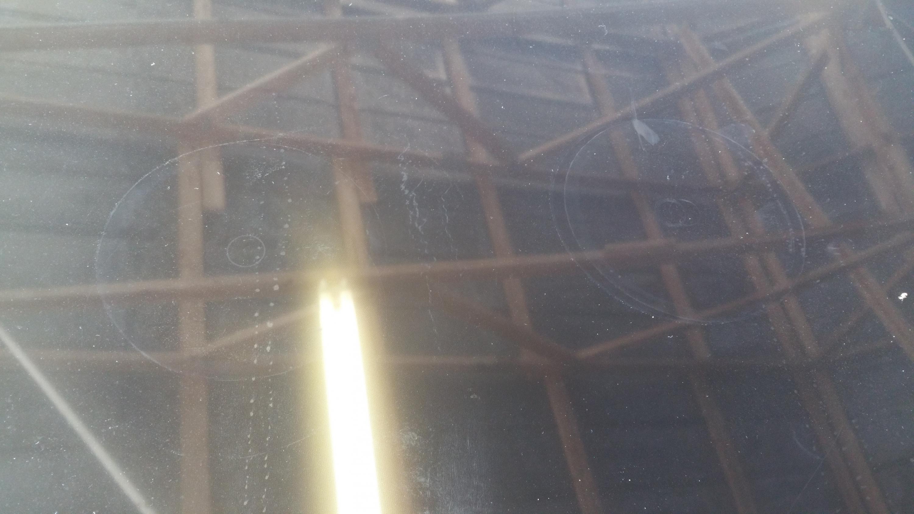

                                      I was kinda wary using the red dual suction ones because they have a real grip to them.. But I tested it and it didn't mess with the integrity of the panel..
                                      All that's left is some suction marks that wipe right off..
                                      So, these handy doodads look like the answer to my prayers...
                                      Hopefully, the thickness of the panels is constant..
