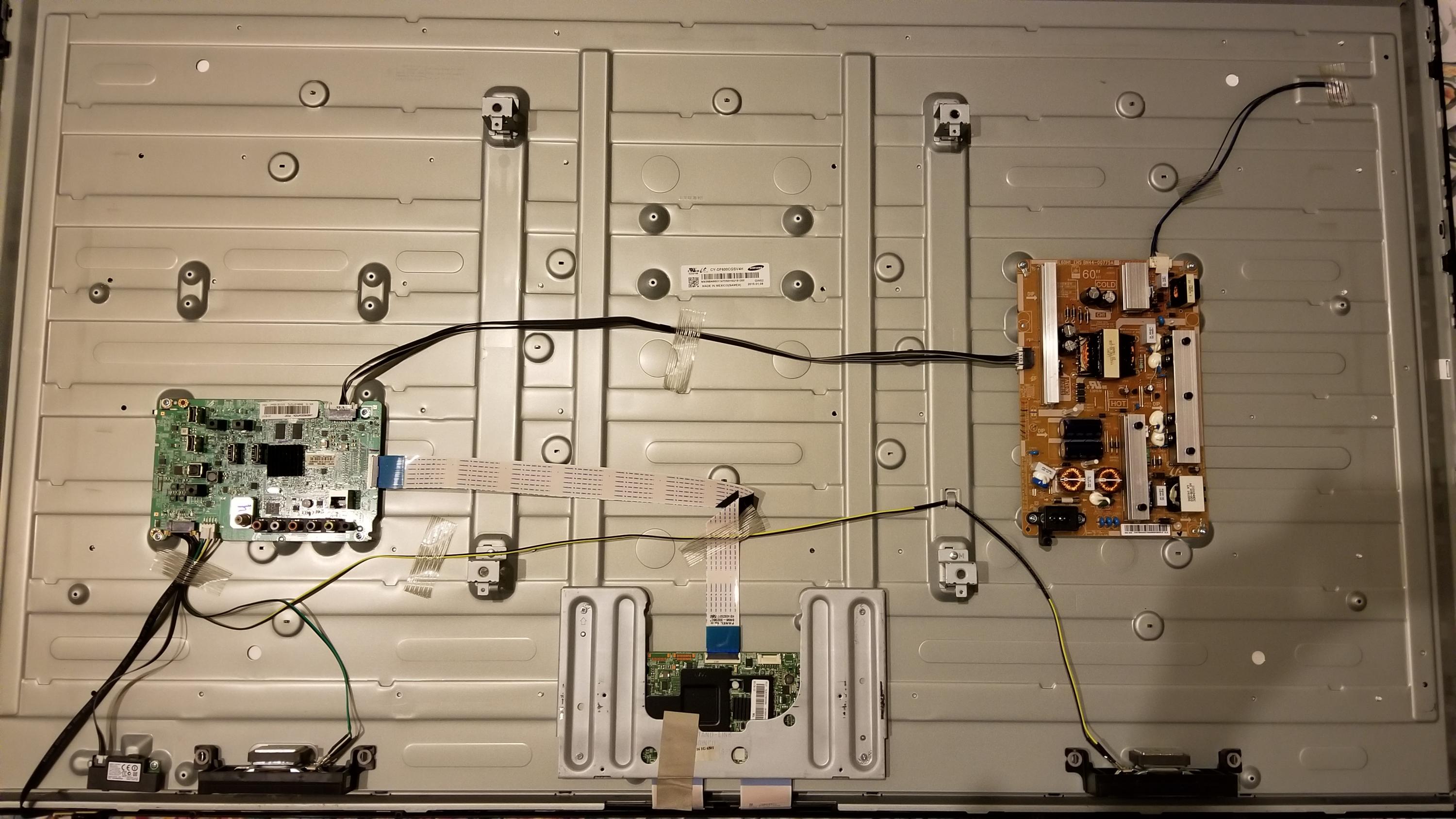

    Hi everyone! Woke up to terrible news that our TV wasn't turning on yesterday.
    I unplugged it, waited a minute, plugged it back in and turned it back on. The light by the power button blinked 5 times (not sure if that's an error code, or if that's normal), and the screen still remained off.
    I have an optical cable running from the TV to our home theater system and could hear audio when I turned on the XBOX , so it seems it's getting power and the screen just isn't coming on.
    I've never worked on a TV before, so I could really use as much help as possible in diagnosing which part went bad. I took the back panels off to take a picture (attached). Any help is greatly appreciated. Thanks so much for your time!

          These days LEDs are very suspect when PSU seems to be working (audio OK) but it pays to check the basics plus voltage outputs first as marked on that board near the connector to which they apply. Your led output is top rhs of PSU with leads going into the back panel of screen and that output voltage should be checked and all of them recorded in your next post together with the ref marks. Multimeter's are cheap but be careful testing particularly around PSU and especially near bottom half of that board marked HOT.

                  This TV set is very known to have bad LED's. However, turn the TV on and measure the VDC of the BLon pin on the PSU, in order to make sure the main board is actually turning on the back lights.

                      Re: Samsung UN60H6203AF LED TV Screen Won't Turn On
                      Are those Voltage readings are made with the black meter probe attached to the chassis GND?
                      It looks to me the LED power supply is not seeing the Load (LED strips) so the output Voltage went up very high. You have open circuit (I.E. bad connectors on the LED strips) or bad LED.
                      Samsung BN44-00775A

                          The LED Voltage/current chart as printed on the board (BN44-00775A) shows 326VDC @410mA, so getting over 400V seems to be about right without the load.

                                      You didn't yet... on the PSU connector CN803 pin 4. Actually measure all the pins on that connector and post the pin out name and the DC voltages measured.

                                        CNM803
                                        1/2 - UD: 14V
                                        3/4 - PWM_BLU: 14V
                                        5/6 - PS_ON: 14V
                                        7/8 - GND: 15V
                                        9/10 - GND: 0V
