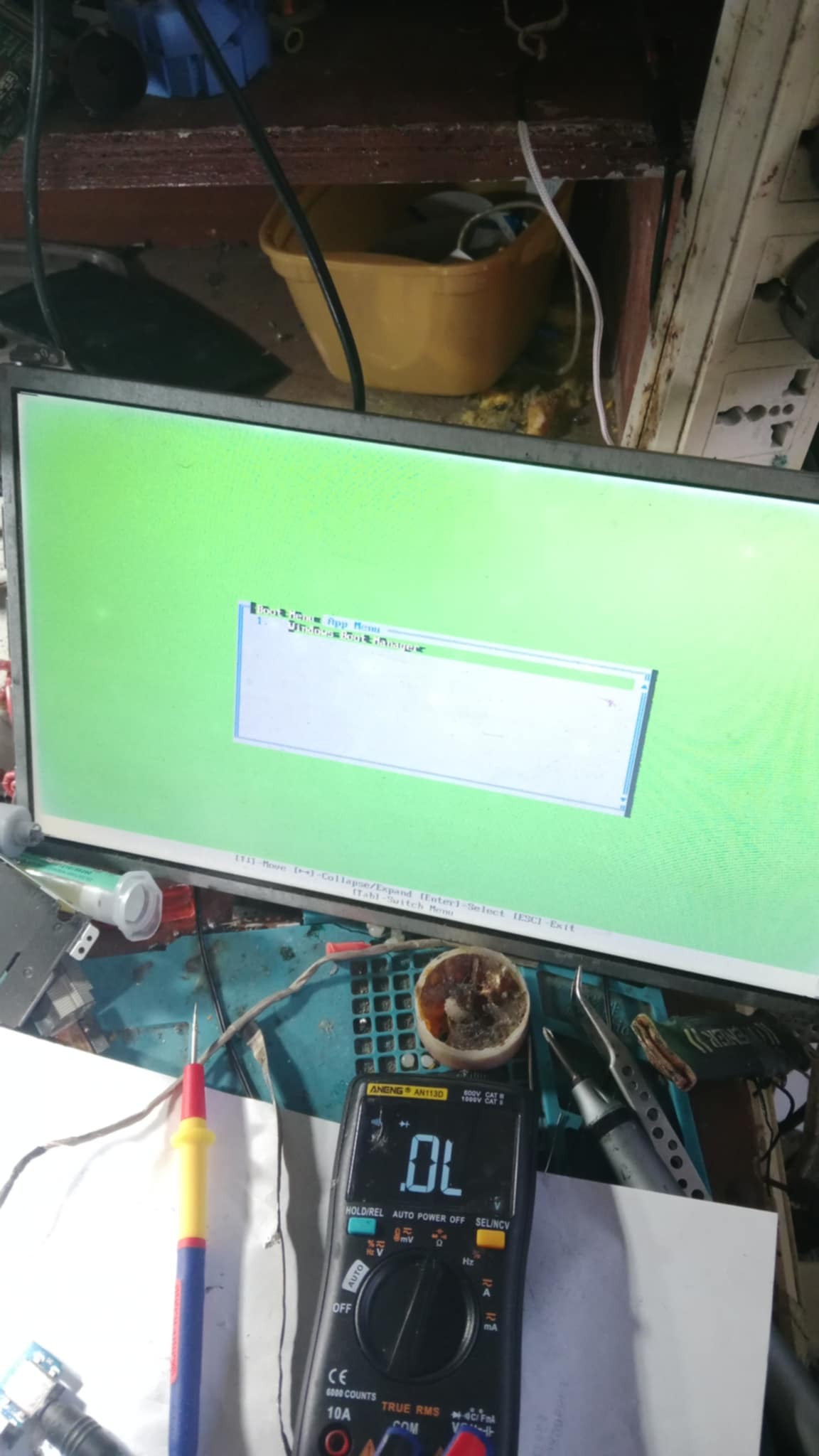

    samsung np300e green screen
    I need help on this samung np300e laptop, laptop turns on but the display green screen samsung logo and no bootable device shows but all green, I have replaced good lvds cable and good screen still problem persist.anyone encounter this problem please help

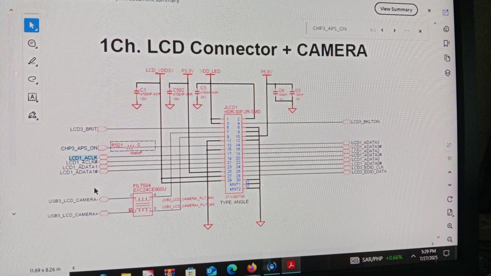

    i Have check all the voltages on the lvds connections all are present except for this CHP3_APS_ON..already tried good lvds cable and good screen still green display,connect to external monitor display is ok.below is the image and schematic 1-1 version, i cannot find 1/2 version since the board is 1/2. anyonce can help on this please
      SMDFlea commented
      Editing a comment
      Post a LINK to the schematic if it is already posted in the forum. If it is not posted then post it in the "Schematic requests ONLY!" forum and then post a link to it from this thread.

      another thing if I put 15.6inch screen display normal but if i put 14 inch screen is green. anyone can help please.putting screen 14inch lower gives green screen but putting screen 15.6inch higher gives normal dsplay,what could it be the problem please anyone can help
