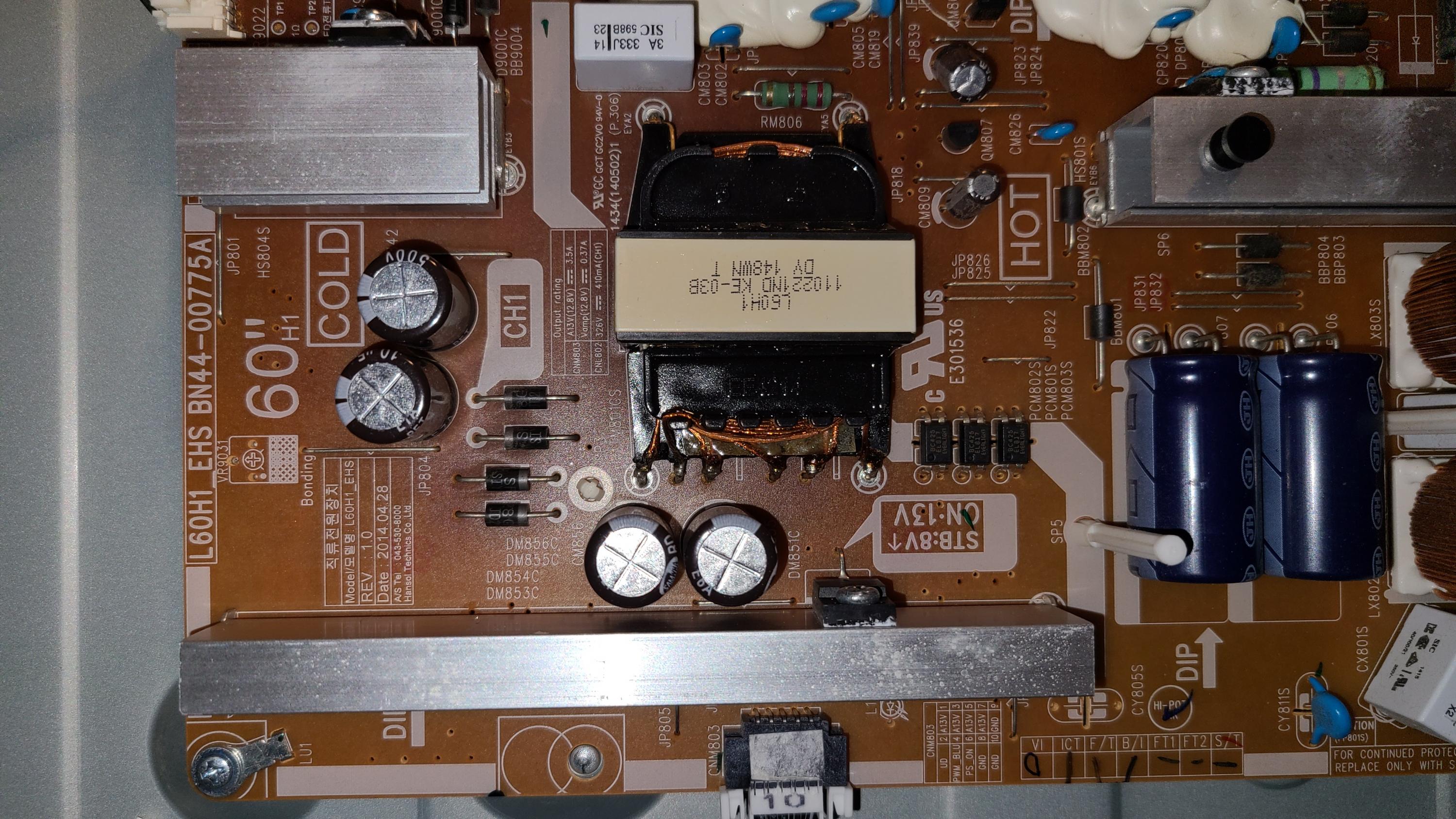

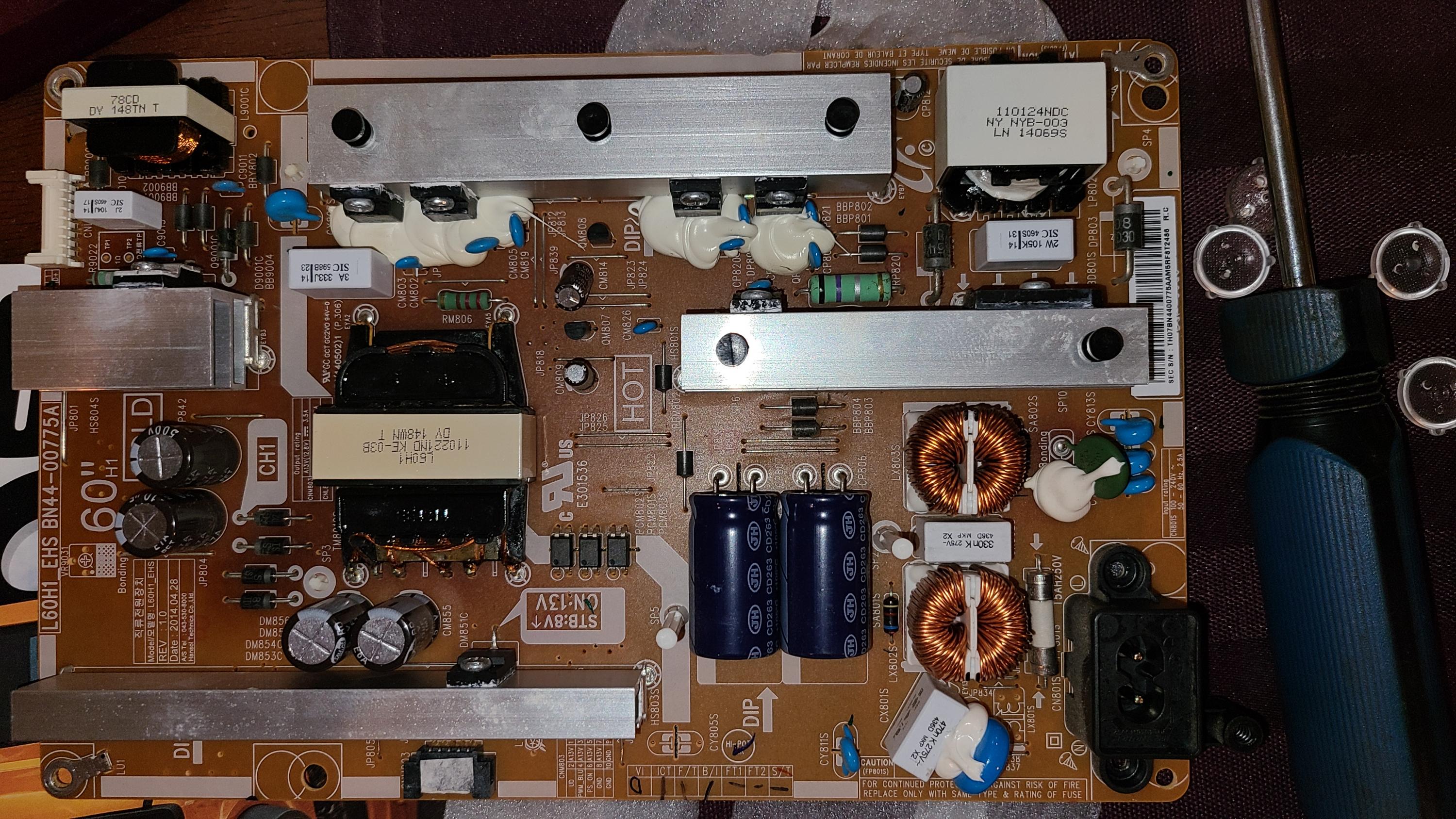

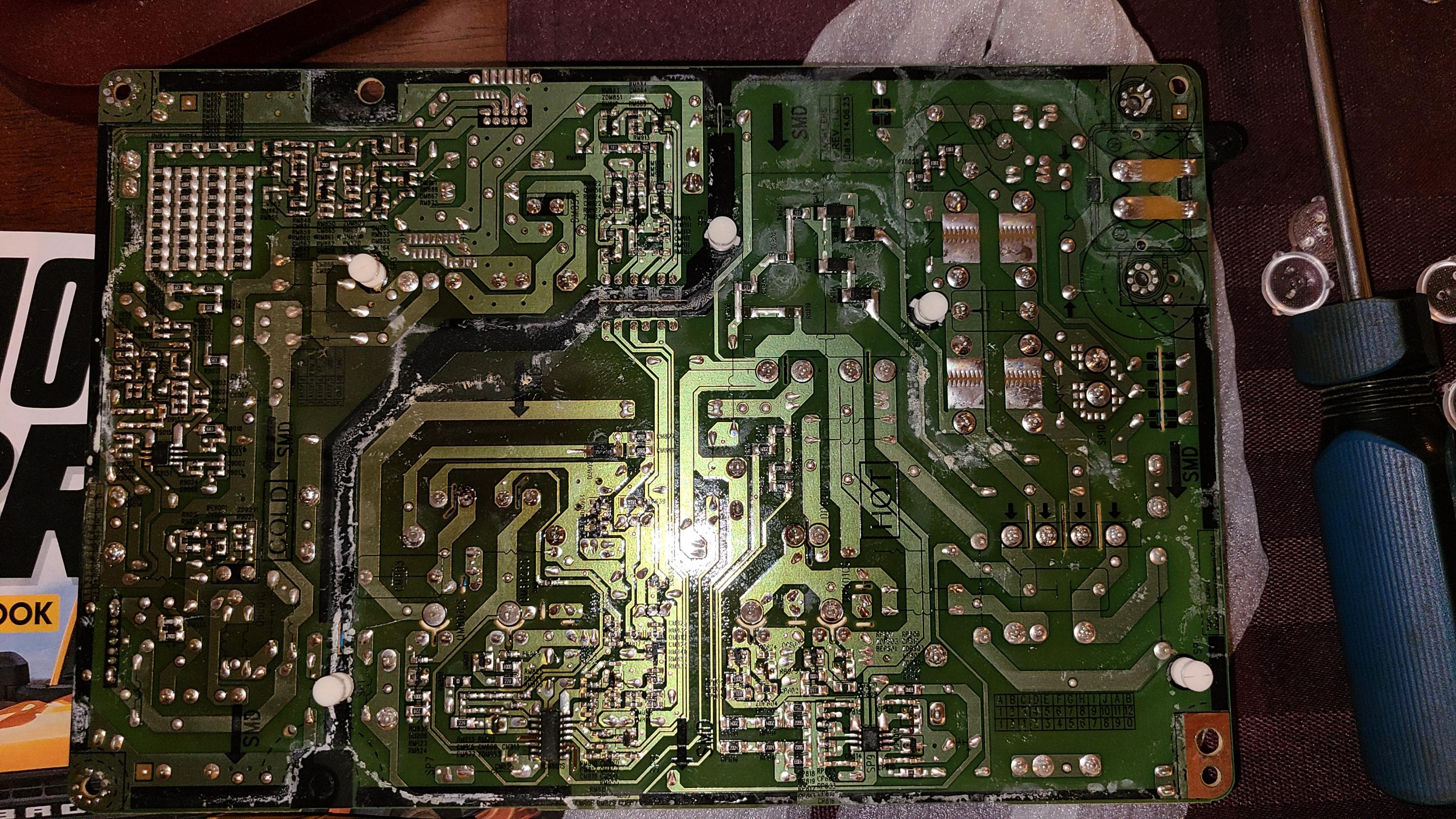

      Show us good clear straight shot pictures of the whole top and bottom side of YOUR power supply board, and also the whole back side of the TV showing all the boards.

        The picture of the bottom side has too much glare from the flash I cannot trace out the circuit using that picture.
        I will have to use pictures form shopjimmy instead.

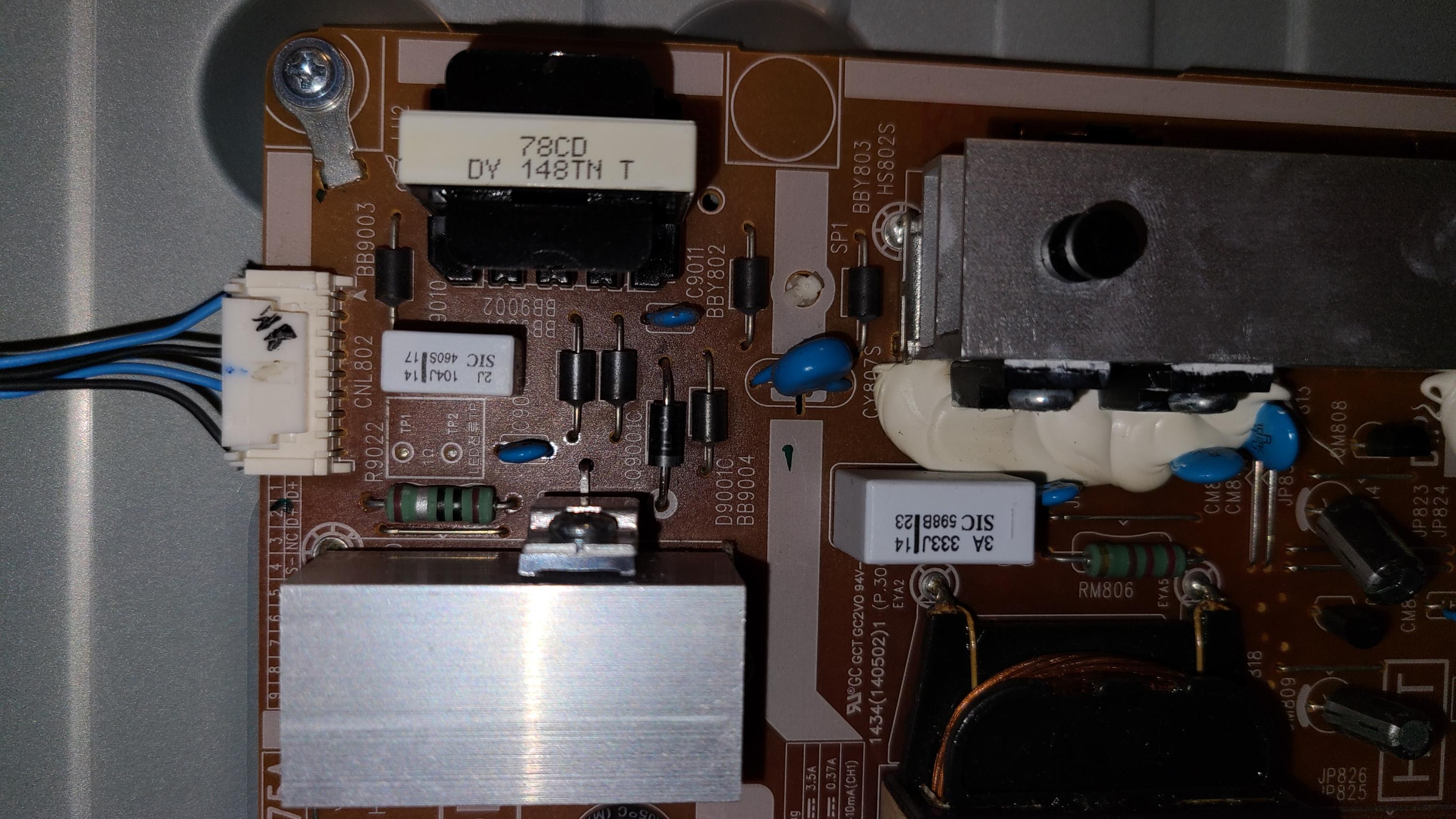

          On the LED connector (all connectors must be in place), there are four wires so what you need to do is to turn the TV off, keep the Black probe of Volt meter (Set meter to be able to read at least 400VDC) on the chassis, read probe on one of wire then turn on the TV while watching the meter to see how high the Voltage goes up to the with 10 seconds to see what it goes down to, the turn off the TV and then repeat the same test on the other 3 LED wires.
          At this point I suspect diode D9001C to be the problem, it is common failure for this BN44-00775A.

                    MOSFET has body diode between S and D so when test S and D it should show like Diode.
                    1) Check the resistance between Source pin of Q9001C and ground to see what resistance you are getting?
                    2) Check the Voltage between Gate and Ground of of Q9001C.

                                  Post #51:
                                  0v between g and gnd with led connector off. 405v between d9001c and gnd with led connector off. Same voltages with led connector on.
                                  It looks like the MOSFET is not being driven so there is not current return path to ground for the LED.

                                          The LED driver IC should be SMD located on the bottom side of the board.
