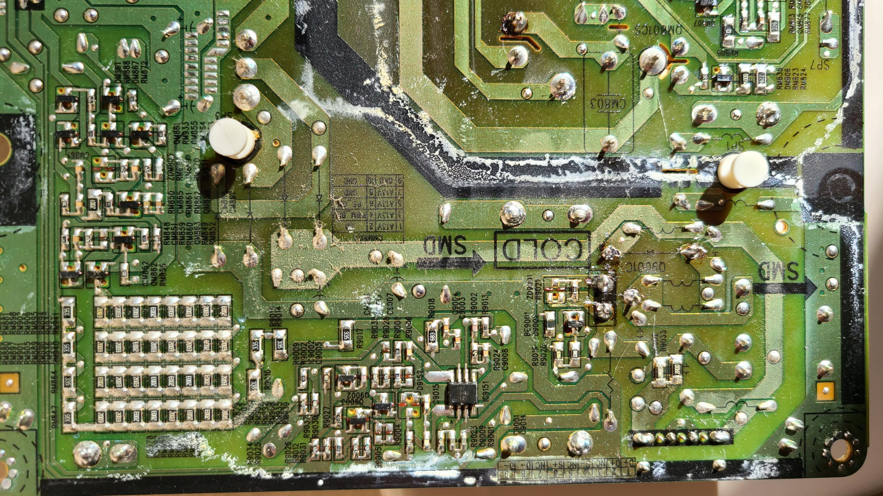

    The LED driver IC should be SMD located on the bottom side of the board.
    I thought that was on the top. When i look at the bottom the smd points to that part. I figured the driver would be attached to gate so im not sure what part is which. I took pics of the area hoping that helps.
      Are these good enough pics budm?

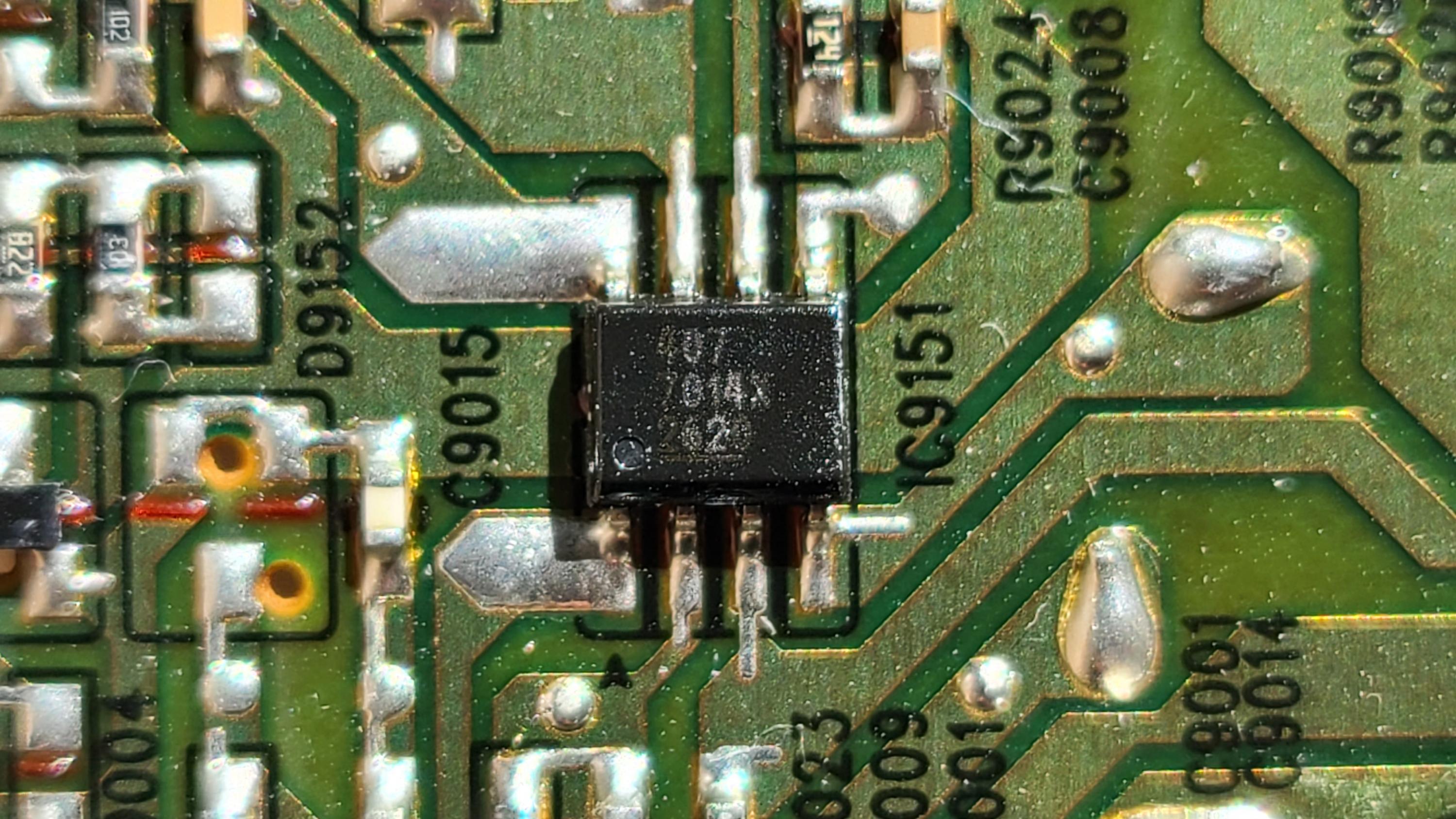

        I cannot read the P/N on top of the IC.
        Can you clean the top of the IC with Alcohol to see if you can read the prints?

          Best i can tell it is 4077014k2620. The 0's could be 6 or 8 instead. And my eyes tell me that could be a k or a x, but i think what i have is correct. Consequently, the only magnifying glass i had fell onto the concrete right out of the lens as i was looking at the part.

            Do those numbers seem right? I cant find anything online with that part number.
              #66
              Re: Samsung UN60H6203AF LED TV Screen Won't Turn On
              I cannot find anything at all either.

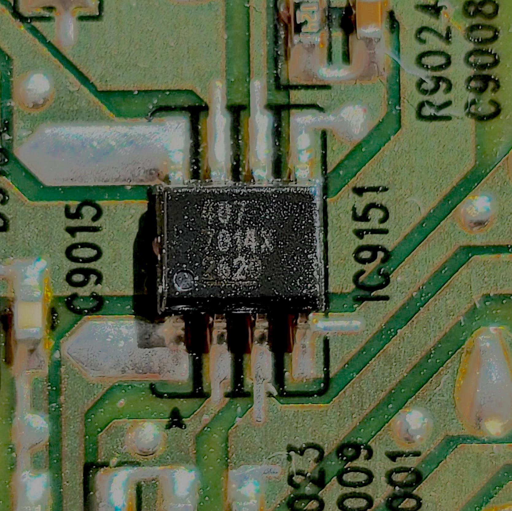

                  Looks like: 407 7014X 2620
                  I've modified (contrast, exposure, shadow) the original picture to make it a little easier to see.
                  Here's a previous thread trying to identify a 7014x SOIC-8 LED driver...
                  https://www.badcaps.net/forum/showthread.php?t=82041

                    Confirmed by younger eyes the number is 4077014x2620 (after i explained she was not looking at "plans for a golf course", but electrical traces instead).
                      Perfect! Thank u. That is what i see as well but urs is much clearer. Now, i only get a mathematical equation when i plug that in to the google.
