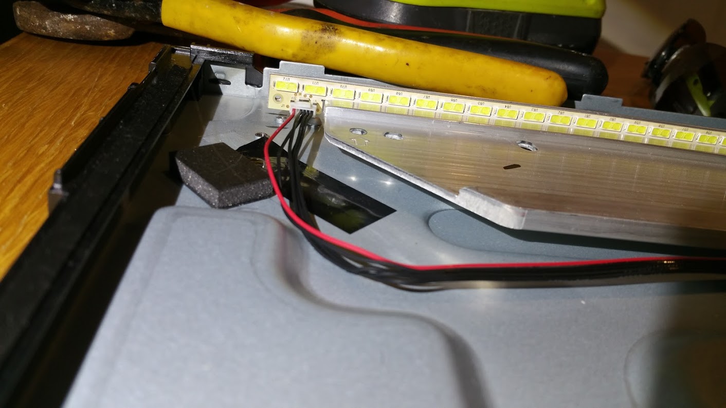

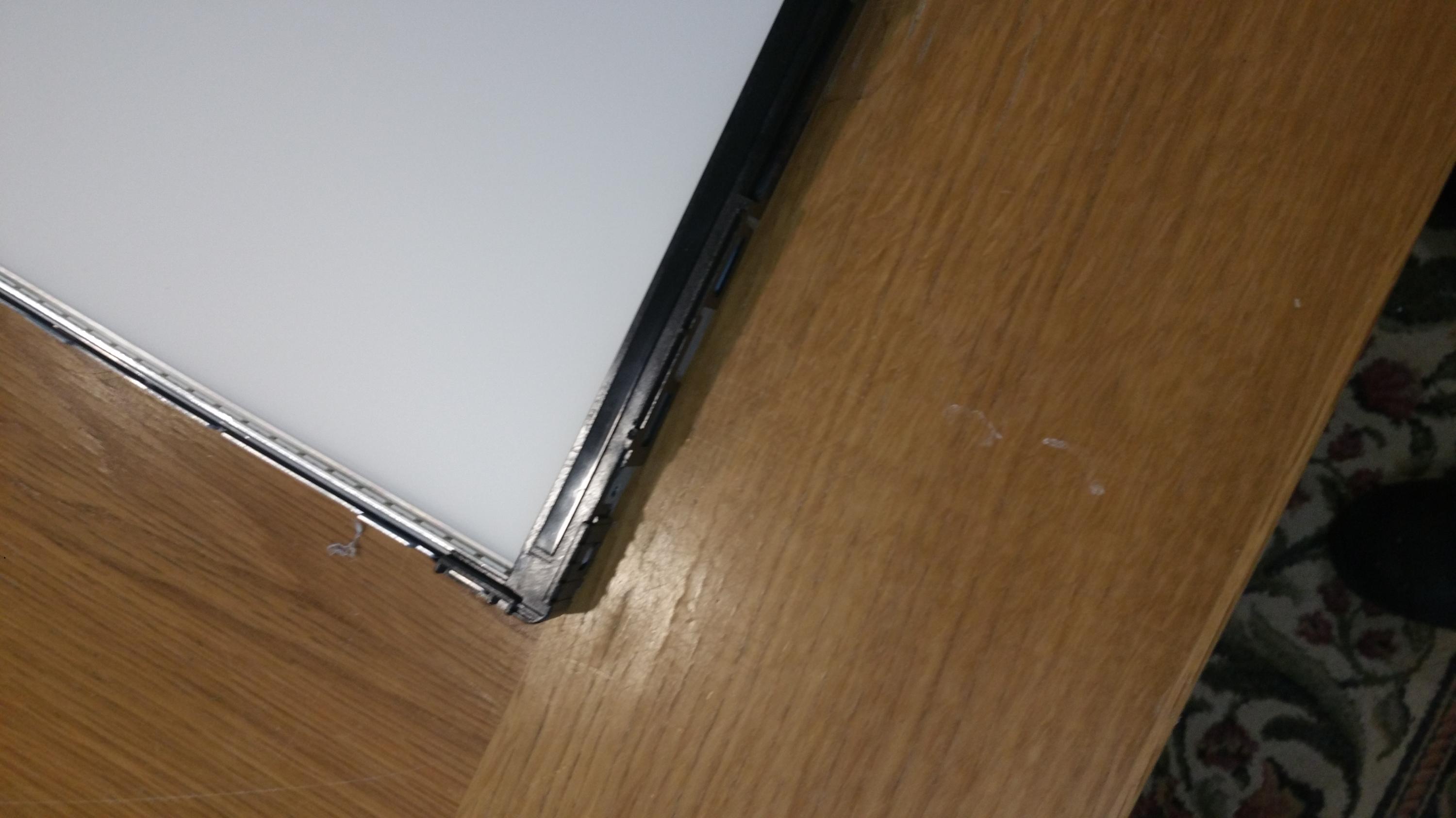

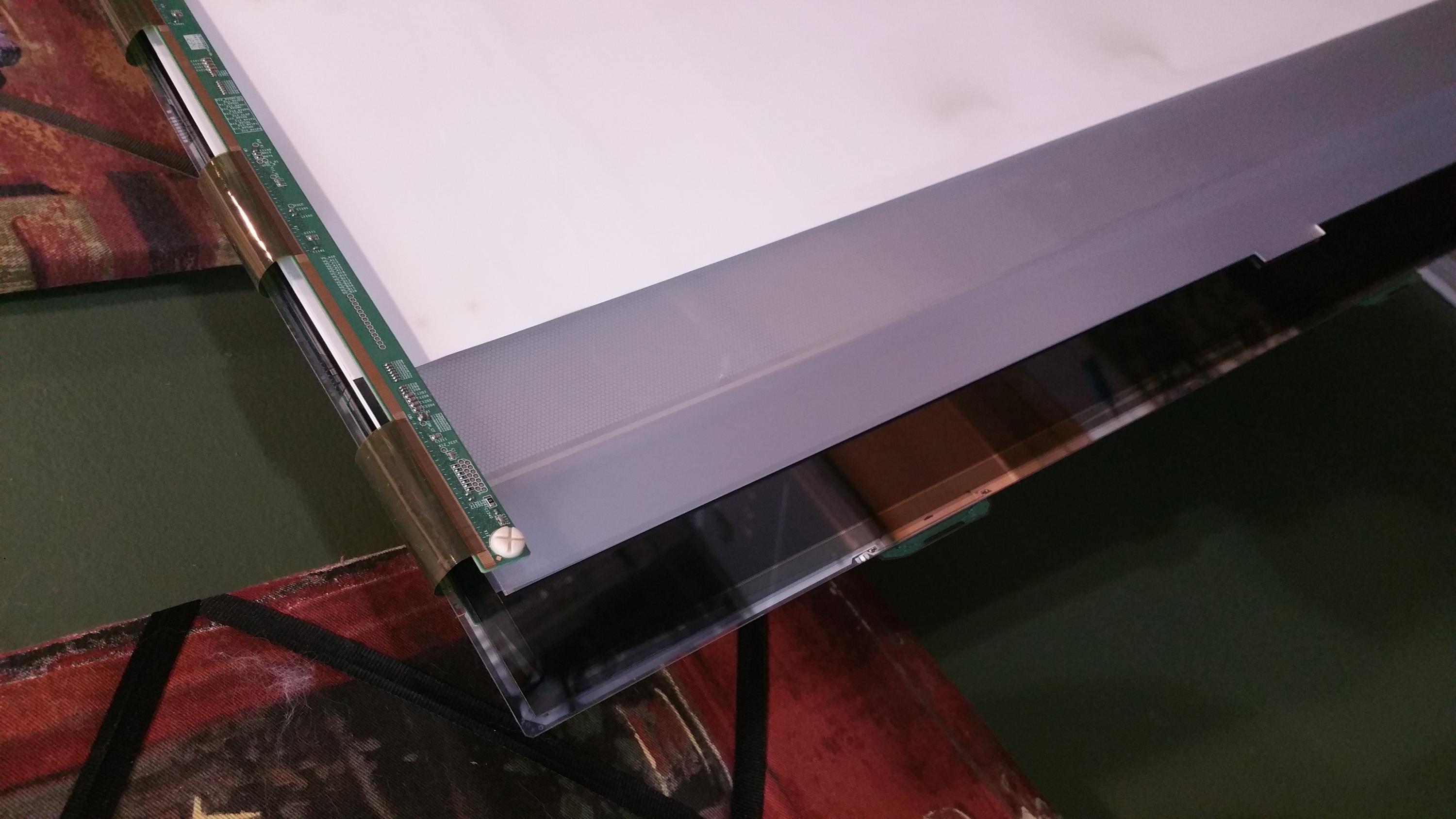

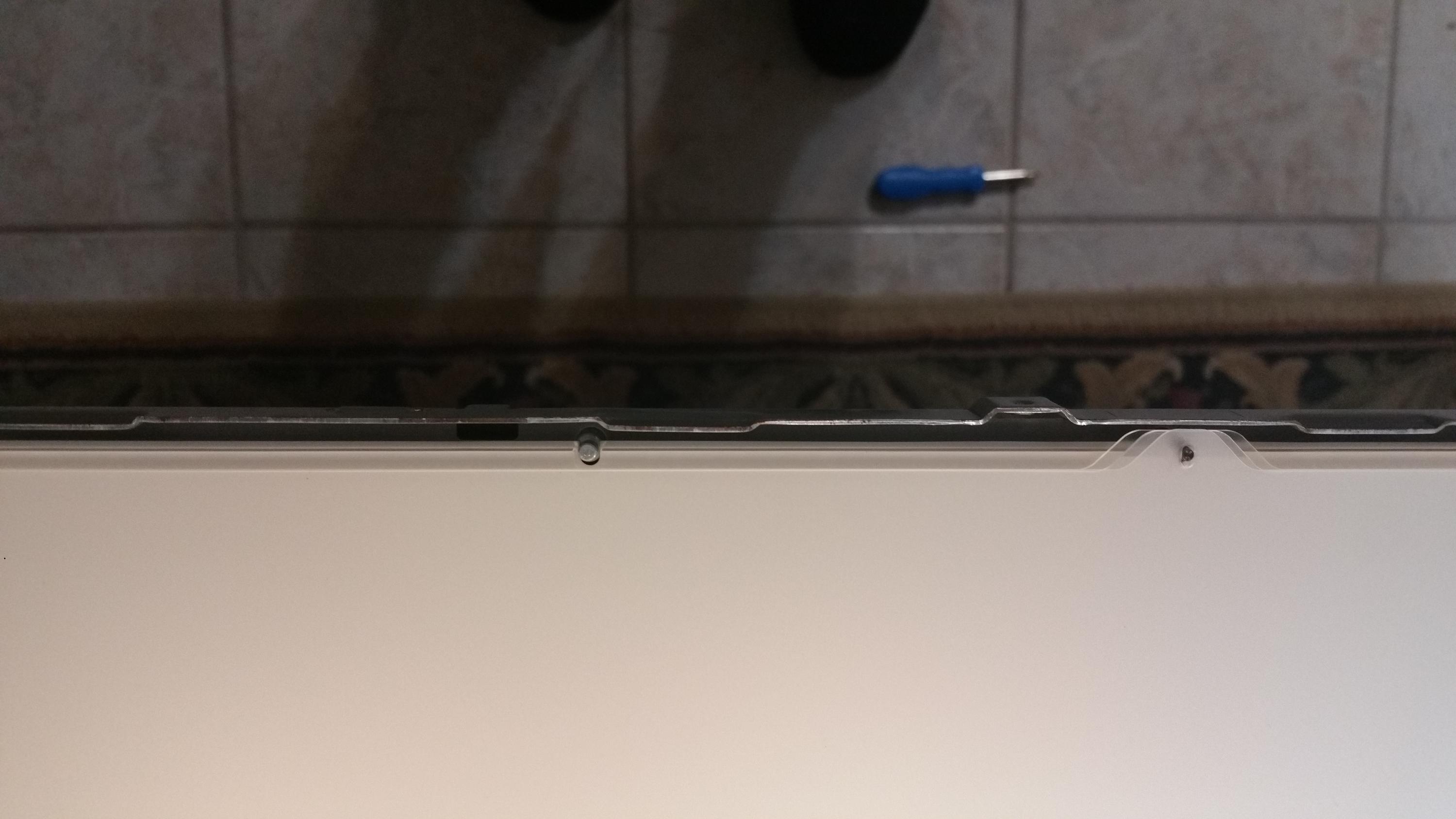

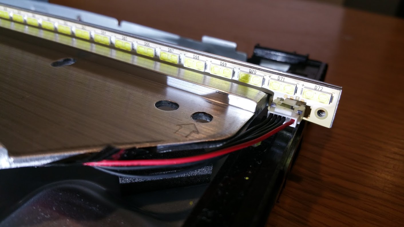

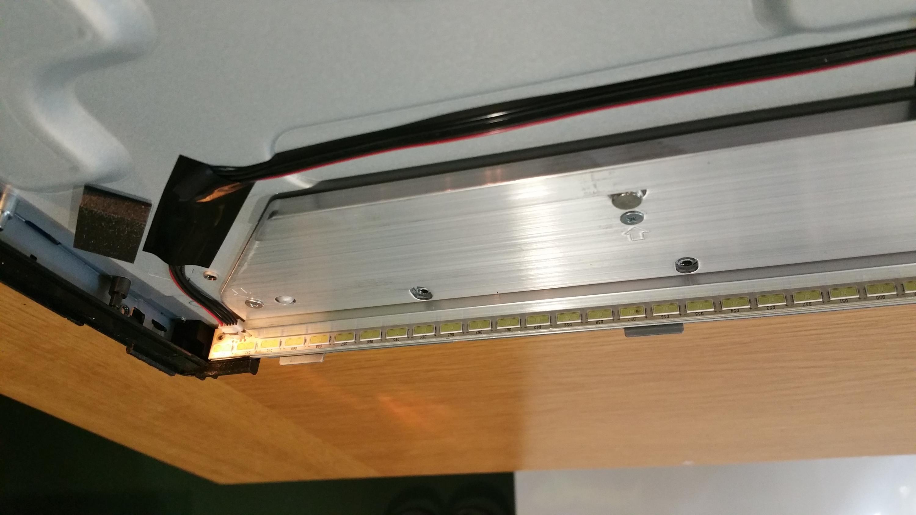

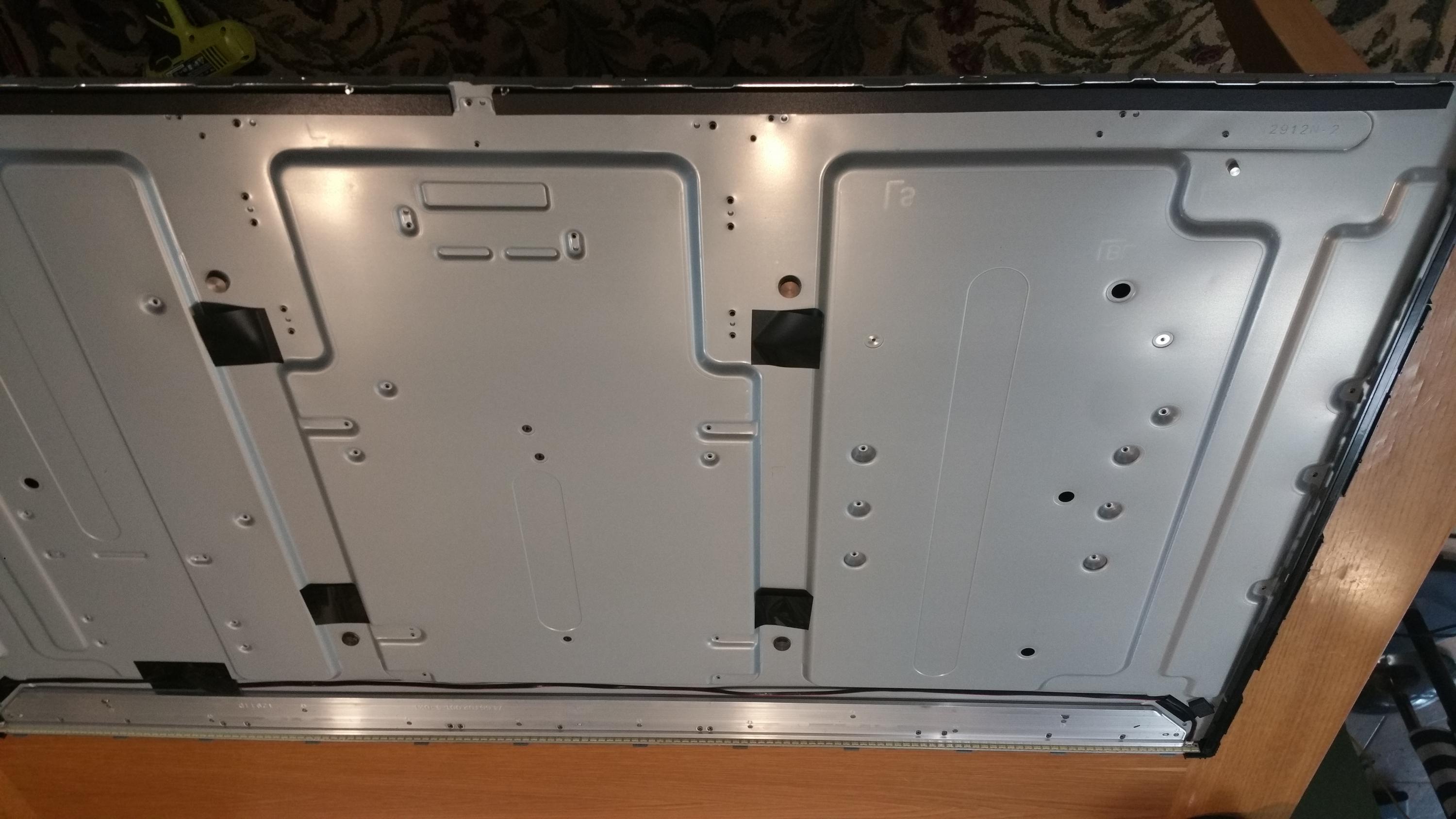

        Omg! I so badly wanted to post a WooHoo and show you I got to the backlights....Instead it's a Whomp..Whomp!!!...there are NO Led backlights????!!!! Pictures attached.

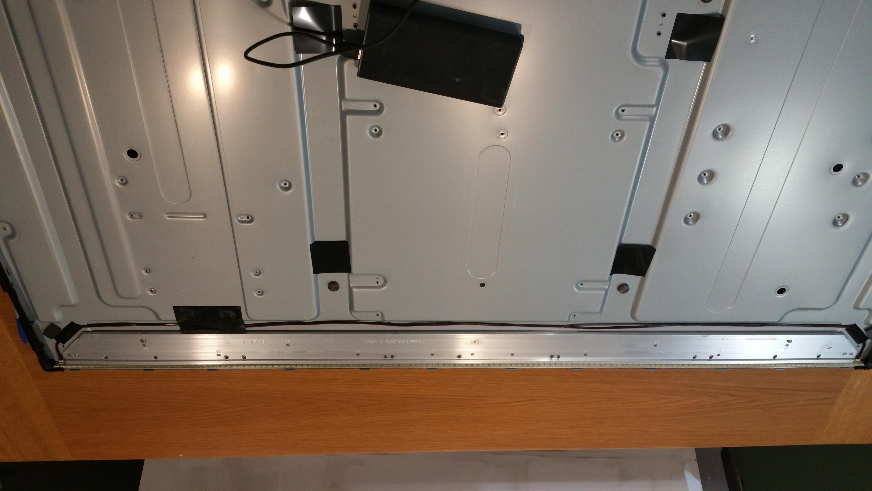

          #64
          Re: Insignia NS-55E480A13A. Backlogs flicker, then black screen.
          Ok, I take it back. There is One long strip on the top of the chassis, there are wires that come from led driver board. Nothing like I've seen in any of the videos though.
            #65
            Edge lit tv.
                      I'm having a hard time finding less like this. They are like double less on each little piece. Is there a name of such an led? I was also wondering, could the whole 55 nch TV just be replaced with any type of edge light that is the same size, like a newer brand or type? Picture of the less is above in post 64.

                          #72
                          LEDs are identified/named by their size in mm. Width first then height.
                          Maybe yours are 7030 but a closer photo of the LEDs would help.
                          Far easier to find the right LED and replace than try to get a strip from another TV to fit, the voltage/current would have to be the same and the connector also.

                              #74
                              Hi everyone! I plugged in the number on the steel bar that holds the leds and voila! I got ebay items coming up that represent the leds!!!
                              74.55T02.001-3-DX1 is on the bar and 551A04 is right on led strip

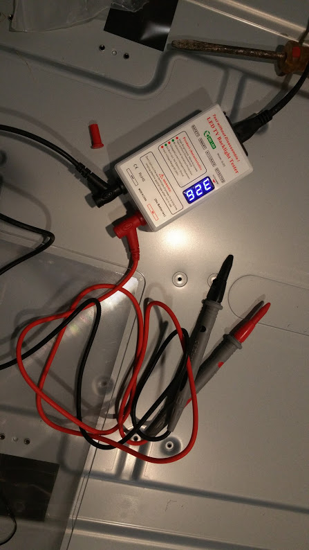

                                #75
                                can anyone tell me how to test this type of strip? I brought an led tester. I see the little dots near the end where the plug is. If it's not plugged into electricity, do I take a chance of ruining them all if I touch the wrong thing? Thanks so much!
                                  #76
                                  I would hook the wires up to the strip and test the strip right at the female LED connector that has the red wire and the bunch of black wires on it.

                                    #77
                                    Thanks budm! Pictures below.
                                      #78
                                      So it has two set of wire with two connectors?
                                      Red probe to Red wire, Black probe to each black wire.
                                        #79
                                        Awesome, that's what I did. Out of the 72 leds, only one is out. Will that short them all out. Is there a way to see all of them on at once with the tester?
