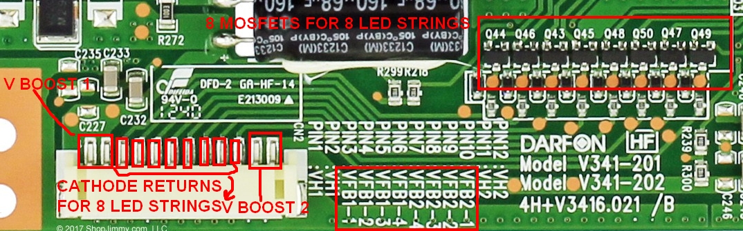

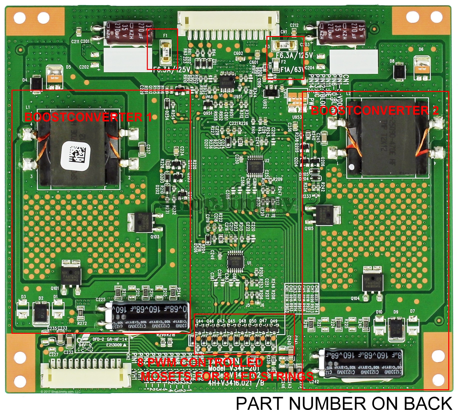

      Insignia/Hitachi/Philips/NEC 55.55T02.D01 LED Driver
      Provided by shopjimmy.
      LCD panel has 8 LEDs strings.
      The LED driver board has two boosconverter circuits, one per set of 4 LED strings.
      There are 8 PWM Controlled MOSFETs (Q44 ~ Q50) for 8 LED strings.
      There are 8 Cathode return pins on the LED connector:
      VFB1-1 ~ VFB1-4 (PIN 3, 4, 5, 6)
      VFB2-4 ~ VFB2-1 (PIN 7, 8, 9, 10)
      1) You will need test the DC V you have on V boost1 and V Boost 2 EVERY TIME you turn on the TV.
      2) You will need to test the DC V on all 8 pins of the Cathode return pins 3 ~10 EVERY TIME you tun on the TV.
      Basically you will be turning TV on and off many times to check all the Voltages on those pins to find out which LED string is bad or which boost converter is bad, that is what I will do.
      BTW, you will see the Voltages change very fast so you must keep the probes connected and keep your eyes on the meter every time you turn on the TV otherwise you will miss the readings.

        Check the resistance between the two ends of the fuse, meter set to 20 Ohms scale (unless your meter has 2 Ohms scale), the reading should be same when you touch the two probes of the meter together.
          #44
          Re: Insignia NS-55E480A13A. Backlogs flicker, then black screen.
          Ok, fuses are good. Your next post...Wow. I've located everything on the board. I think what you are telling me is... Turn on TV and test VB1(which are pins 1&2) and VB2 which are pins 11, 12. Then test first pin(pin 3). Turn tv off. Turn on TV and test VB1 and VB2 again, then test next pin(Pin 4). And so forth down the line. I know how to test the pins, but do I test VB1 pins 1&2 differently? together or separately? What kind of numbers am I looking for? Thank you again!!!!

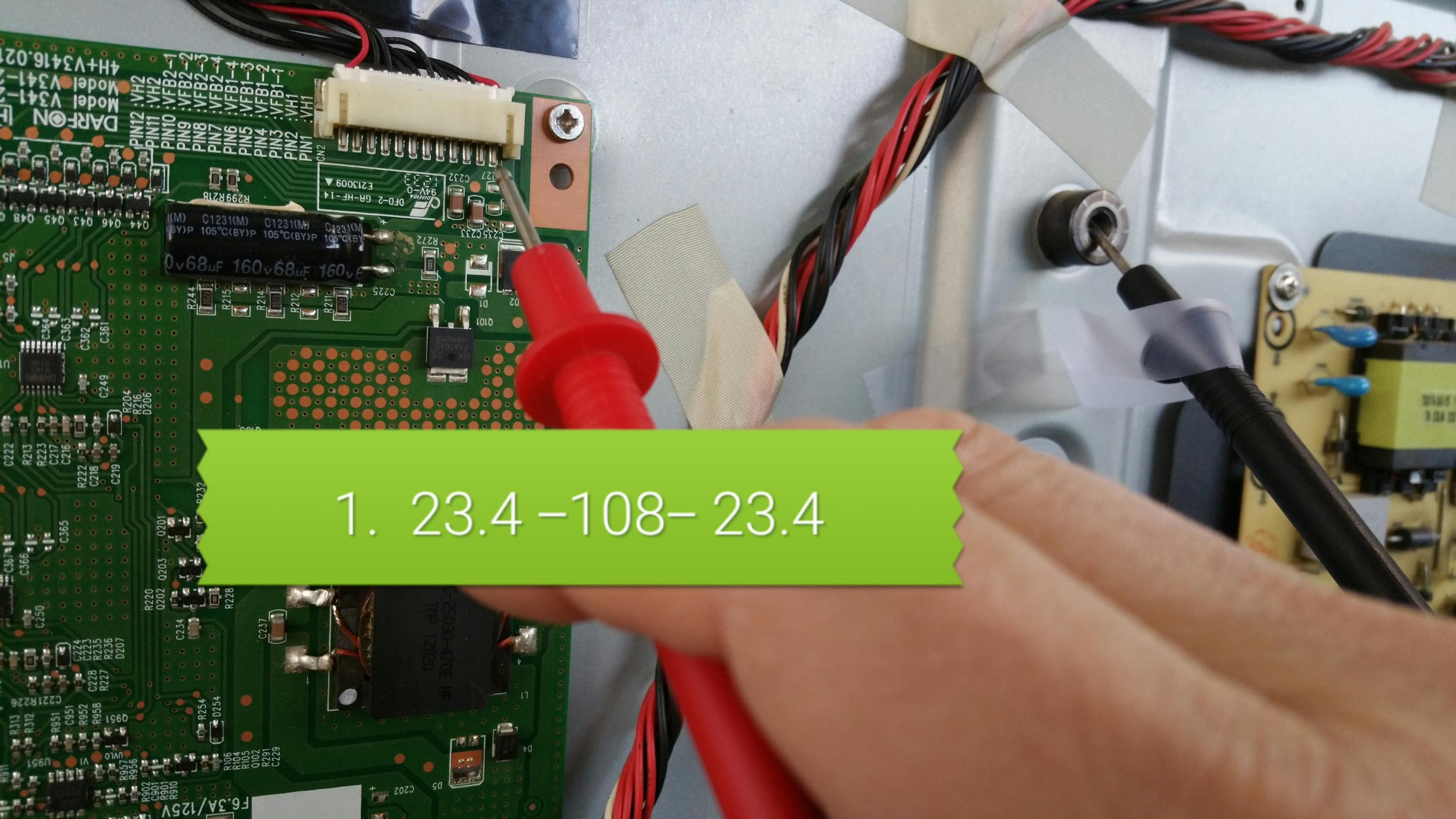

                  Hi!
                  I tested:
                  VB1-
                  Pin 1. 00 - TV ON went to 23.4 on startup. Spiked to 108 when backlights flashed, then back to 23.4

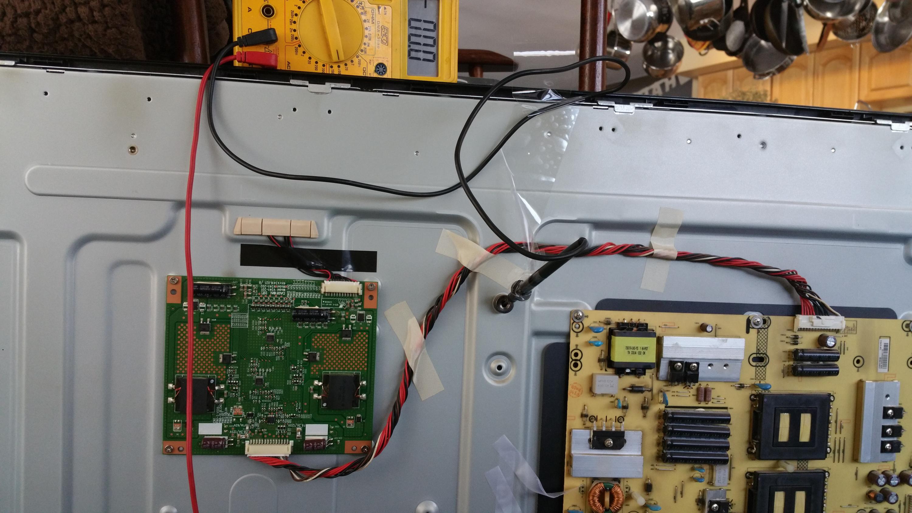

                  Pictures show how I did it for Pin 1 and Pin 12(although photo says Pin 14). Each tested individually while tv was turned on.
                  Hope I did this right! But I have a feeling I should have done more. This is a start though, I hope.

                    It looks like you have problem with those two LED strings.
