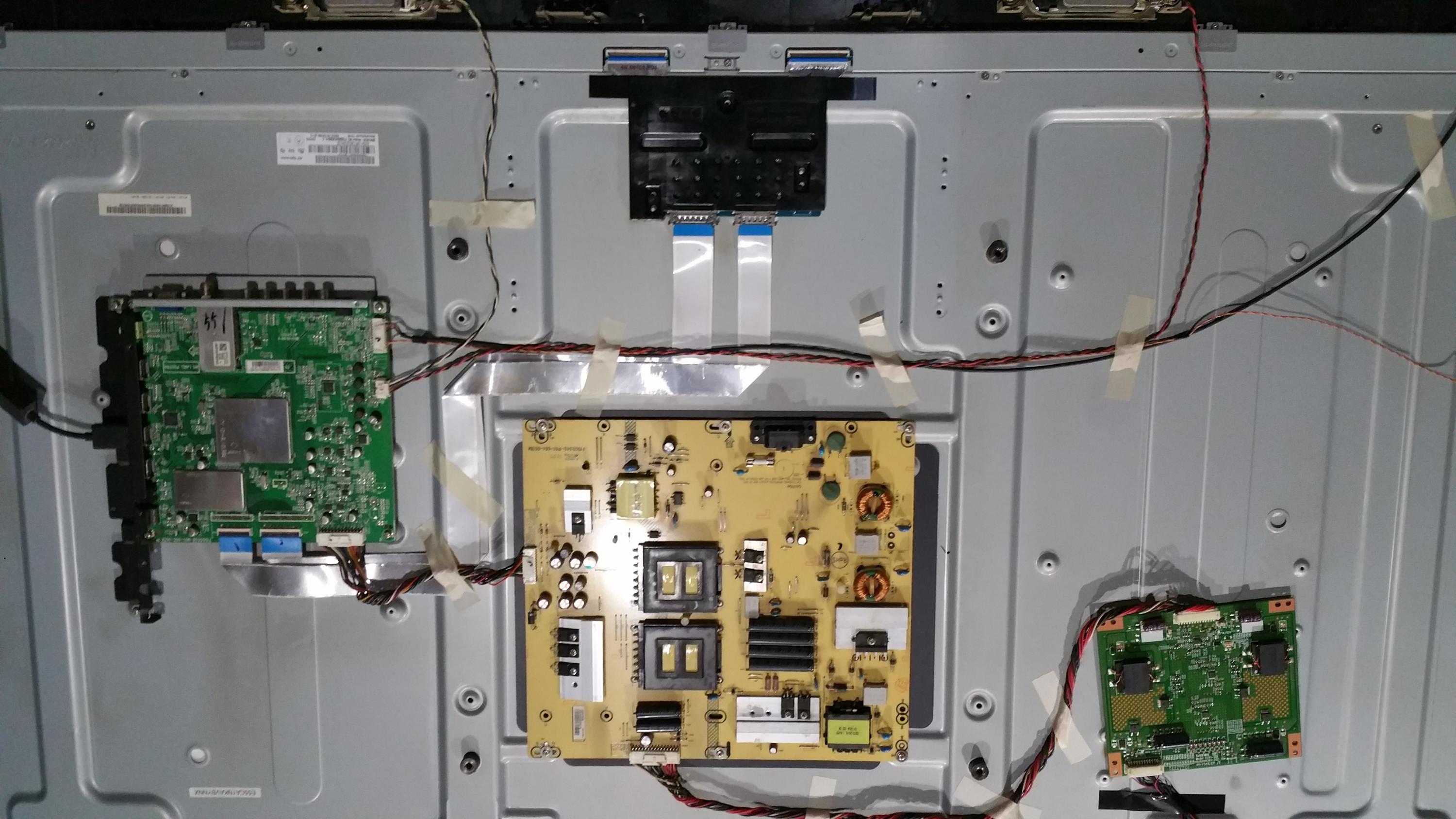

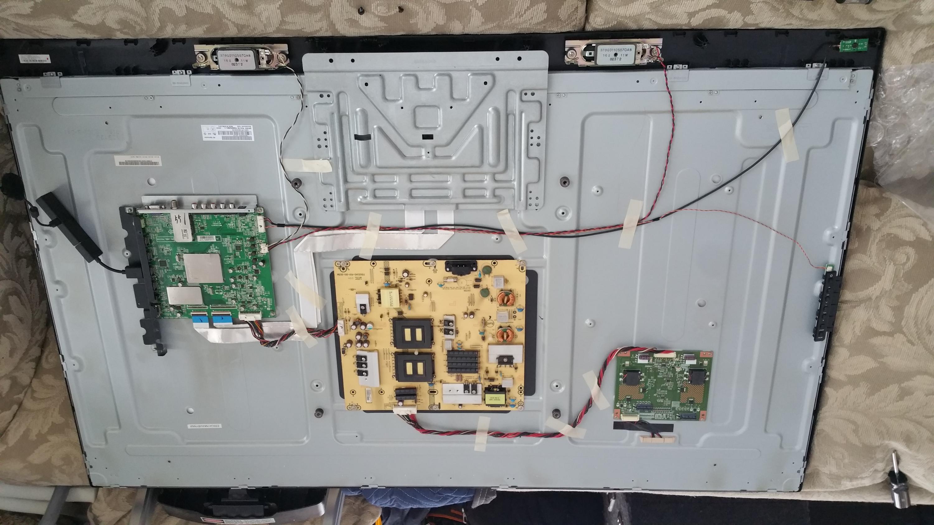

Insignia NS-55E480A13A. Backlogs flicker, then black screen.
  • sameoldsam
    • Mar 2018
    • 58
    Insignia NS-55E480A13A. Backlogs flicker, then black screen. Hi all. Back story...I have this TV, it was my sisters. We tried troubleshooting with Insignia support, with no luck. In May my sister unexpectedly died. I can't bring myself to let go of the Tv. I'm hoping someone can help walk me through the troubleshooting process. I learned and tried the power supply with the voltmeter, they all check out but of course that's if I did it correctly in the first place. I ordered and replaced the lcd driver board since it was the cheapest experiment...no luck. I'm attaching photos of everything, thank you so much for any help! Kathy

    No takers? No one familiar with this television? I just ordered the t-con board. Will try that next. Thanks.

      Hi Kathy, Sorry to hear about your sister. There are if you check's you can run to determine if it's not an LED backlight failure. The right now it sounds like it's pointing to that.
      When the picture goes out have you tried shining a flashlight into the screen to see if you can determine if the image is still operating easiest way to do that would be pressing menu button and look for letters and words
      Btw this tv is a Hisense. Chinese brand. Insignia just rebadged it pretty much. The LED driver board was a good shot at replacement however that sometimes does not cure the problem. We have to make sure that the power supply is commanded to stay on at the PS-ON pin. If it is then we have to look at the back light pin to make sure that that is commanded to stay on.

        Thanks so much for your reply. Love your name...would have suited me well 20 years ago...ok, well 5 years ago! I did try to see if I could find anything on the screen but it didn't look like it when I used a flashlight in the dark. How specifically do I check the ps on and display light on? Is there a thread to direct me too if you don't have time?
        Thank you so much about my sister. Wish I could let this go, I'm guessing if it is the leds then it wouldn't be worth it???

          Lol thanks. I stuck with that name for nearly 20 years now of course now I'm 41 with 3 kids and a wife And mortgaged out the arse.
          Do you have access to a digital volt meter?
          Set it to DC. You wanna check black lead to ground or anywhere on the chassis and red lead to the pin on the power supply that says PS-ON. Keep the voltmeter on this pin while you turn the TV on the pin should go high like 3.3 or 5 V and stay there. Does it or does it back off after the screen goes out

            Check the ON/OFF (bl-on) pin to see if it stays above 2.5V when TV is turned on.

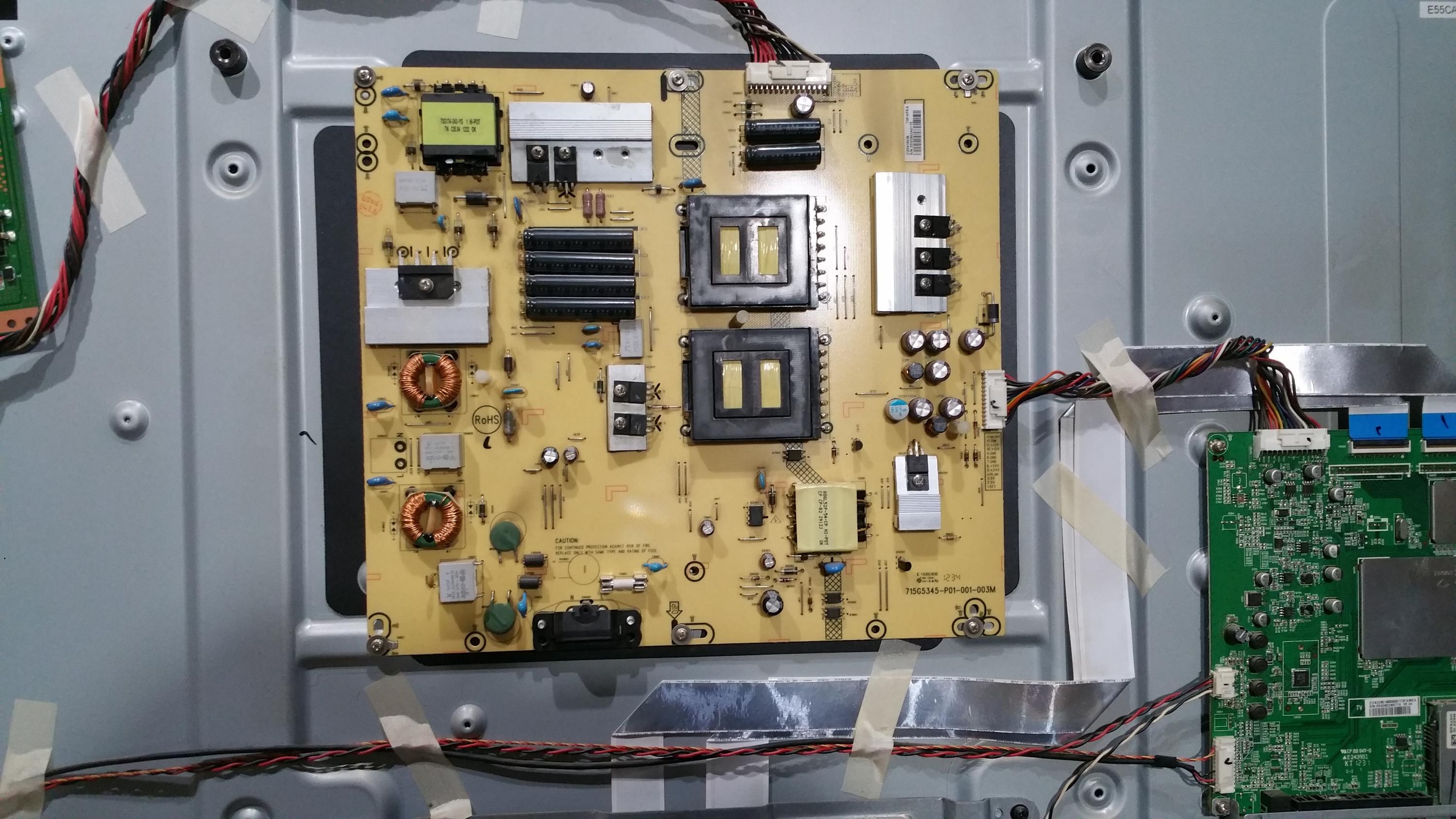

                    Re: Insignia NS-55E480A13A. Backlogs flicker, then black screen.
                    hmmmm....

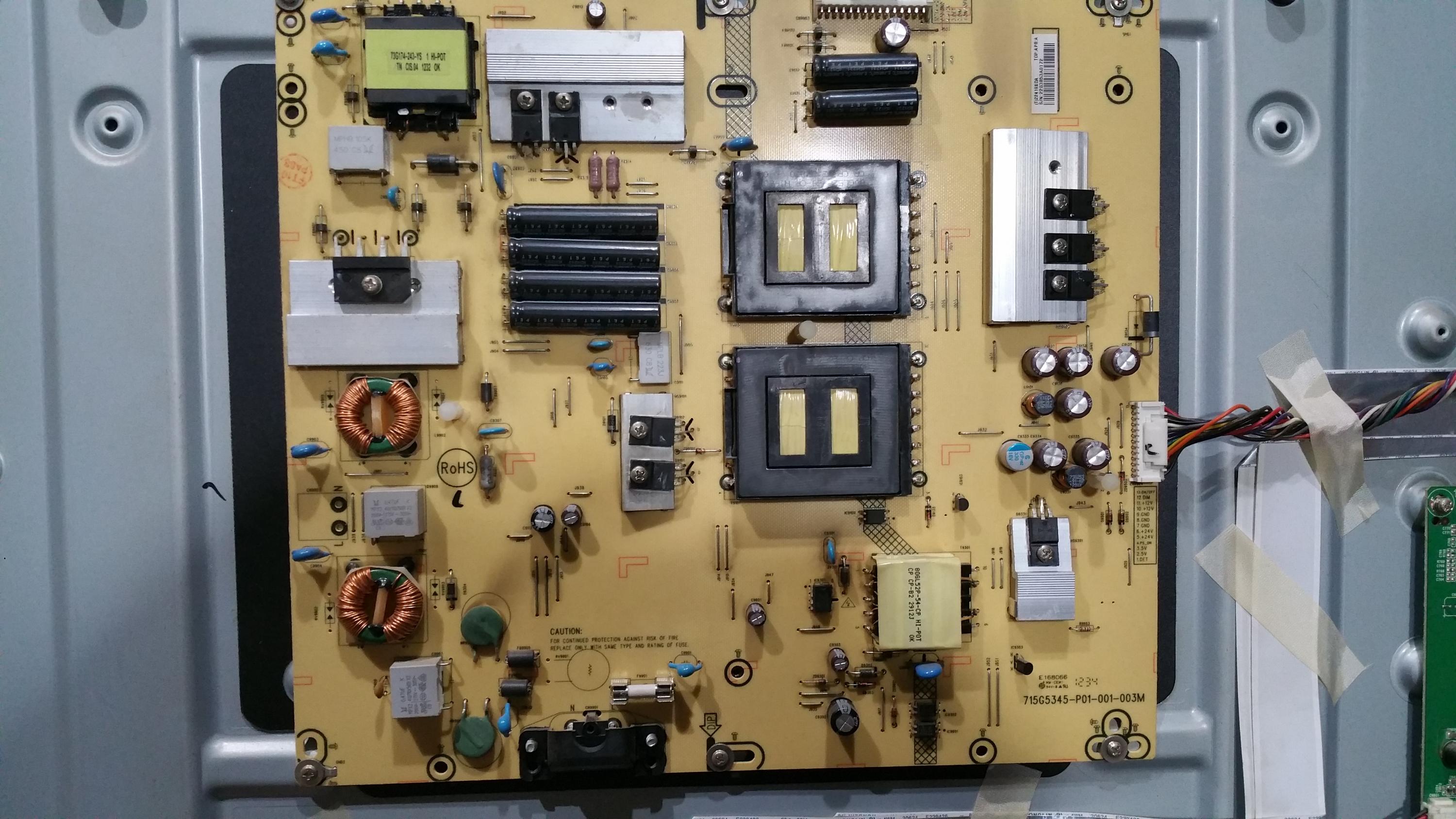

                    Ok, I can't find where the board is marked hot/cold side? If I where to guess, the hot would be where the power goes it...but I don't want to guess. The 2 areas of wires and pins...there is a PS ON #4, there is also a on/off on #13. and the second wire cluster also has an on/off. There is not a BL ON that I can see on either of them. I do have all the photos above in the first post if someone wants to check it out.
                    Much Love,
                    Kathy
                      ON/OFF = BL-ON/OFF for turning the backlights circuit on (0N = >2.5 (TYP.) and off (<1V = OFF).
                      Just do not anything on that power supply board with your hands or body, so at least you should plug the TV into the GFCI outlet.
                        http://www.shopjimmy.com/insignia-ad...upply-unit.htm powersupply pic.
                        • nomoresonys
                          • Jan 2013
                          • 12206
                          • U.S.
                          Check voltages on CN9904 with all boards hooked up and tv powered on, list the name and expected voltage and the actual voltage you get right beside it, there's 13 pins, black lead to ground/bare metal back of tv etc. red meter lead to pin, just like in the video, on this board you can measure the pins from back of connector to get a reading, meter set on 20 volts dc.

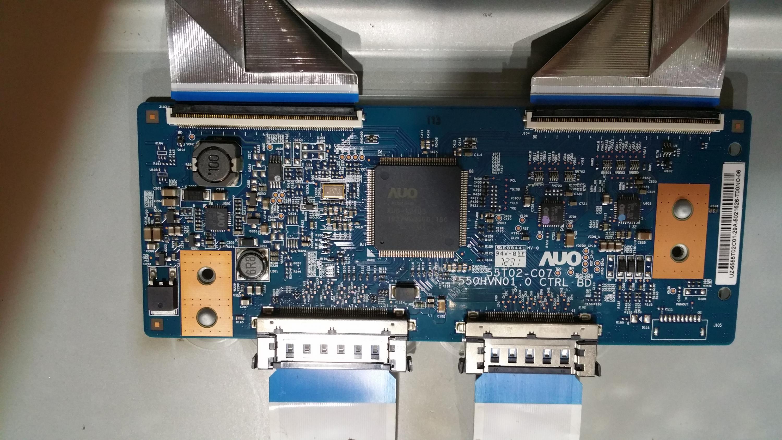

                              ok, this might be a stupid question, but...the tcon and driver board have a cover on them. Are they a 'ground' of some sort? Do they need to be attached to test the power supply or can I do the testing with power on and those backs off?
                              Videos show testing the driver board with it off, but the board is on the power supply and not separated.
                              • nomoresonys
                                • Jan 2013
                                • 12206
                                • U.S.
                                Sure take them off.

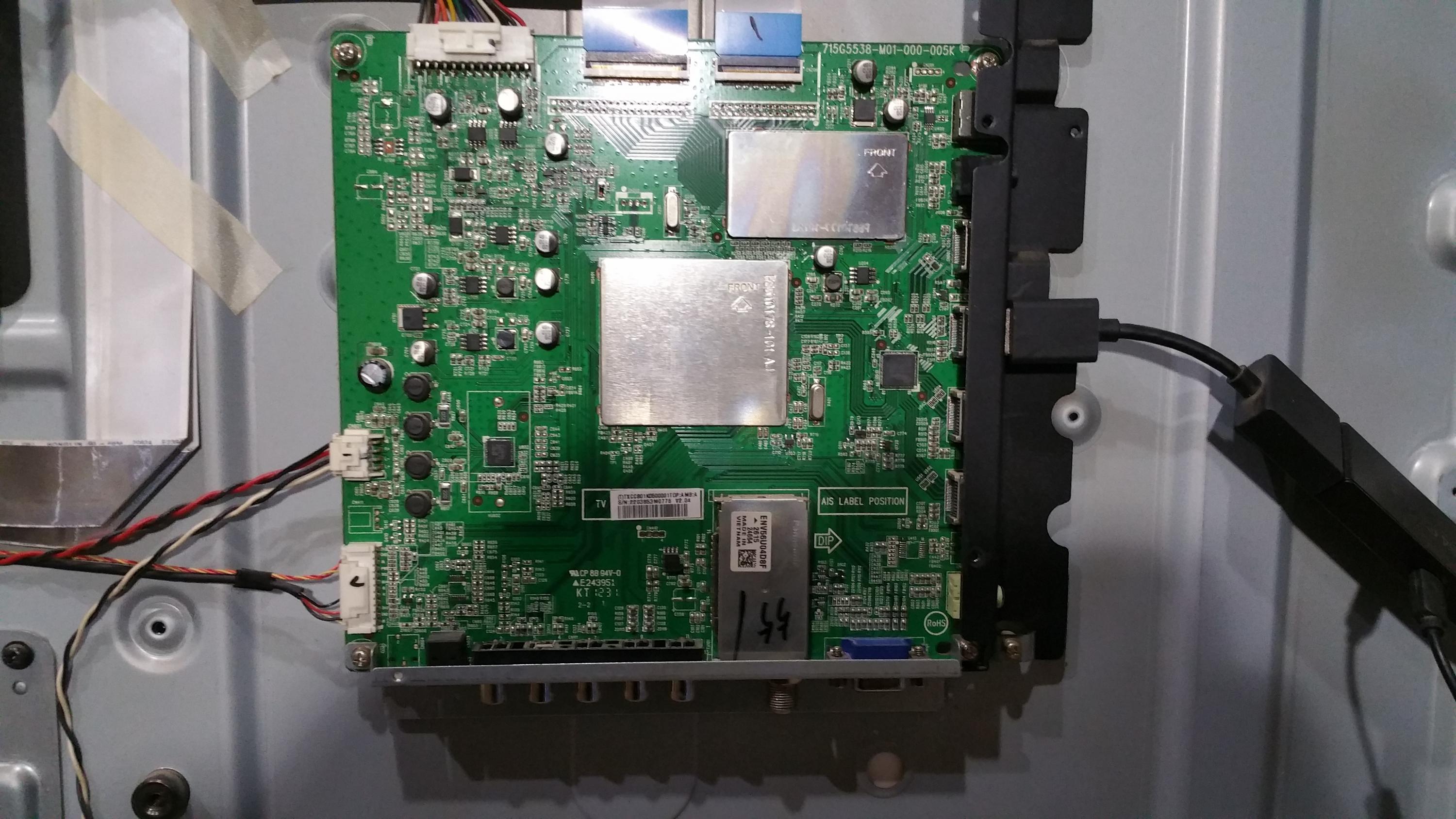

                                  To Main Board:
                                  1.DET 0
                                  2. 5V 5.3
                                  3. 5V 5.3
                                  4. PS_ON 2.62
                                  5. 24V 23.6
                                  6. 24V 23.6
                                  7-9 GRD
                                  10. 12V 23.6
                                  11. 12V 23.6
                                  12. DIM 2.1
                                  13. ON/OFF 2.8

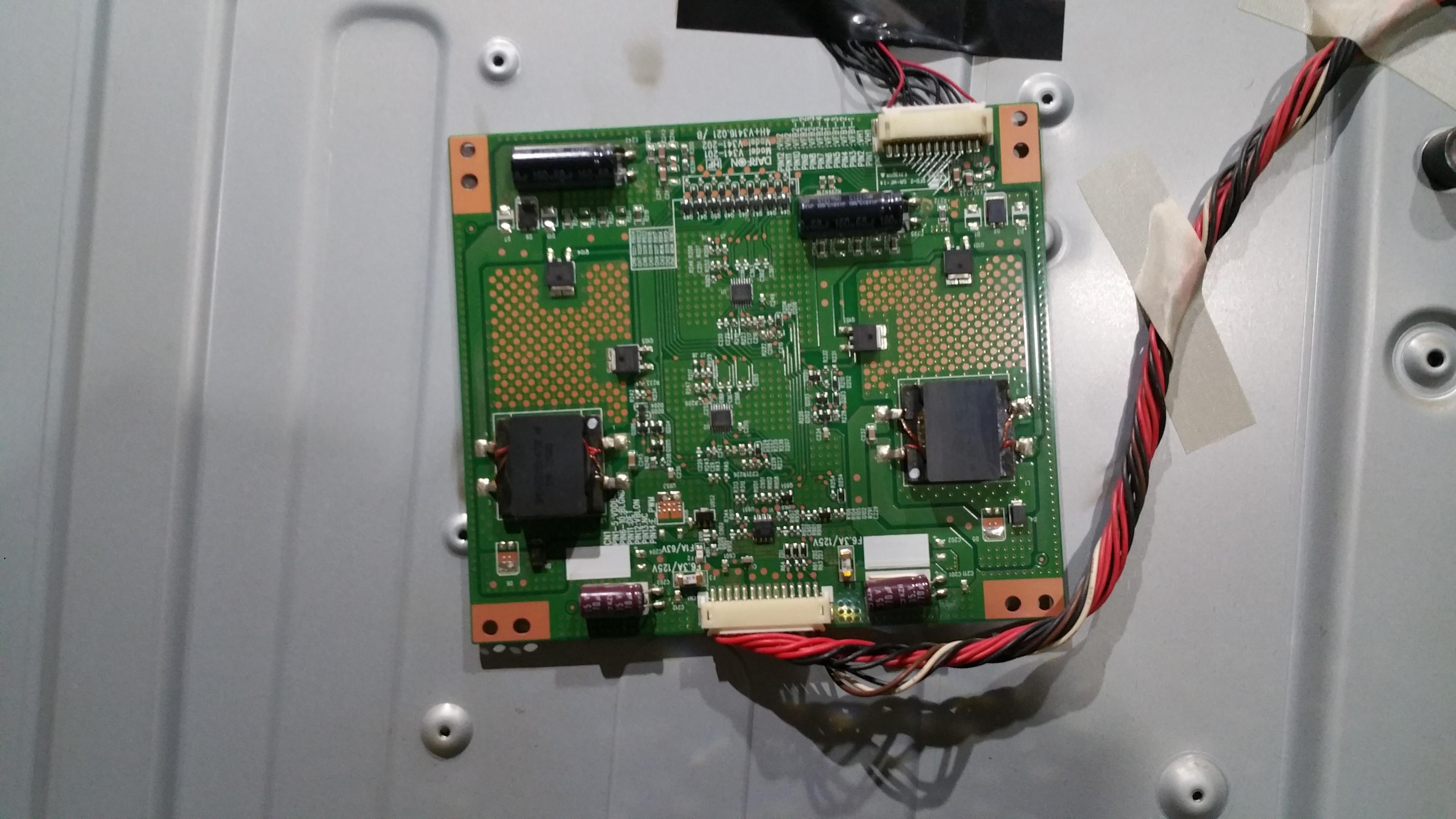

                                  To LED Driver Board (the original one)
                                  1. ON/OFF 2.8
                                  2. DIM 2.1
                                  3. DET 0
                                  4. 12V 11.6
                                  5-9 GRD
                                  10. 24V 23.9
                                  11. 24V 23.9
                                  12. 24V 23.9
                                  13. 24V 23.9
                                  14. 24V 0 reads -23.9 on the Driver Boards matching pin

                                    I only see a cover on your t-con, you can test those other boards before the t-con, it kinda looks like a led backlight issue, I'd do the test in the video in post # 14 first, led backlight failure is prevalent in led tvs.
                                    • nomoresonys
                                      • Jan 2013
                                      • 12206
                                      • U.S.
                                      Very nice job on those readings and listing them, see how he's testing the LED driver board? that will let you know if there's a problem with the LED driver board or a led backlight problem.
                                      • nomoresonys

                                        On 14 did you mix up your meter leads when measuring?
