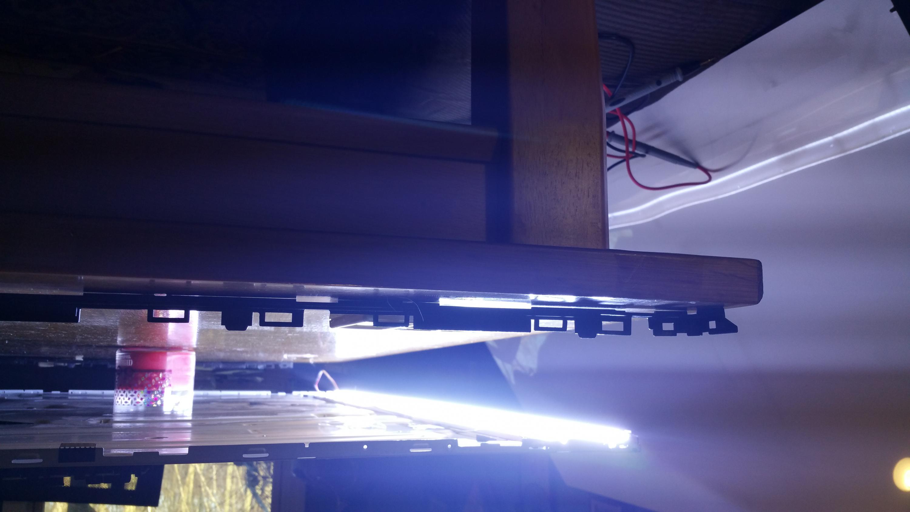

Insignia NS-55E480A13A. Backlogs flicker, then black screen.

      #82
      Re: Insignia NS-55E480A13A. Backlogs flicker, then black screen.
      Well I did test it, they all went on, but how do I test them for 20 minutes?? ...especially since I'm going to have to strip the TV down again anyway. Also thinking I should change out the other side of the edge lighting too, even though they all work. What do you think?

          #84
          Thanks nomoresonys, I did, just gotta strip her again. Not giving up. does anyone know how to do what budm suggested to test them for 15 minutes or so? I can't imagine that means to stand there holding the probes on those tiny wires for 15 minutes.

                  #88
                  Can I hook up ONLY the power supply and video driver board to the LEDs to test, or do I have to hook up all boards..t-con, motherboard, video and power? I could just try it but I don't wont to short anything out so I thought to ask you all first.

                    #89
                    I went with hooking everything up except the t-con board since panel is not there anyway. All LED are lit...So Bright! Will let it run for 20 minutes and report back. Although I probably won't be able to see again for awhile.

                      #90
                      Went off after 11 minutes. Ran it again, went off after 14 minutes. No LEDs seemed to get weaker, flicker or turn off ahead of that. Will watch closer this time to see if one goes off right when it shuts down.
                      Edit: Ran a third time, 14 minutes to shut down. Again, no flicker, dim down or individual led that went out.

                        #91
                        Not sure, maybe something is overheating and shutting it down, wonder if it could be a built in protection on account it isn't fully assembled but then again it wouldn't even turn on for you when you put it back together right?

                            #93
                            Status is now when assembled backlights pop on for a second then go off, then with all but tcon connected, backlights stay on for about 14 minutes then shut off.
                              #94
                              When I test the backlights I run the power supply board by itself and force on with pull up resistors if the power supply/LED driver board does not have them. If you do the test with all the boards connected but without LCD glass panel connected then you need to provide video signal otherwise the TV will go into standby mode when it does not detect video signal for period of time.
                              BTW, some TV will not come on without T-CON board connected.

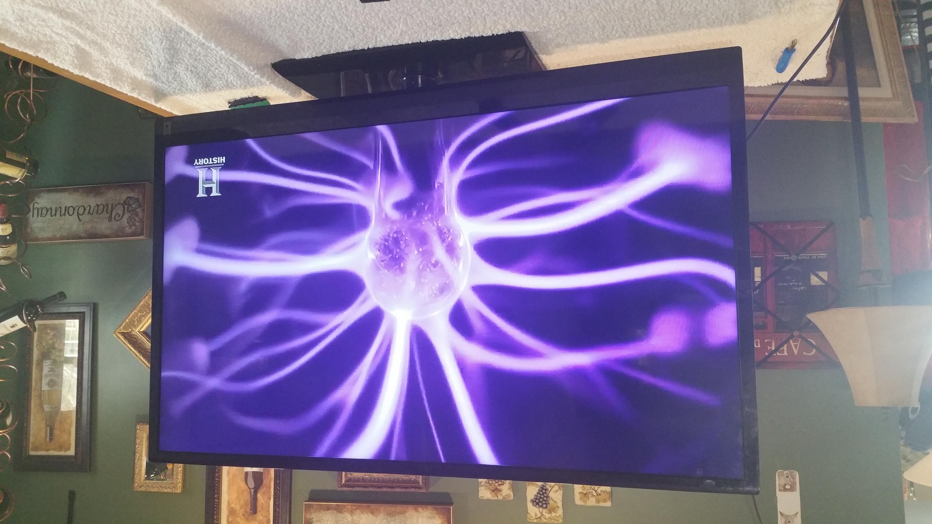

                                  #96
                                  Great, ok, so I will hook up T-con board and then plug cable into the main board, then let it run.
                                  • sameoldsam
                                    • Mar 2018
                                    • 58
                                    #97
                                    So everything is hooked up again, including a cable box. I got sound, which I had, and I have a backlight tv screen. I do not have a picture, and I can no longer pull up the menu. I tried the cable box with the cable cord and with the hdmi cord, same result. I'm guessing it's something I'm doing wrong but I don't know what.
                                    EDIT: It was something easy... a ribbon on tcon board! IT WORKS!

                                        #99
                                        I don't even know how to Thank You All for your help!!! Thank you especially budm and nomoresonys for your expertise and sticking with me to the end! THANK YOU!!
                                        XOXO XOXO. Photo attached, my sister would be so proud!
