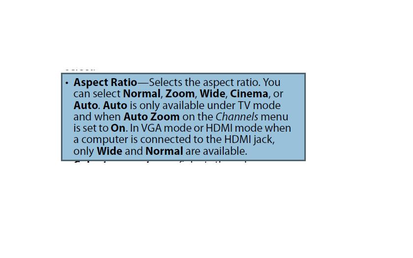

    Anyone know the process to get into the Insignia NS-L322Q-NA service menu? I cannot turn off over-scan while watching the satellite. A lot of the picture is missing.
    Re: Insignia service menu
    Do you have the remote to change the Image setting, I.E. ZOOM, FULL, 4:3, etc.
    • Jackching
      • May 2017
      • 127
      Yes i scrolled through the different sizes but wide is the closest setting. Overscan is turned on by default in the menu and it wont let me turn it off.
      • R_J
        • Jun 2012
        • 9625
        Have you checked the setting in the satellite reciever, maybe the output can be changed there.
        • Jackching
          • May 2017
          • 127
          yes i went through all the settings on the bell receiver also. Say if i go to my roku stick, the tv lets me turn off over-scan then and the video is fine. Soon as i go back to satellite, over-scan is greyed out again.
          • R_J
            • Jun 2012
            • 9625
            which inputs are they conncted to? Likely the hdmi input is the one that the overscan is greyed out. Did this just happen or has it always been this way? I see there is a format button on the bell remote and one of the settings is stretch (stretches the image and makes it wider)
            • budwich
              • Jul 2015
              • 3097
              if you look at the bell sat when you change channels, there is an indication of what the sat receiver has been set for in terms of aspect ratio for both SD and HD channels. "page up" and "page down" on the remote allows the user to cycle the appropriate settings for either SD or HD depending on the channel being watch. People (me) sometimes cause problems when "paging" thru the guide and this results in "inadvertent" changes of the aspect.
