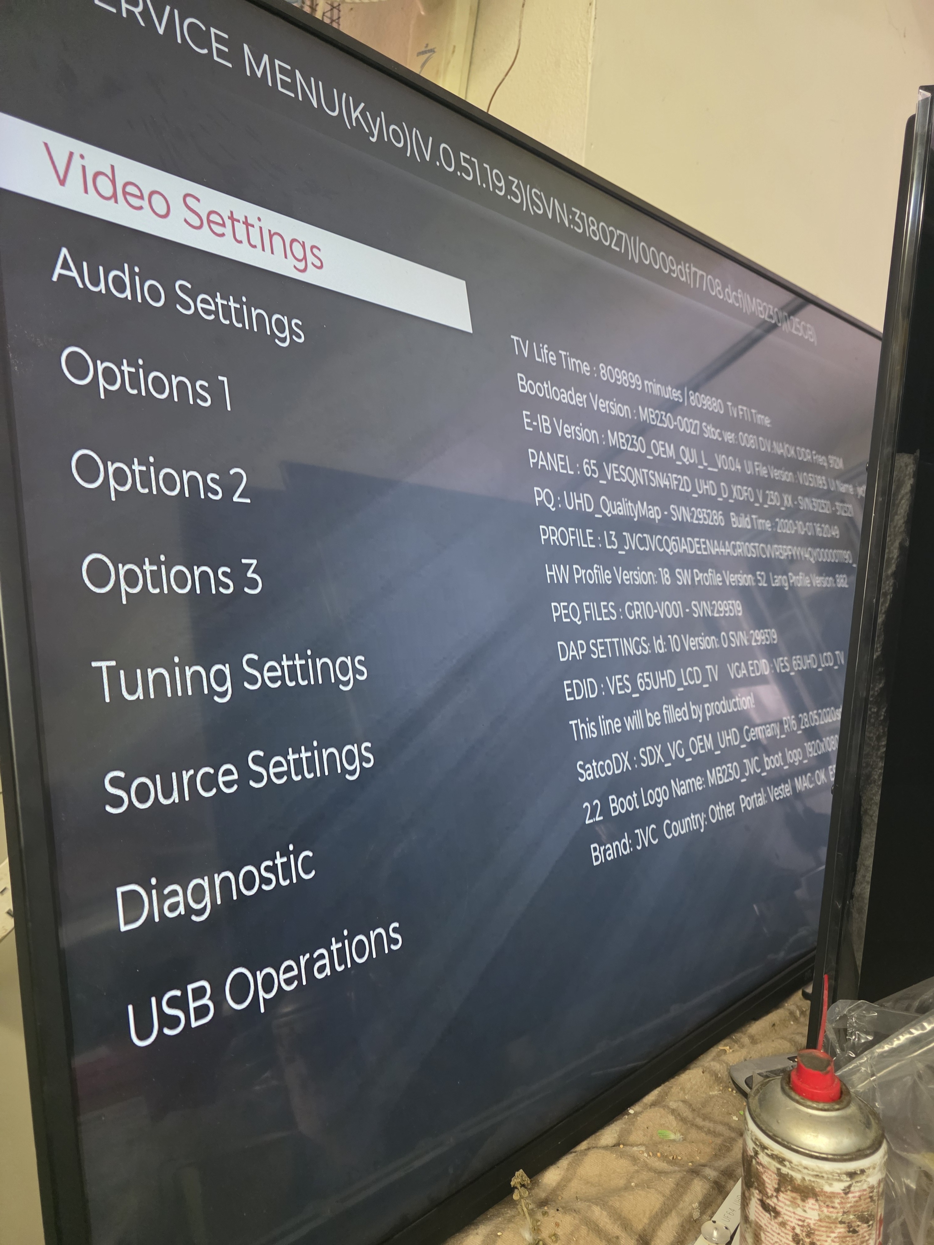

    I have just replaced led set of this vestel tv due to age. Click image for larger version
    I would like to reduce backlight from service mode. I have tried menu 4725 but in the menu i can't change anything.
    Any help pls? I don't want to change from electronics inverter feedback resistor ideally.
    Thanks again.
  • Diah
    • Feb 2013
    • 6500
    you can only put high value SMD R synce R at the BL circuit which located at the back side of PSU close to the BL socket
