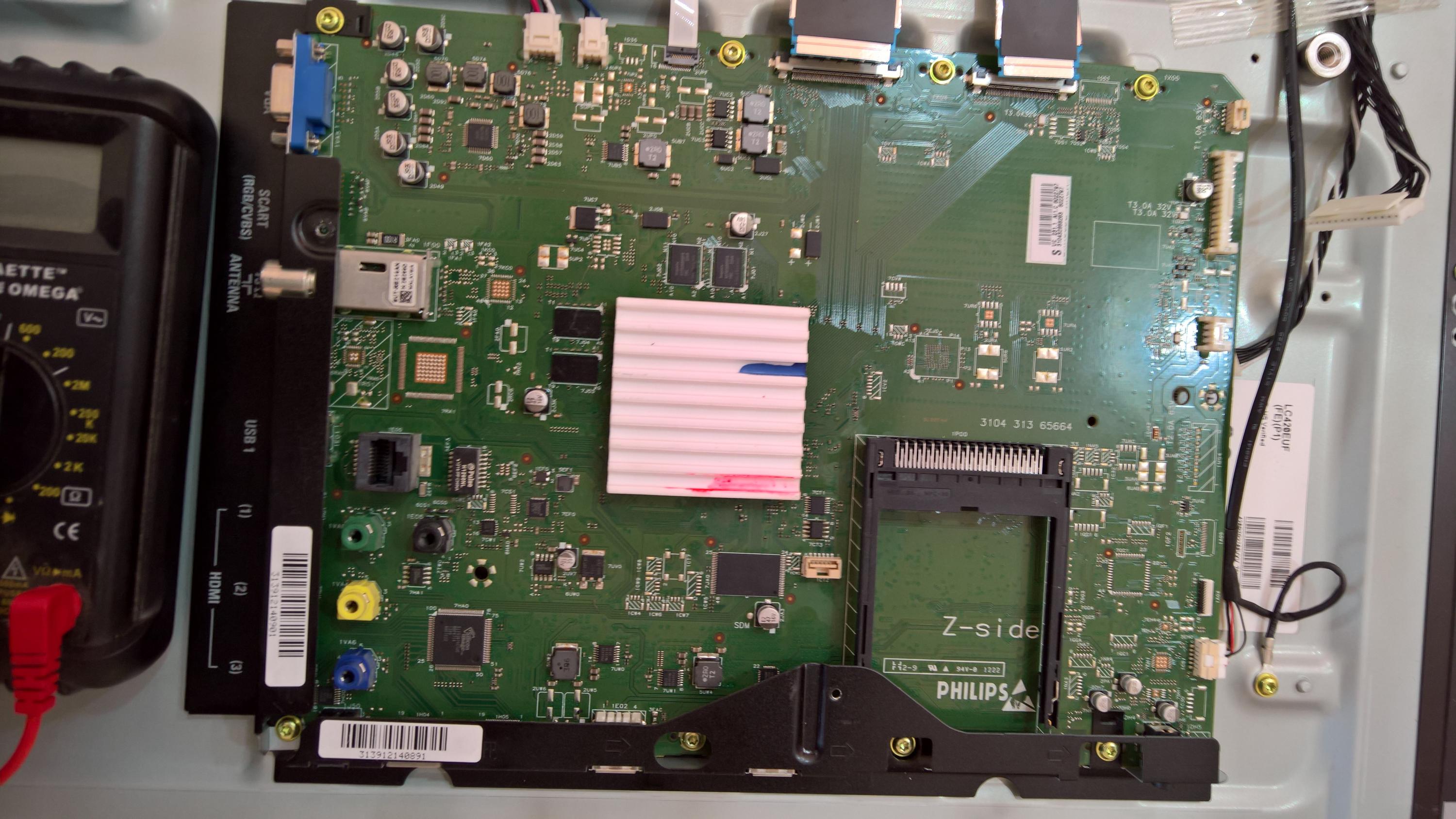

    hi all, a m8 got this tv that was working fine till some days ago when suddenly it wont turn on.
    if he press remote control to turn on, the red light on tv blink, but nothing happens.
    if he left tv on its own, the red led start blinking twice.
    hre is some picture of mainboard inside that looks like new... no bad component spotted.
    any help would be good
    edit: ive done some measurement and on a component on green pc board, i got 5 volt for 1 second when psu board emitted one high tone noise, and then that 5 volt went down after that seconds. that things repeat every 30-60 minute. didnt measured the interval time exactly, but keep doing like this.

    Cacchio ho dovuto leggere 5 volte per capire che m8=mate!! Mannaggia..
    Why that mate gave it to you? It was already defective?
    If i'm right theese boards suffers from software problems, i have a 6008 series with a similar fault, you better solder 2 wires to the SDM solder place on mainboard and on a GND spot then join those together , switch on the current and the tv , watch the SDM mode led pulsing, and after download service manual to know what's the error, long blinks are decimals, short are units, ex. 5long 3 short means 53.
    If you have 53 much probably software error, you need to find a way to upgrade it, serv. man. tells you several recovery modes on how to begin update.

      tnx for reply. problem is that tv doesnt seems to get 5 volts. when there is a memory problem i see philips logo should pop up on tv, while here is totally dead....
      edit: strange thing as i said is that on the marked red zone in picture if i put multimeter for measure volts, it is 0 volt..... then after a bit it goes to -0.4 (negative volts) volt for some seconds, then to 5 volt (positive this time) and then back to 0 volt.
      why that - 0.4 volt ?

        That zone is for audio output VS internal loudspeakers, i repeat if you want to hear me (old scurengion.. =-) you have to enter SDM mode..

          post an edited picture of the shorted wire i have to do....

            There's no need of a picture, watch yours, on the center bottom zone there's an electrolytic cap, on top of it the big flash memory, on the side of it the SDM place clearly visible, for the GND place you can peel the wire and wrap it around a screw for board fixing.

              tnx, now i found it. so i have to solder a wire to that smd and one to gnd, and then connect them so smd is shorted. after that power on tv and read code ?

                Yes, SDM not SMD... or to be more safe use only a wire from SDM to the chassis screw..

                  tnx very much for reply. soldering done and the result is an error code 53
                  what's next ?

                    So you only get led blinks and no audio/video?
                    As my last sentence on post #2, check the serv. man. for instruction on various recovery modes for upgrading it. I never tested them with mine...
