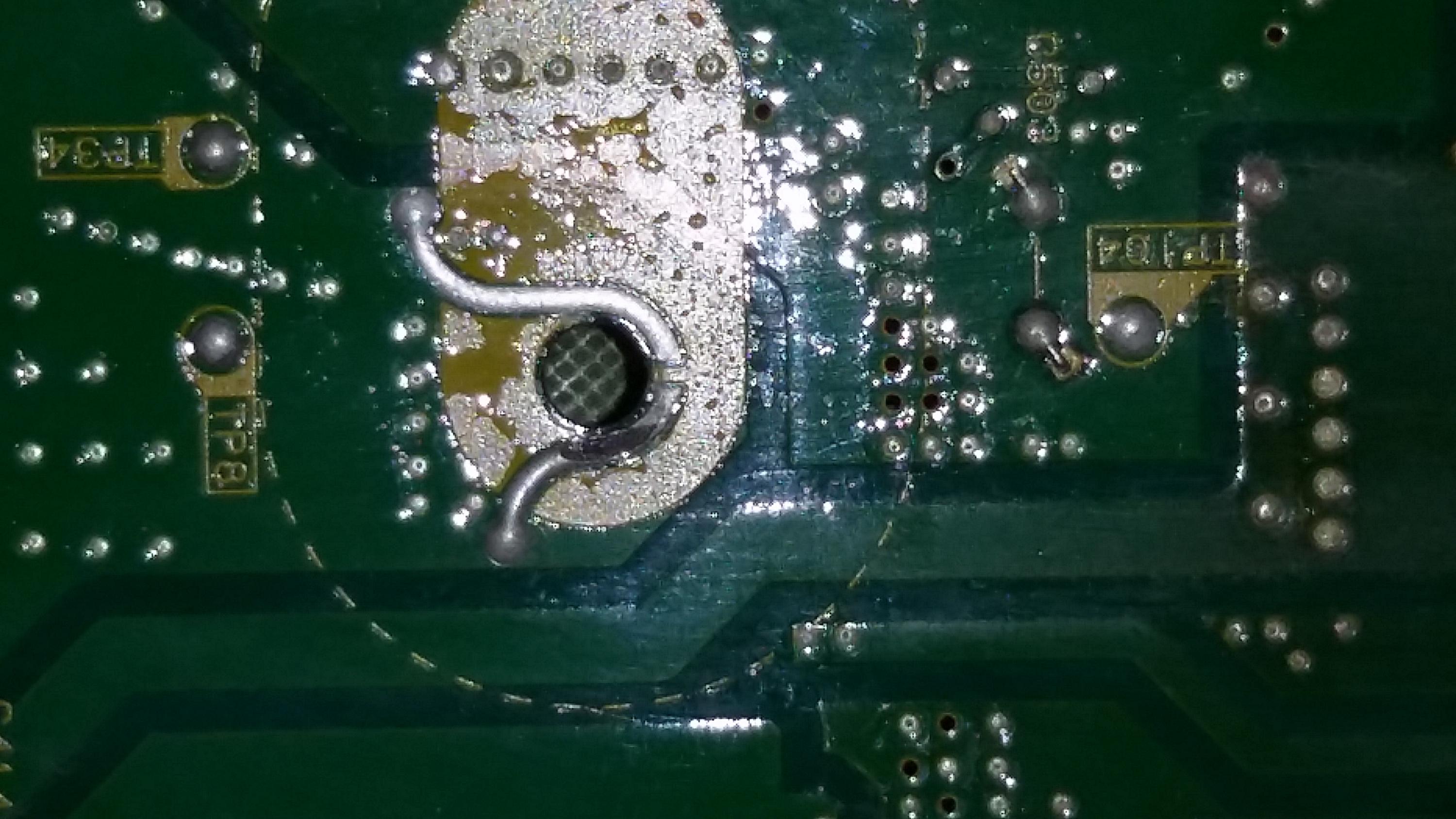

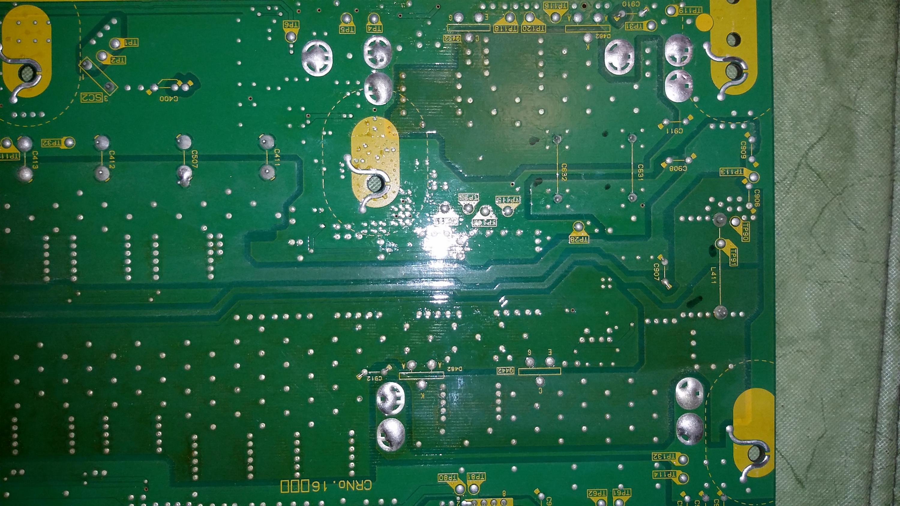

        Re: whole new repair / learning world... plasma! Yikes!
        took the board off. pictures show some of the contacts on the bottom side have issues. Top side looks OK. My question is shouldn't most of the "contact surface" be from the screw thread contact area? The "stand off" mount "dimple" is a coated surface which meets at those "dark areas" so I wouldn't expect it to be a good point of contact... should be this be sanded to a good metal look on that mount surface?
        • budwich
          • Jul 2015
          • 3097
          #44
          looking at the surface closer, it appears to be somewhat like "aluminum oxide"... kind like the thing that happens with aluminum electrical wiring when it mates with the wrong type of switches. I have likely sanded them clean to ensure better contact.
          It doesn't appear that I can get the components locally so its "off to china".... slow boat here I come.... that's ok as I probably have to "shelf" the project for a while.
          Thanks for all the help on this. I hope it is ultimately successful and will post the outcome when and if I get there.
            what type of screws hold this board down the older type or the newer upgraded ones.
            • budwich
              • Jul 2015
              • 3097
              #46
              not sure what the difference is but the screws have an "integrated washer header"... meaning the screw head has its main body and then there is a wider metal rim. It is certainly not the type that the shopjimmy kit has which has a washer and spring associated with the screw.
              • freakaftr8
                • Oct 2012
                • 3743
                #47
                Shop Jimmy screws are more tailor to trying to keep the board locked down. Floating grounds are all about these boards. This is a number one failure of sustain boards in Panasonic's.
                When I repair a sustained board I usually take out all the screws wire brush and. If I'm at work where I own a machine shop I put them on a screwdriver in wire wheel the hell out of them to clean them all up. A few times I've used blue loctite on the screw threads. I'm not sure if this helps or not, However I've noticed on a few repairs that the screw holes feel definitely loose. On a few of those I went down to the hardware store in but coarse threaded screws with loch washers. Any of the scenarios I haven't heard of a problem arising as of yet over the last 4 years
                  i will probably add some star washers that will hopefully help with both lock down and contact to the track.

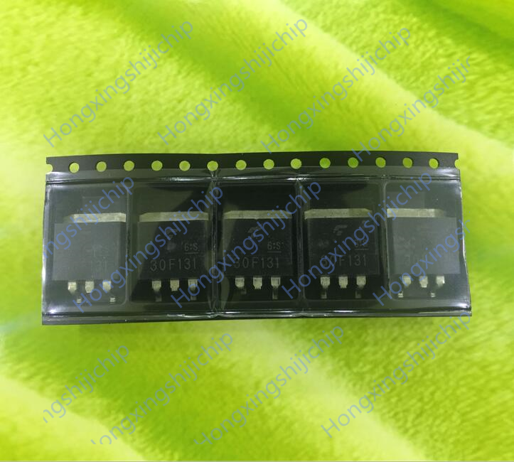

                    You need to watch out what components you buy. Dont buy the 30F131/RJP30H2A from china unless you want some fireworks.
                    FGD4536TM , there are some fakes on the market also so i hope you get the good ones.
                    On this particular board the DG301/302 fail also. It measures good on the outside but interal is still damaged.
                    Also the 2 small ic's on the board are usually dead. IC501 out of my head......
                      oh oh.... that's not fun. i need to look closer..... hmmmm.
                      this is what I order...
                      "NEW TOSHIBA GT30F131 30F131 TO-263 MOSFET" from china... doesn't appear to align with your "code warning"... I figured the "toshiba" would hopefully be a good sign.
                        I doubt you get the original ones. We will see what happens.
                        http://4.bp.blogspot.com/-z7bycQ_nfH...600/pana05.jpg
                        BD8693FVM. That's the control IC.
                        3Y (SMD Code) is a CPH5524-TL-E
                        Replace RJP30H2A and 30F131 for FGD4536TM
                        There is a long thread about the fake 30F131 on this forum.
                          thanks again, will look at those IC's in question. They don't appear in the shopjimmy kit / help for the sc card (or mentioned) so hopefully although maybe a common failure, they are OK.... this tv isn't going toward anyone so I can "redo" if necessary. If they are bad, will they take out other components "again". Will they generate any sort of "flash code" that points at them if / once the set is powered up after the other repairs.
                          attached is a picture of the igbts... hard to tell anything... I will see I guess.
