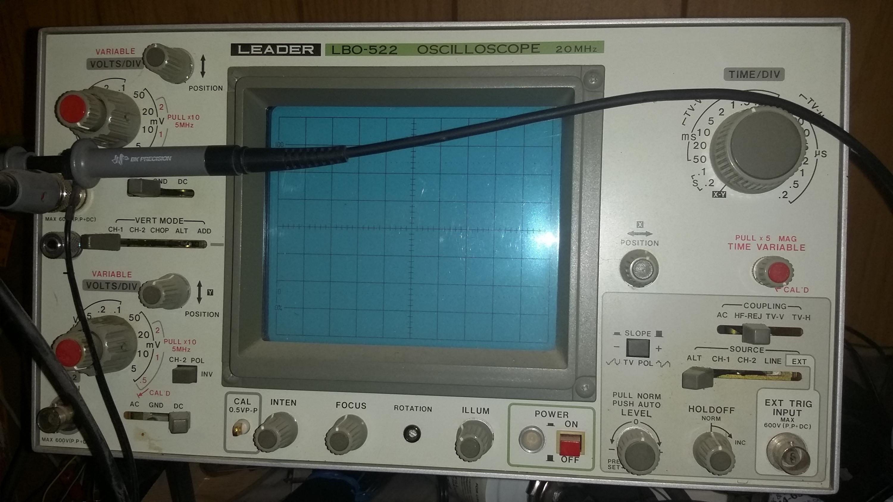

        well, the friend got the scope working... maybe. Its an old leader LBO522 20mhz scope. Hopefully, that has enough response what I need. He didn't do anything to get it working other than leave it plugged in and turned on for a while... so something needs to warm up somewhere. Anyways, its what I can use.
        Suggestions as to where to start probing? There is only one probe at this point.

          Re: whole new repair / learning world... plasma! Yikes!
          Show me what scope you got...also I'm not budm

            #125
            oops... sorry tom66... watching to many threads... :-)
            here is a face plate picture.

                    I think your scope may struggle with the task at hand. What probes do you have with it?

                      :-( while it is what is. Only one probe (friend thought he had another... but not yet). It a switchable 1/10X BK probe.

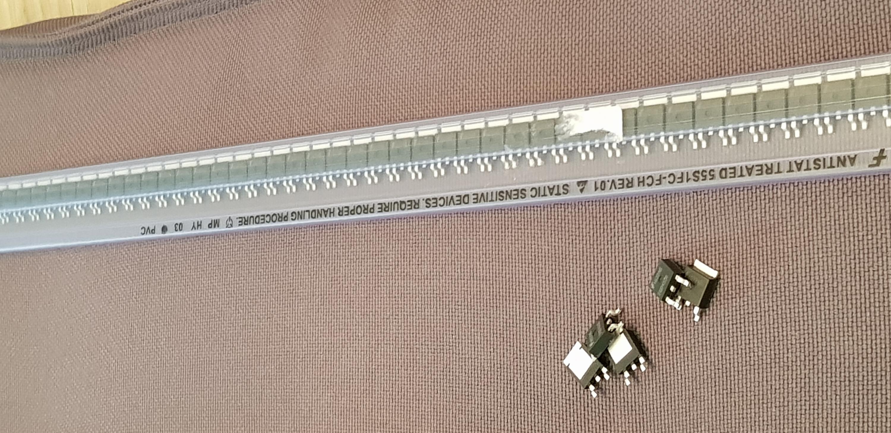

                                  Could you please take a decent picture of the FGD4536TM that you are using ? All those bangs are definately not good for the sc board.
                                    Here is a shot of the one that I had removed that were still "good" (ie. they didn't physically blow apart). As I mentioned, I did see a working picture for about 5 minutes before some of these blew up. Currently, I have placed some 30f131 on the board (are they "real"... who knows but they "operated" with the little "igbt" tester that was suggested on the forum).
                                    Anyways, I removed Q501 as it was indeed shorted on the PNP side. these little suckers are no fun soldering in place. I checked all the other CPH5524-TL-E's and they appear to be ok and similar in readings. I haven't given the board another try yet as I am "praying to the electronic gods" that I get one step further without taking more components out... :-)
                                    don't see an "rn1008" on the ss board... is it a igbt type device? I see a rcj330.... ?

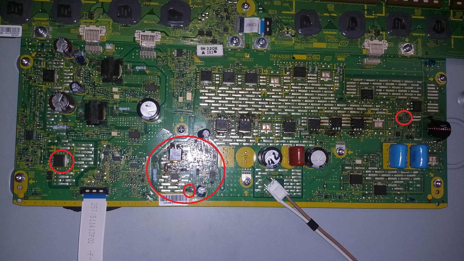

                                      #138
                                      So i read through the whole thread.
                                      Im almost certain that you used fake parts in the beginning of the repair. Which is not your fault but real 30F131/RJP30H2A are very hard to find.
                                      For repairs we use the FGD4536TM but unfortunately there are also fakes on ebay for this replacement part.
                                      The result is that your board literally blows up because the replacement parts cant handle the load.
                                      If you used the right parts your board would not blow but it would give a blinking code.
                                      See the attachment.
                                      RJP63G4 top left , is it short? Measure in diode mode for shorts.
                                      You did not replace the IC501 + small transistor top right on the board? ( See circle )
                                      This is the reason you dont see a light coming up and if this part fails you also get 6 blinks. After the first short this IC usually survives but you tried it a few times and im 100% sure it is dead.
                                      DG302 probably wont read short but can also result in 6 blink , it is best to replace those after so many bangs.
                                      RF1501 only reads short with shorted fets. If you have the original , use that 1 again , same for DAF30.
                                      Im 100% sure you used fake parts because the 1ohm resistor + diode and other parts in that area blew up. I learned this the hard way also.

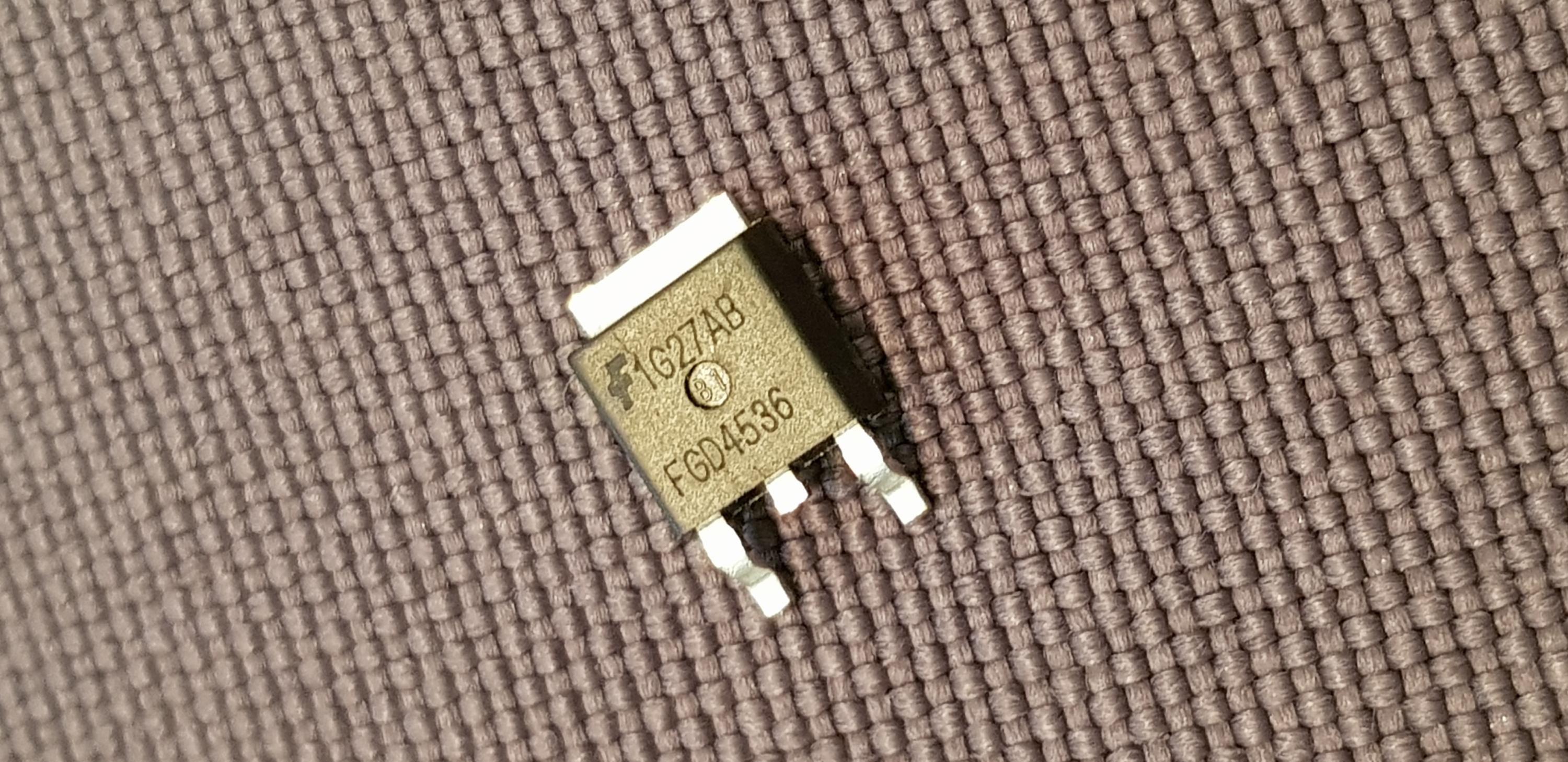

                                        #139
                                        Your FGD4536TM dont look original to me.
                                        Originals have a small hole in the middle , these are my FGD4536TM.
                                        Also , you cant wash the logo of the part. When you clean it with alcohol the logo must be very clear.
                                        check my pictures!
                                          "holy mackeral"... :-)... yep mine don't have those "forge marks" although the "alcohol test" did seem OK.
                                          you said: "You did not replace the IC501 + small transistor top right on the board? ( See circle ) "
                                          I did check all of the "small transistor arrays" after I found the Q501 shorted. All others appear ok in terms of metering including the one you indicate.
                                          Is there any on board check for IC501... I hate these small devices (in terms of desoldering / soldering) plus I am not sure I have a replacement at this point.
                                          I have to check the other things that you suggested as I haven't rechecked them after subsequent failures although I do check the FETs/iBGTs to see if they have shorted.
                                          you said "This is the reason you dont see a light coming up "... I do see the led on the board light for about 1-2 seconds before it extinquishes and the 6 flash code shows up.
