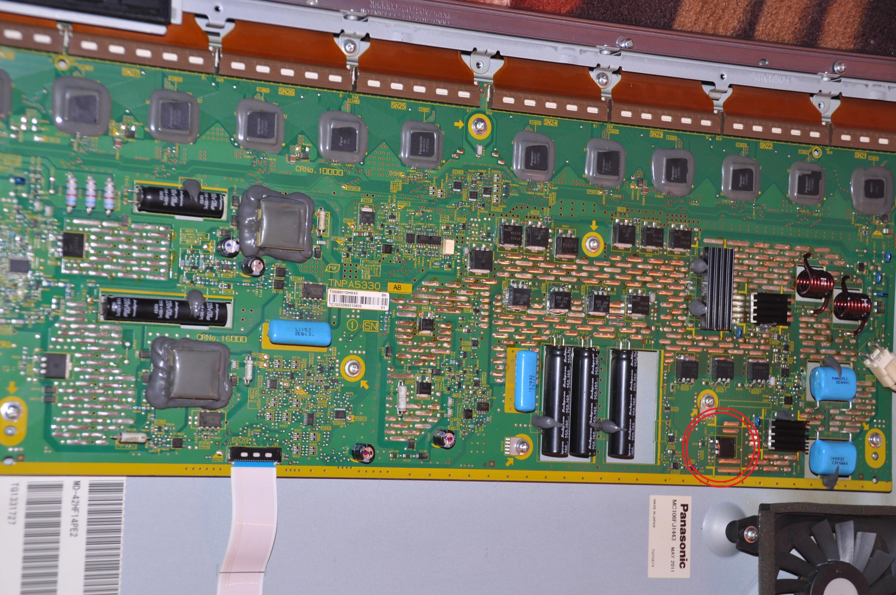

    thanks...
    not sure if I can re-use the old / originals diodes as my "removal" effort might have been "rough" on the body / legs of those... will check or at least compare old to new measurements.
    I checked Q661 once any / all components that I could find that were shorted were removed. It appears to be good on the diode scale and resistance checks.
    I have to track down some form of 1ohm resistor as I don't have anything that low but hopefully locally will have some non-smd types available. Thanks for this as my "eye guess" wasn't close.

      #82
      Re: whole new repair / learning world... plasma! Yikes!
      I did a check of the diode packs that were replaced and compared to the old. The forward bias voltage on the RFN10 is slightly different. The old is .48v ish while the new is .52v ish. I have a couple other "new"... one reads .48 and while another reads .52. Not sure that would make much difference as the spec indicates .98 max. The rf1501's all (old and new) read .42v.
        Should be fine. On that resistor in question yes it is a2.2ohm resistor SmD type. It can use a standars type half watt resistor if you want.
          2.2? Mine measures 1 OHM and it is rated as 1RO ?
          I got a european board , might be different then american/canadian boards.
            Ah my apologies. You are correct. It is 1 ohm. I was looking at a different reference.
              I was doing general checks while waiting on parts along with following the 60st30 repair thread. I just noticed the during my one attempt at powering that one of the feed resistors of the one blown 4536 is also "broke"... :-( will probably just use a regular resistor instead of an smd as the one track was originally damaged during the FET removal.
              Checks of the other boards (SC,SD) show no shorts, so I am hoping that basically if and when I get the SU board up and running, things will be happy.
