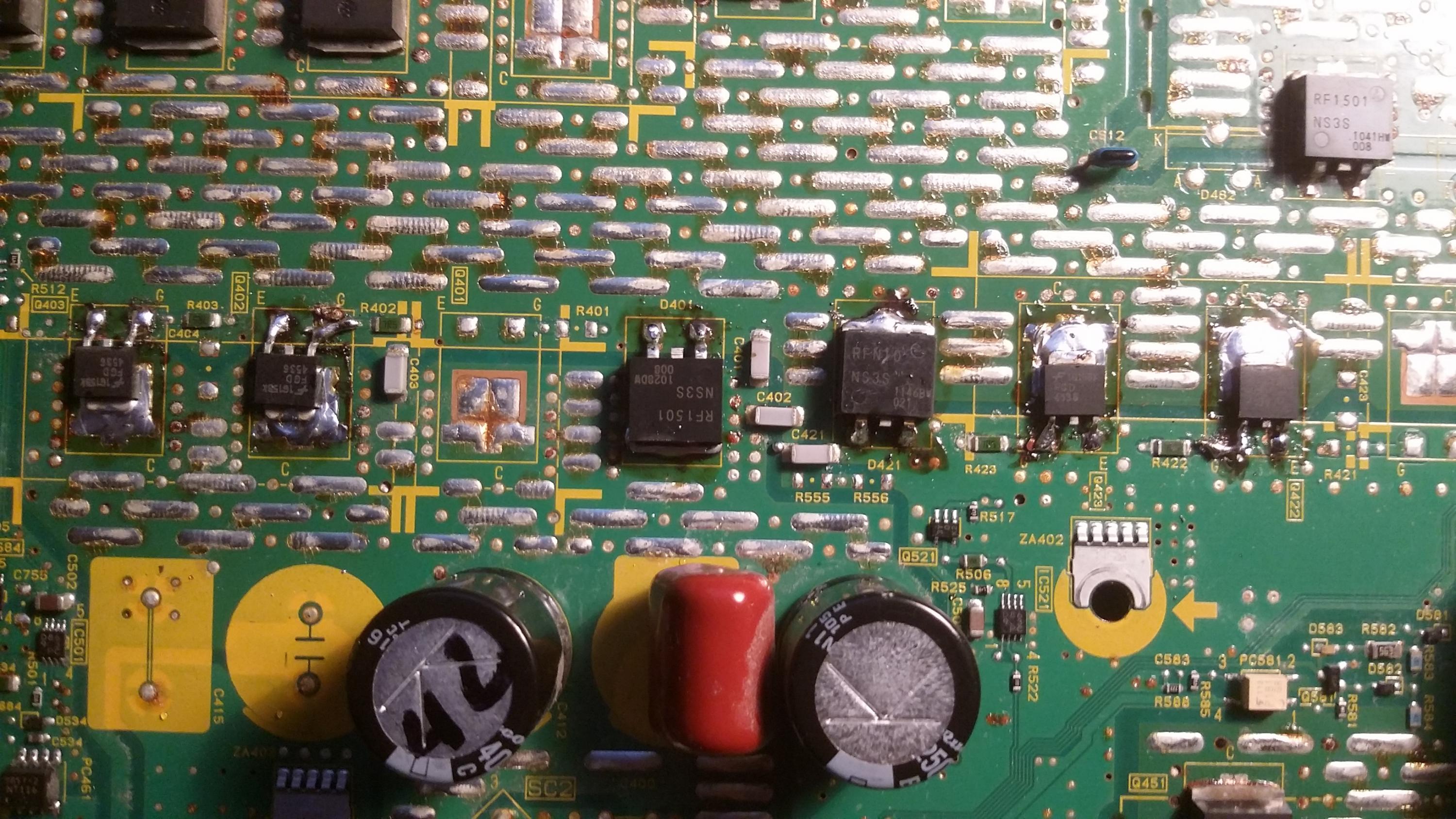

              #66
              Re: whole new repair / learning world... plasma! Yikes!
              here is a picture of the removal "work"... :-)
              As you indicate, with a meter, I can find the "contact point" of the "residual pad trace" and follow it to the SMD resistor for the mosfet. Hopefully, I can solder a small wire section to complete the path for the new mosfets. I seems to have compromised one contact on d401... even thought pad looks good, it doesn't "trace" over to the side... this one might be tougher to fix.
              One question: do you "pre-tin" the base of the mosfets before trying to mount them?
              Thanks for the guidance.

                #67
                No I dont. I solder down the pad and then the legs with no flux.

                  #68
                  As Timmy says. Just solder the parts to the board and use the solder to drag a pad to the resistor.

                    #69
                    well I got things soldered to the board.... not the prettiest effort (I am a "resistor only man" myself...:-) ) but checked all the connections to the appropriate points off the various replaced components. Everything meter checked fine... hopefully the "electrical capacity" of all the connections is up to the task.
                    I am somewhat concerned about the fgd4536's in terms of their position on the ground pads. Because of their smaller footprint (compared to the 30f131) and the need to reach the other contact pads / legs, the bodies of the fgd4536's aren't fully on the ground pad. Hopefully, this won't be an issue.
                    SO... I guess the moment of truth is close. Any last checks needed before this things gets connected and powered?

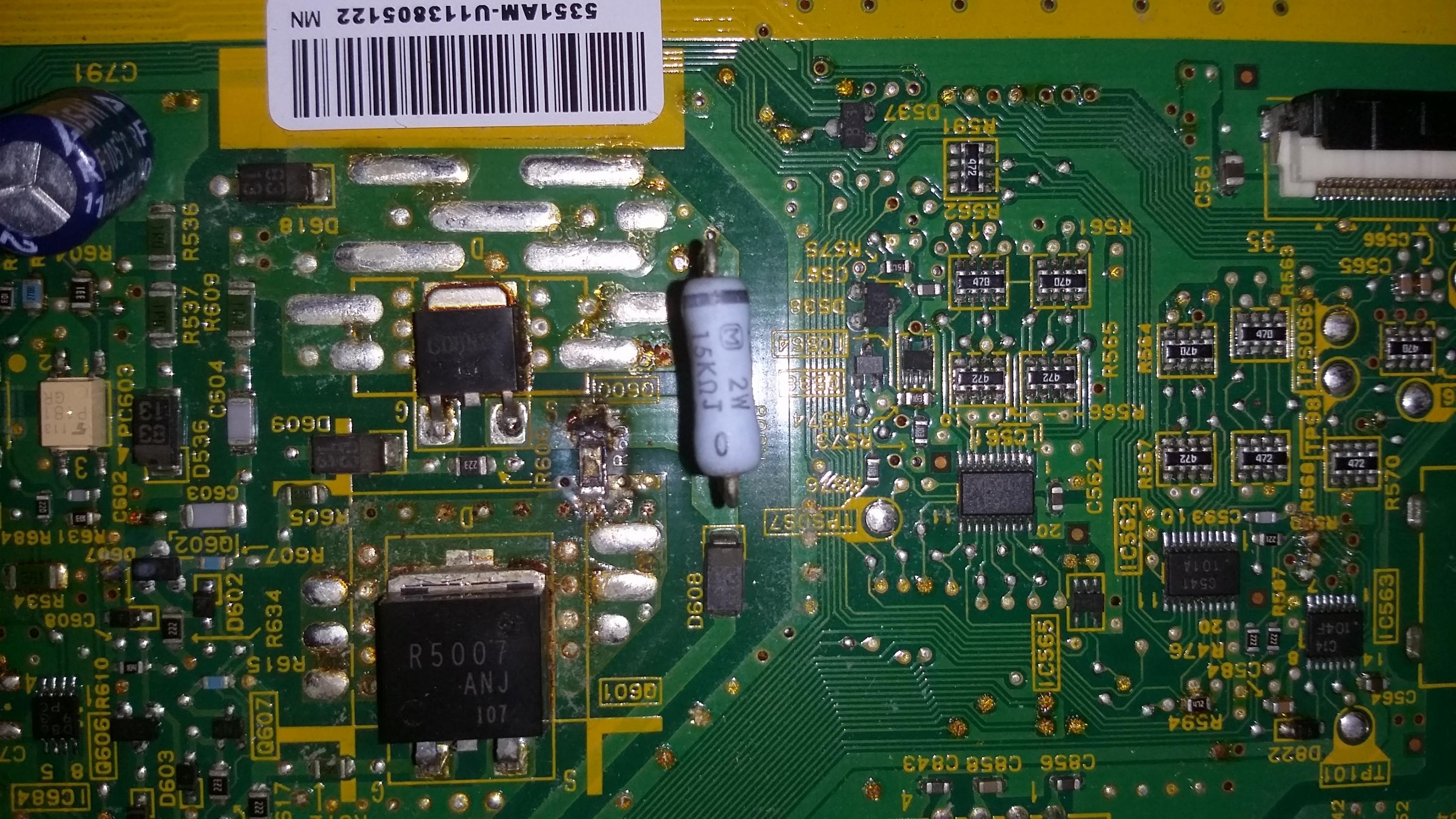

                        I did some more check of the SC board. I thought at the time that I had checked all "three legged" components but I guess not... although maybe inboard testing might not be totally adequate. I found Q601 shorted along with one leg of q600 shorted.
                        BUT worse all, there is a "burn mark" at r600... which I assume is the "snap" I heard... :-(
                        Q601 is a "r5007 anj 107" and Q600 is "C08N25" (I think .. "0" could be a"D"). Can't tell what the R600 is (blown top portion).
                        Not that I have seen these parts replaced / mentioned in my travels / reads.
                        Hopefully they are available from somewhere.
                          Good try but unlucky! The exploded resistor is due to fake parts. There are fake FGD4536TM on ebay also. So i hope you got the right ones.
                          These bangs happened to me also when i first tried to repair the Panasonic plasma tv's. I tried it many times before i figured out i used fake 30F131/RJP30H2A. Trust me , i builded these boards almost from scrap and i know what parts blow with fake parts.
                          First of all a quick learning lesson. The IGBT's on these board are divided into 2 area's. The top area closer to the buffer boards are only shorted when the panel or buffers are shorted. Usually you dont need to replace DAF30.
                          The lower part of the IGBT's in the same line as RF1501 are shorted due to the ground/screw issue.
                          9 out of 10 times there is no need to replace RF1501 or RFN10 , they read short because the fets in the same trace are shorted. Same for DAF30.
                          On this board you only need to replace Q403/402/423/422 and Q451 and another one i dont see on the picture. It is located top right of the board and it is a D302 or 301.
                          You can use FGD4536 in place , well i read it somewhere on this forum. Never tried it.
                          You need to replace IC502 it is a BD8693FVM. That's the control IC.
                          You also need to replace Q531. 3Y (SMD Code) is a CPH5524-TL-E
                          Because the resistor blew you need to measure "Q661?" , it is located bottom left on the board , near the SC20 connector. It is a RJP63.....
                          What is the exact model of the board? I think i got this board somewhere so i can give you the resistor value. Should be a diode near , measure it.
                          Dont worry , we will fix the board but you need good parts!
