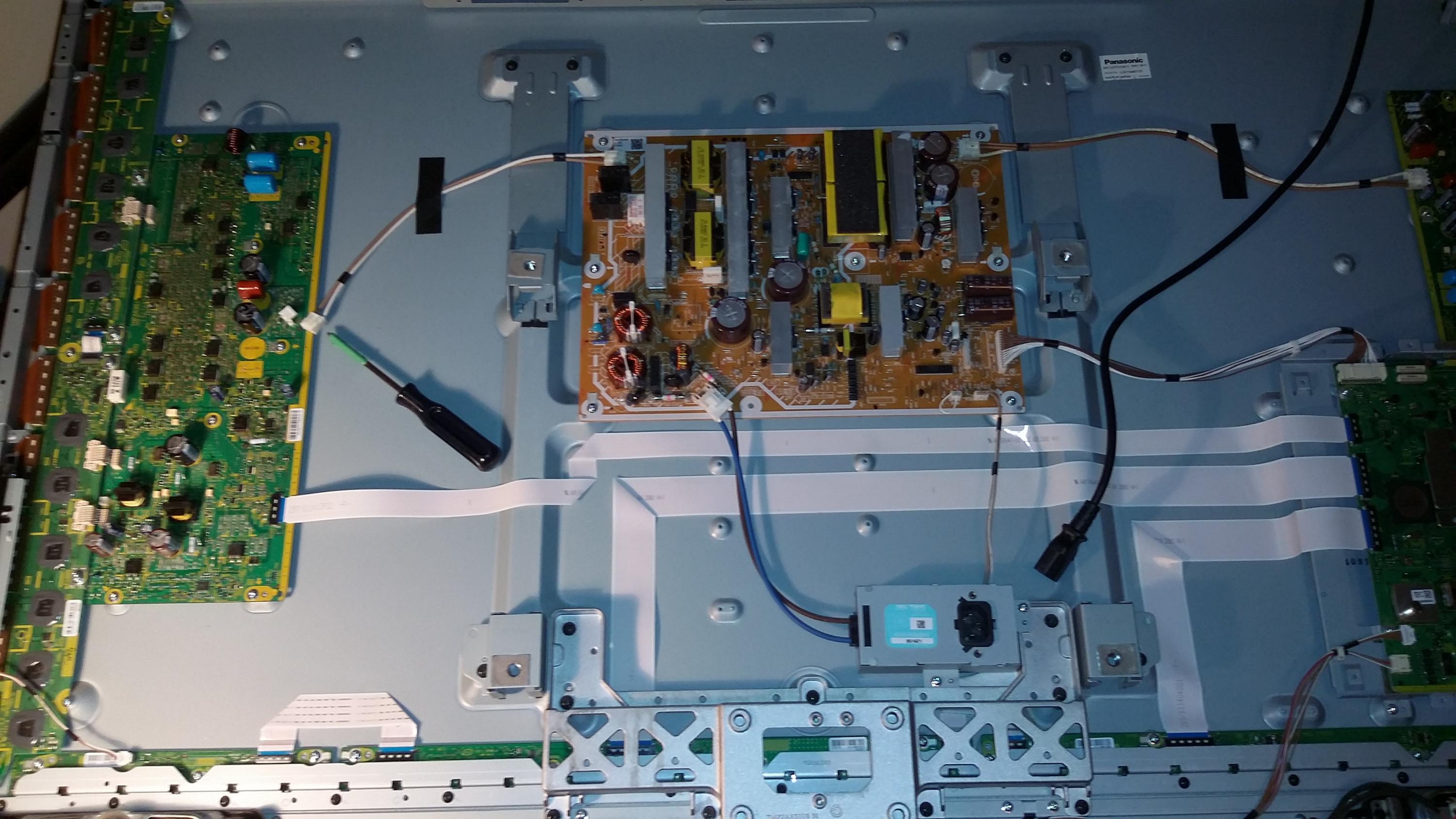

                                    Got on the bench, back off. Its dirty... not sure if that was from where was recently (recycle) or where it spent its service life. Nothing obviously burnt or otherwise.
                                    OK. Following the first thread that I posted, IF I unplug the SC board from the power board and power up, I get a code 7. Measuring the resistance at the connector of the board, shows its a short. :-( ... Good I guess.
                                    Question: in the other thread, it mentions doing a "quick check" of resistance to the Vf ground on the ribbon cables to the panel to see if perhaps the panel connections have a problem. Not sure that I understand what the check means and where those "points of interest" are.

                                      OK... I think I understand, you are checking the power supply line side of the disconnected cable... hoping that the power supply will at least provide some powering there before any shut down. Right?
                                      • budwich
                                        • Jul 2015
                                        • 3097
                                        Re: whole new repair / learning world... plasma! Yikes!
                                        this is a picture of the back of the set with the sc cable disconnected. I don't see any blue and white wires.
