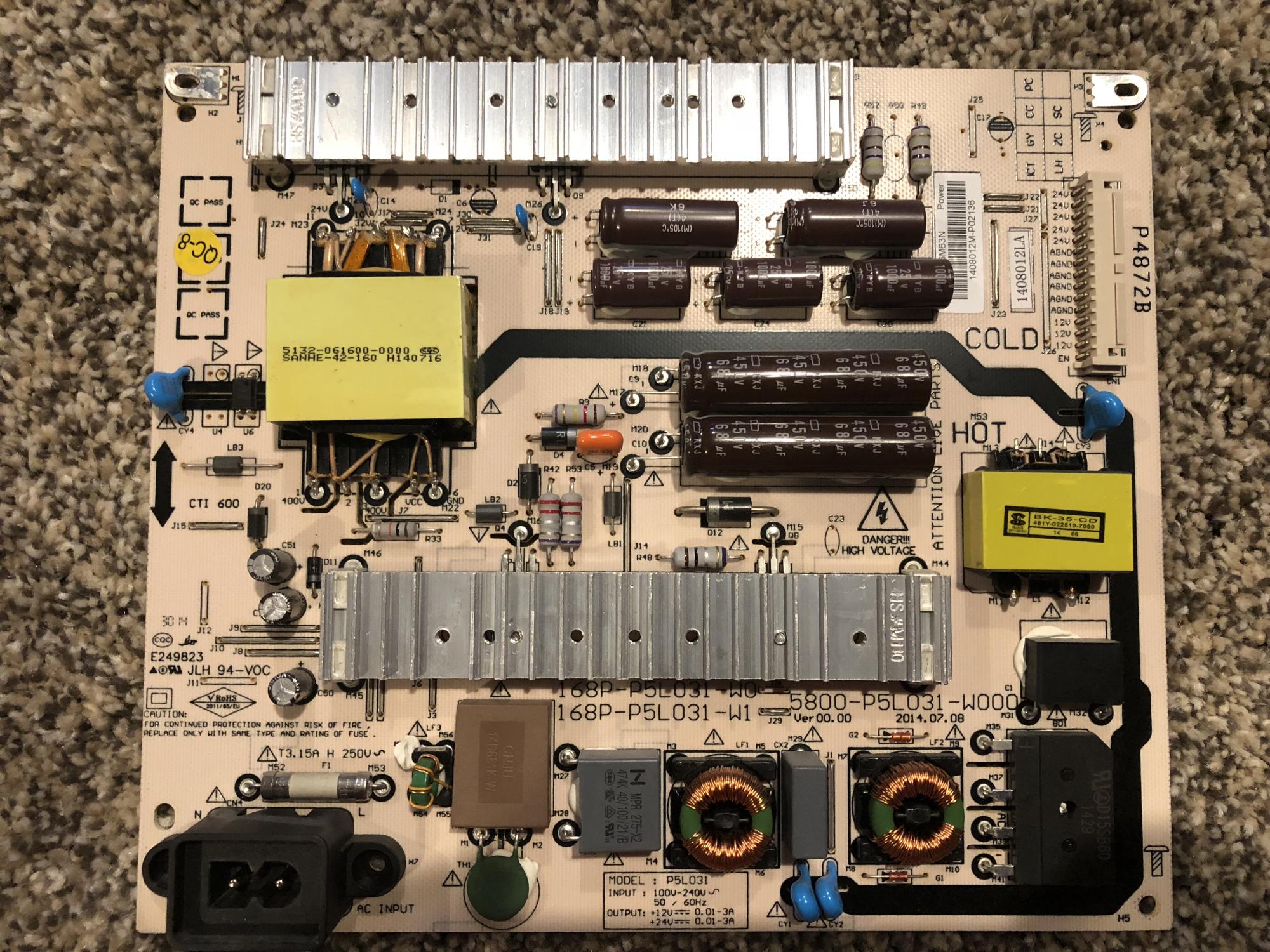

                          Hi guys, I am a brand new member. I have the exact same tv with the exact same problem, exact same readings. I just measured Voltage between 1&2 on U1 and I get 14.4V (with nothing plugged into the board except the 120VAC).
                            #53
                            Re: LG 60LB5200 will not turn on

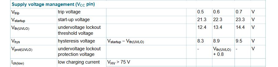

                            According to the datasheet given post #8 the startup voltage needs to be approximately 22V with an undervoltage lockout (switch IC off) at approximately 13.4V
                            Edit
                            Are there resistors all connected in series on the HV (pin 16) and also is there a capacitor connected to the VCC (pin1) and if so what is the working voltage given on it?
                                Edit
                                On Pin 1 there are 2 capacitors and then it goes through some diodes and a transistor. On those caps the voltage is also 14.4V
                                On Pin 16 there is one 10K resistor and the other lead of that resistor ties into pin 2 of that big yellow components (not sure what that even is).

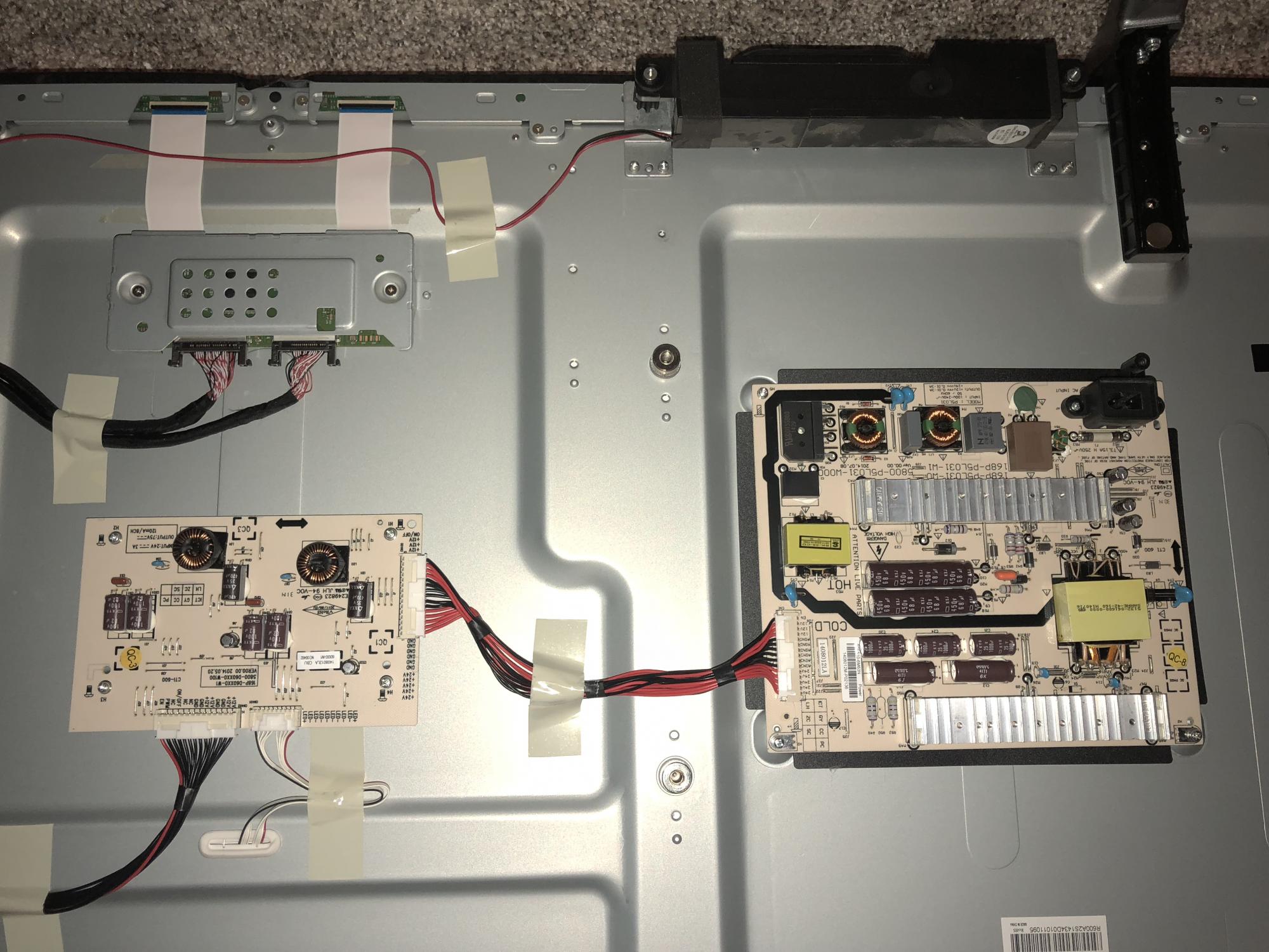

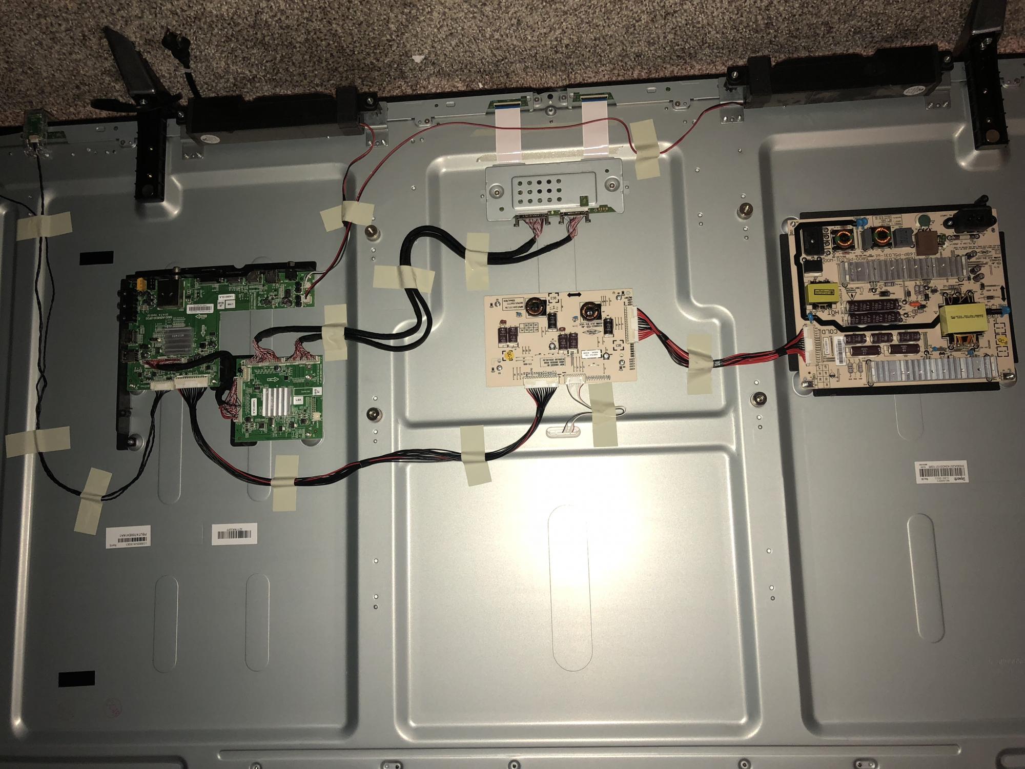

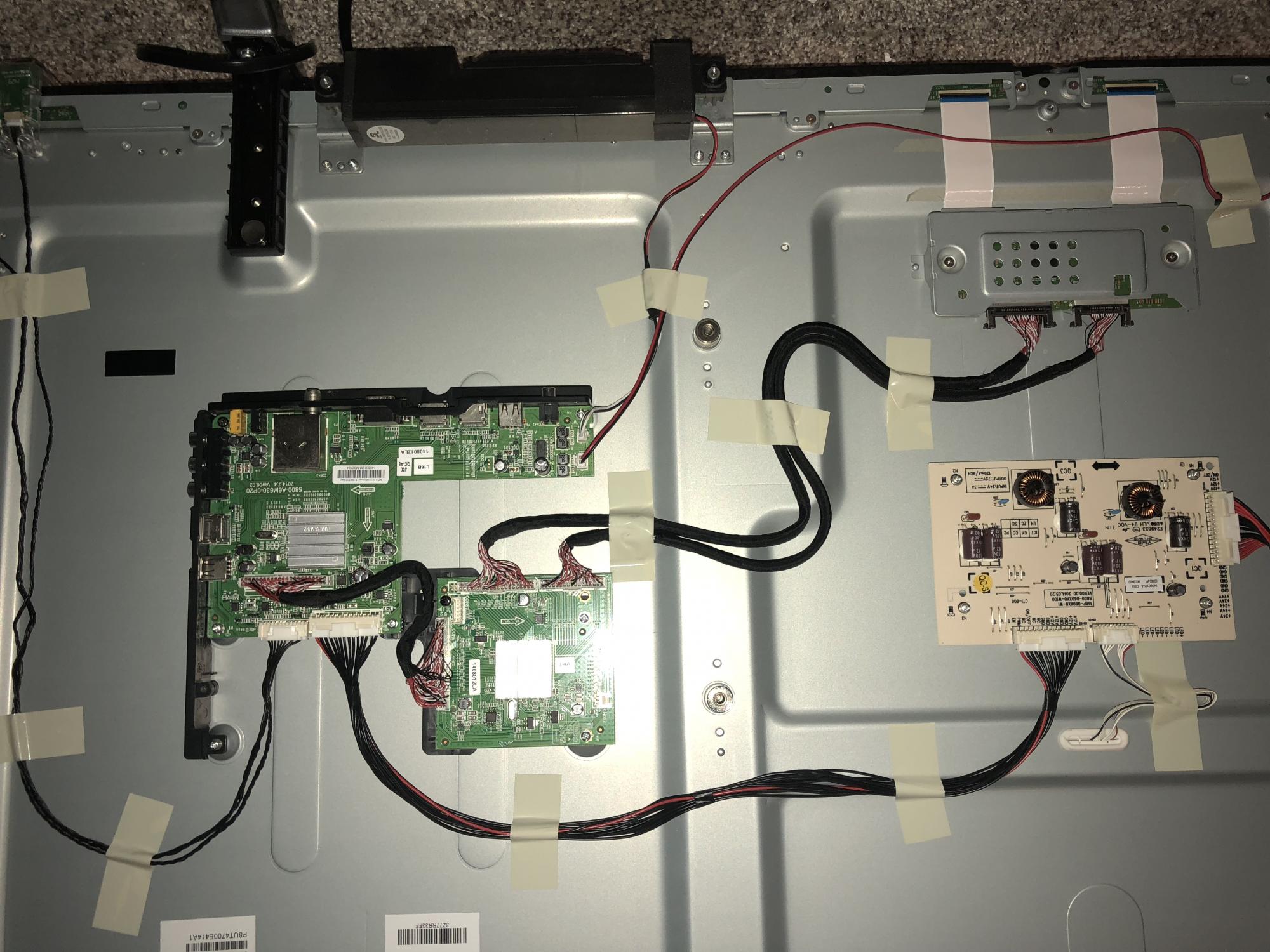

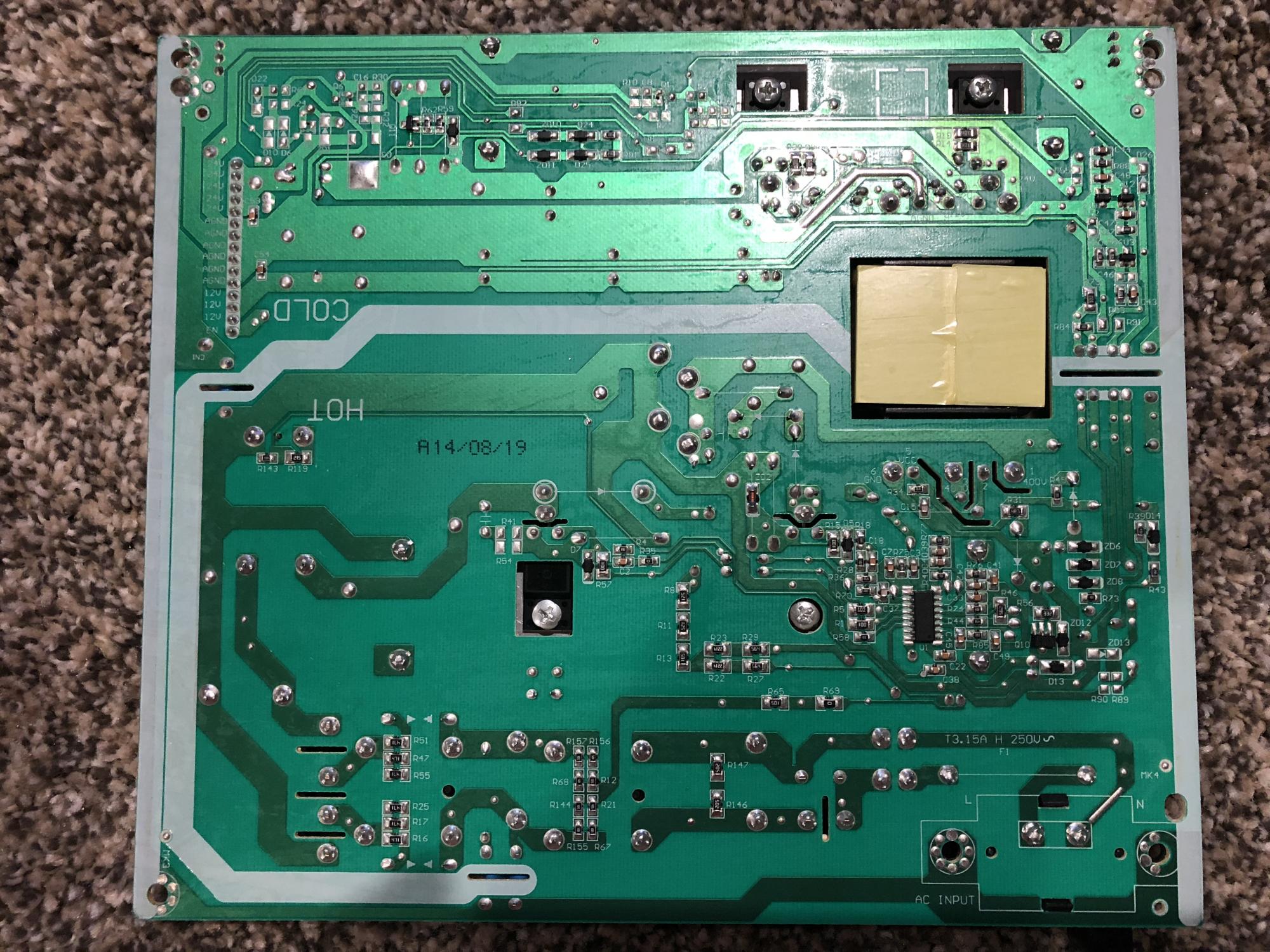

                                    Can I get the pictures of the whole back side of the TV showing all the boards so I can see how they are connected together?
                                    I also need good clear straight shot of the whole top and bottom side of YOUR board.

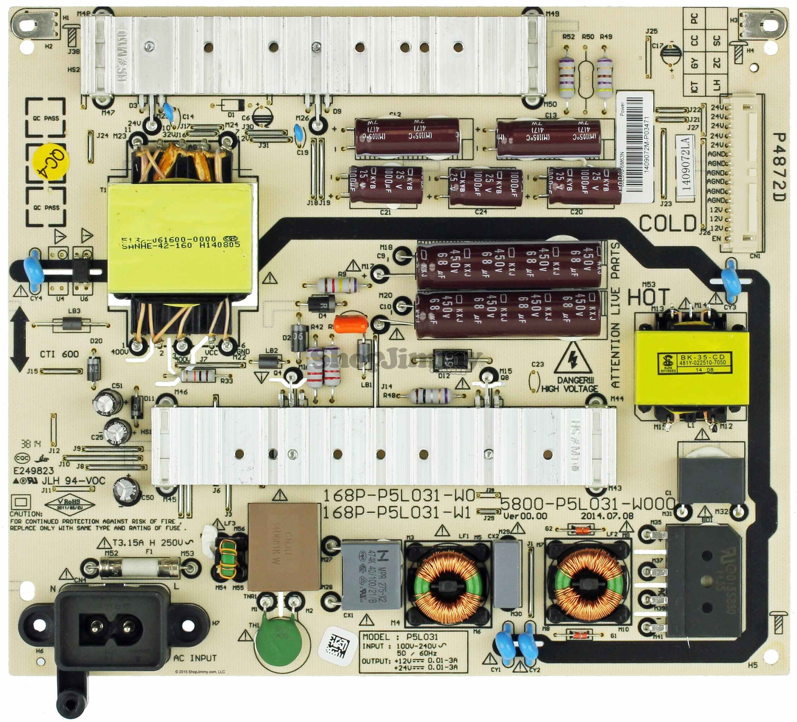

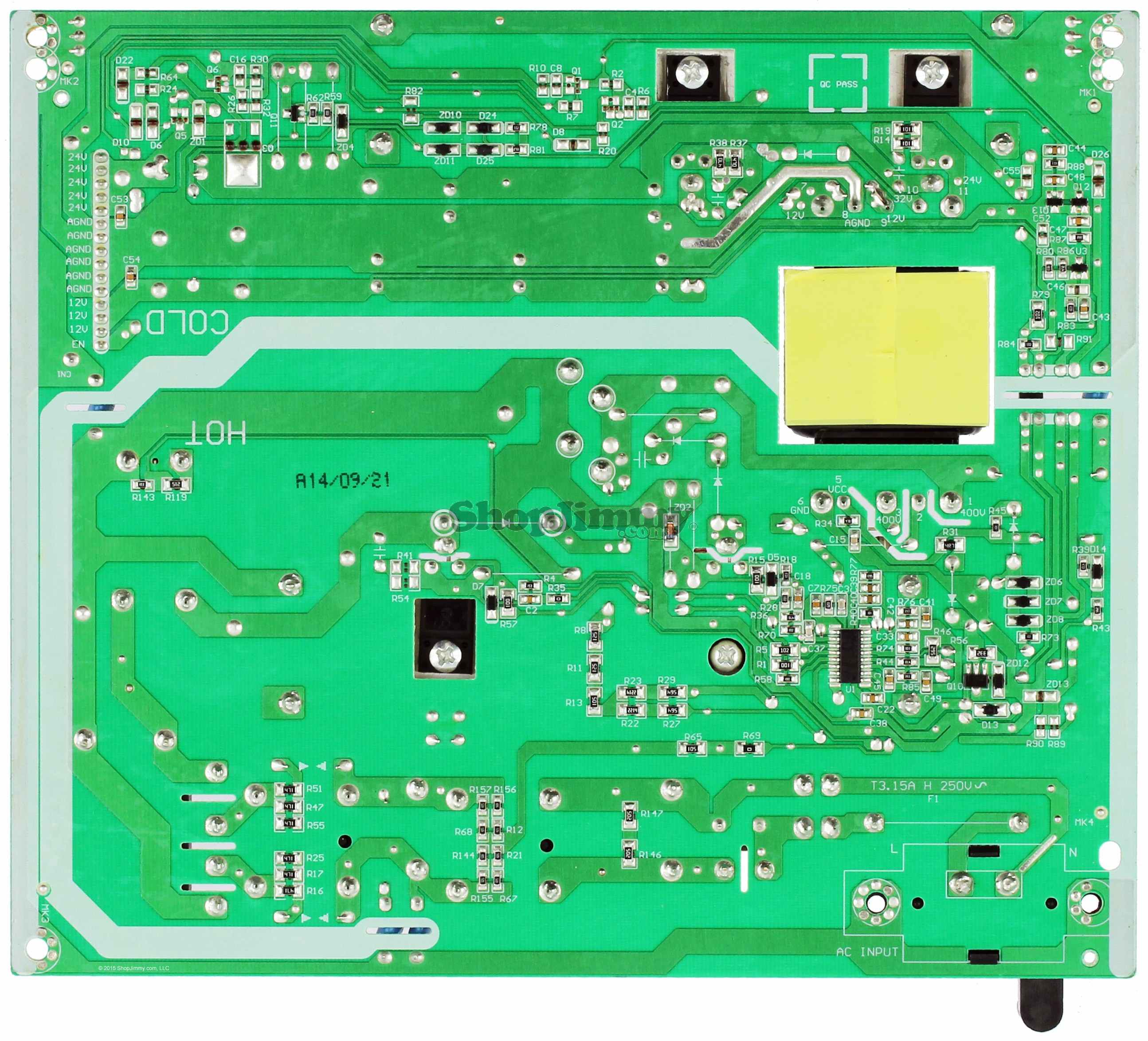

                                    1) Right now the power supply is running otherwise you will not have any DC at the outputs at all.
                                    2) I look at the bottom side of the power supply board from shopjimmy, the EN pin is not connected to anything at all due to jumper J26 and J27 are missing in shopjimmy's pictures, so I need to see you boards and how they are connected together.
                                    Pictures provided by shopjimmy.
                                    http://www.shopjimmy.com/lg-cov32809...er-supply.htm#
                                    LG COV32809701 Power Supply

                                      I attached the photos you requested.
                                        #59
                                        Sorry. The pics are upside down.
                                          #60
                                          The picture in post #5 is the back of my board. I can take a picture of the front, if you would like. However, I'm thinking CMS has covered both sides and the back of the TV.
                                          It is odd that it looks as if the EN pin is not actually connected to anything.
