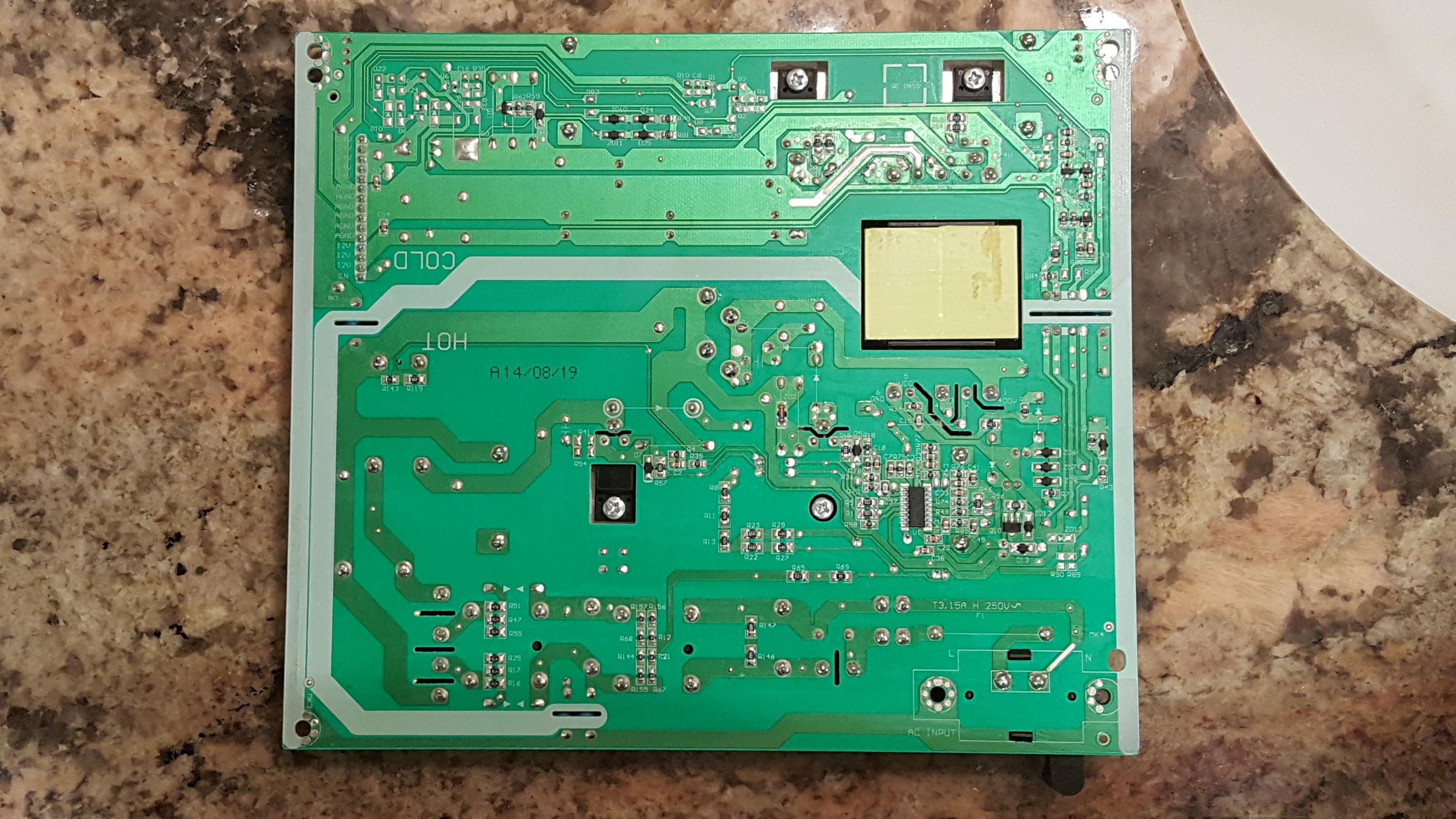

    LG 60LB5200 will not turn on. There is a green standby light.
    Measured voltages at the power supply output connector. All 12V pins were at 7V. All 24V pins were at 15.5V. EN pin is at 2.2V
    Does this appear to be a faulty power supply or is there something else I need to look at?

    Are you happy your dmm is reading correctly ? Then measure voltage across the two largest caps - neg on lhs pin pos on rhs pin - should get 350/400v.

      To be safe, I used a different meter. Voltages were much the same.
      Here are the actual voyltages, instead of my memory.
      12V = 6.95V
      24V = 15.64V
      EN = 2.54V
      Both of the large caps are 163.2 VDC
        Re: LG 60LB5200 will not turn on
        Your PFC Voltage booster is not working.
        Check the RESISTANCE of the Diode D12 in both direction.
        We also need good clear picture of the bottom side of the board.

          Do I need to remove D12 from the board, before testing it?
          Power removed, D12 still on the board
          Negative on cathode: 30k or 239k (it changes between them)
          Positive on the cathode: started at 250k and climbed to over 1M, before I stopped measuring it.

              OK, PFC diode is OK.
              Get the P/N as printed on the U1 SMD IC and then look up the spec sheet so you can find out which pin of the IC is the VCC pin so you can verify if the IC is getting the power to run it or not when the TV is turned on.

                Looks like an NXP TEA1755T
                Pin 1 Vcc = 1.15V
                Pin 5 LATCH = 1.10V
                    Service manual at manualslib may help with diagnosis. It is slightly different model but PSU may be much the same.

                      It is not getting way too low of the Voltage to run, so the next thing will be tracing out the VCC pin back to switched Transistor on that power supply board to see if it is getting the Voltage feeding it and the control Voltage to turn it on or not. This is not going to be easy for beginner unless you are really good at tracing out the board.

                        I was able to trace Vcc to a nearby transistor. Is it the one you are needing voltages from, or did I miss it by a long shot?

                            Page 27 of sm gives a bit of circuitry for 3.3 vcc
                              What DC Voltage do get between the two legs of the cap I circle in red?
                              The Voltage on that cap is generated from the AUX winding of the STBY Transformer.

                                I think I used a bad ground point for Vcc. Using PIN 1 for Vcc and PIN 2 for ground, I get 14.49V.
                                I measured across the cap and get 15.1V.

                                      So the IC is getting the VCC to run but it is not running.
                                      Report the other pins Voltages too to see if they are what they should be or not, make sure to use good GND this time.
