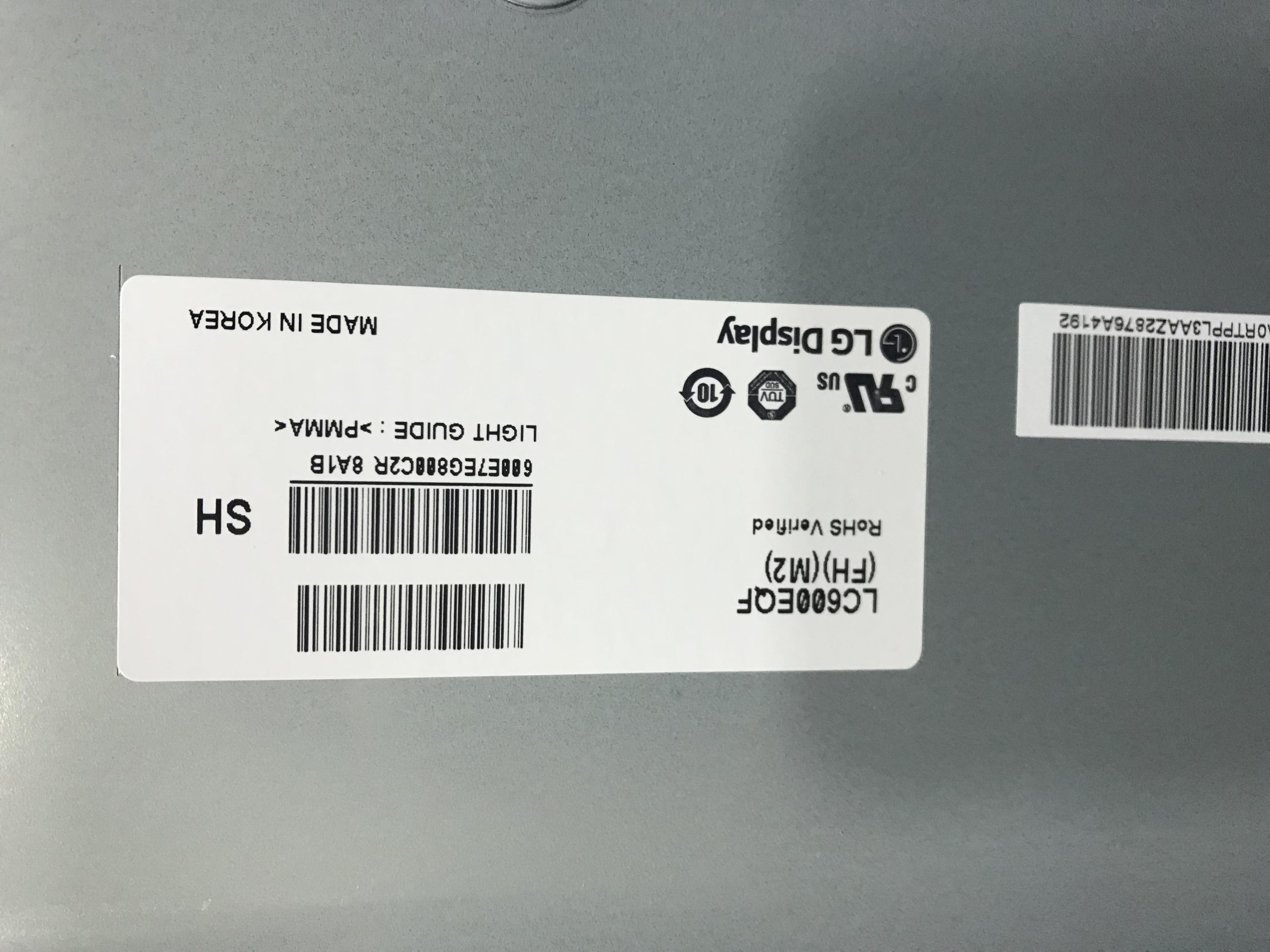

                                      #38
                                      Re: Lg 60uf770v 4k screen problem
                                      Can you write down the panel model? There's a sticker inside on the chassis..
                                      • daz2206
                                        • Oct 2013
                                        • 50
                                        • uk
                                        #39
                                        here you go
                                        • budwich
                                          • Jul 2015
                                          • 3097
                                          #40
