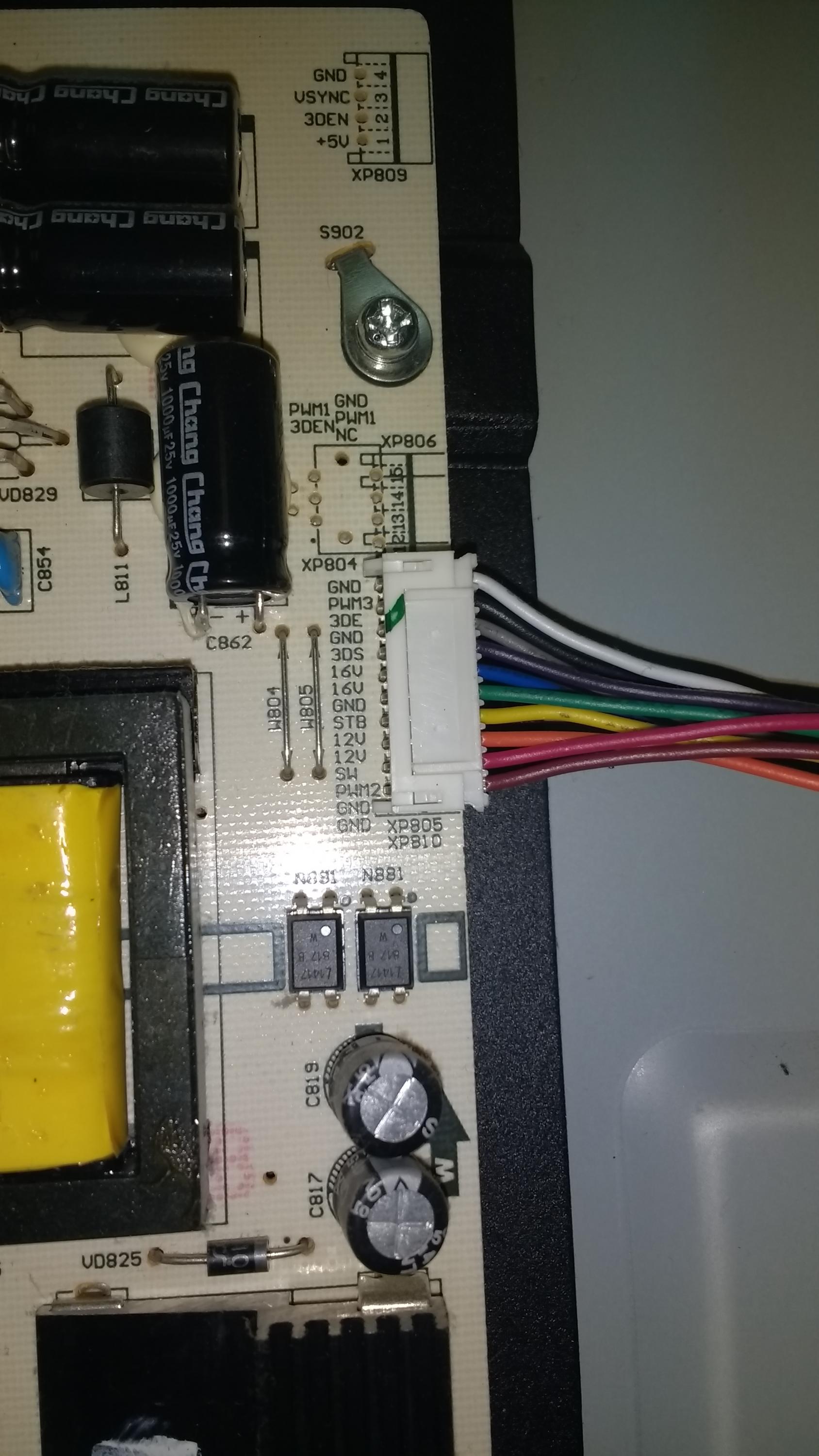

    Have a Hisense 50H5G no backlight. Can see a picture with a flashlight.
    I have 2v on the red wire and 0 volt on the white wire going to the LEDs.
    PWM2 is 3.2v and SW is 2.8. IS SW BL_ON and is that voltage high enough?
    From the top down
    19v (16v)
    19v (16v)
    0v (GRD)
    3.7v (STBY?)
    12v (12v)
    12v (12V
    2.8v SW
    3.2v PWM2
    0v (GRD)
    0v GRD)

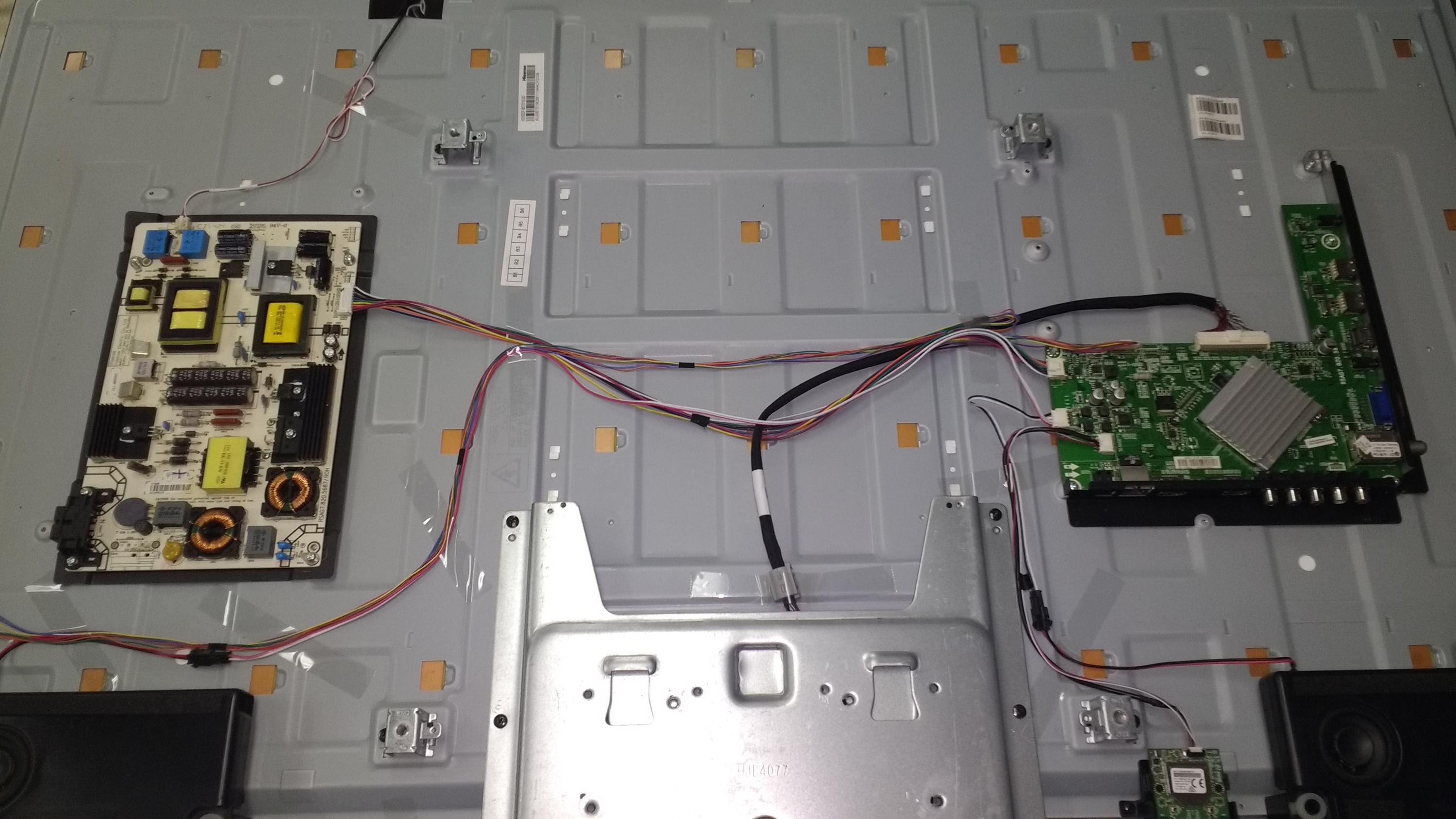

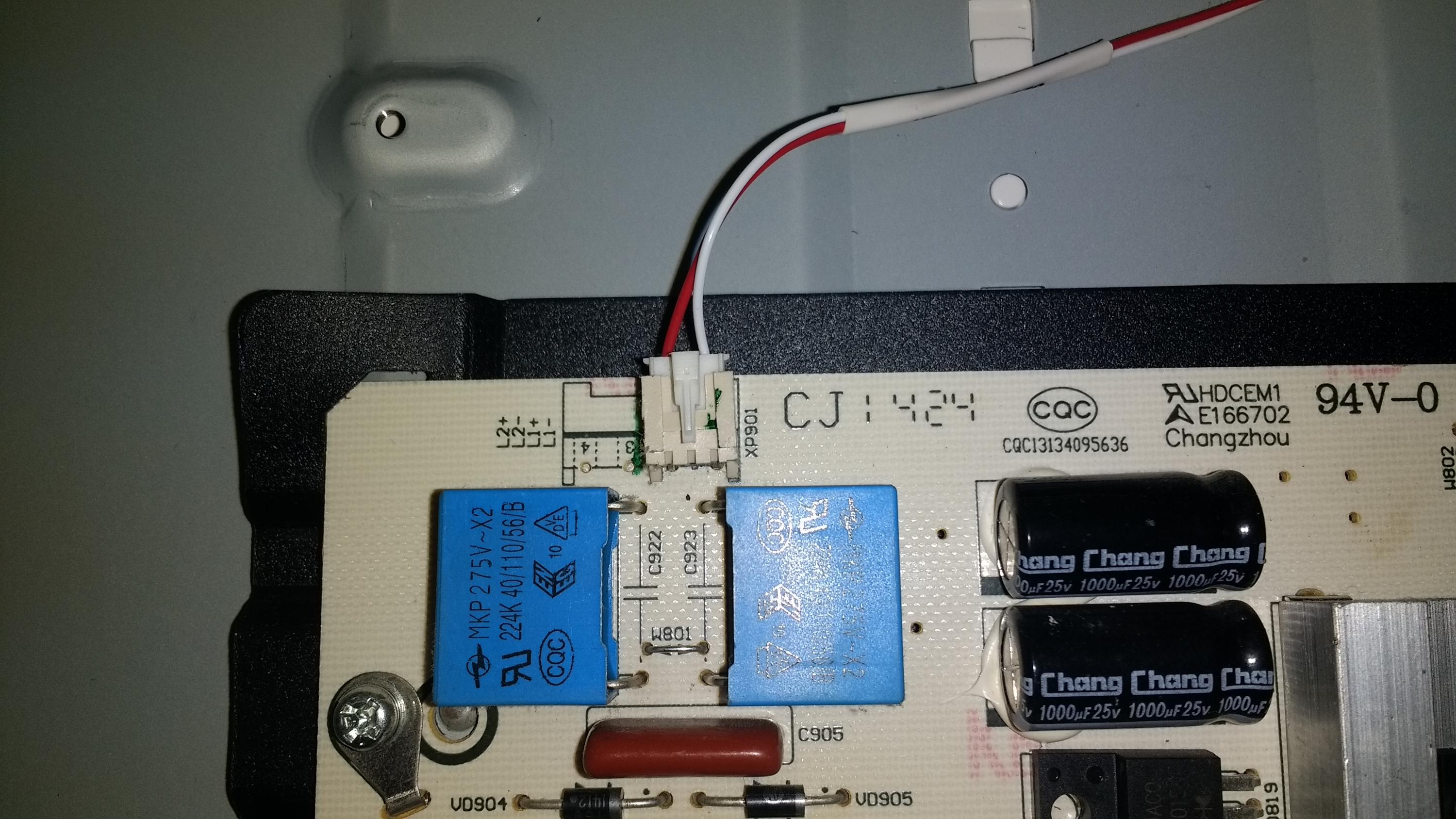

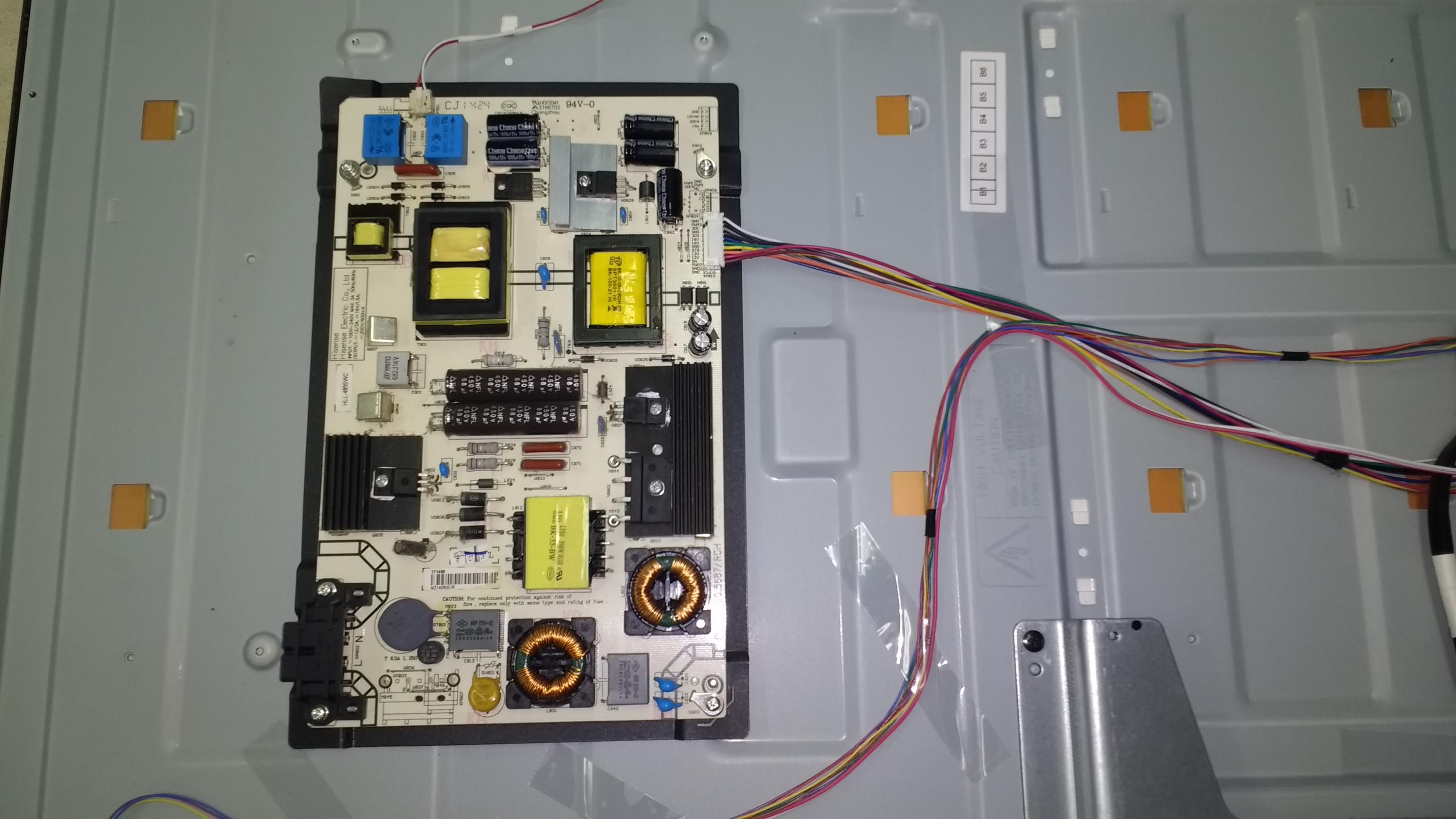

            Re: 50H5G no backlight
            We need good clear straight shot pictures of the whole backside of the TV showing all the boards and then straight shot pictures of the top and bottom side of the power supply board.
            • SHADOW3277
              • Jun 2014
              • 123
              Here are the other pics.
              Here is the PS at SJ. http://www.shopjimmy.com/hisense-171...upply-unit.htm
