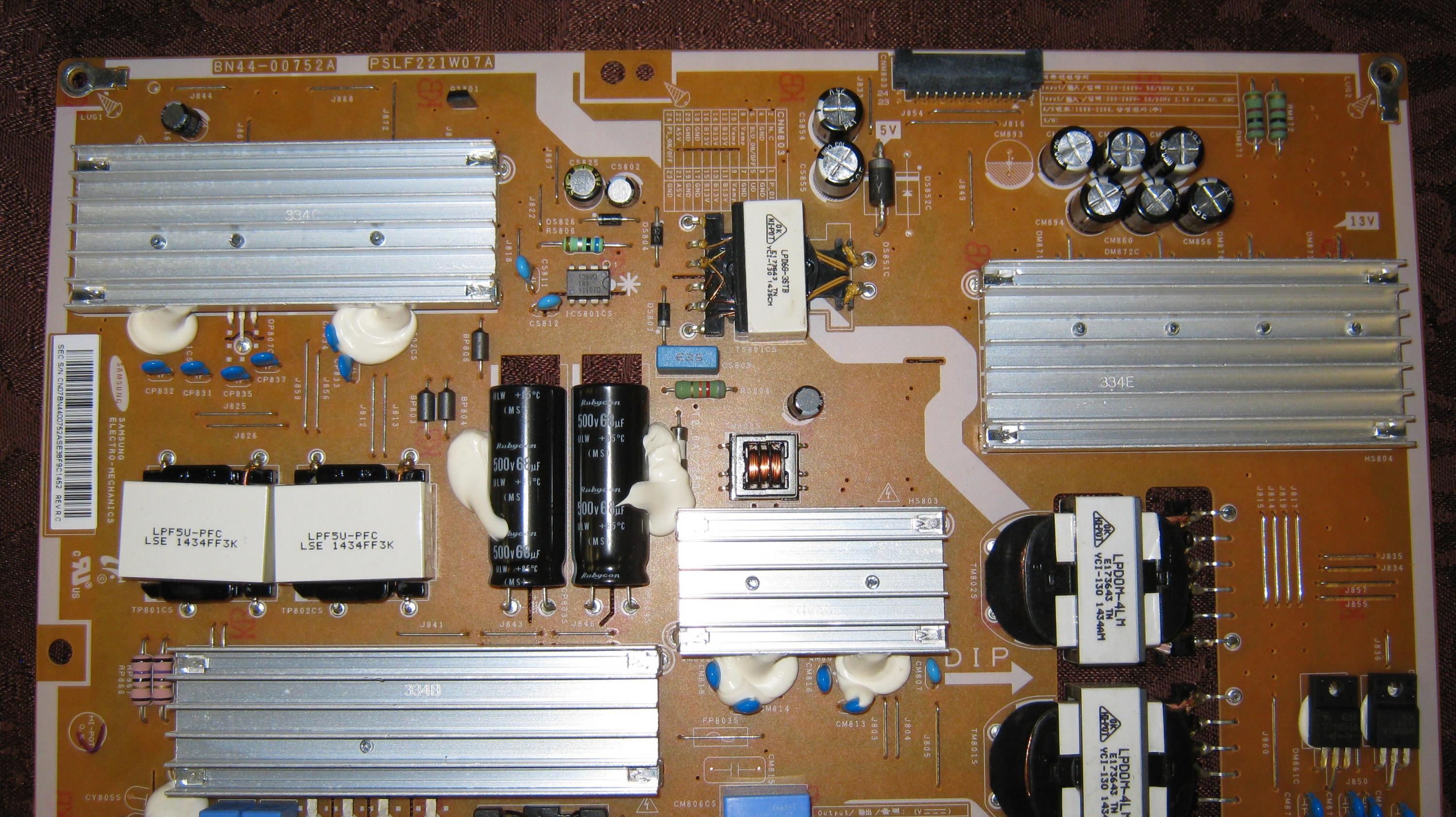

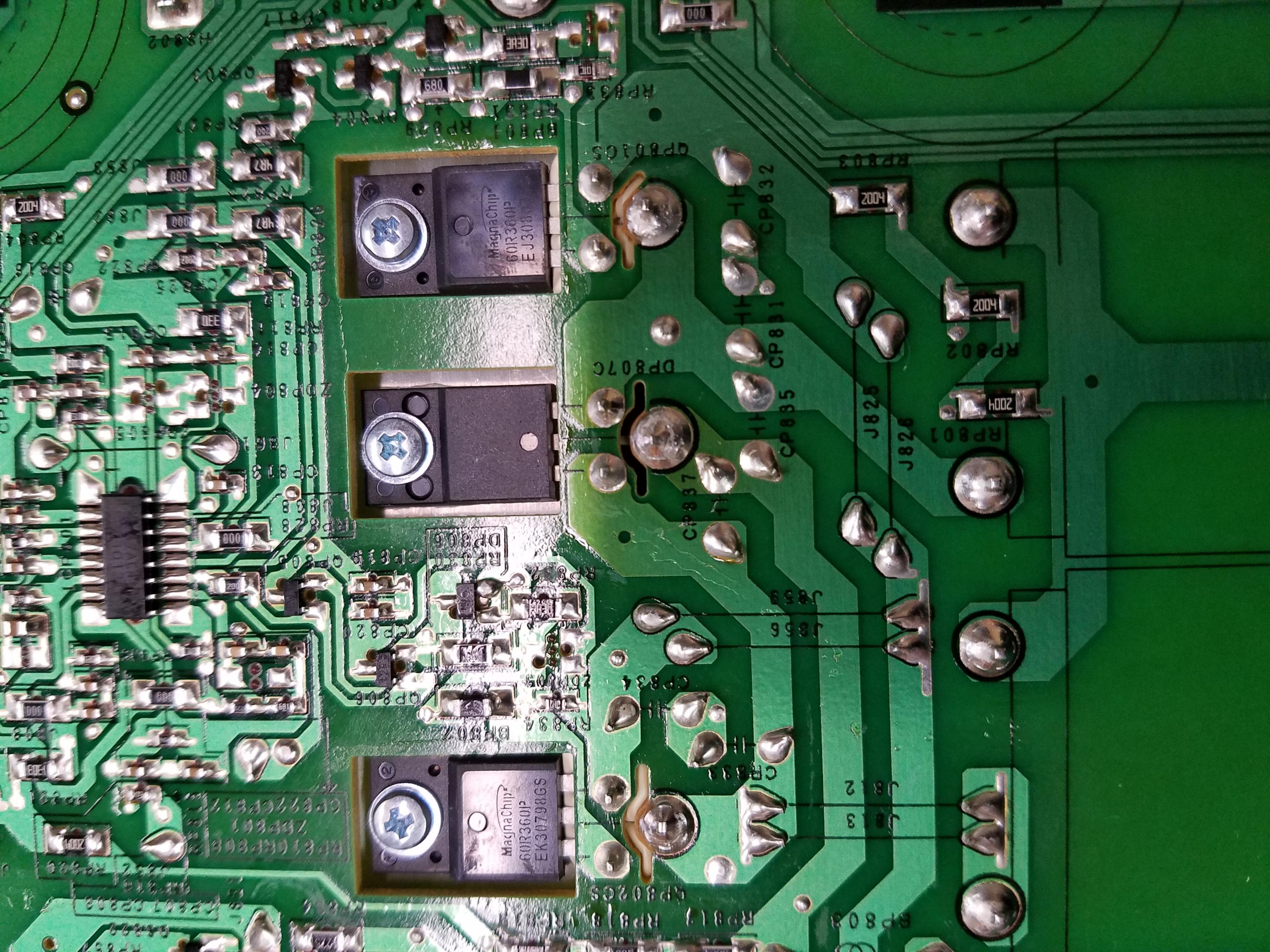

    Hi All
    Hi I have a Samsung UN40HU6950 TV that blew it's fuse on the power board. The board is a SE9B505102. I bought a matched ceramic fuse for it, reinstalled the board and it immediately blew the new one. I am at a loss of what to do next
    Thanks in advance = )

    The fuse is blowing for a reason, usually shorted a shorted component(s) on the power supply.
    You will need a multimeter to help find the faulty part(s) and to help us good photos of the board. I think it's a BN44-00752A ?

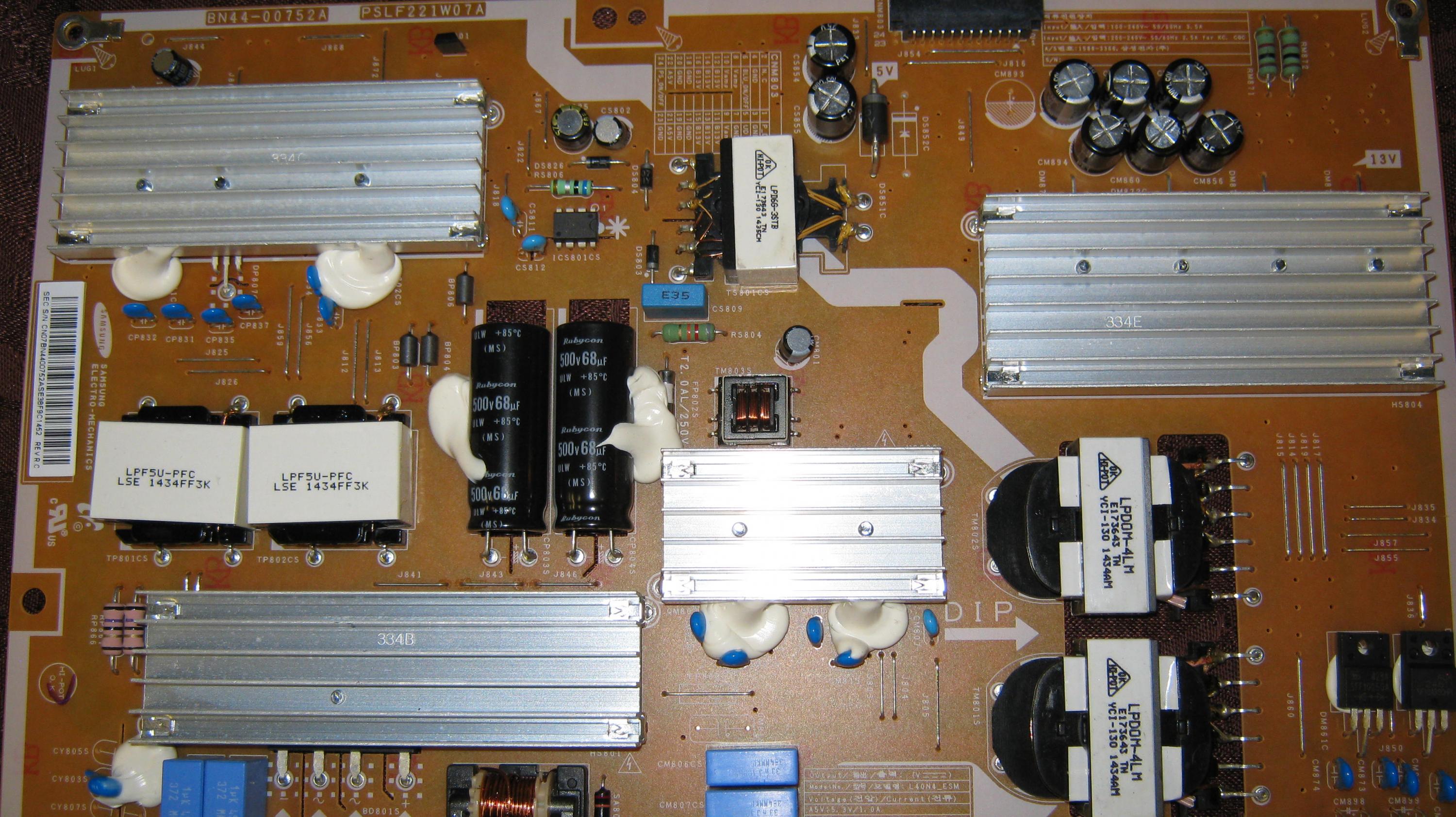

      I have a multimeter and I am not totally unfamiliar with it's use. The board is exactly the one you have mentioned. Tell me what you want photos off and I will post them
        Re: Constant fuse blowing
        Good clear high res straight shot of the whole top and bottom side of this power supply board.

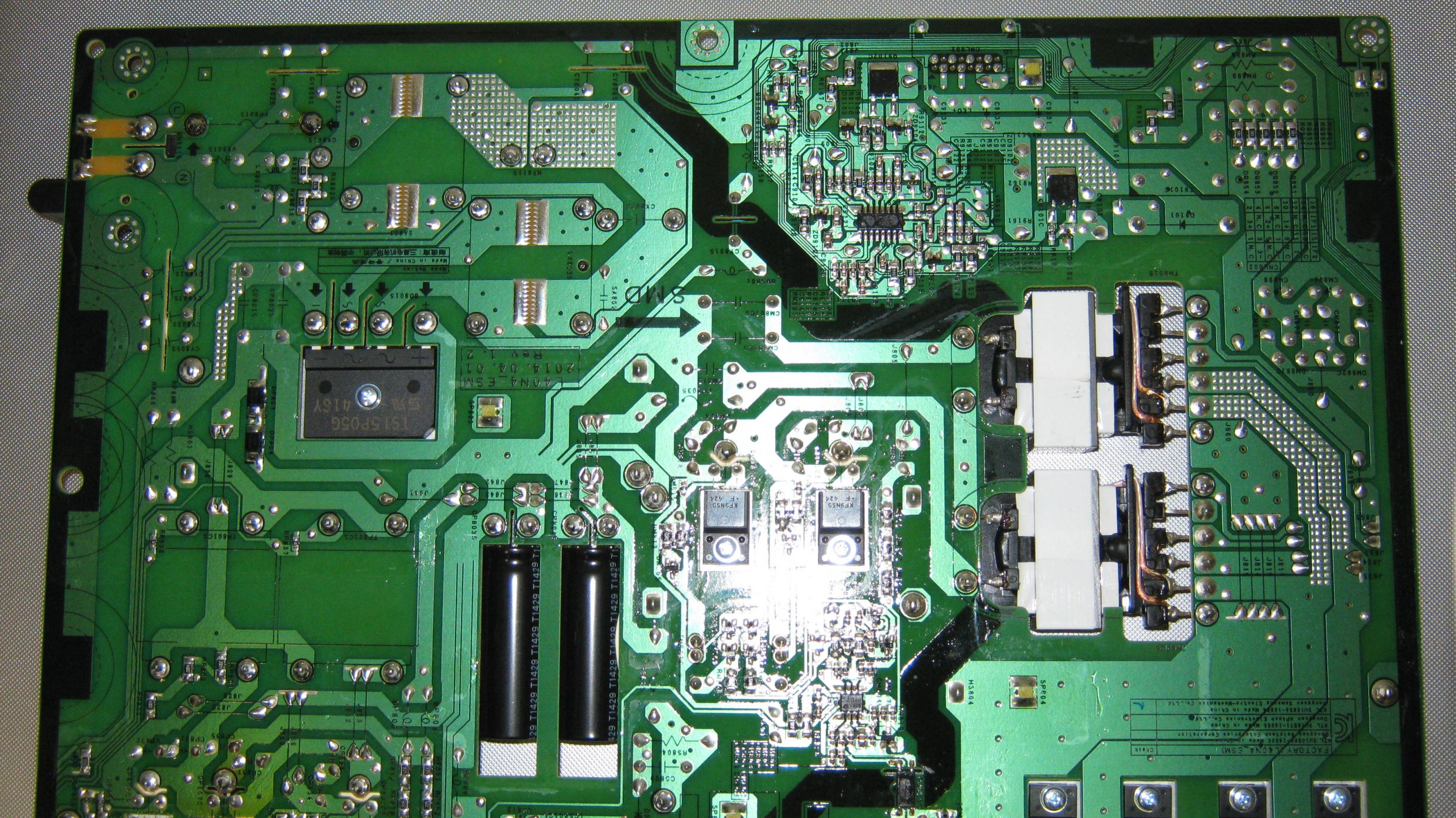

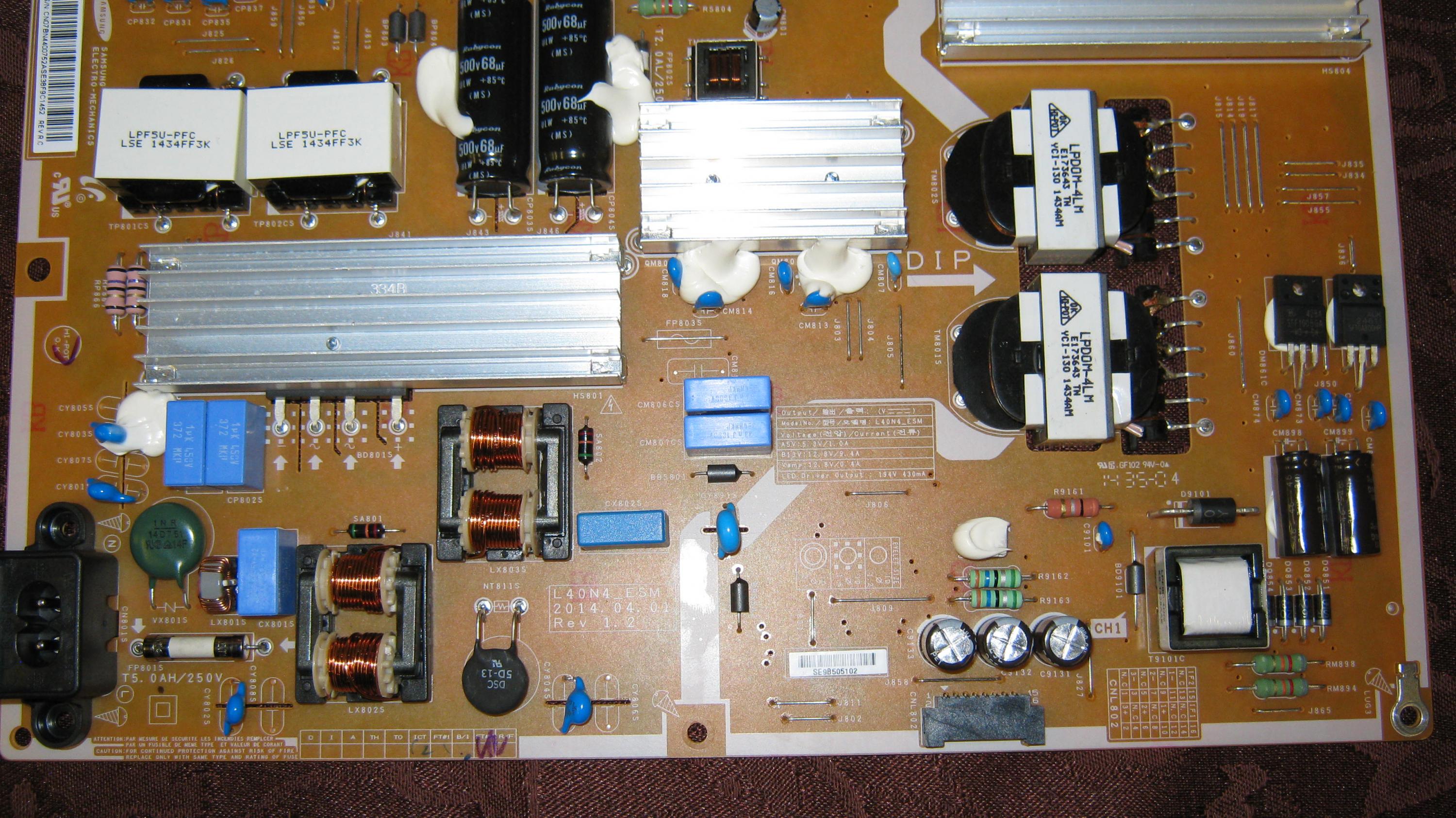

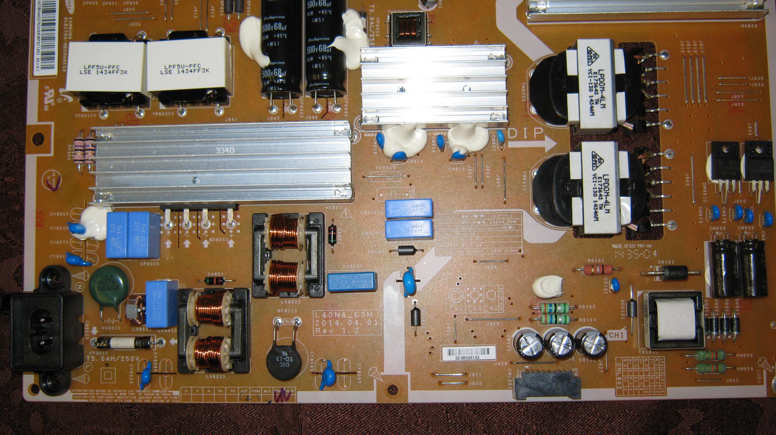

          OK - here they are. Let me know if you need anything better.

            check out the bridge rectifier BD8015 to see if it is shorted and the PFC fets next to it.

                OK, lets address this one a a time, here are what my readings on my bridge rectifier is.
                With positive lead on leg one ( + ) and negative on leg 2 - .502
                With positive lead on leg one ( + ) and negative on leg 3 - .502
                With positive lead on leg one ( + ) and negative on leg 2 - tests through
                As far as the PFc's go, I am assuming you are telling me DP803 & DP804 These I am unsure how to test I now have noticed a slight discoloration around DP801c on the back of the board This sits between QP802cs & QP801cs and they read differently

                    The 2 outer legs ring continuity on BD801s
                    If you are referring to the 2 500v68uf capacitors as the main filter cap(s) they both ring continuity also

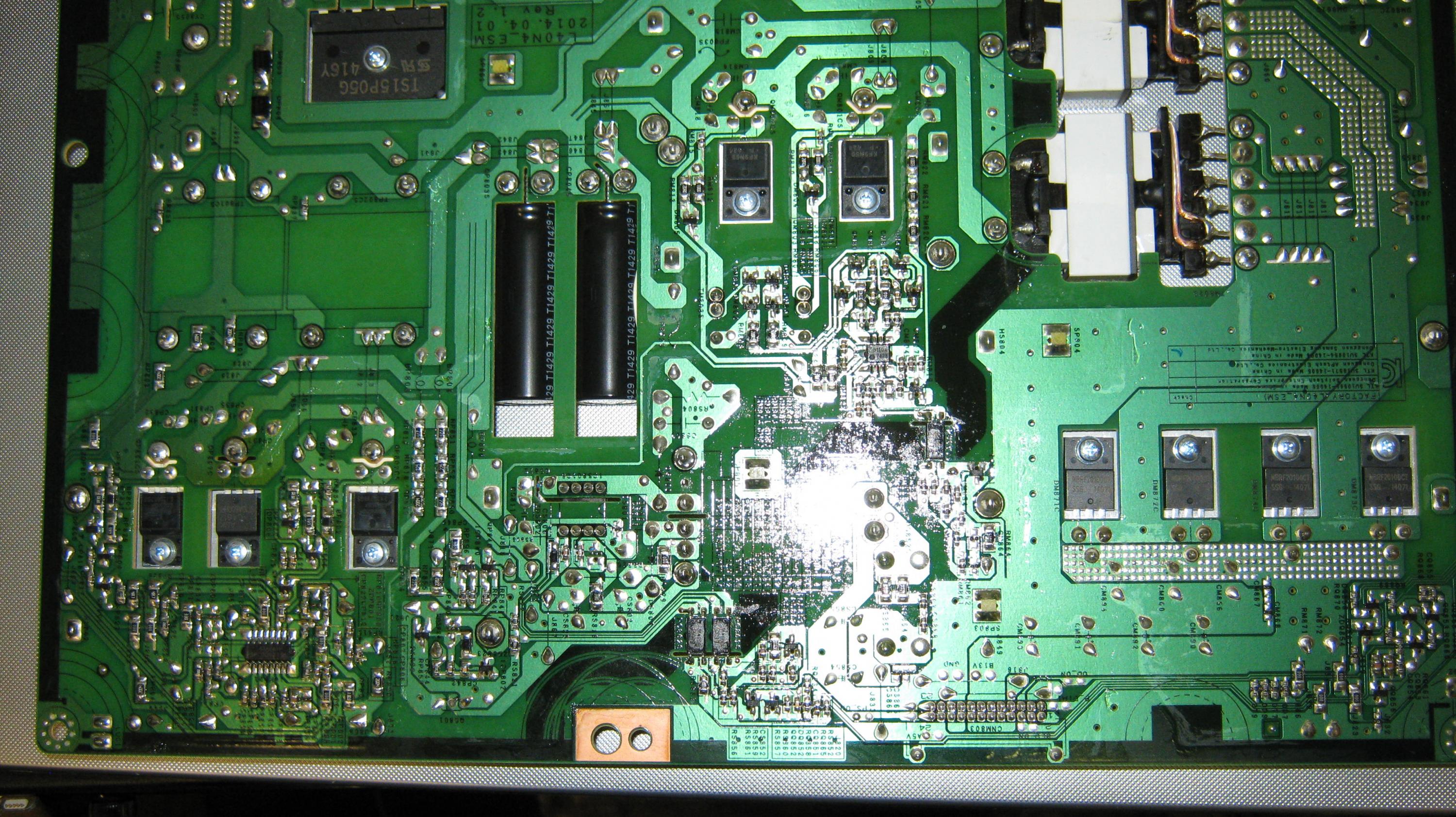

                    The mosfet I am suspicious of is posted below. I may be wayyyy off as I am new to this but it looks like there was a heat issue with the middle one.
                      We need the reading in Ohms, continuity test does not mean much when looking for resistance value, continuity is telling you that you have connection between the two points, the resistance will tell me if it is normal or not.
                      Make sure to report if the reading is in Ohm, K Ohm, or M Ohm.
                      Yes, those are the two power MOSFET's for the PFC circuit and one PFC diode on that heatsink.

                        Now that you read that (if that is correct) here are my results testing the 3 mosfets I pictured. On the backside of the board I put my negative on the left and my positive on the right. My meter is set in "diode mode" Here is where I am confused. When set on that on my expensive multimeter it just beeped continuity, when I pulled out my cheap radio shack multimeter I got a reading. If I am on the right path, please continue to point me towards what to test. If not redirect me please
                        Mosfet 1 - 0.0
                        Mosfet 2 - 0.0
                        Mosfet 3 -.356
                        *note - pulled out my more expensive meter again, and it beeped on the first two as before, but on the third mosfet it measured 1.16 odd that the other meter measured .356?

                          No power applied to the board, then just put meter in Ohm mode and read the resistance between Source pin and the Drain pin and then tell use how many Ohms you get on the meter, make sure to report exactly what you see on the meter to whether it is in Ohm, K Ohm, or M Ohm.

                            Okay from the mosfets pictured in my last attachment left to right (This is taken on the back of the board with one lead on the right pin and one lead on the middle pin)
                            1 .5 OHMS
                            2 1.1 OHMS
                            3 .7 OHMS
                            Hope this helps

                                  Remove one MOSFET one at a time and then test it off the board again, so far you you do have shorted MOSFET.

                                    something is shorted all right... but like budm already suggested: take one FET out at a time and check it, then put it back in its place. Not that you get mixed up later on where did what go.

                                      So, rather then checking in circuit, you want me to desolder and resolder each mosfet? What am I looking for on the read for each mosfet?
                                        Yes, remove it and test it of the board the same way as you tested before, the one we looking for the most is the resistance reading between Source and Drain pin.
