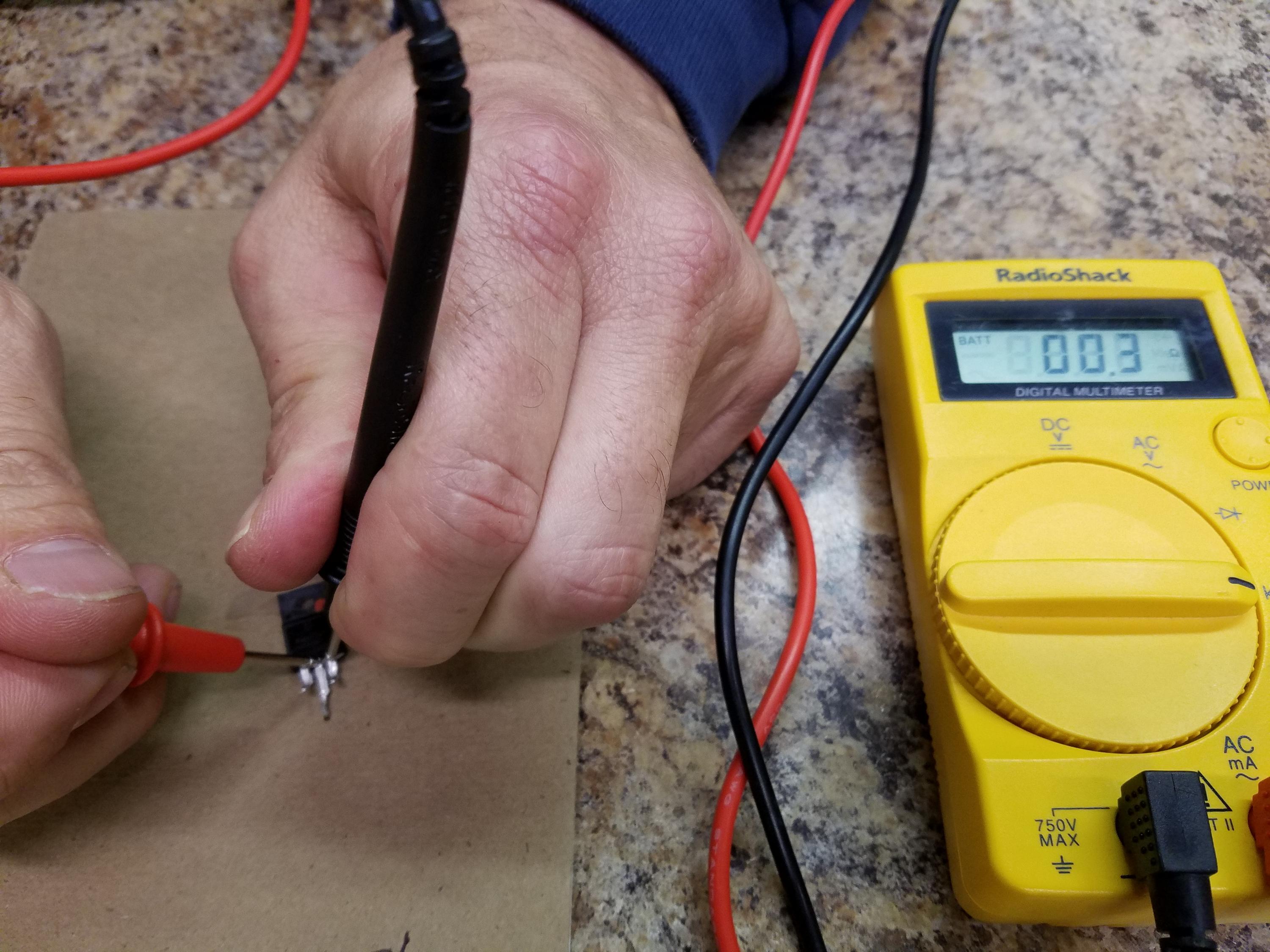

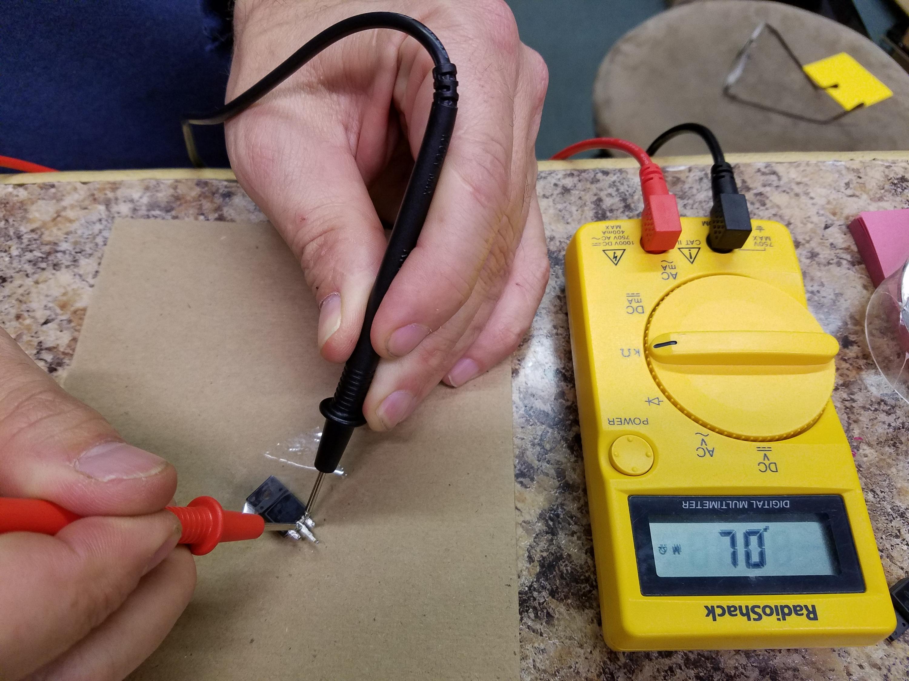

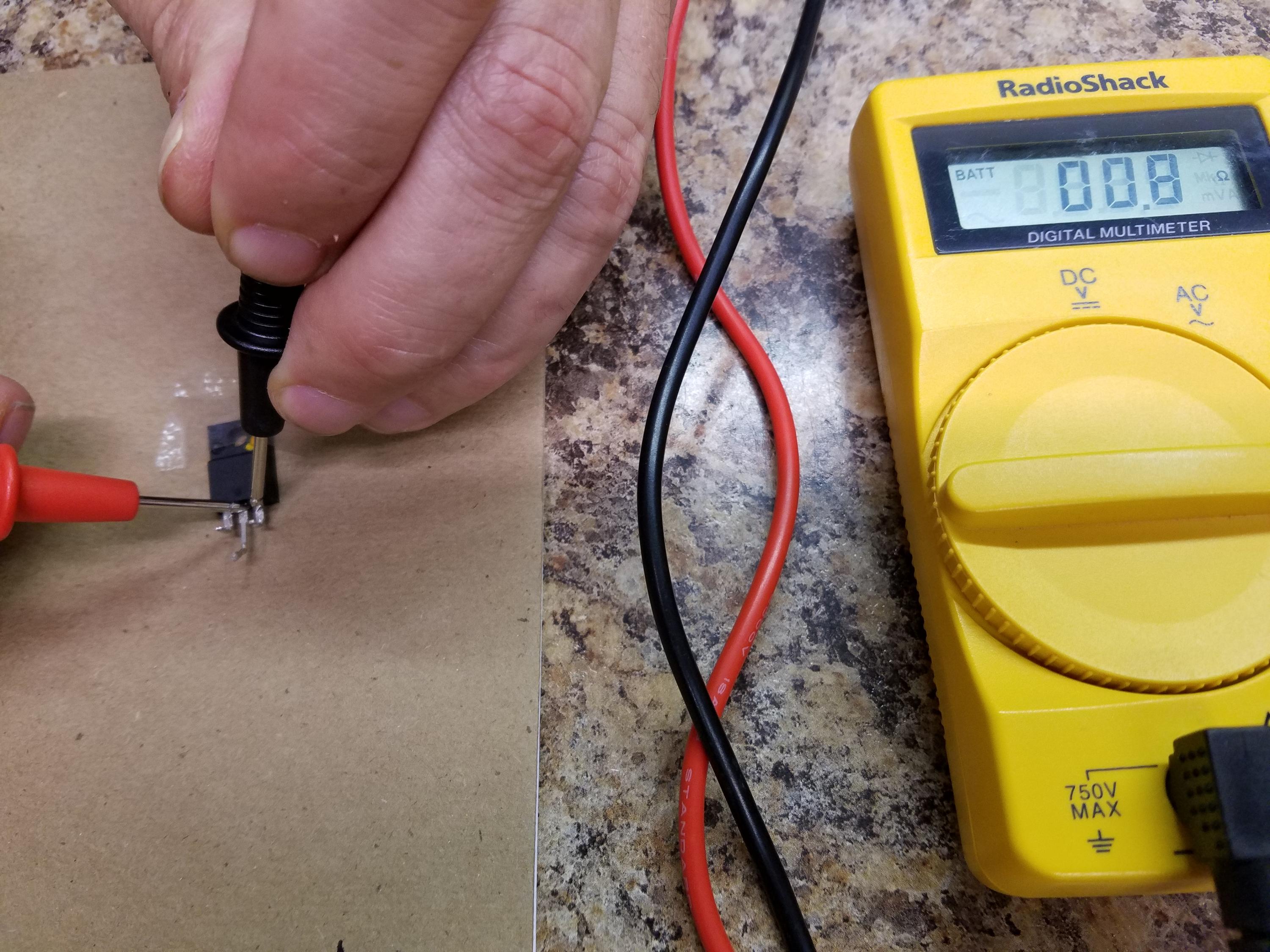

      test results with mosfets out
      Left - 0.0
      Middle - 0.0
      Right - OL on the cheap multimeter, no read on upper end meter
      Left and right chip are a Magnachip 60R360P
      Middle chip is auk ck617 sf10a600HPI

                Here is the pictures of the tests, hope it helps

                      So the two MOSFETs tested BAD per your pictures per post 27, so the PFC IC may be damaged also. I would replace both MOSFETs and the IC at the same time.
