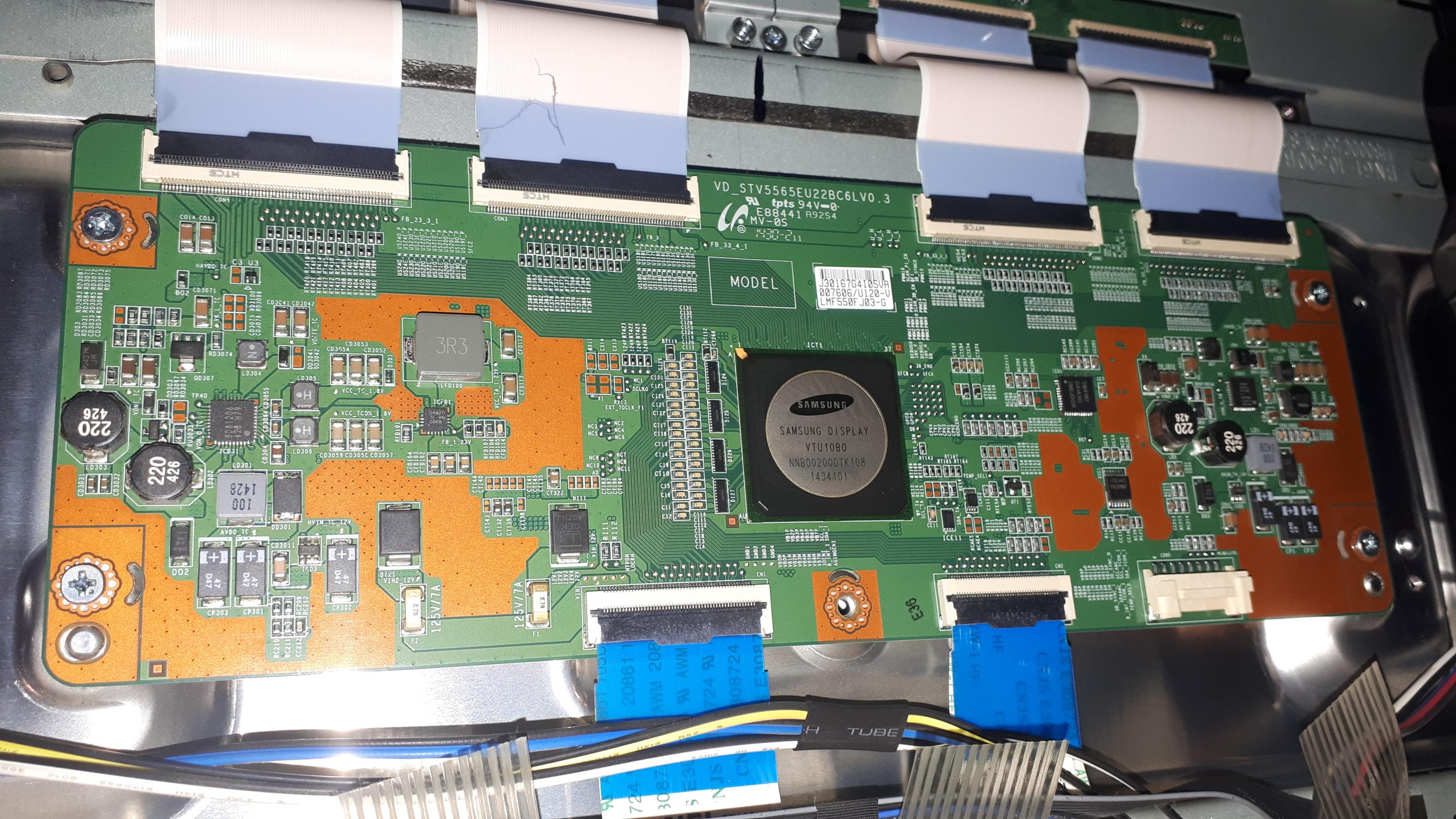

Samsung ue55hu8500t tcon board fuse blowing
  • Chrissygizmo
    • Mar 2021
    • 145
    • United Kingdom
    Hi , I've got a Samsung UE55HU8500T that has sound but no picture, I've had it open and done a quick check of voltages etc, I found that the F2 fuse on the tcon board had blown (T-CON BOARD VD_STV5565EU22BC6LV0.3 -) so I replaced it with a similar value fuse but still nothing, ten I noticed the replacement fuse had blown too . I would appreciate any help with this. Thank you in advance
  • diif
    • Feb 2014
    • 6978
    • England
    Re: Samsung ue55hu8500t tcon board fuse blowing

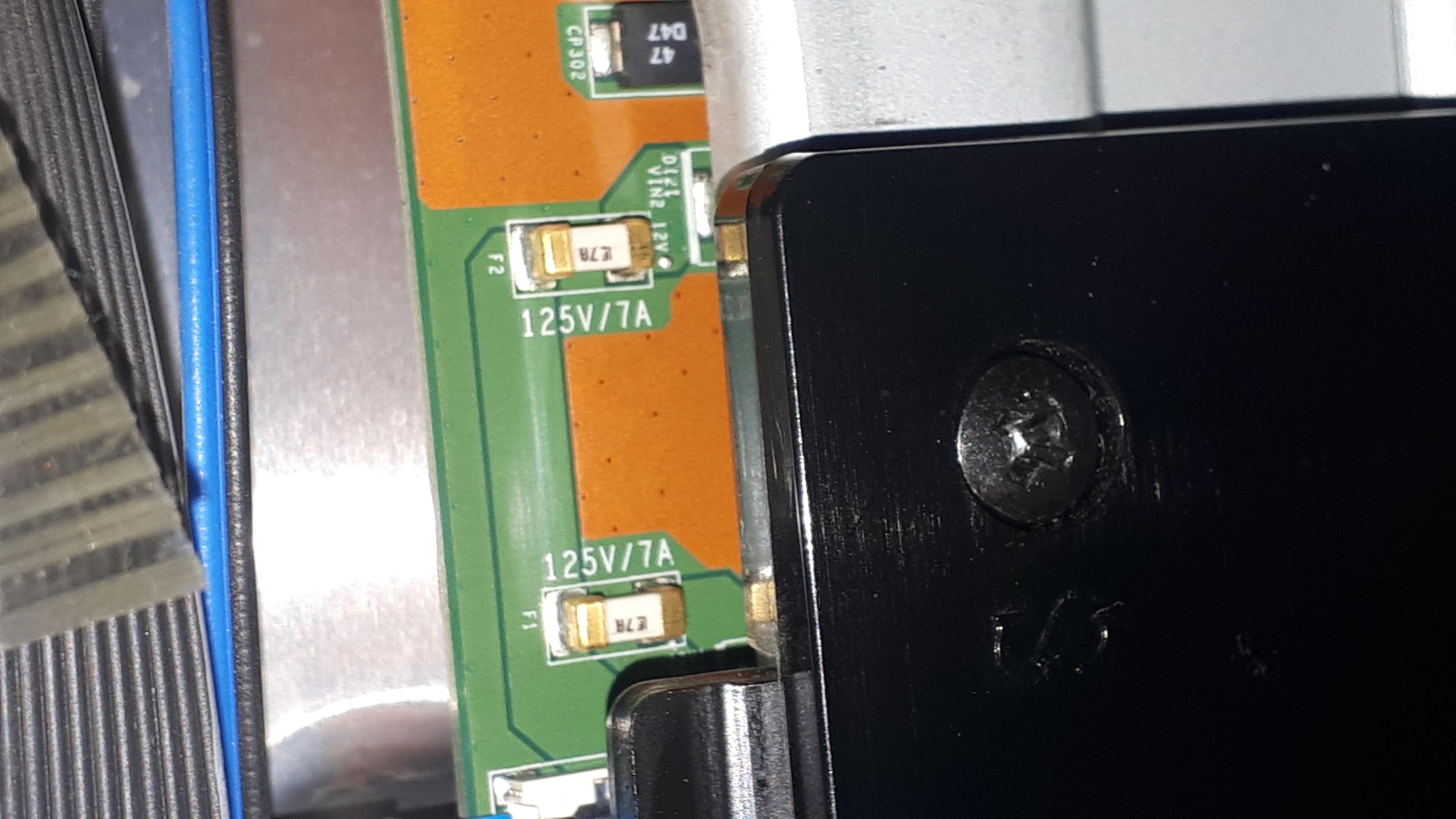

    I see two fuses, did you check the diodes next to them, you have a short somewhere.

      Thanks for your input, no I only checked the fuses , I will check the diode later, Could I just ask you to point out the diode that I should be checking please? I was going to go around the board and googling each component to find out which ones are diodes , as you can gather I'm new to this.

        Diodes are prefixed with D so D111 & D121 are diodes

            Yeah I checked both fuses , I've just checked both diodes and here's the readings..
            D111 - 4GZNJ - 559 / OL
            D121- 4GZNJ - 000 / 000
            I am guessing that D121 needs replacing and is there a compatible diode I can try for testing purposes tonight as I'm having trouble trying to find the exact same one on the old boards i have to hand .

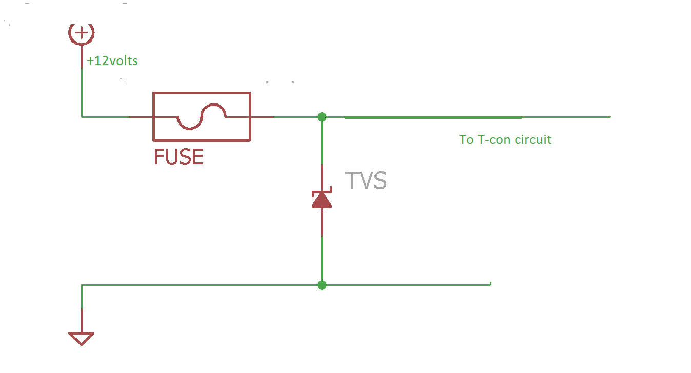

              D121 is a littlefuse SMCJ14A tvs diode (14v protection diode) you should be able to remove it and check the board operation. If the board works ok, install a new protection diode.
                Thanks for that, do you mean I can remove the diode and put the board back into the tv to try it ? If I get a picture then order a replacement diode ? Put a new fuse in before trying though I'm guessing? I thought by removing a component from anything there wouldn't be a circuit so it couldn't work ?
                • R_J
                  • Jun 2012
                  • 9628
                  Yes you can remove the diode, install a fuse and check the board. The diode is there to protect the 12 volt line from any spikes above 14v, For some reason it shorted, either from a voltage spike or it was just it's time, If there was a voltage spike, both protection diodes should have shorted.
                  The diodes should be between ground and the +12 volt input

                      There is not a BREAK in the circuit, The diode connects ACROSS the 12 volt input.
                        Just think of it simple example, such as AC outlet strip, one with surge protector device installed and another one without. If you remove the surge protector device from the outlet strip with surge protector, the outlet strip will still work and provide power to the socket but it will no longer has surge protection.

                            What BOX are you talking about? If the fuse is open, the t-con is not going to work at all so you will not see anything on the screen.
                            Remove the shorted diode, check it after it is removed to be sure IT is shorted and not something else on the board, If it is just the protection fuse that is shorted, install a fuse and try it.
