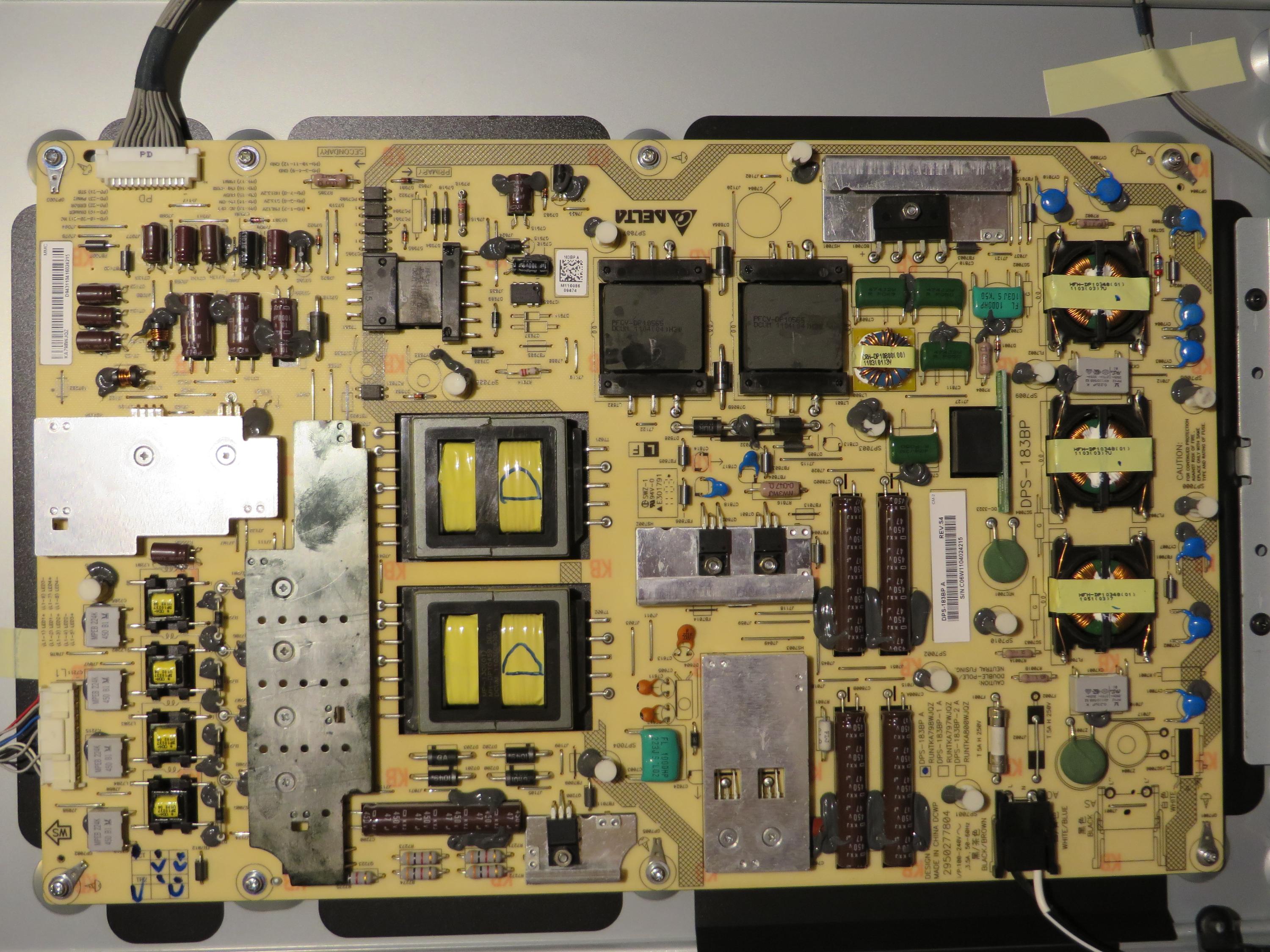

    I have inherited my fathers old TV it's a Sharp LC-60LE831U. It was powering on and off randomly until IC7905 blew it's top (TY264PN) I replaced it and the TV still didn't power up. I traced down that the 2.2 ohm fusible resistor R7914 was blown so I have replaced that and still no joy.
    I am measuring 164VDC on the two outside legs of the rectifier.
    On the TY264pn using pin 3 as ground I am measuring
    1) 0.5VDC 8) 0.0VDC
    2) 0.0VDC 7) 0.0VDC
    3) GND
    4) 0.0VDC 5) 164VDC
    There is no voltage going to the mainboard connector. There are no blinking lights on the front.
    Please help me troubleshoot this TV.
    Thanks,
    MattBatt

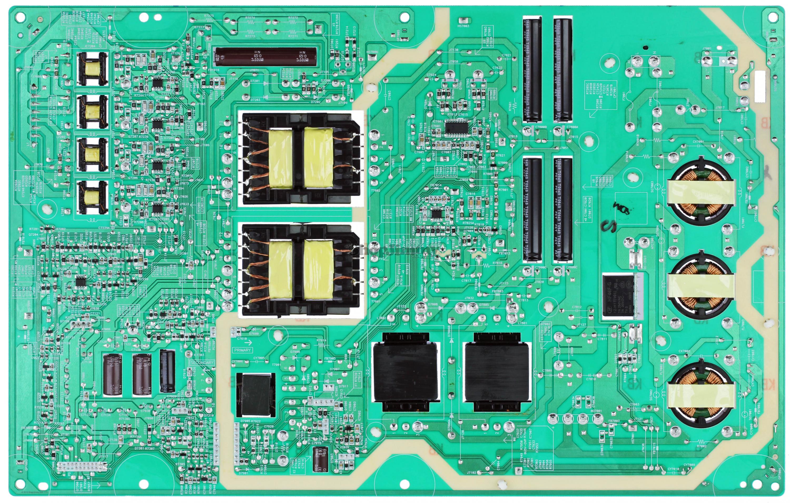

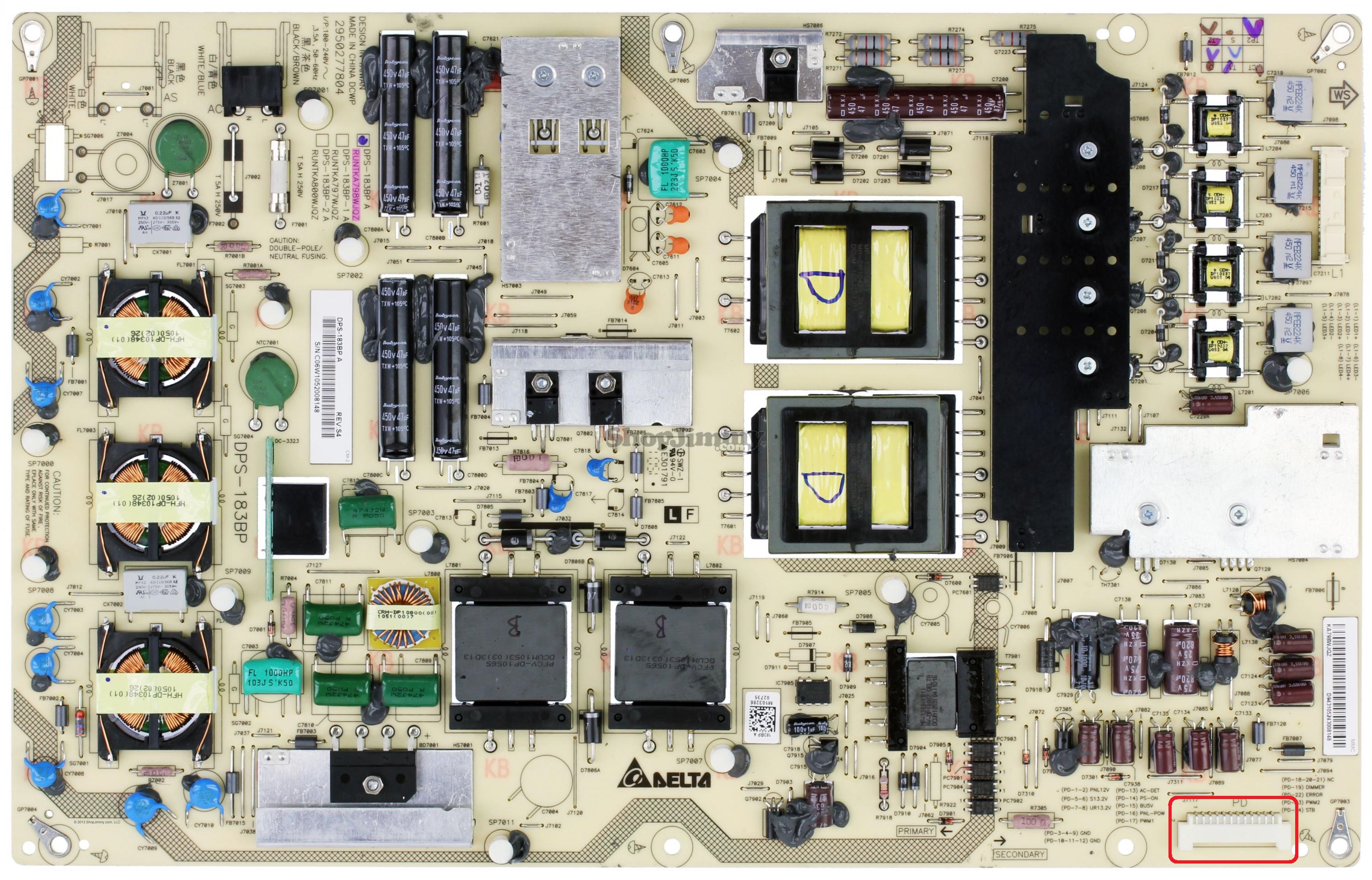

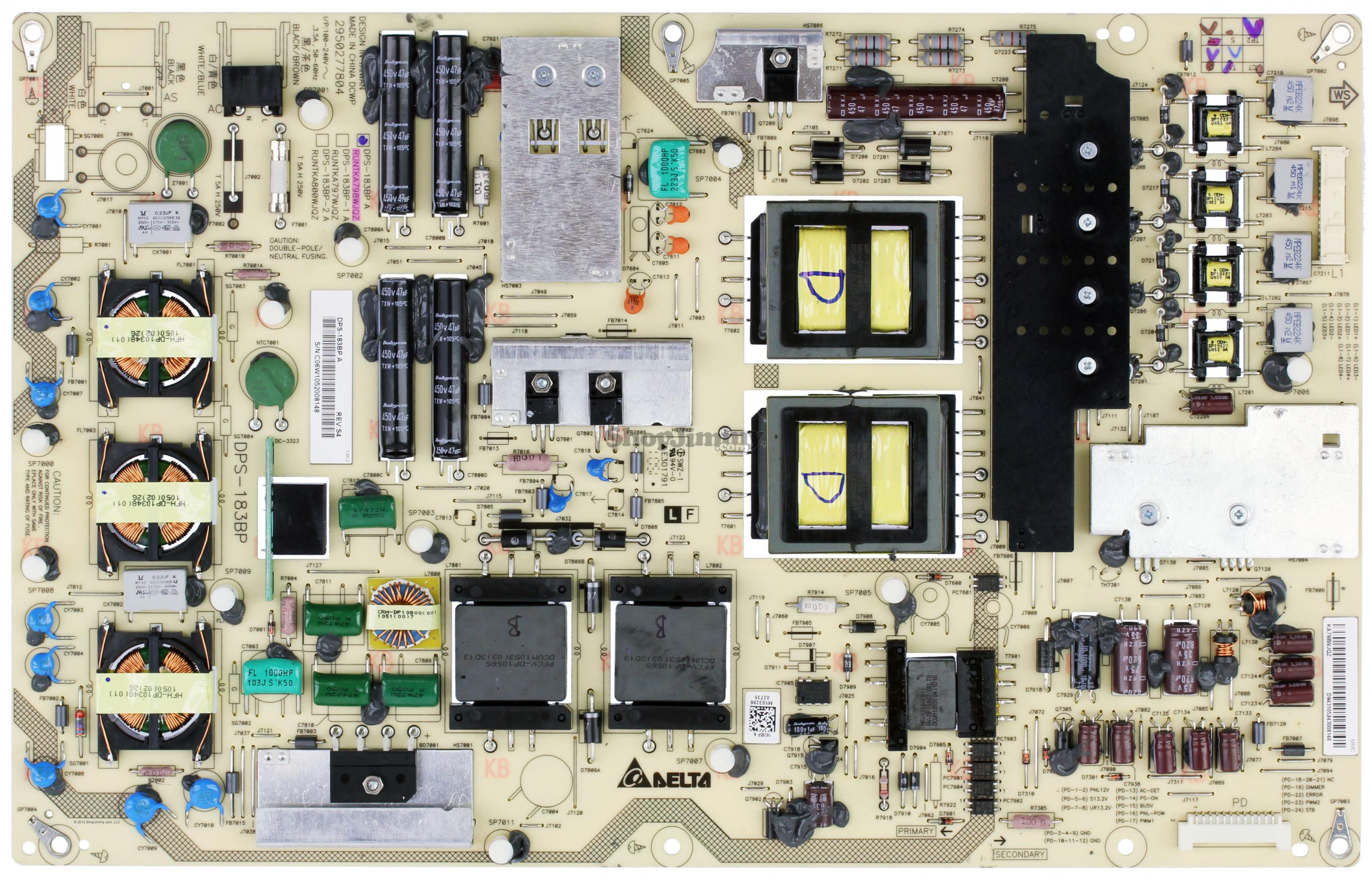

    Need good pictures of front and back of power board
      Re: Sharp TV no longer powers on
      Darn it I forgot to put the powersupply model numbers in the first post
      Delta DPS-183BP A
      RUNTKA798WJQZ
      Jimmy took better pictures than I can.
      When I get home from work tonight I can try taking some.
      No caps look blown.

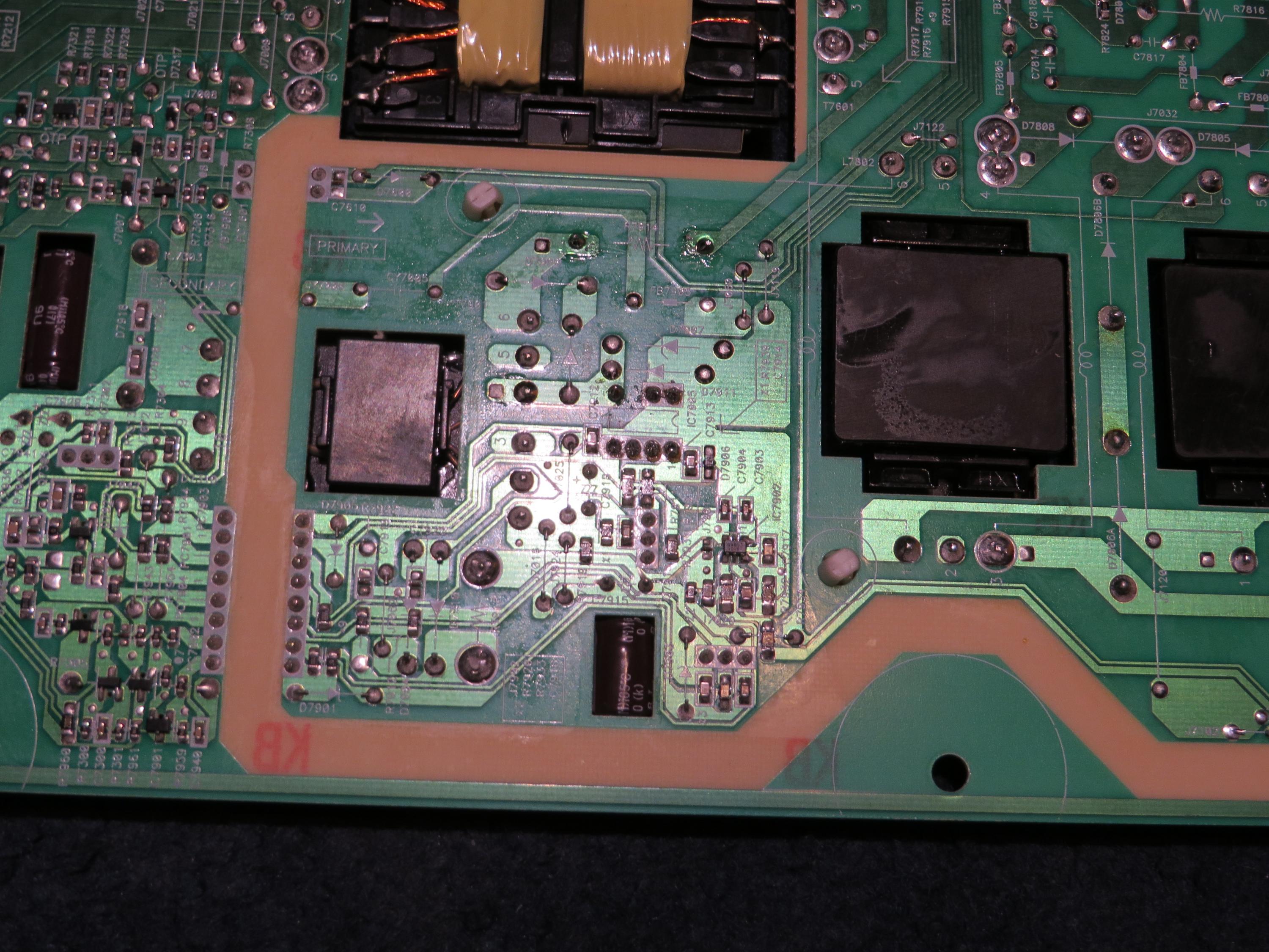

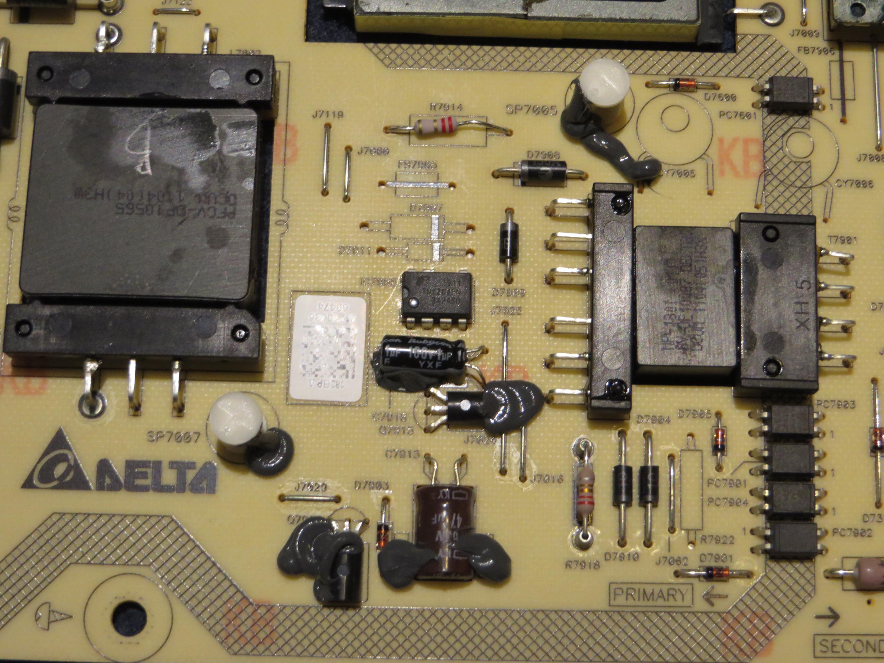

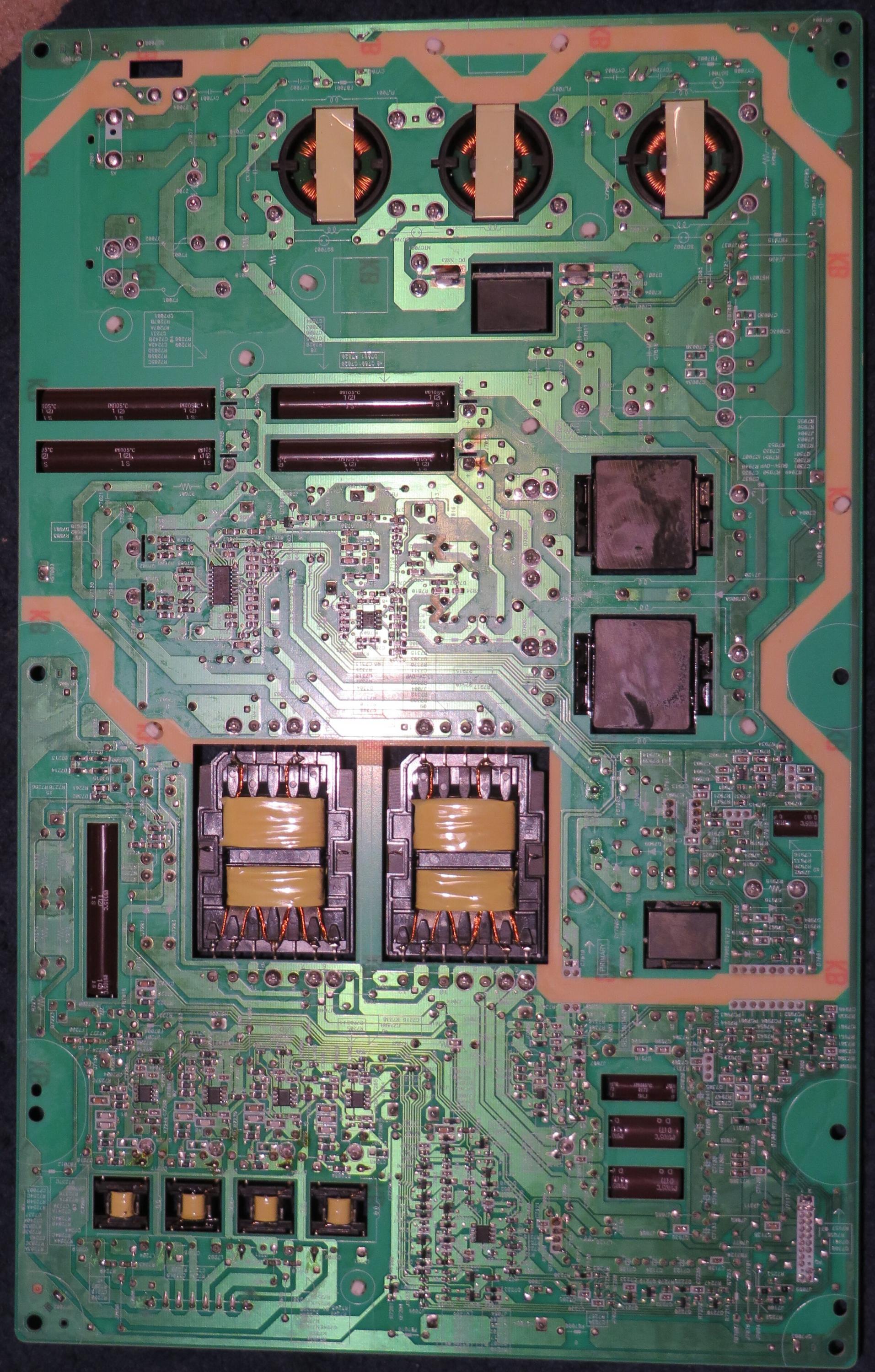

        OK I took some pictures let me know if there is an area I can highlight further.
        Thanks for the help
          So I am guessing you have no 5V STBY voltage. Check if the 5V STBY rail is shorted (secondary). If you have juice going into the TY264pn, but nothing coming out, may be a good chance it is bad, needing to be replaced.

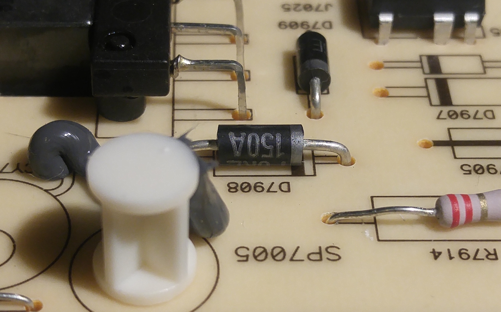

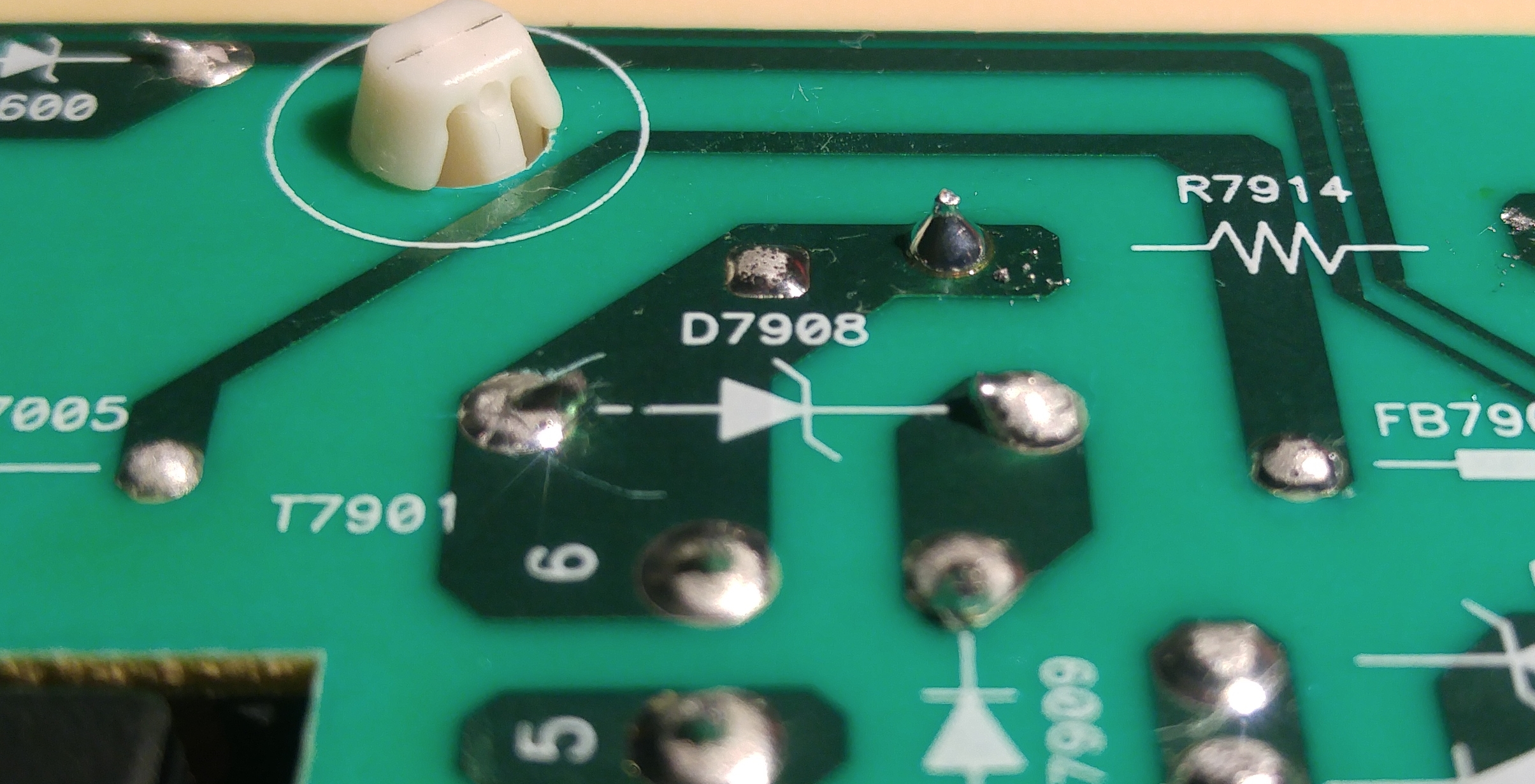

                            Alright so next up on the test block is D7908 which has the symbol of a zener Diode. It has "P6KE 150A" printed on it. I looked it up it's a TVS diode (new to me).
                            Removing it from the board and using my diode test it reads 0.6V forward bias and OL reverse bias. In resistance mode it reads OL in forward bias and 13.743 Ohms in reverse bias.
                            The next component in series with the chip is R7909 a BYV26E which is reading 0.5V forward bias and OL reverse in diode mode on the DMM
                            I suspect these might be bad since I can follow the positive bus from the capacitor bank to R7914 (bad replaced) - D7908 (?) - D7909 (?) - IC7905 (bad replaced).

                                Can you give the voltages at the connector marked PD
