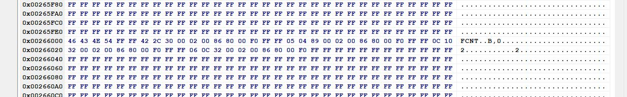

                        Update: BIOS was reflashed to ME clean. Same exact symptoms.
                        It DOES write to BIOS (I read back from it to see if it had changed), which I think is a good sign. But still no POST (CAPS LOCK test still negative).
                        My next idea would be to go for broke and replace PUZ1 or inject ~1.8V directly to VCC_CORE to see if any signs of life, but suggestions are appreciated.
