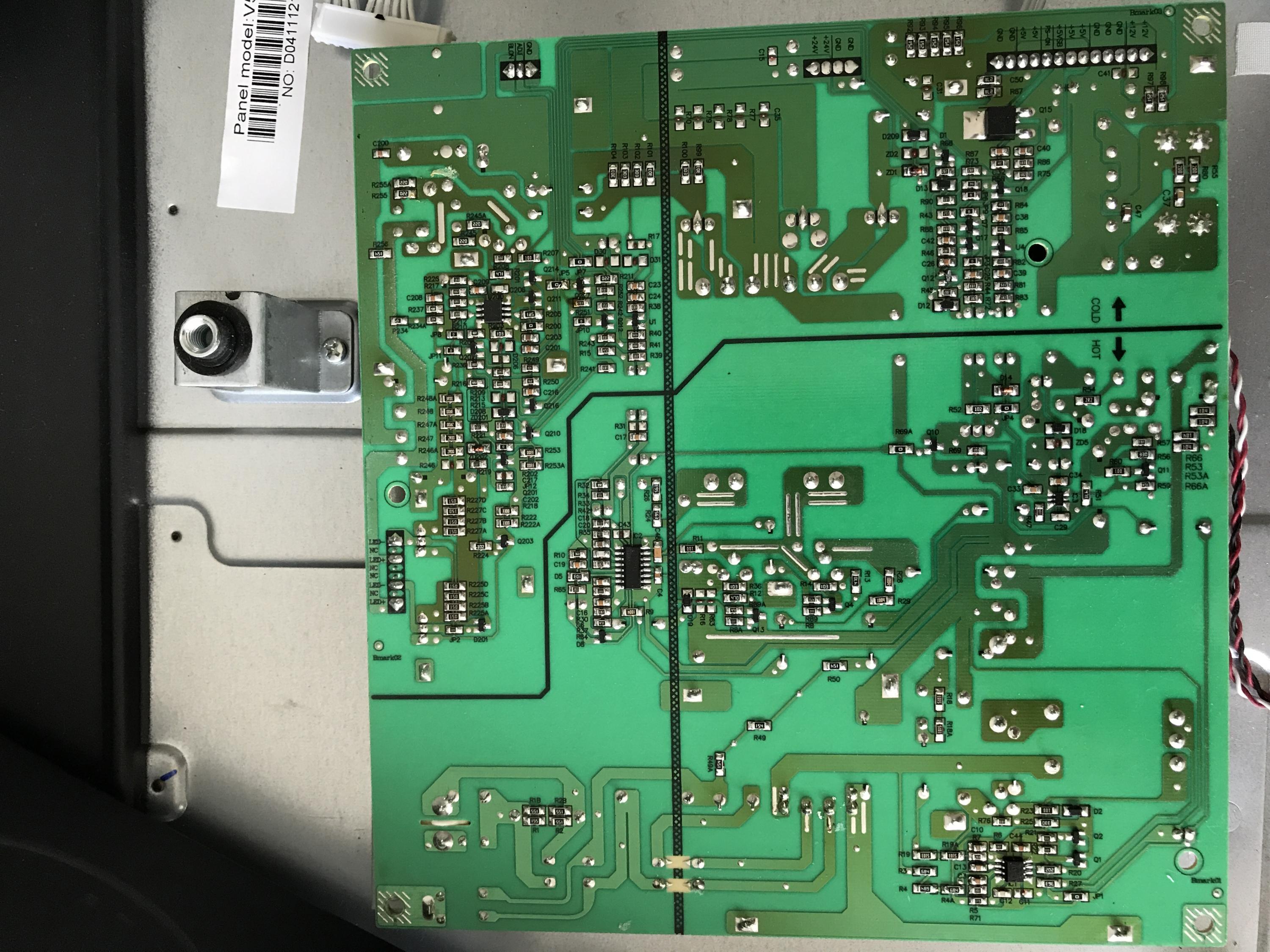

                Re: RCA no power indicator
                I would say you have a bad power supply. If you want help troubleshooting it will need good pictures of back of board with traces exposed
                  More in depth power supply troubleshooting required. Need good straight shot high res of the top and bottom side of that power supply board.
                  • Minkota
                    • Jul 2017
                    • 30
                    • United states
                    #29
                    Ok, I will post a photo later tonight. Thanks again.
                      Attached is the picture of the backside of the Power Board.
                      • Minkota
                        • Jul 2017
                        • 30
                        • United states
                        #31
                        I don't see anything obvious, maybe someone with more experience can spot something

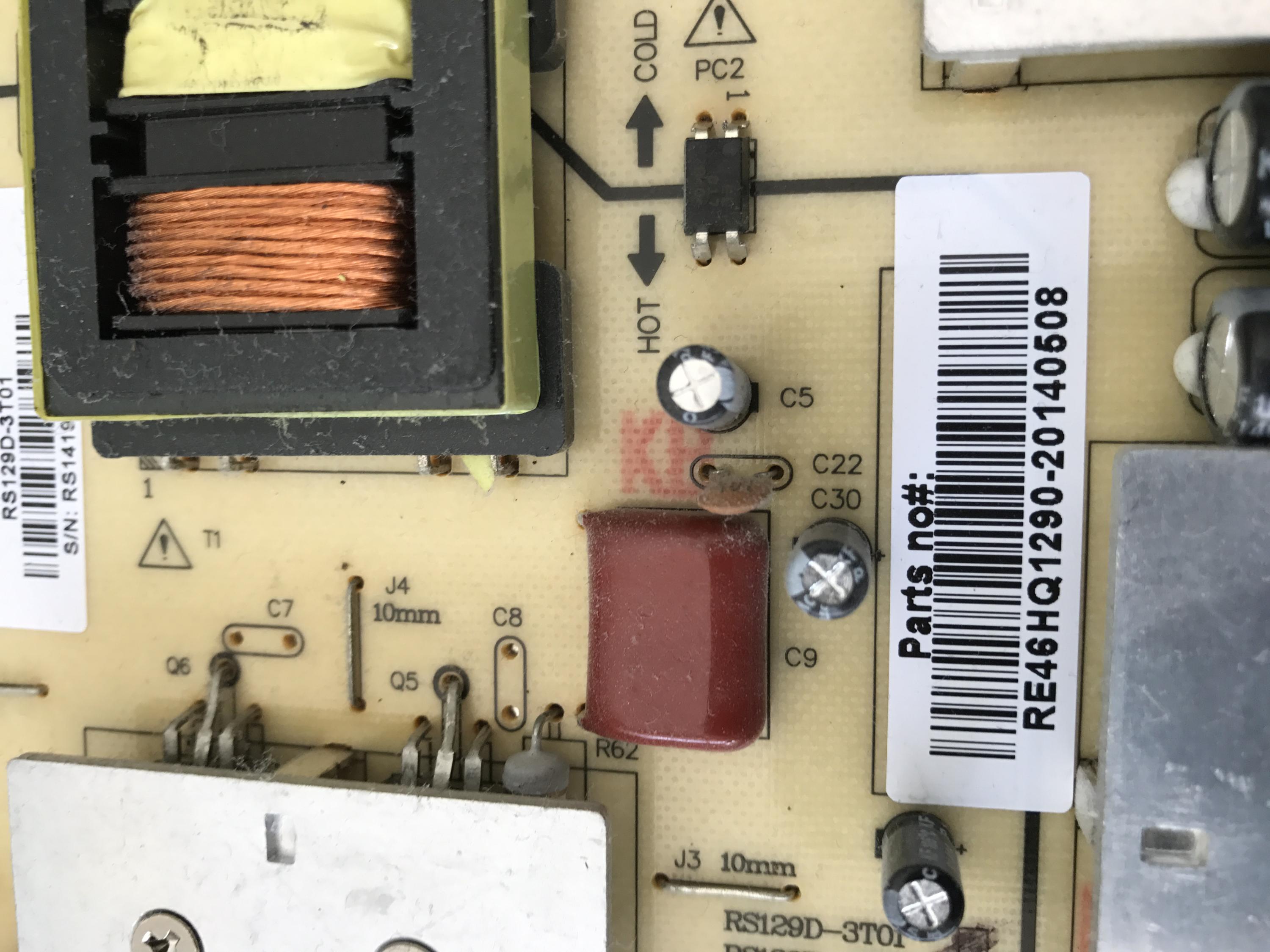

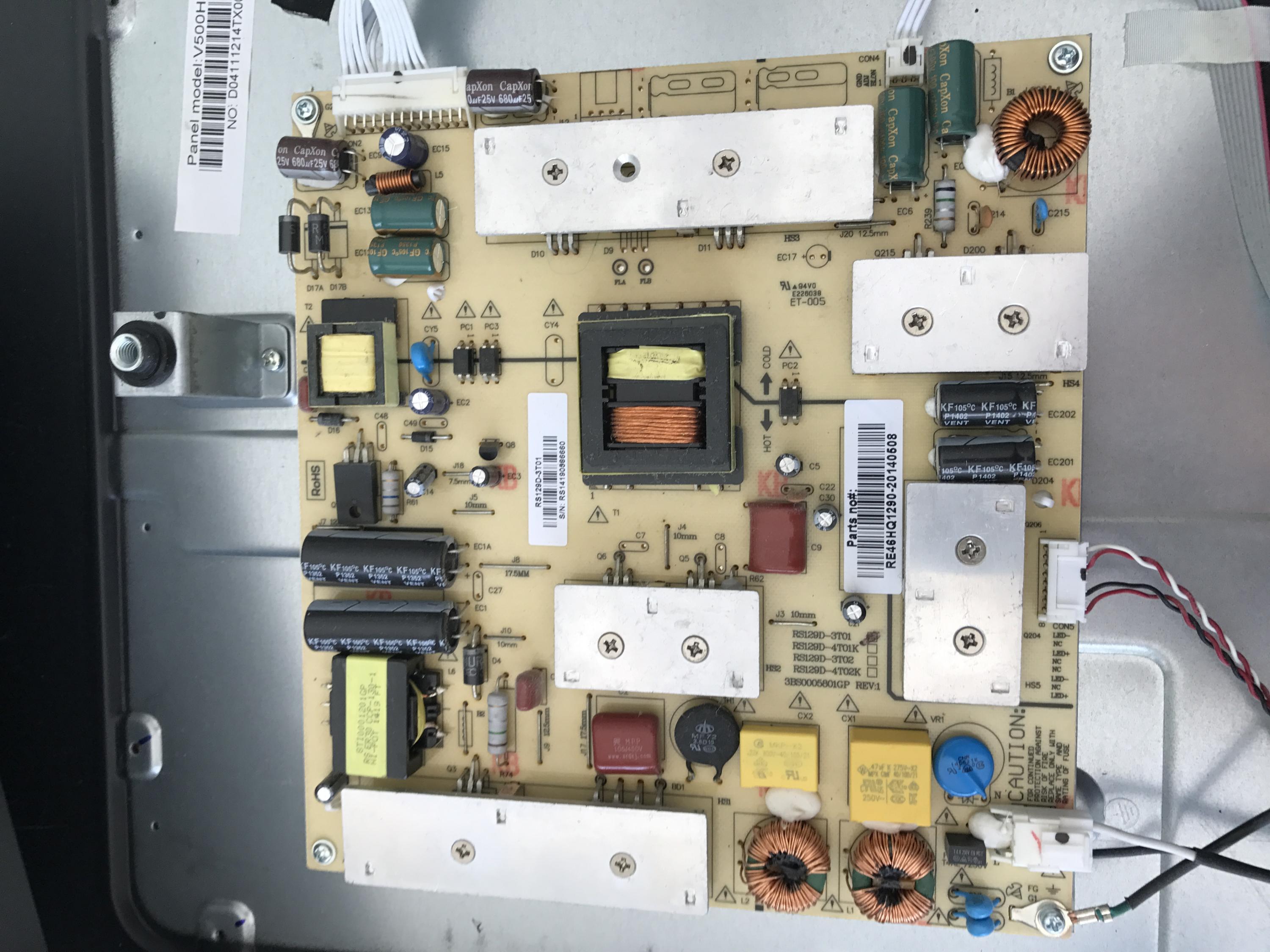

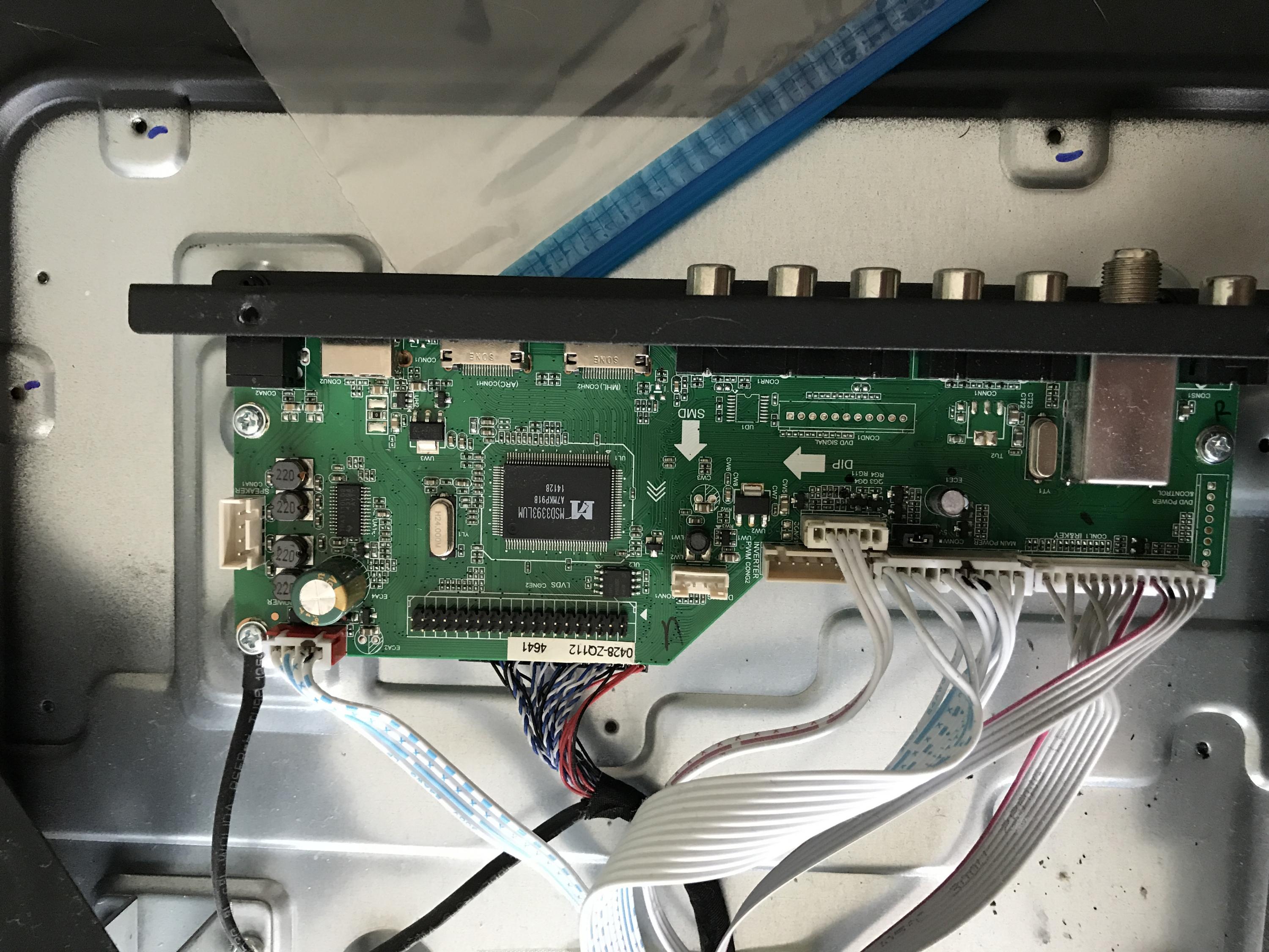

                          Originally posted by Minkota
                          I did that and the voltages stay the same.
                          The PSU should only produce 5VSB with the main board disconnected. Nothing else. You can't get to read any other voltages on the secondary with the main board disconnected, until you supply 5VSB to PSon. Just sayin...
                          Can we see the component side of the PSU too?
                          While you are at it, snap a pic from the main board as well and post the model number of the TV.
                          • Minkota
                            • Jul 2017
                            • 30
                            • United states
                            #33
                            I have attached the pics....

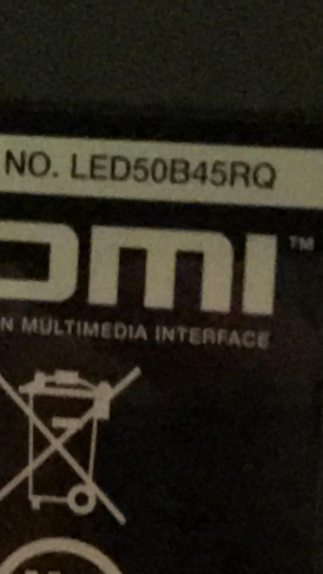

                              #34
                              Pic of model no.

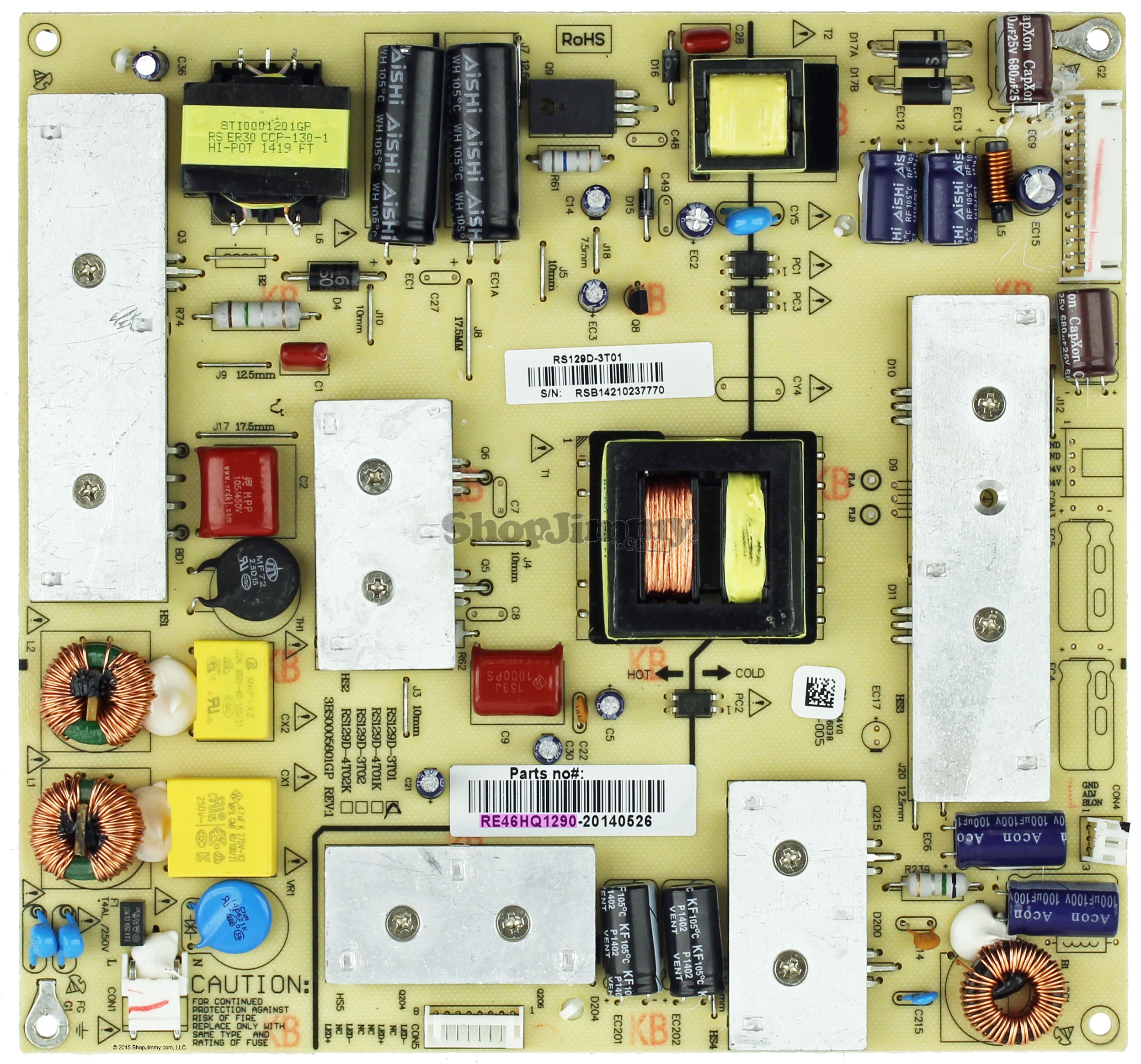

                                #35
                                RCA LED50B45RQ
                                http://www.shopjimmy.com/rca-re46hq1...led-board.htm#
                                RCA RE46HQ1290 Power Supply / LED Board
                                Please check the DCV at the PS-ON pin to see what it shows when TV is plugged in but the power switch is not activated and when the power switch is activated.
                                Pictures provided by shopjimmy.

                                          #40
                                          Q12 top right corner section appears to be disintegrated. 2 up from D12 Also a leaking capacitor can pull voltage down. If that transistor is shorted it could be hitting some resistors that are acting like a voltage divider. if the short was to full ground it would be more obvious and easier to find.
