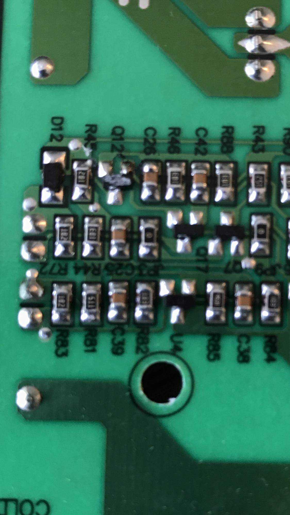

      Q12 on the back side of the board (great photo by the way) is blown apart.
      or there is a piece of trash that looks like foil on the otherwise very clean looking board. Top right of photo near the bottom right of the center coil connectors... 2 up from D12
      OOPS it is the TOP right of the center coil connections
          I see that now, I will see if I can do a continuity test later tonight and see if it is in fact burnt. I will also try to post a close up as well.

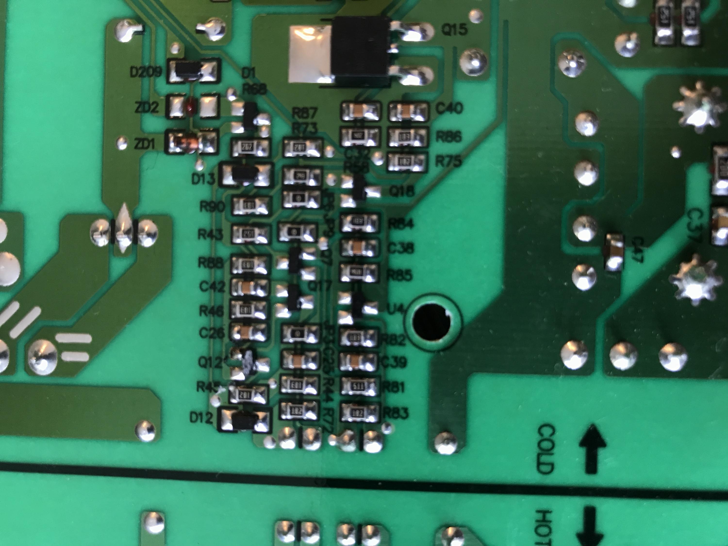

            Attached is a close up of the area in question....

                Originally posted by Minkota View Post
                is it safe to assume this is most likely the cause of the issues?
                Hard to tell from photo could be trick of the lighting... you need to test the transistor... see if it is shorted to ground or shorted thru itself.
                Something is cutting you voltage, but if it was a full short to ground it would either smoke and be obvious or just pull the rail to 0V.
                I had a board once on a computer that had a low voltage issue and after many hours i found a shorted smd cap that was connecting a resistor to ground on a 3.3v line and the math for a voltage divider made it 1.2v and that would not let a mosfet trip on.
                I don't know if that is your trouble just a possibility that is why it is hard to find.
                That part looked completely blown in the other photo but not i'm not sure it may be ok just a lighting illusion... back to the testing board!! (sorry)
