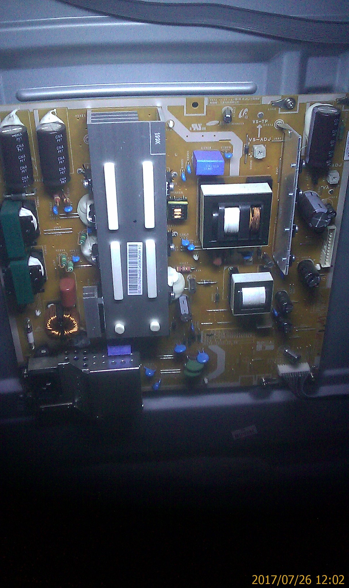

    Pictures ? Of all the boards might help you more to solving your issue

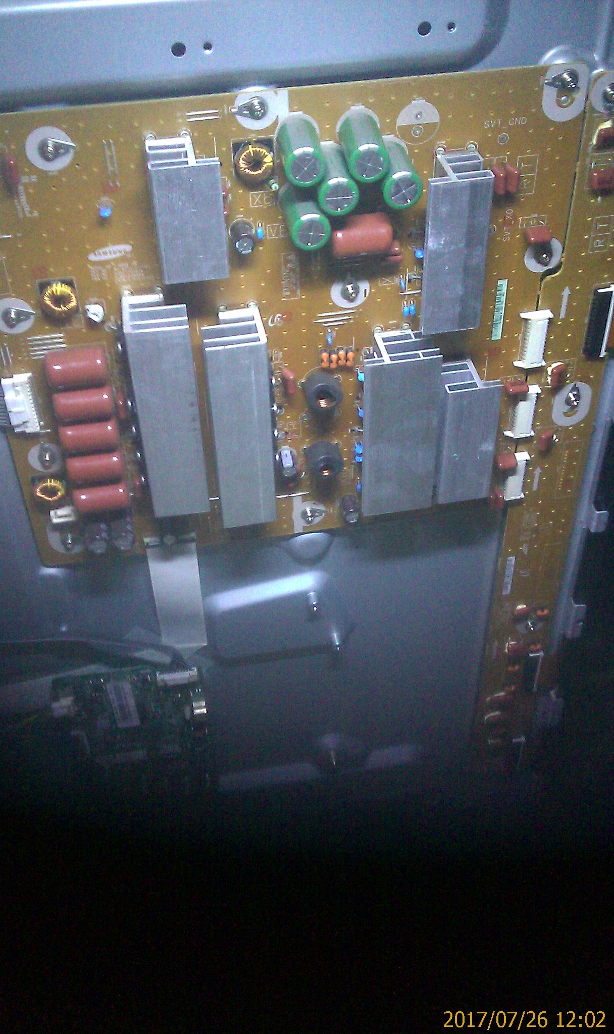

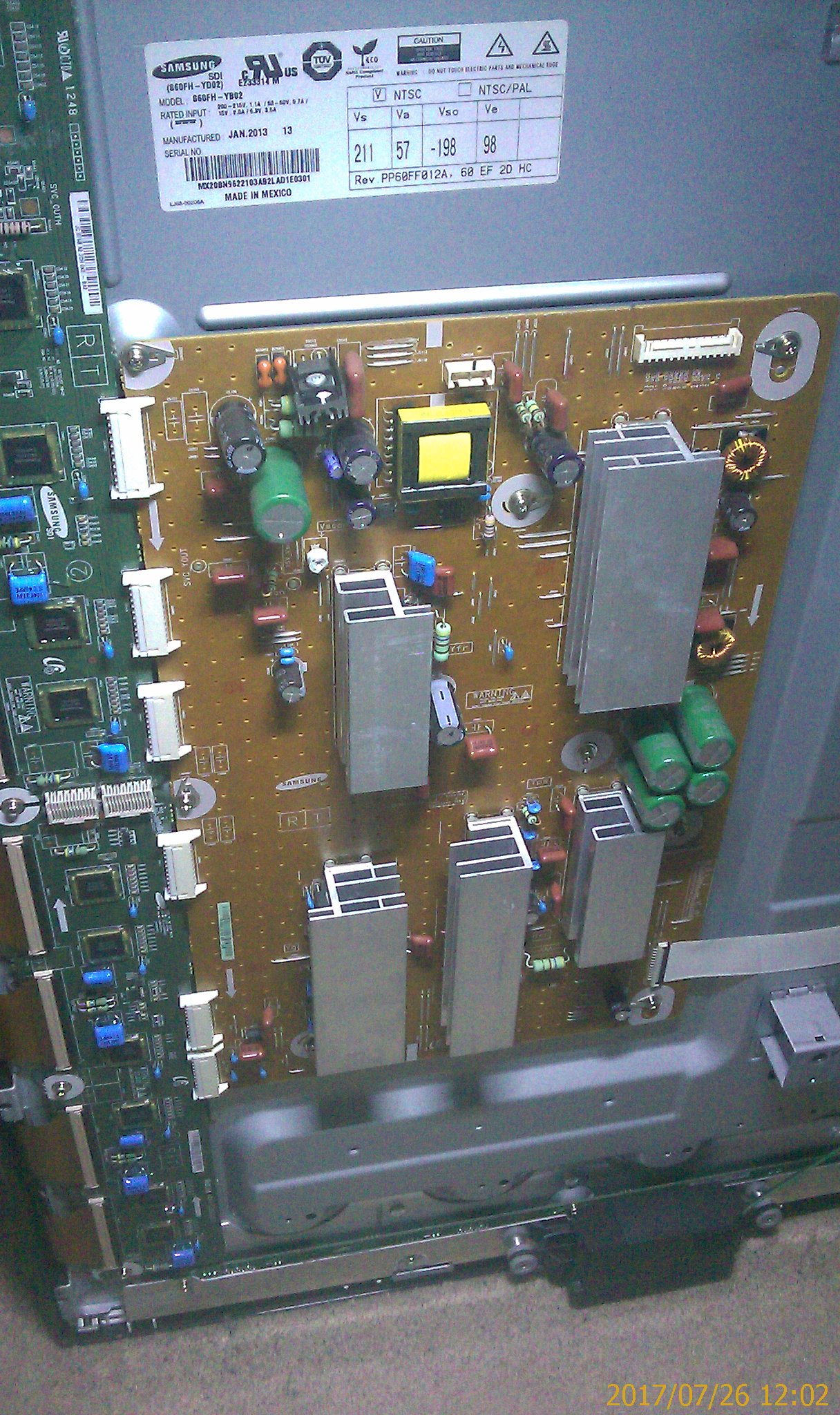

          Re: Samsung PN60E530 plasma tv power on issue
          thank you here are a few photos ob back of my tv....seems they use way less compoennets than they did back in 2006 model plasma tvs

                can someone tell me where the vscan on y and ve on z test points are in my pics if you
                can see...

                      im thinking this is a y or y buffer issue

                        Yes the tests now done give good reason to suspect y side problem. Check y main for short. Samsung boards generally in good supply at reasonable prices.

                          thank you im thinking y also but it seems from research i have done that this is a very common issue with y board....
                          3 bad ceramic caps and 1 bad ic
                          very common..so common they sell the kit on ebay lol
                          cheap enough to buy the parts and try it..so i will look

                                  Update...replaced 3 blue caps on yours..tv now powers on ok with picture
                                  Did not replace the ic....didn't need to

                                      Correction replaced 3 blue caps on ysus ....damn iPad auto fill lol
