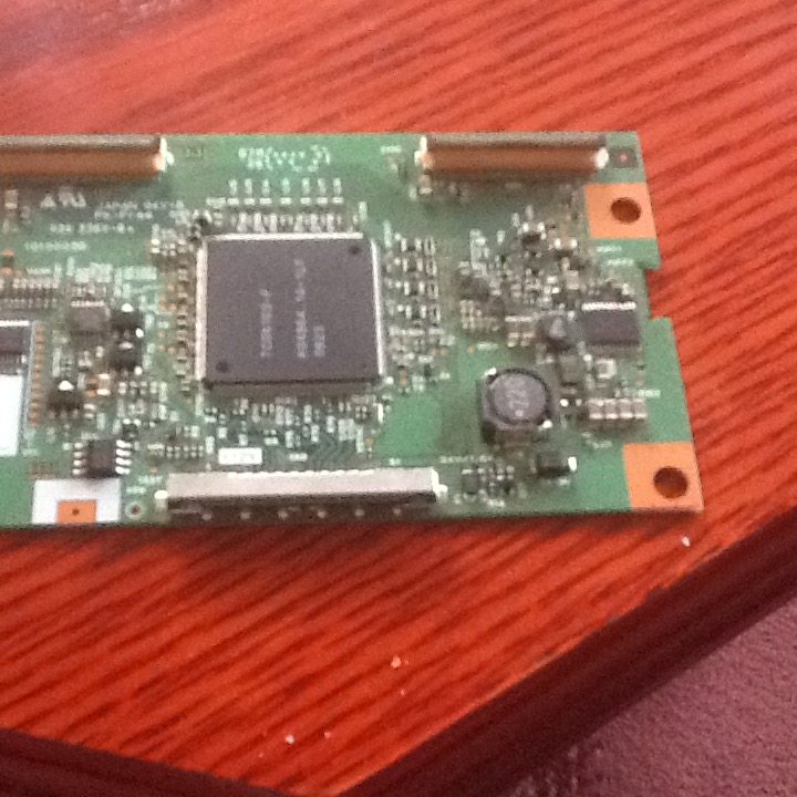

    Hi guys, I have a Panasonic that comes out of standby just fine,then the screen go's a dark blue and that's it,no picture no sound, no graphics, nothing. Any sudgestions?
    Thanks in advance

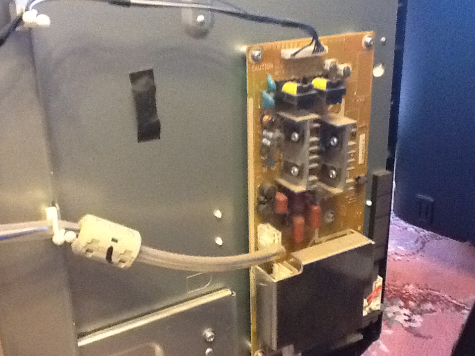

    Need good clear straight on pictures of back of tv with cover off and each board.

      Il take a few pics when I get in later, the back light led's are lit if that's any help.

        check your fuse on the t-con to star with.
        and pics.

          Il have a look for the fuse now, I'm having trouble uploading pics, bloody computers
            Re: Panasonic Tx37lzd80
            Pictures

              Could you give me a hint as to where the fuse is on the t con panel?

                It's just next to the LVDS connector marked 24V/1.6A

                  It looks like the fuse is open circuit, what rating is the fuse, is it 1.6ah as marked on the board?

                    The picture uploaded post #6 appears to be the power supply board. Is that where the blown 1.6Amp fuse is or is it on the Tcon board

                      It's on the t con board 24v 1.6ah

                        Go ahead and replace it with a 1.6A fuse. I suspect it's an smd fuse?

                                  Hello Norman, without any pictures it would be total guesswork as to what type and size of fuse is on your board. If it's smd is it 603, 805, 1206?

                                    Don't know if the quality of this pic is good enough to see

                                        Measure it as best you can and check against the chart. For example if its a 1206 type then it will measure 3.2mm x 1.6mm.
