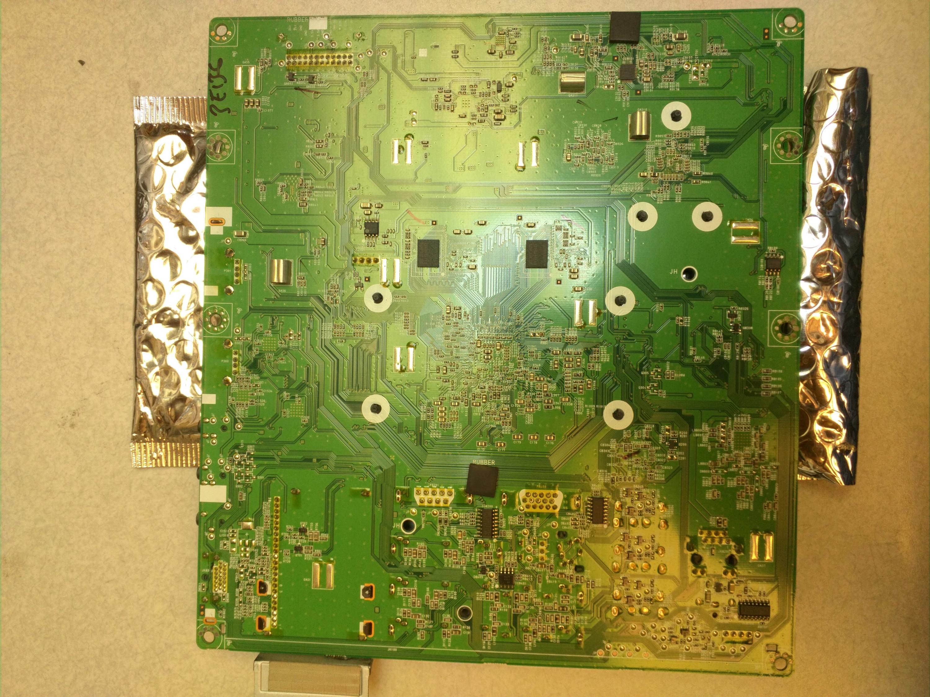

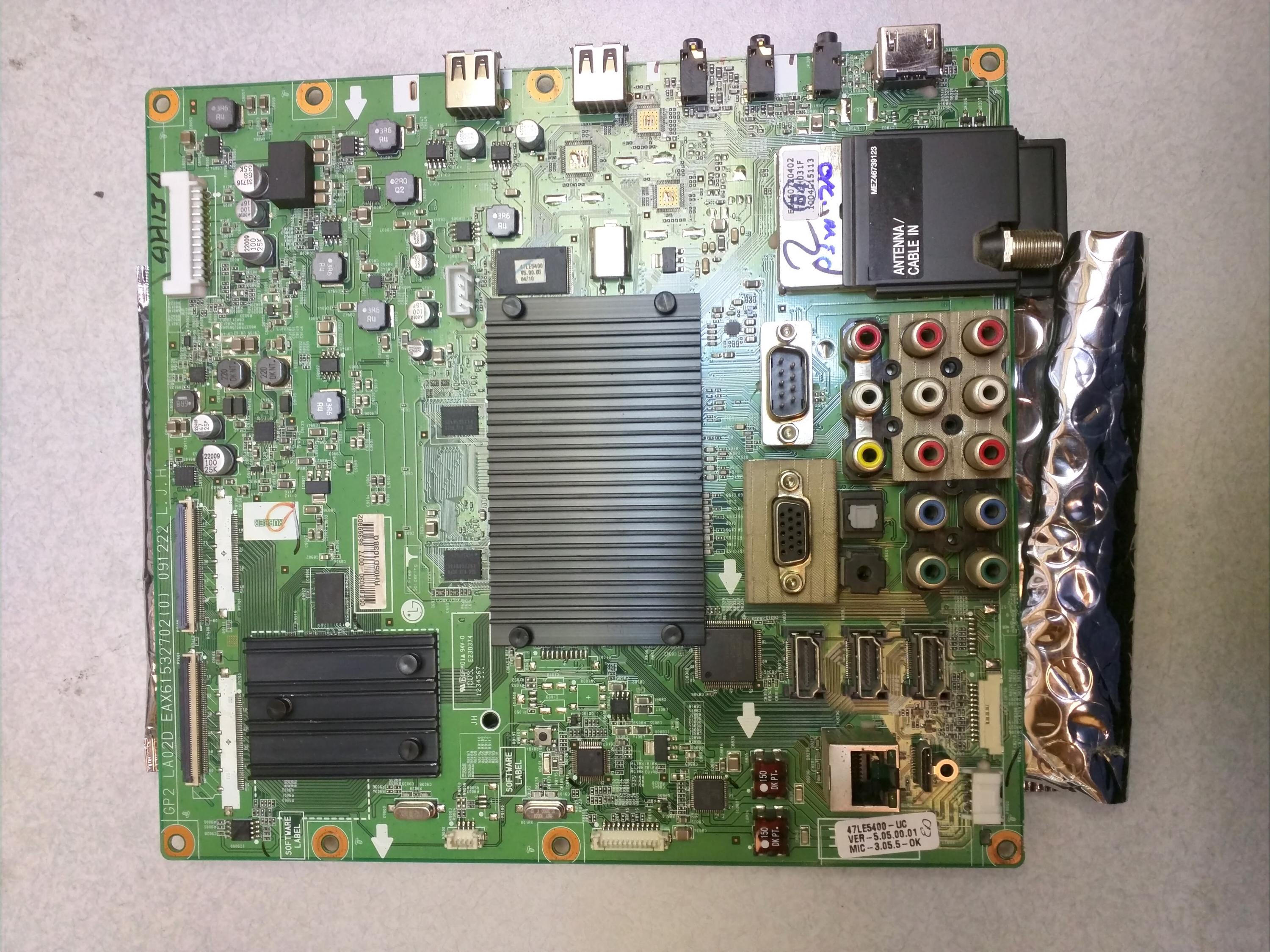

        • cherokee.warrior
          • May 2017
          • 87
          Re: lg 47le5400 powers up, black screen, no sound
          here are the board images.
            Main Bd problem. Since the power LED comes on, etc.

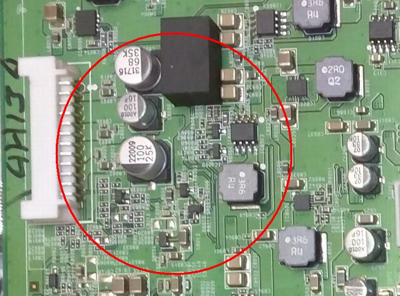

                    Before doing something like baking the board, I've got a similar one that is from an LN5400 that comes to life temporarily if I chill these parts. There are some funny waveforms around the power detect circuit keeping the CPU off line (note: schematic will be not quite the same but very similar). Am investigating it further right now.
                    Does yours change if you chill this area?
                            I removed both heatsinks off the main board and used foil tape to tape around the chips and on the underside of the board. soaked both chips with liquid flux and heated chips with a hot air gun for a while and put board back in tv. TV now works.

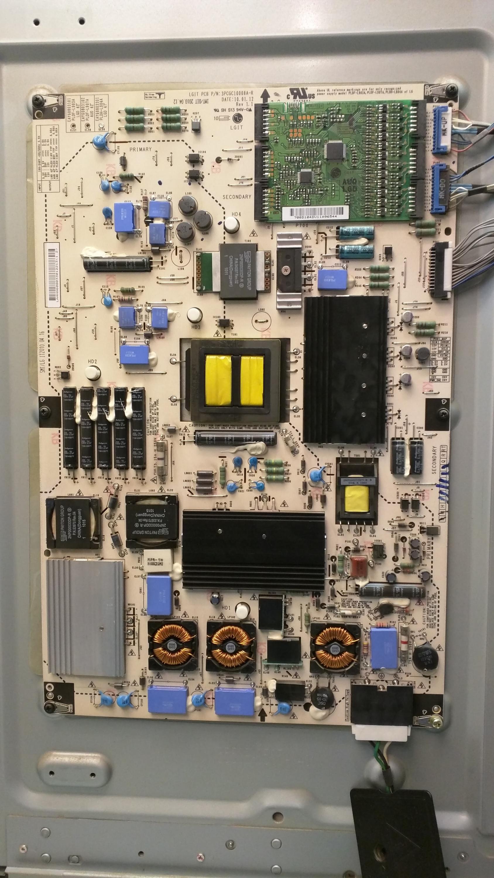

                                  Got LG 47LE5400 with the same symptoms: black screen, no picture. The voltages on the cable that supplies power on the main board (there is a table on the white power supply board with voltages and pins) are as expected. I also tried to put 3.5V on PWR_ON and DRV_ON on unplugged cable and got the TV turning on but no backlight.
                                  Ended up heating two BGA chips that are under heatsinks (preheat the whole board for around 100C for 10 min, put flux around chips, heated the chip on 320C for 5-6min, then got down to 200C for 2 min, then for 100C for 2min) and the TV started working. I removed thermal stickers that were put between chips and heatsinks (the one that was on the chip near the R&L LCD cable sockets degraded due to the high temp or time) and put thermal paste, it should increase the thermal contact.

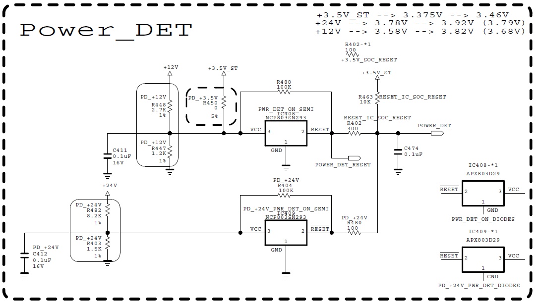

                                      Check all the pins on the connector going from powersupply board to mainboard with multimeter, report all voltages, check in standby which is plugged in turned off, then turn on tv, make note of both conditions. Something like pin 1 ps-on 0v off and 5 v powered on, theres a video how to in the second link there in my signature below.
                                      • maxim22
                                        • Oct 2013
                                        • 5
                                        In PowerOn mode all voltages seem to be OK except PowerOn voltage (pin 1) which is 3.23V instead of 20V (as written on the board).
                                        In StandBy mode there is only 3.4 V on 2 pins (pin5,6), all others are 0V.
