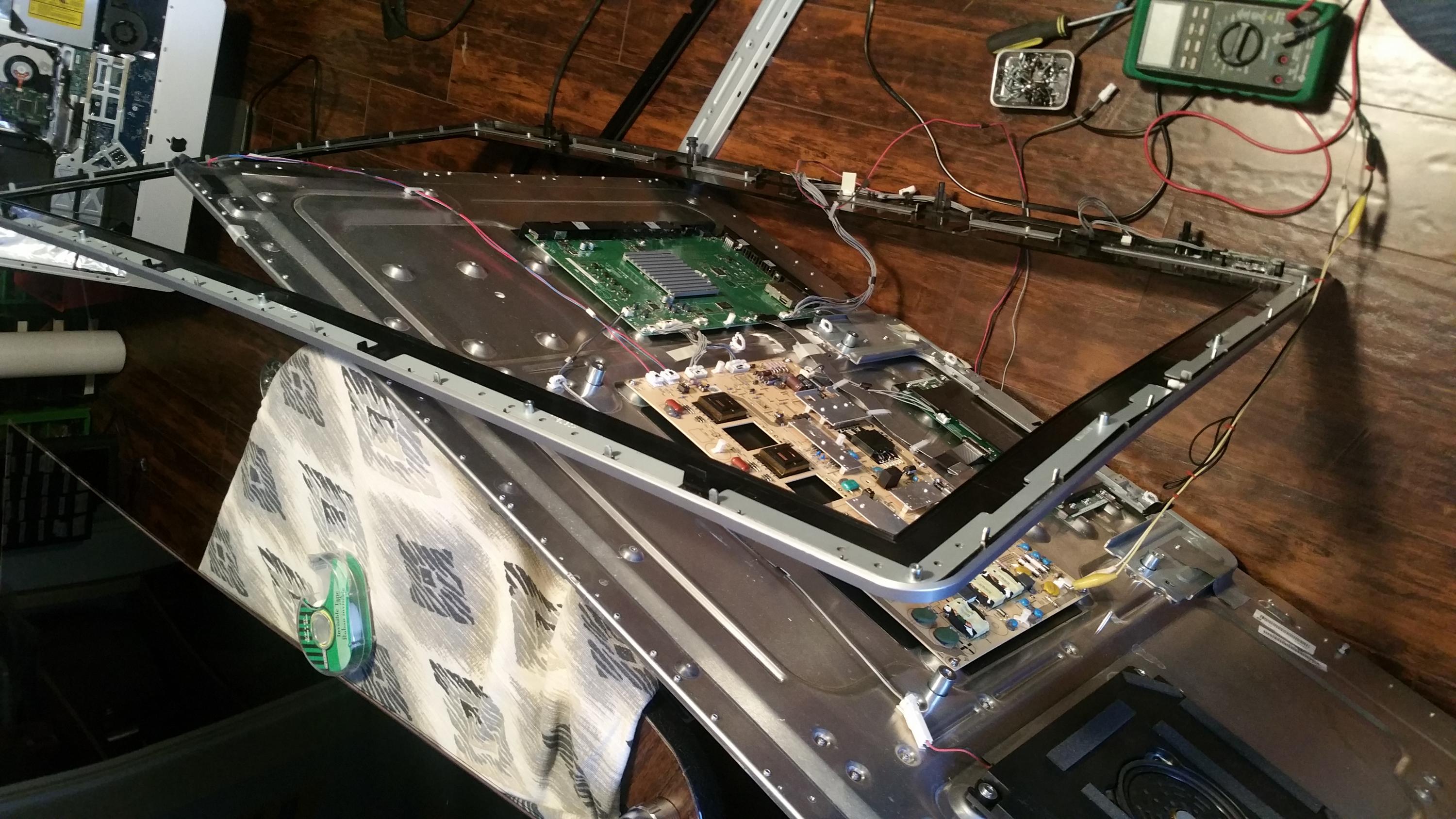

    hey guys,
    Ive been a long time lurker, I am a repair tech and I like to help people out when I can.
    I have the above said set, given to me from a frustrated customer who has had it into 3 different shops and no joy on the repair. pretty odd I thought.
    anyway, the symptom is as follows.
    when the set is totally cold, it fires on no problem and will stay lit sometimes for up to 5 full mins , sometimes more sometimes less. then it starts power cycling. When it cycles the led light and shut down. There is no real code happening here, the set just power cycles every 15 to 20 seconds and tries to start with no joy.
    i have the set fully apart and the lcd panel removed. i can see any issues with the led wiring. if I dont try to start the set the stby is correct 3.3vdc and is sitting there.
    if i unplug the lamps i get the 1 long 1 short error code, but when I plug them in it just repeats the behavior.
    so, any tips? ive looked over the power supply, nothing is getting hot, caps seem fine, esr levels are all good, and capacitance also seems fine. This does seem like a capacitor issue to me thats for sure so Im wondering if i should change them anyway just to see. other than that I cannot find a single thing wrong at the point.
    any help appreciated if anyone has seen this before.

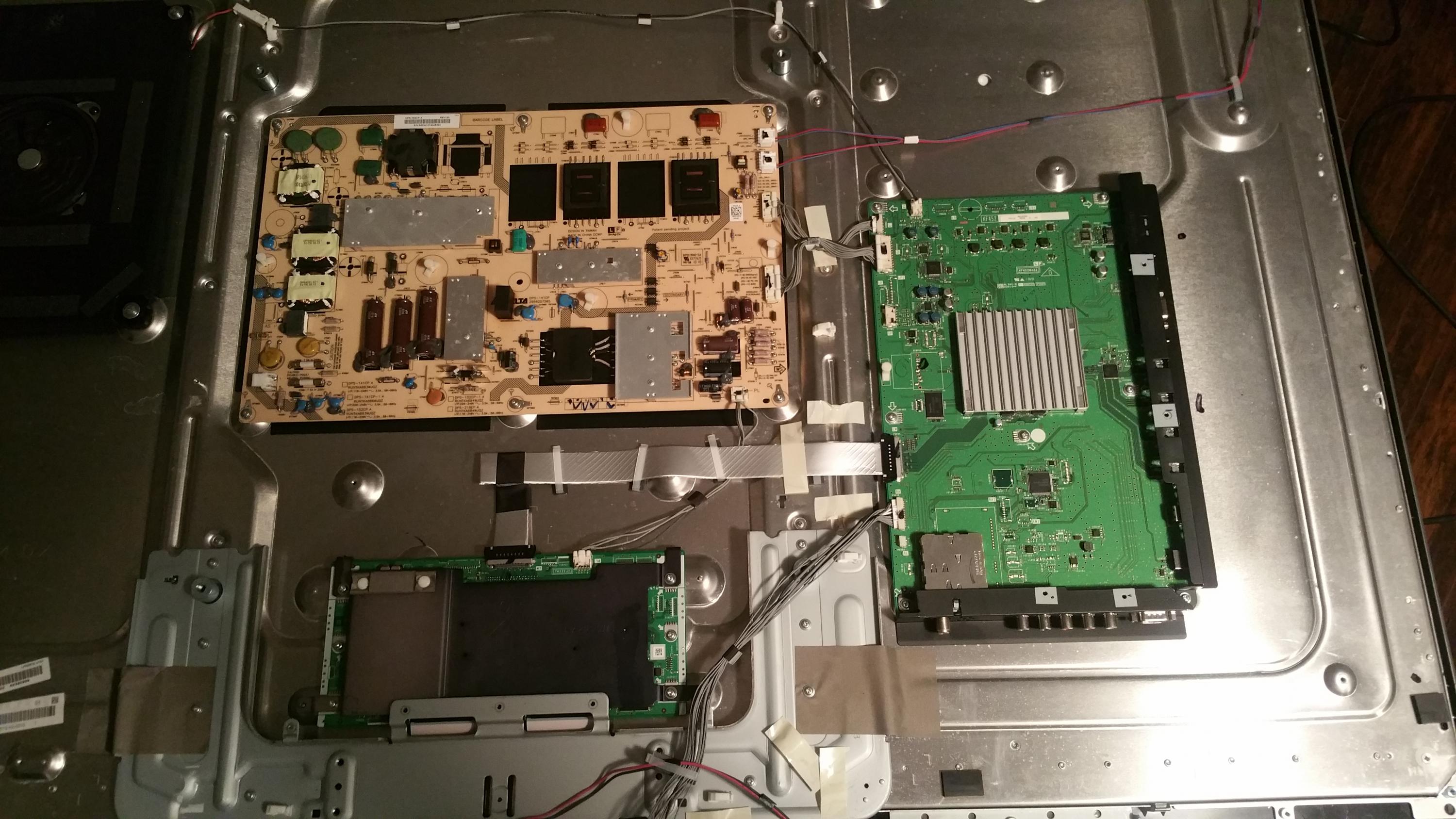

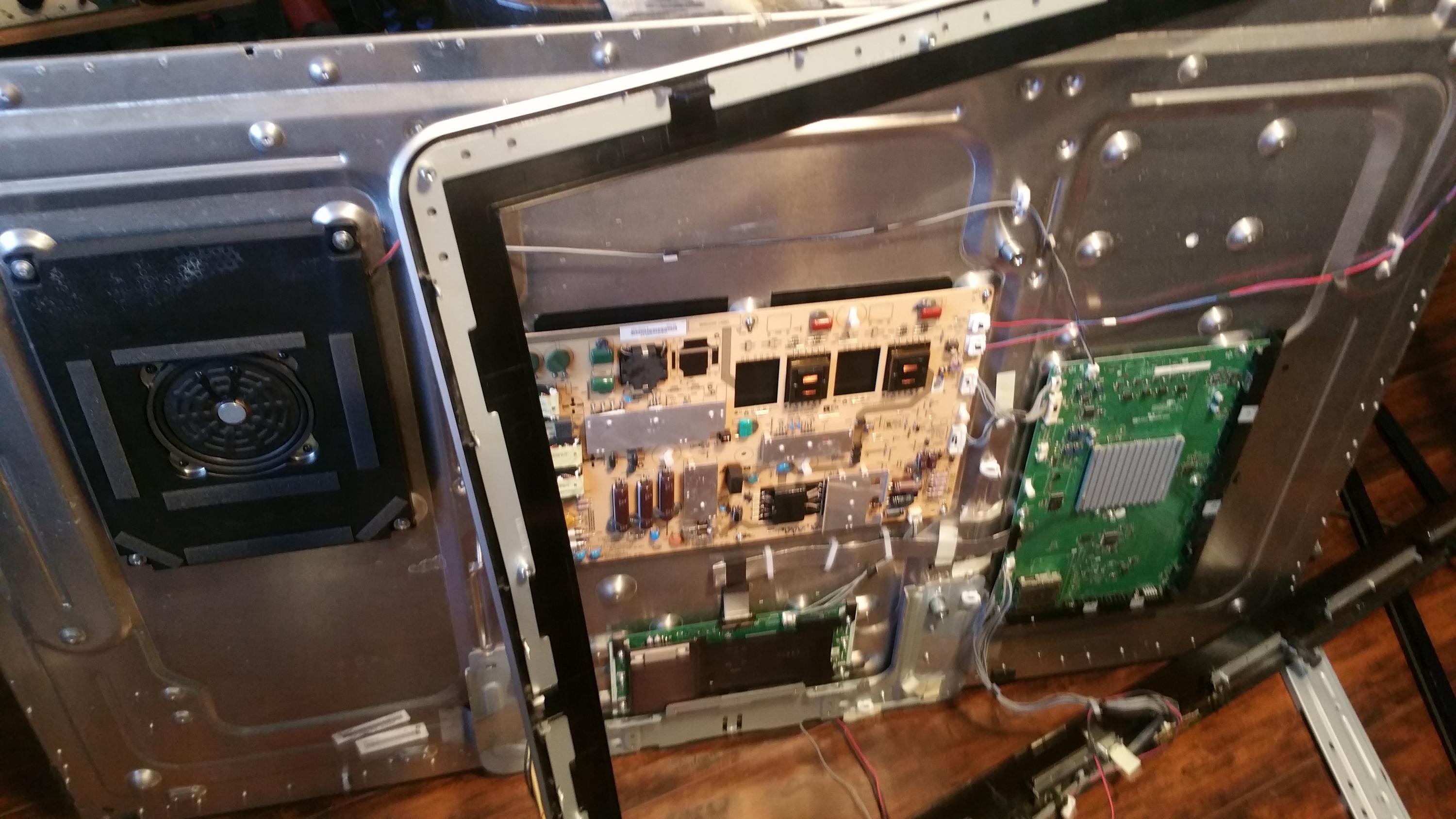

              Re: Sharp Aquos Quattron LC-52LE810UN power cycle odd issue
              here are a few pics. have everything connected but the panel itself and it behaves the exact same way.
              I'm almost positive it's a thermal issue I'm just not sure what chips would make the set behave this way.
              I'm thinking the freeze spray is a good idea as well.
                here is a better pic of board layout.
