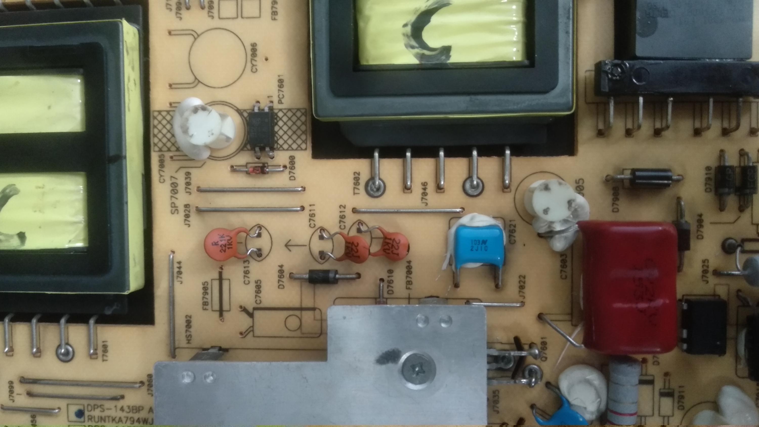

    The power supply board is DPS-143BP-3A, RUNTKA 796WJQS (i attached in this thread)

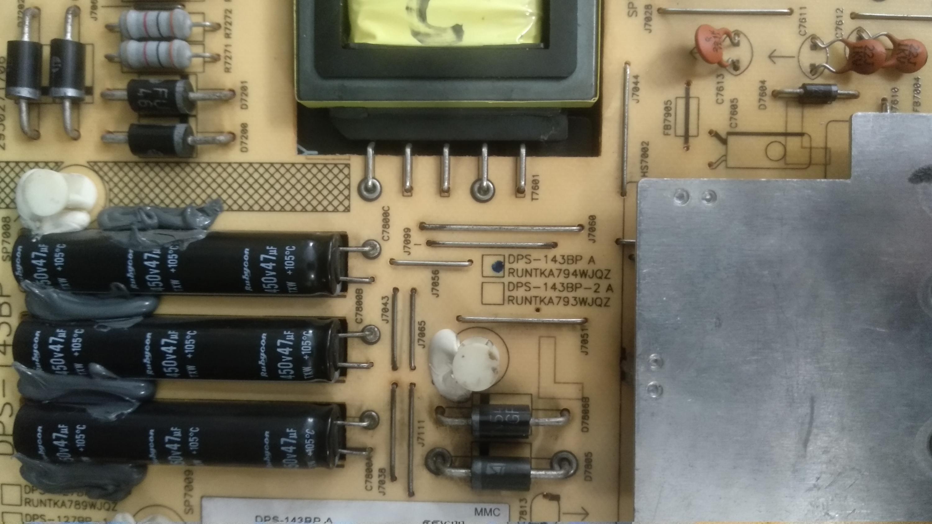

    The Power Factor Corrections block for main 3 bulk capacitors (C7800A, C7800B and C7800C and mosfet Q7801 has 223v output.
    Resonance Converter block for Q7602 has no voltage out (0 v) however for Q7601 still has 223v.
    Meanwhile for AC Det block at pin number 8 of TNY264N has 223v as well.
    But at Q7915 has 5 v, C7915 has 2v, and R7918 also has 2v.

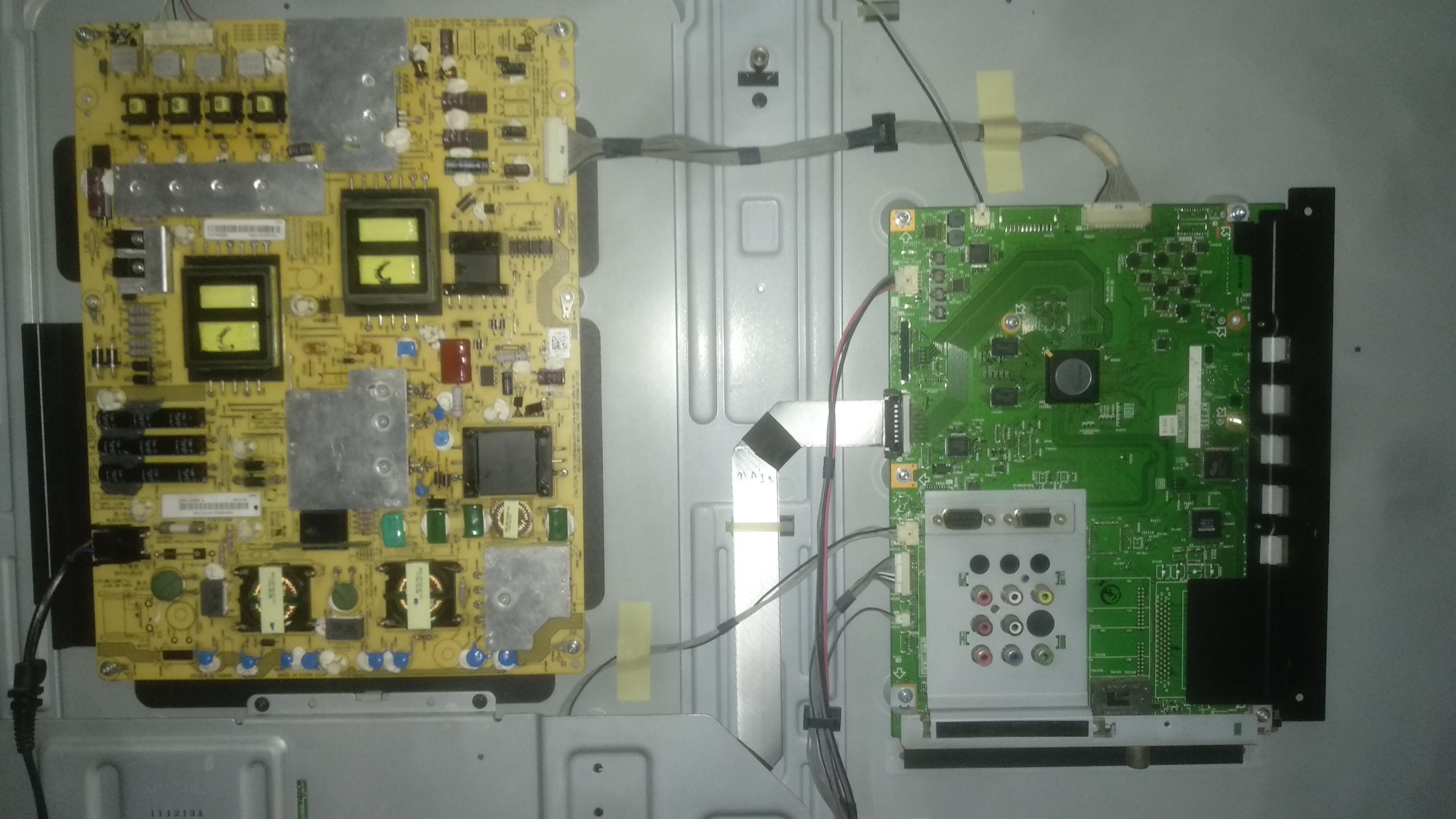

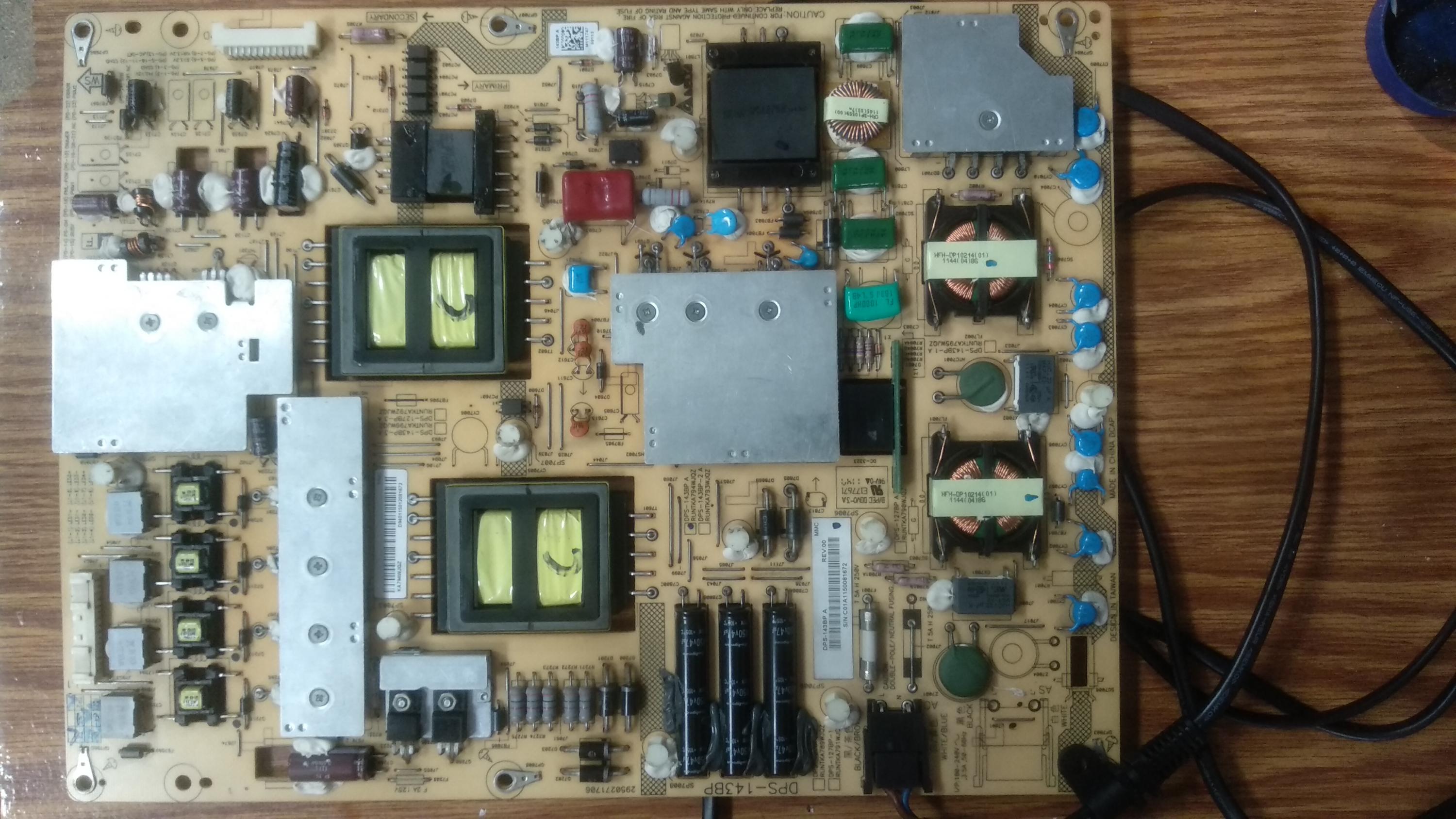

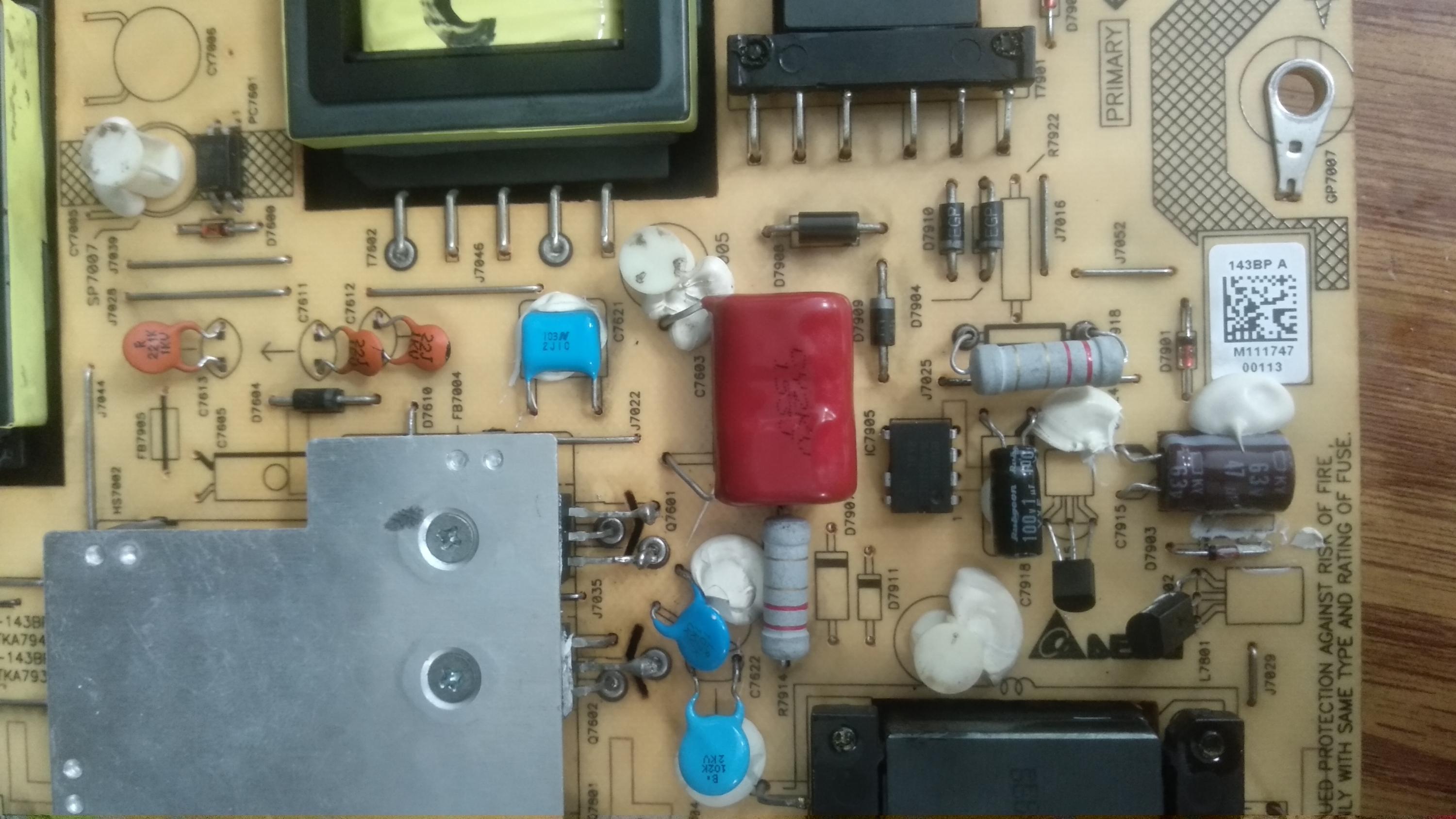

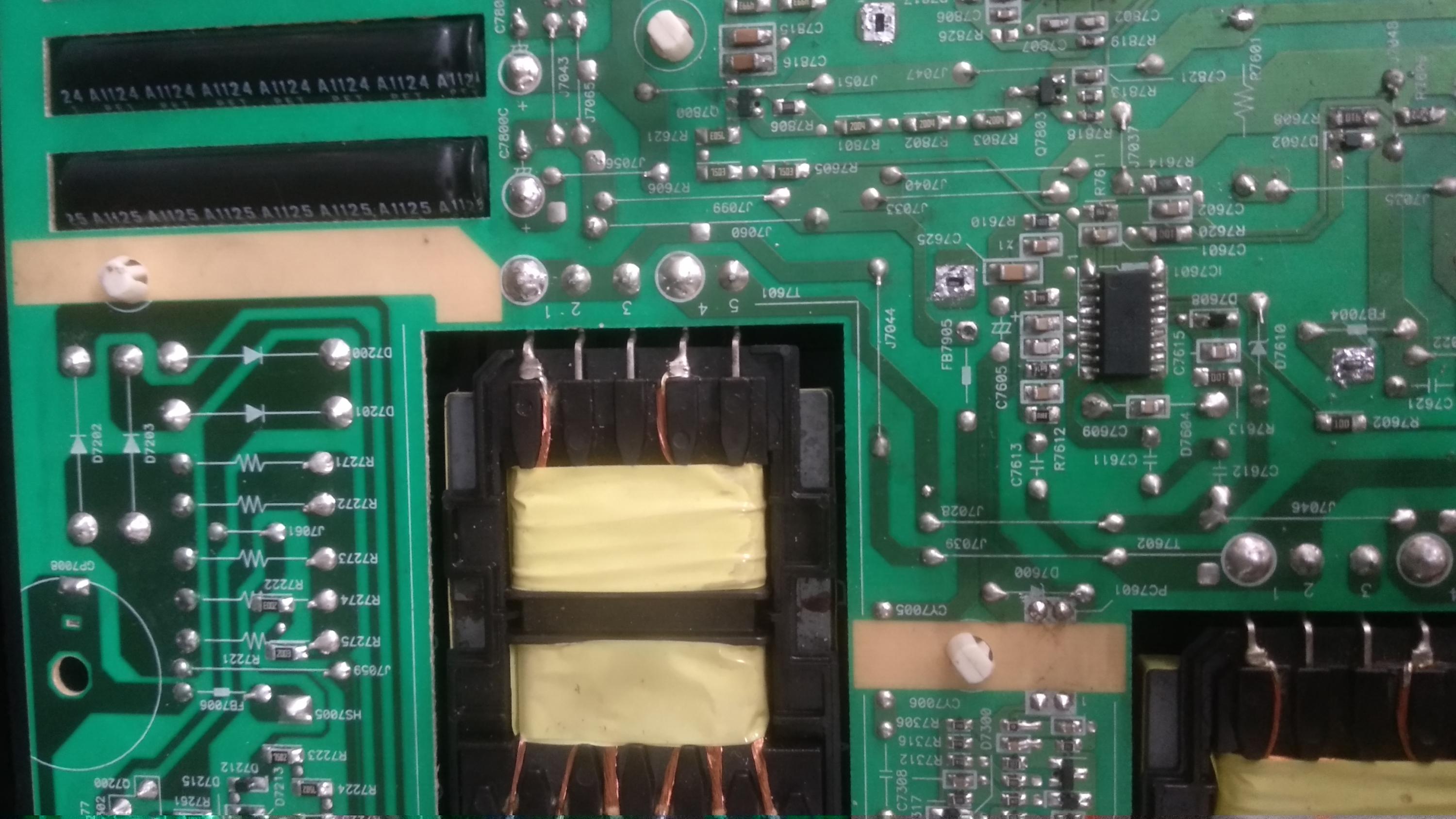

    Re: Sharp Aquos Quattron LC-52LE835X Totally Dead, no output voltages

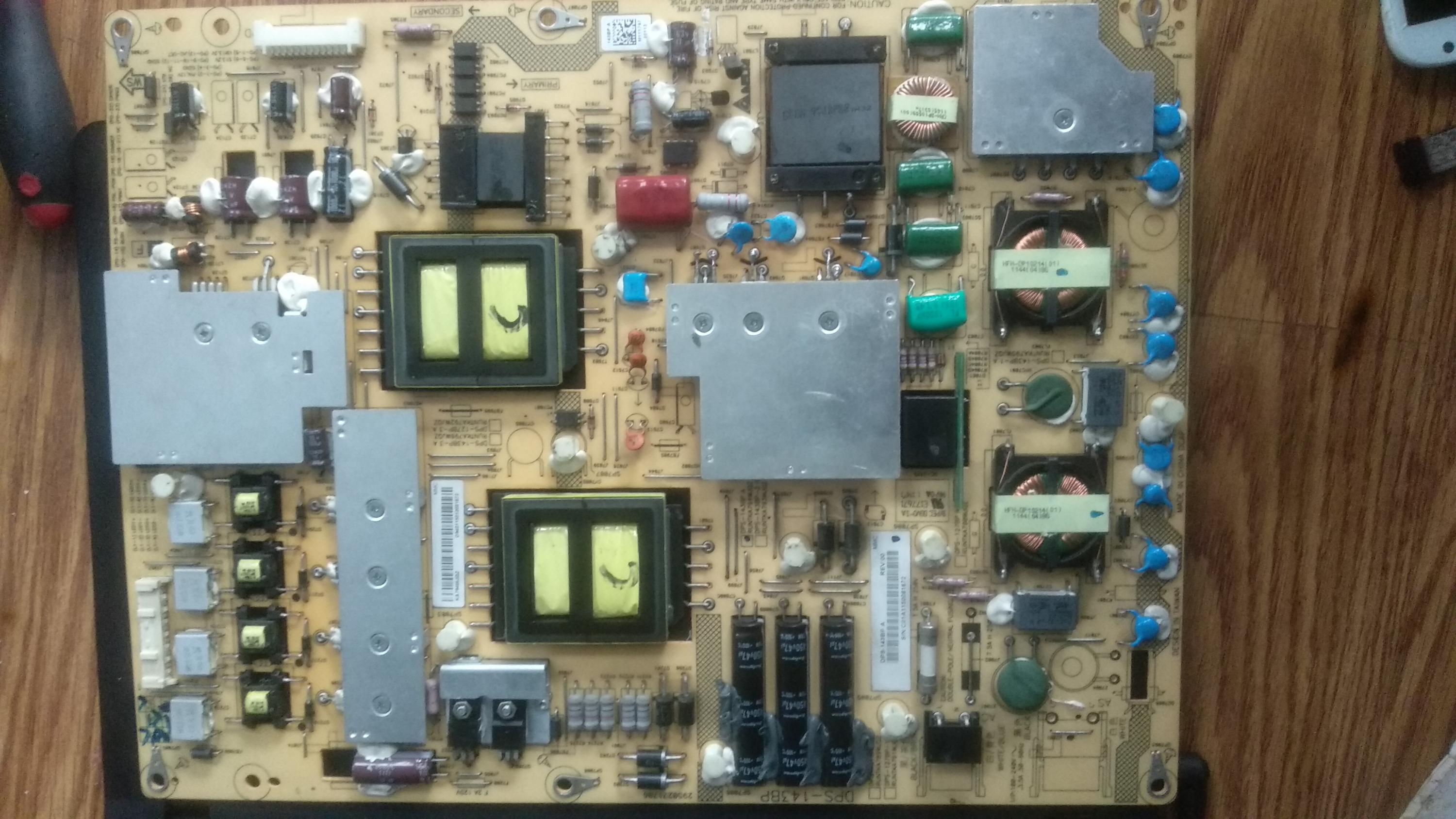

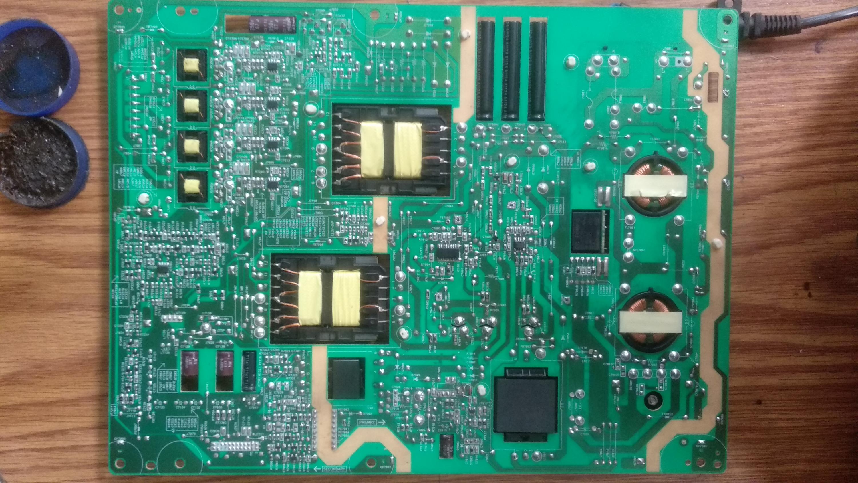

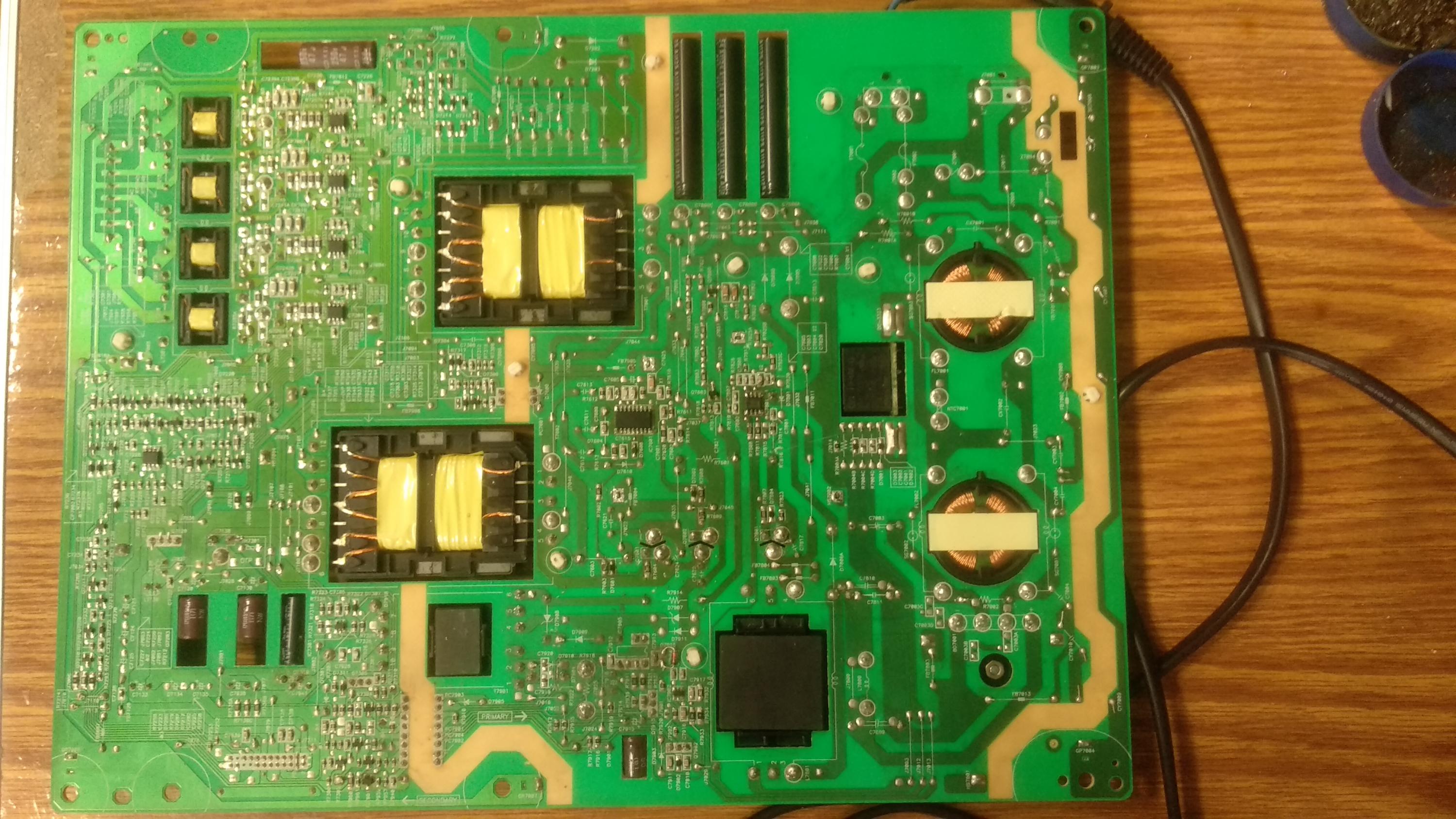

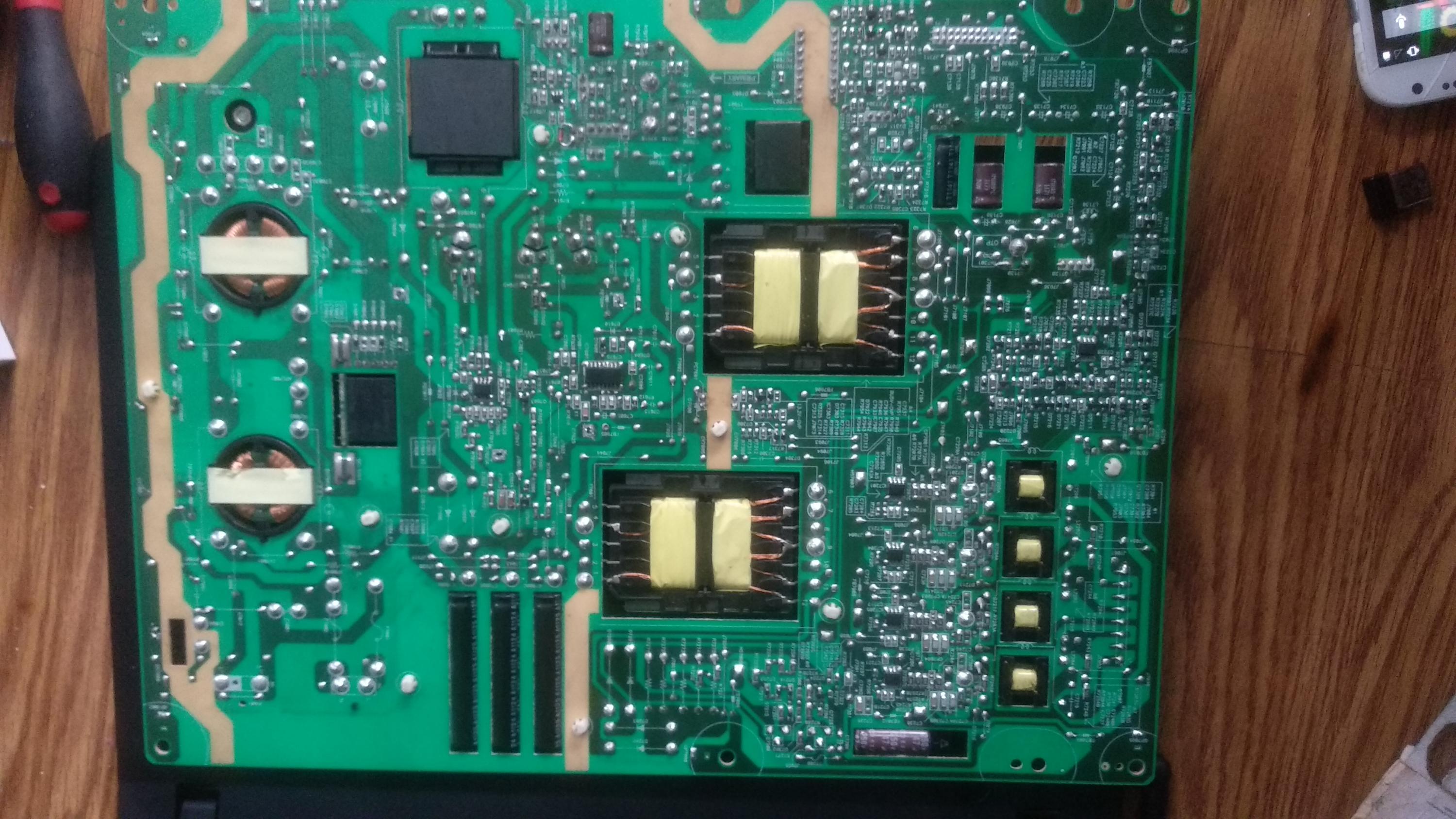

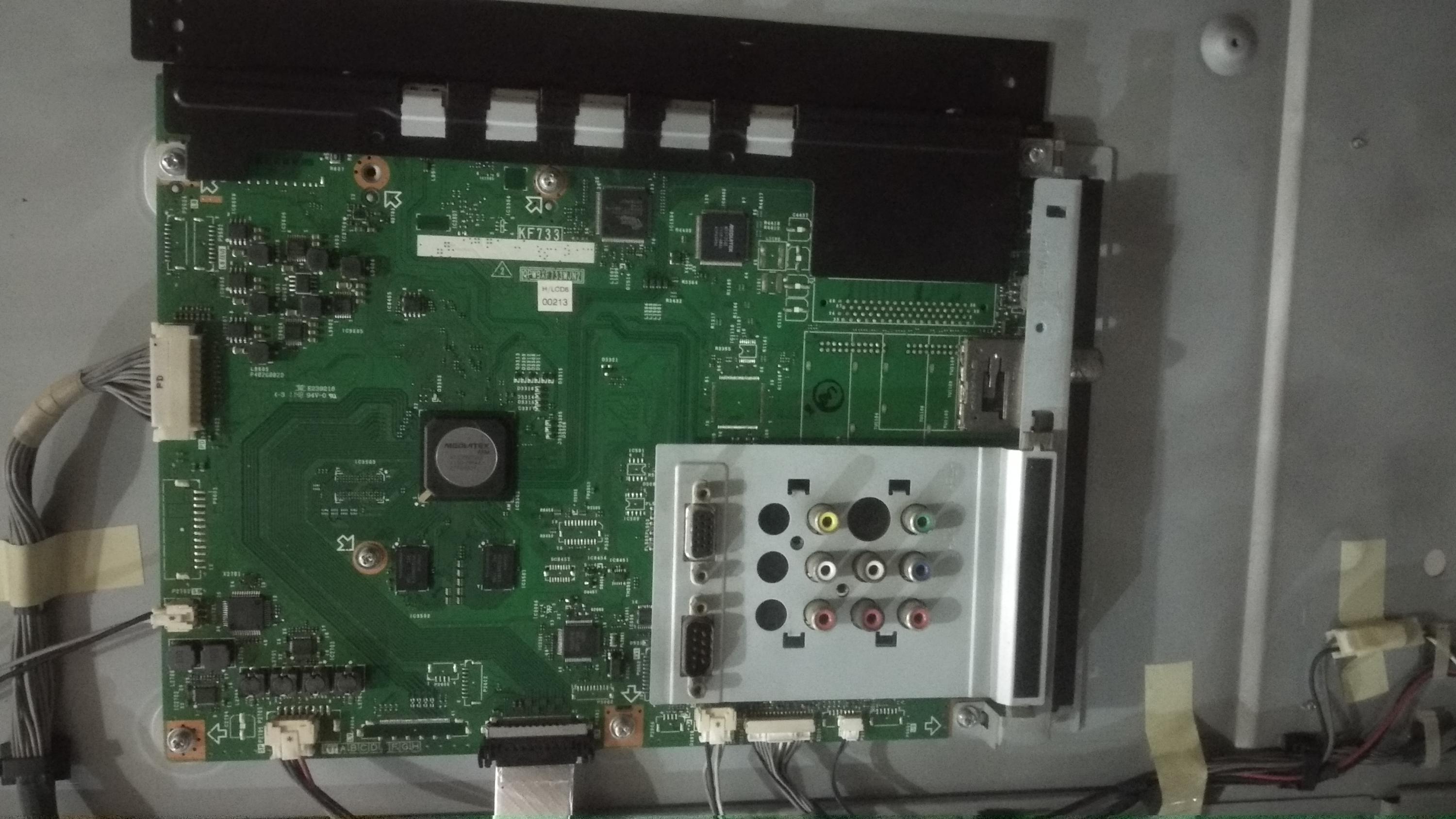

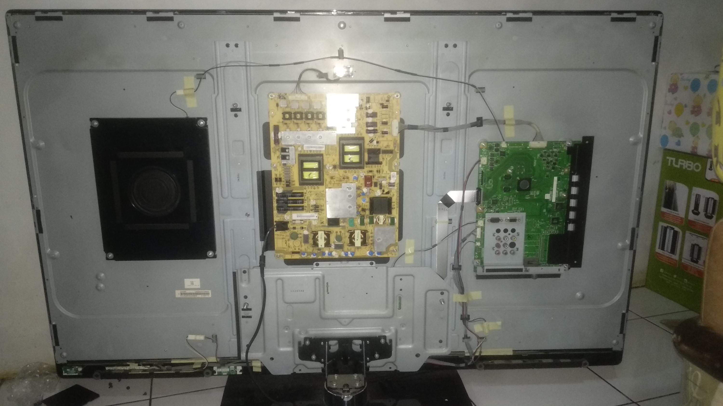

    Please provide good clear straight shots of the WHOLE top and bottom side of the power supply board, and also the pictures of the whole backside of the TV showing all the boards.
      Okay, i will be back with the pictures...thanks
        Okay then, i'll be back with the pictures. Thanks

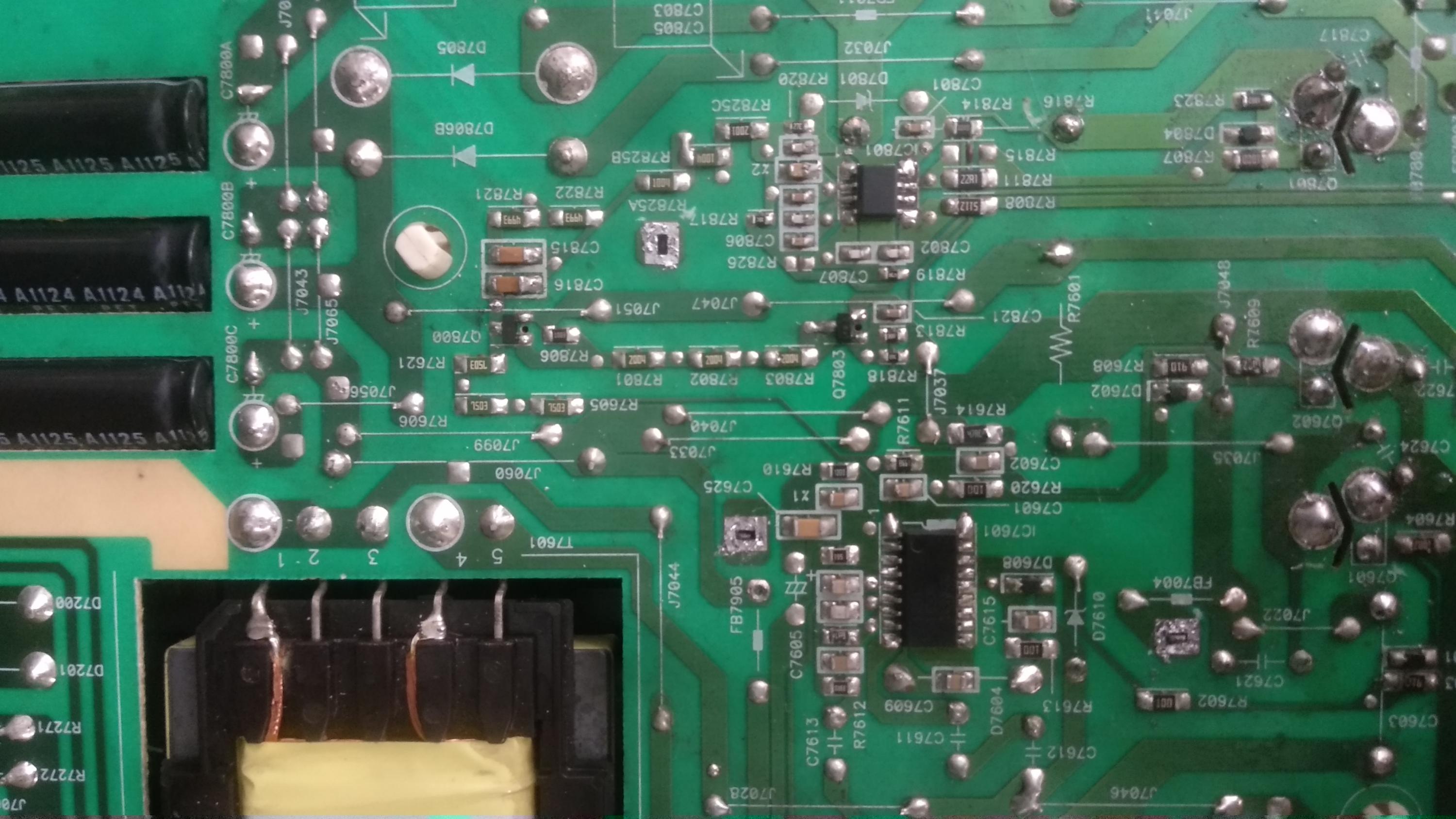

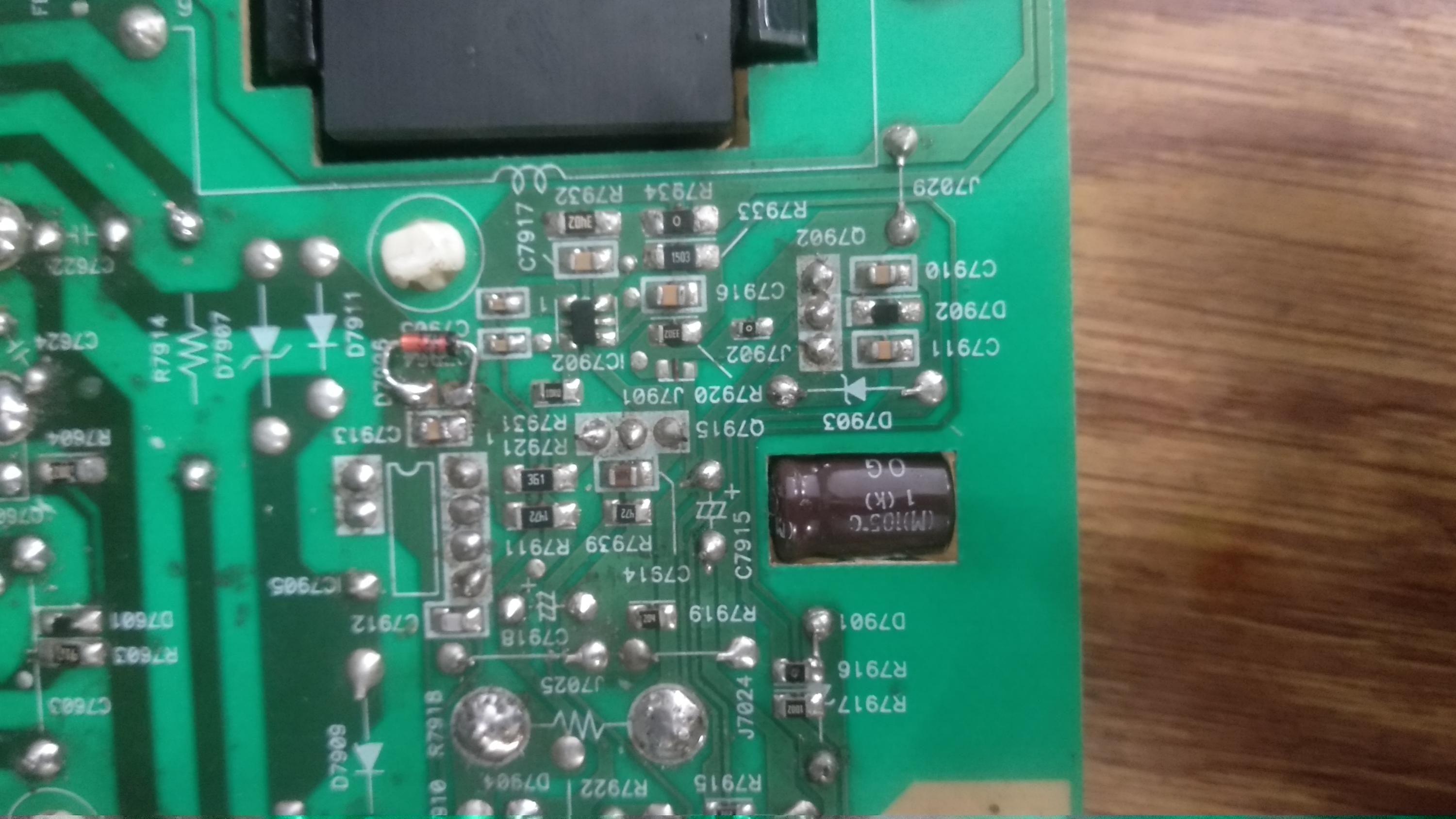

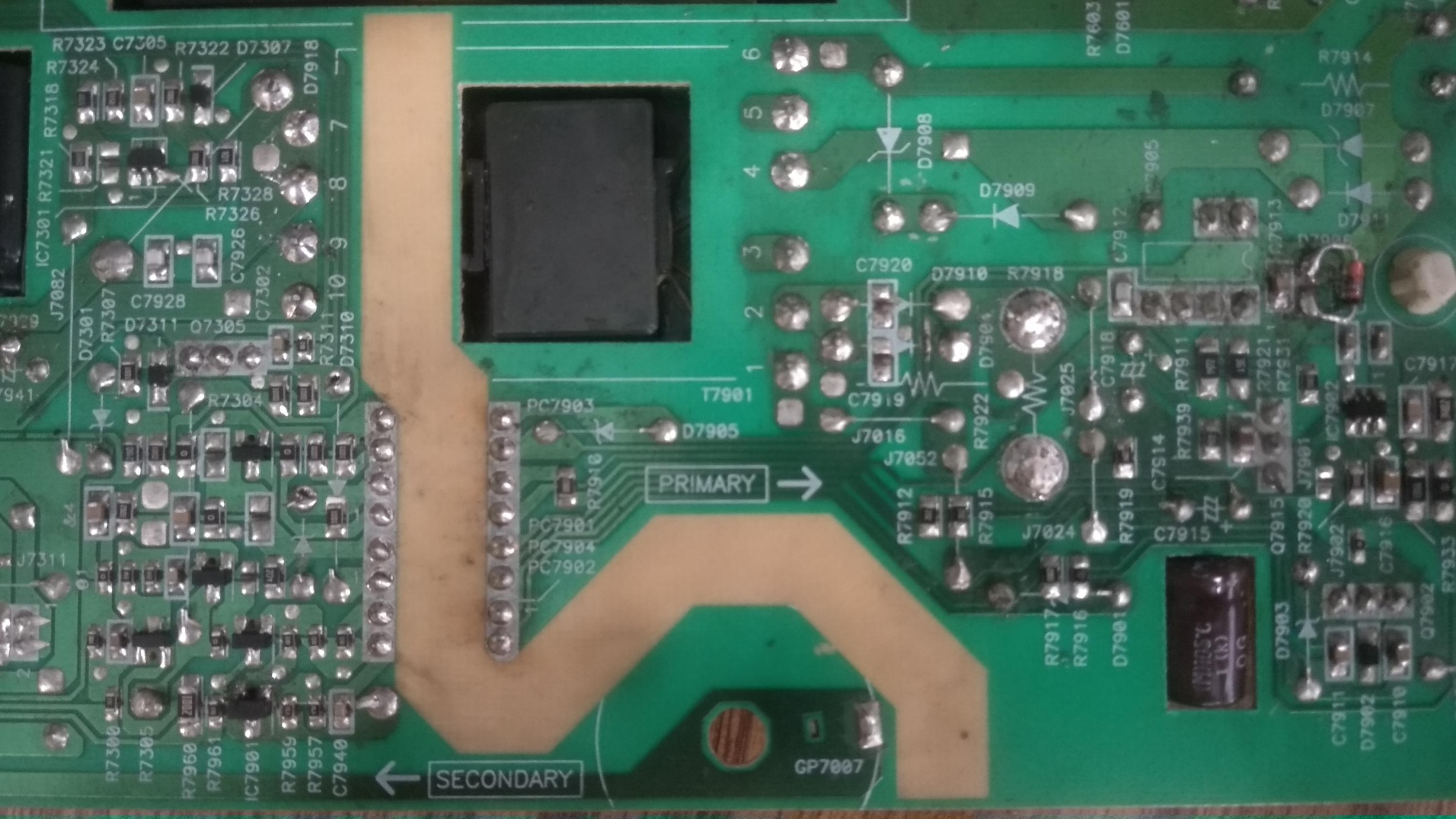

          Hi Budm, here are the pictures that you request. Hope they are clear to see.
          I have measured the voltage when i put the power supply board together with mainboard, and there's no standby light nor the output voltages.

            Your post #1:
            "The Power Factor Corrections block for main 3 bulk capacitors (C7800A, C7800B and C7800C and mosfet Q7801 has 223v output."
            What did you use for ground ref. for the meter?
            Your country AC Voltage is 220VAC?

              Yes I did, i used 220VAC ground ref. And it's the same results when i use both legs - and + of capacitors, 223V.
                If your AC power line is 220VAC, the DCV measured between the two legs of the main filter caps should be around 320VDC, and then it should be around 380 ~ 400VDC when PFC Voltage booster circuit comes on.
                When you make measurement in the hot side of the circuit, you use the negative leg of the main filter cap as the circuit ground ref. not the chassis or safety ground.
