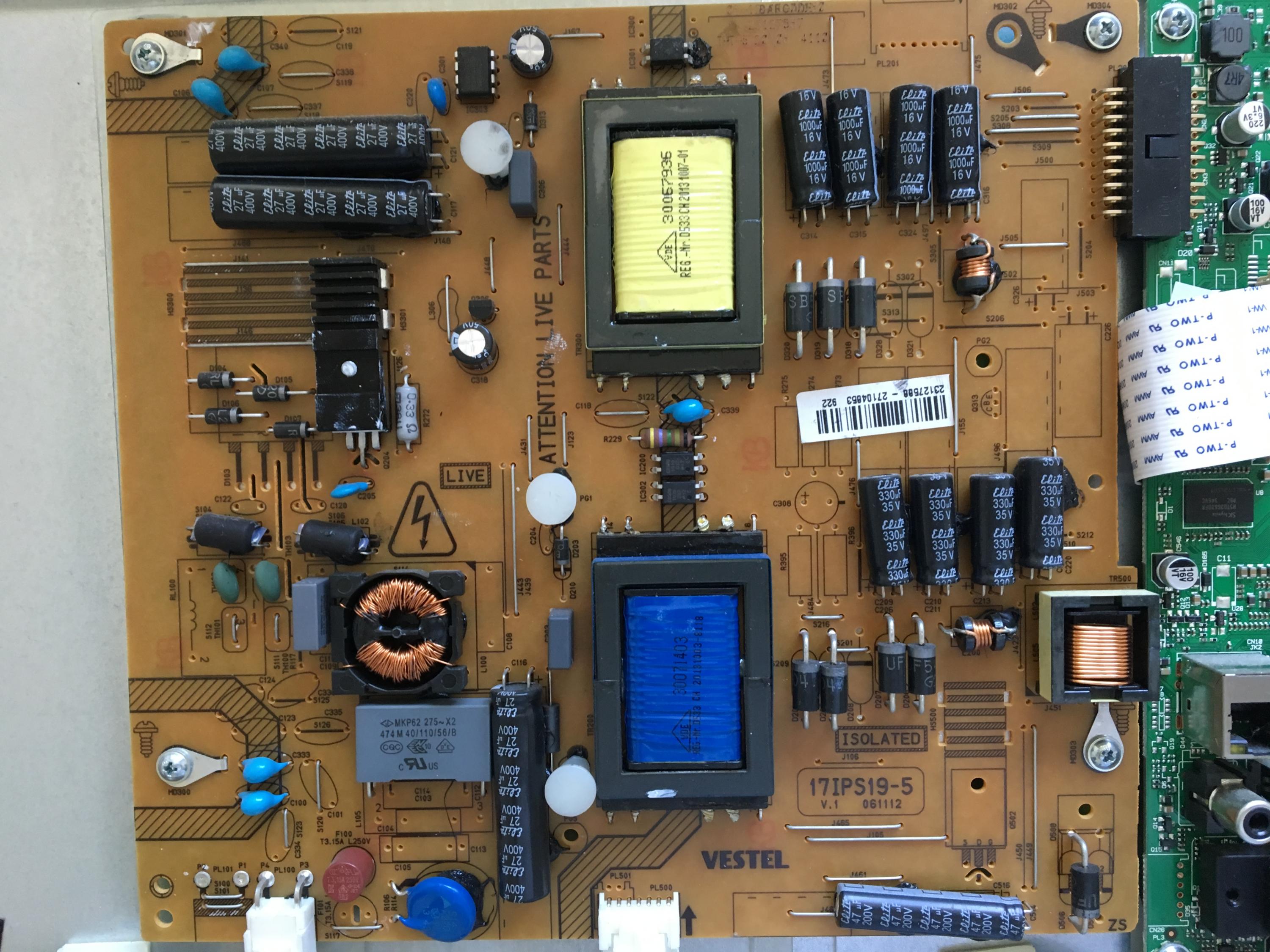

    will put pics as soon as downloaded but
    powerboard 17IPS19-5
    Mainboard 17MB95S-1

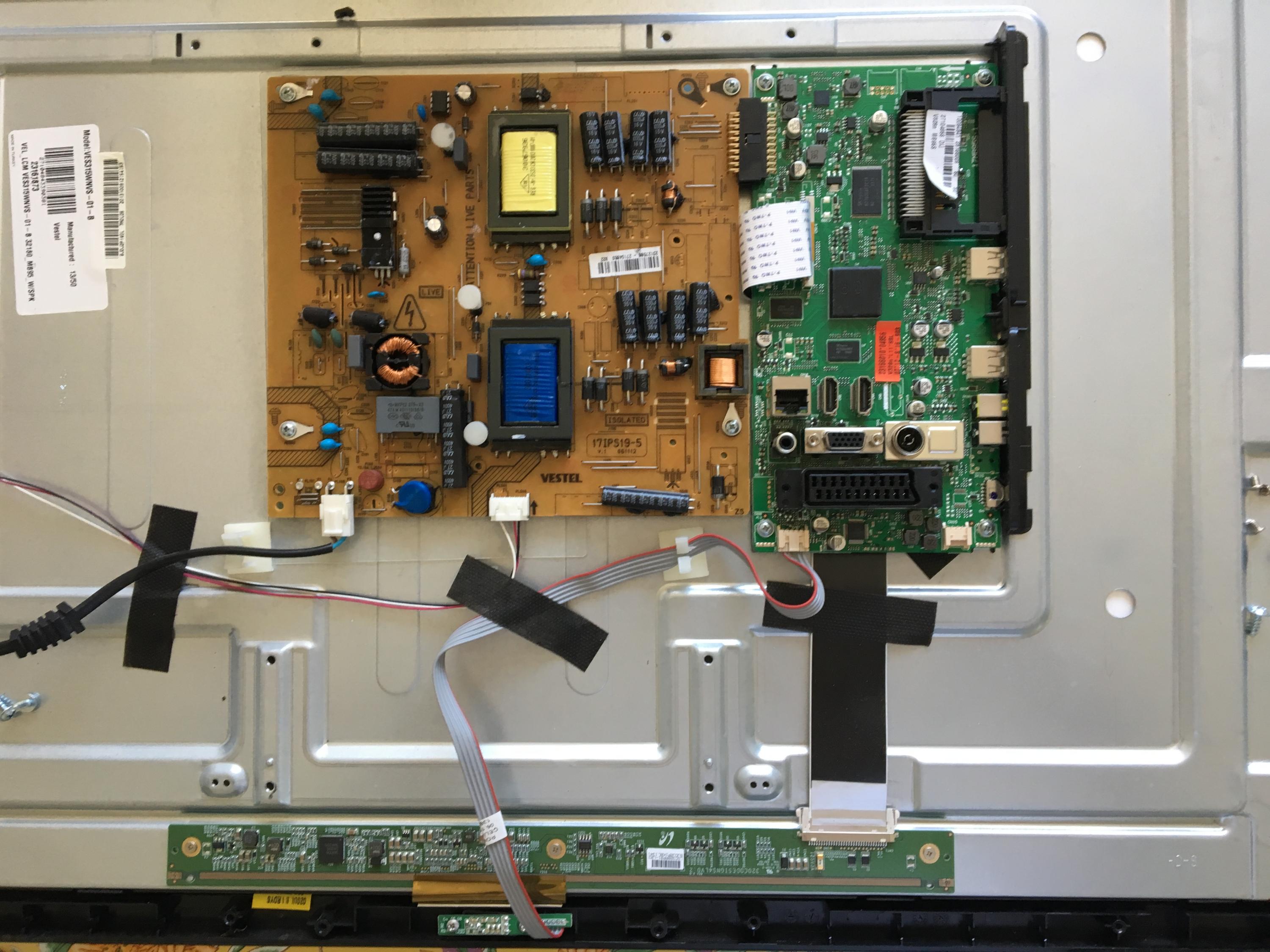

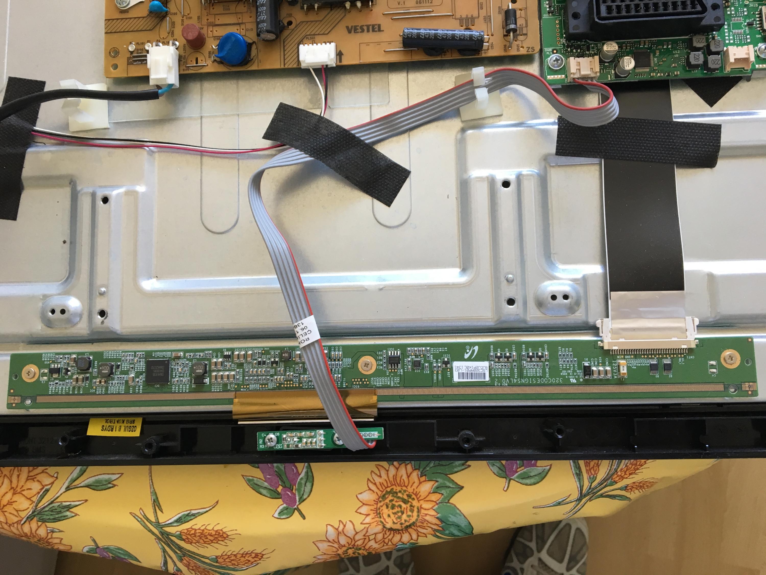

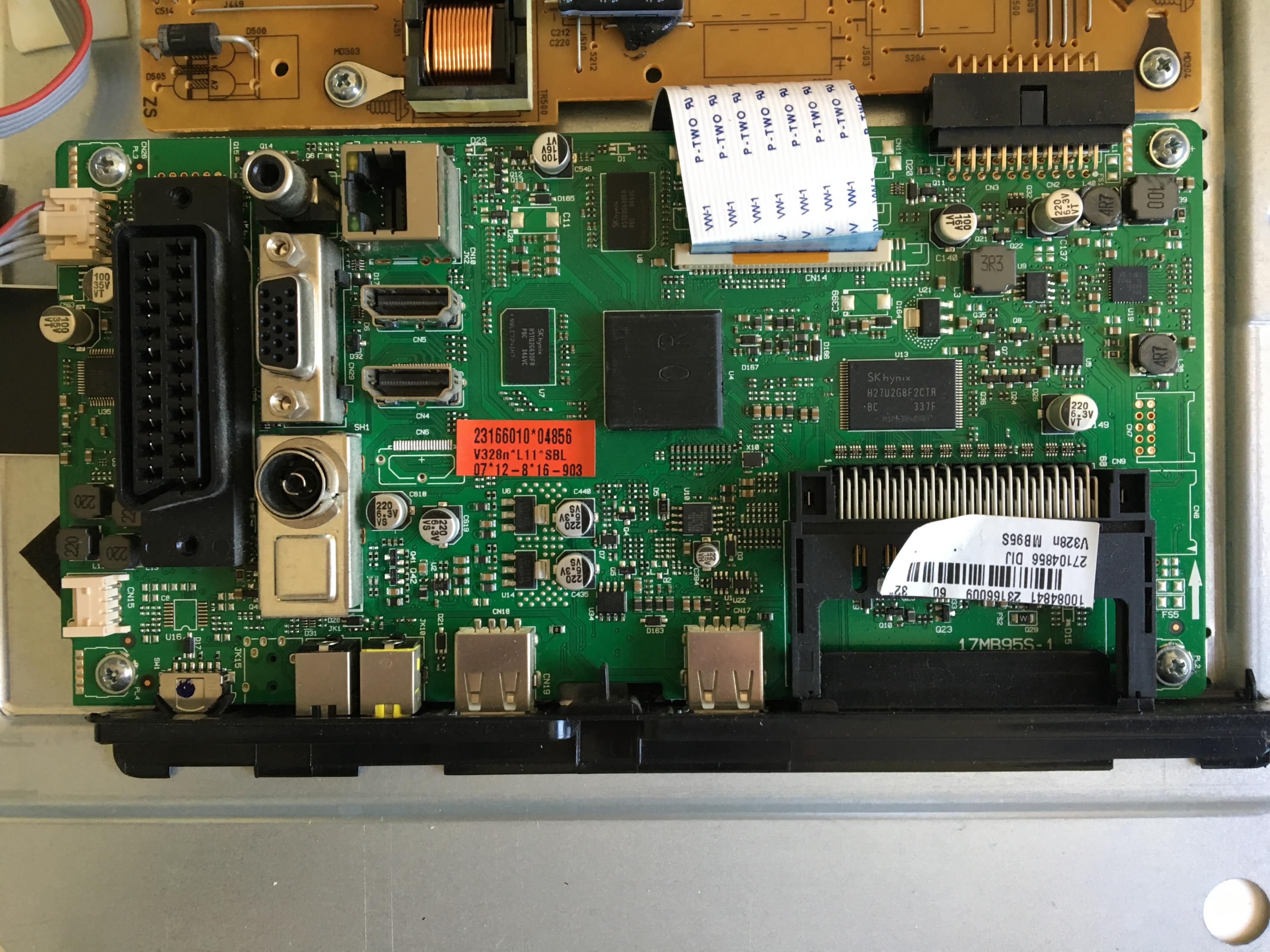

    pics of boards

      Re: Bush LED3217HDCNTD flashing red light no picture
      337v at cap C116
      12v at the 3 diodes and 24v at the four diodes
      I am thinking mainboard or firmware, but I am probably wrong, I usually am

        So the SMD Fuse F1 on that T-CON board is good and getting 5V or 12v at both end of the fuse?
          You could try heating/freezing eeprom U10? and see if it boots up.
            ok update
            just followed a tip off reeceyburger123s video on youtube and froze the ic chip with an upside down can of air
            tv has booted up and is working now both picture and sound, although have not tried turning it off yet and rebooting, not sure if i dare turn it off yet.
            what do i do now, there is obviously some software glitch on the mainboard or is it a faulty ic chip
