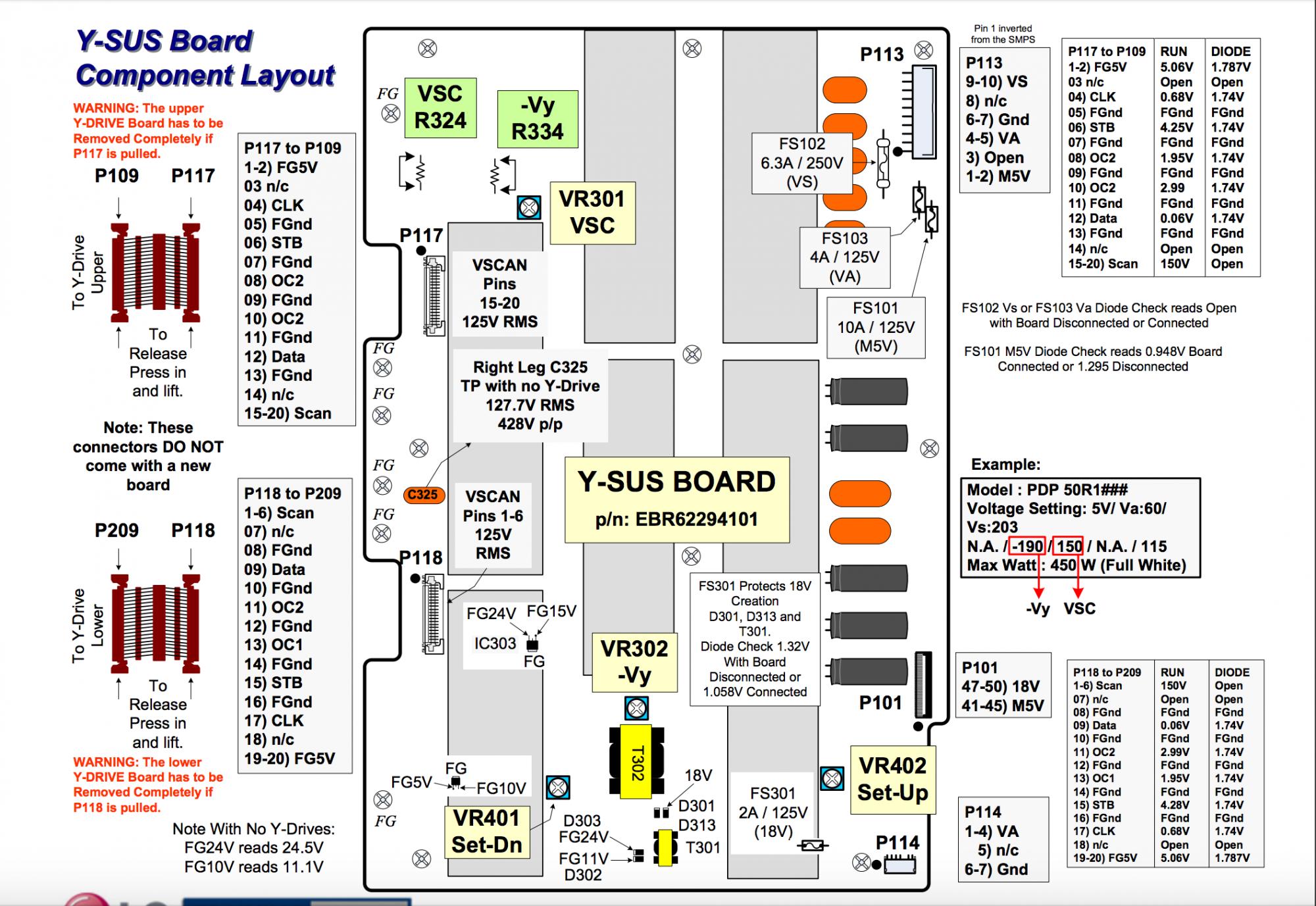

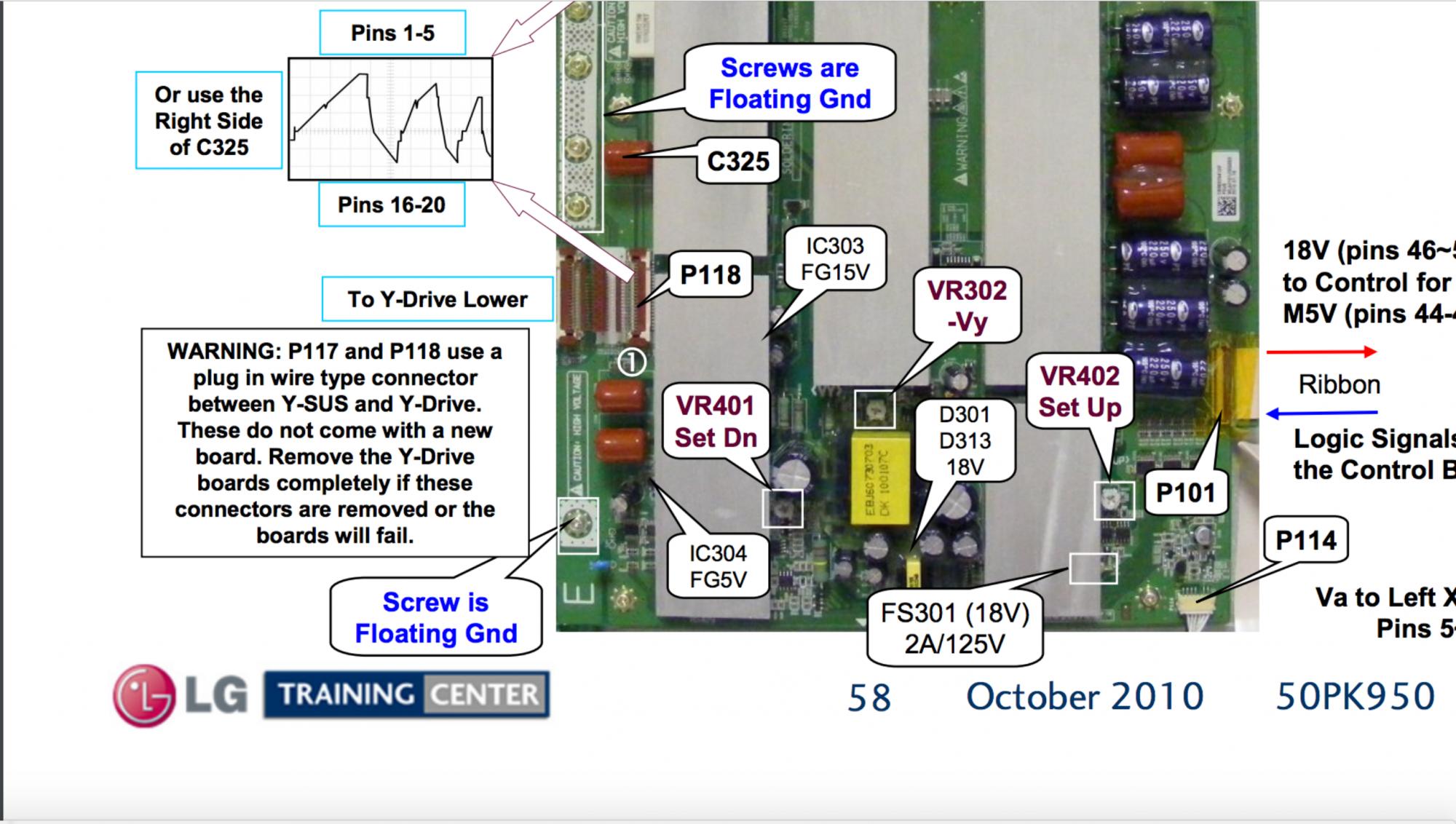

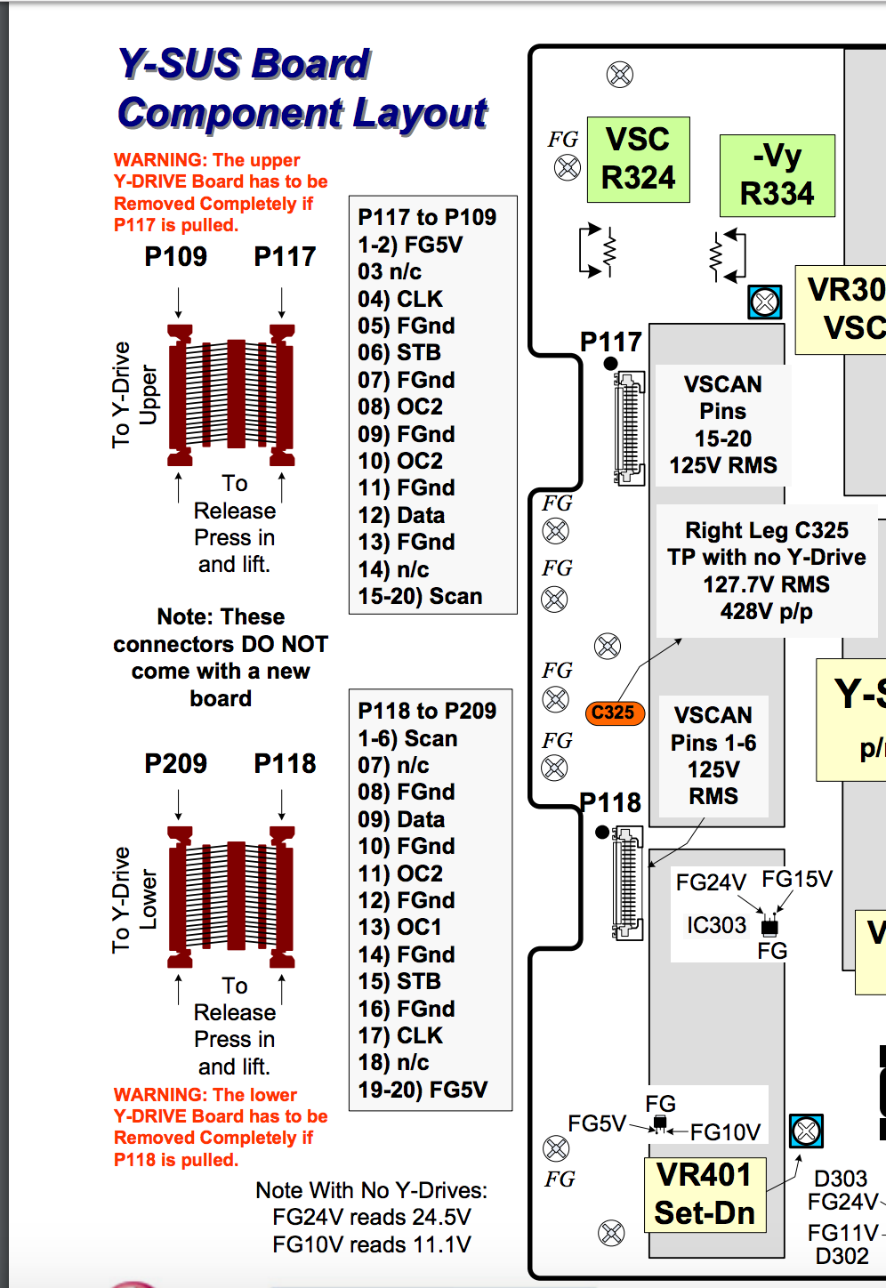

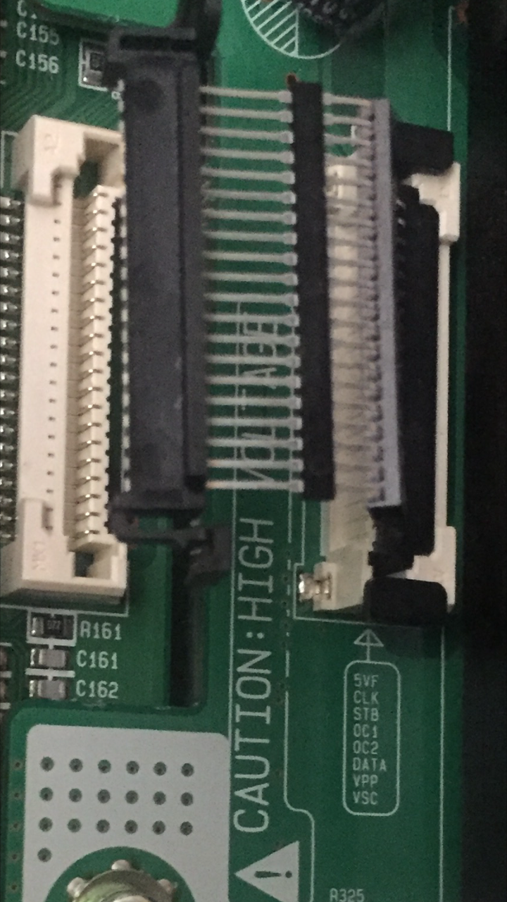

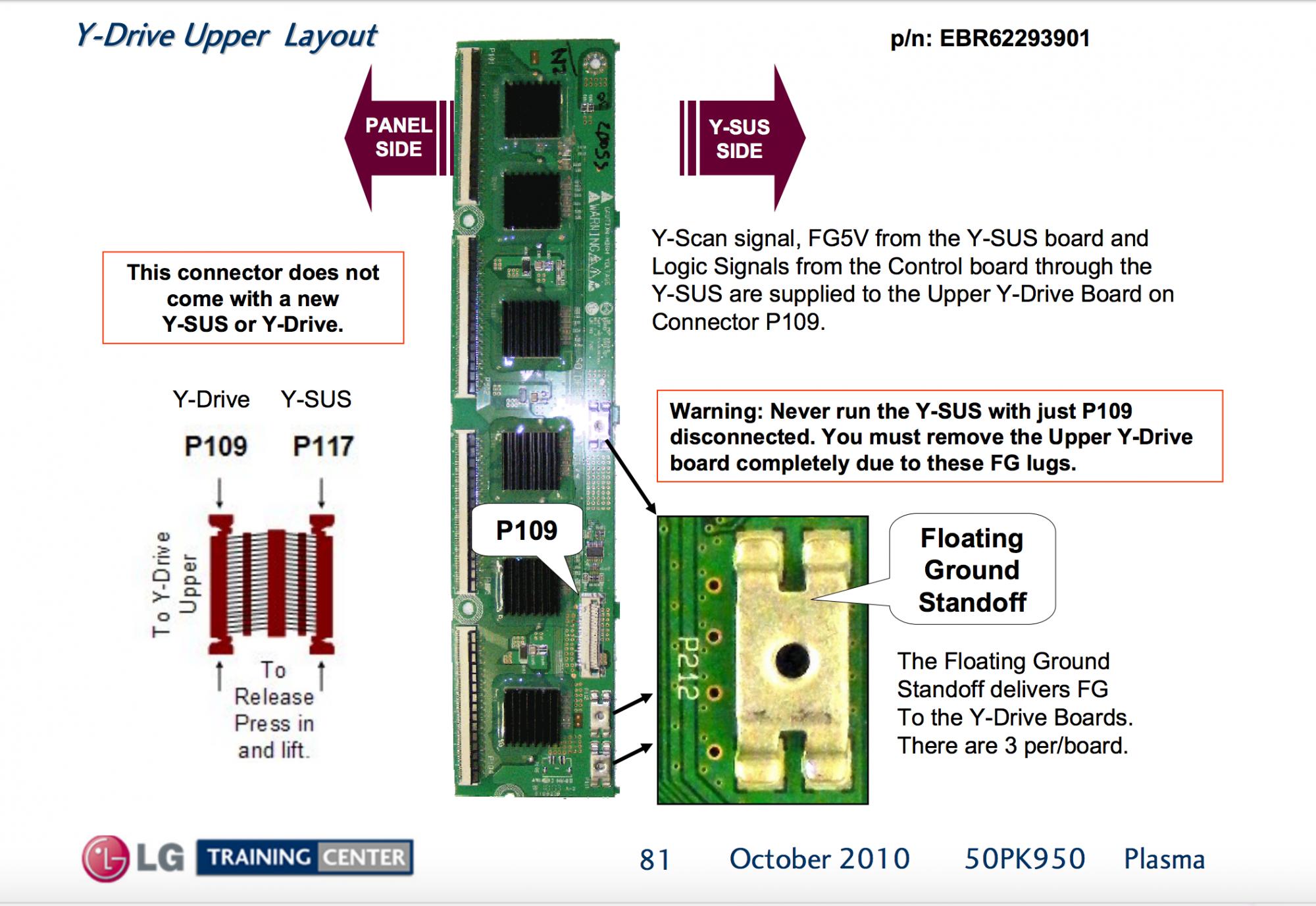

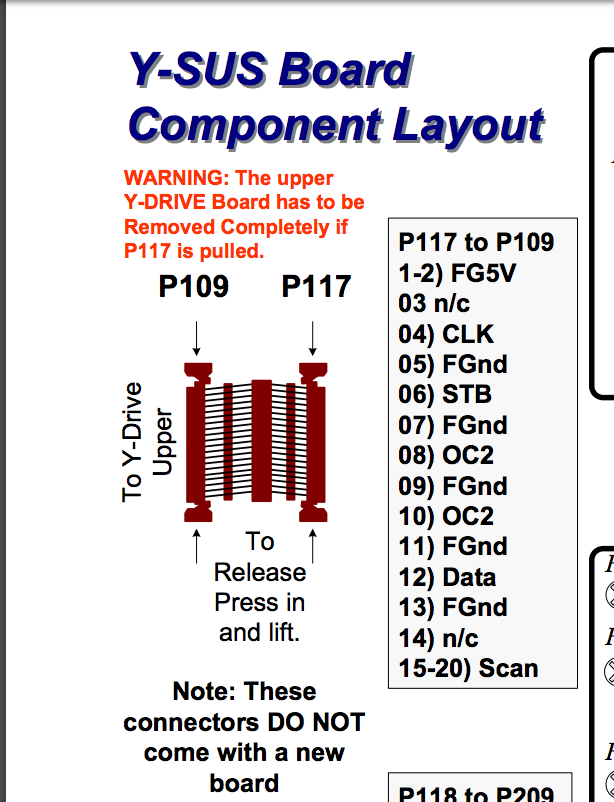

                            #93
                            Re: LG 60PX950 ~ Vertical Pixelation Issue
                            I think I found out what happened.
                            I tracked down a Training Manual for the LG 50PK950, which is a close enough model to mine for this purpose.
                            When I first bought that replacement lower Y-buffer board and installed it a few days ago, I left both of the wire-designed connectors between the two buffers and the YSUS in on the buffer sides while I reattached the YSUS itself. Did this, in part, because the YSUS overlaps and sits on top of both of the buffer boards when it is screwed back on, so I put the buffers on first, then plugged the wire connectors into the buffers, and then finished the re-install by screwing the YSUS in on top of the buffers.
                            I did not hook up these wire connectors to the YSUS at that precise moment in time, as I thought I would check the Vs and Va coming into the YSUS from the power supply one more time along with the Vs and -Vy resistor voltage readings once again before hooking up the buffers.
                            Apparently this was a big mistake.
                            If you look at the pictures below, it specifically says NOT to remove the right-side (the YSUS side, in other words ~ labeled as P117 and P118 in the diagrams below) of this wire connectors while leaving the buffer boards themselves in, as that will cause the boards to fail. This explains why both the replacement lower and the original upper (which had been producing the top half of the screen on the picture) both seemed to fail at the same time.
                            Has anyone seen this before? I'm going to buy two new boards armed with this information. I'm documenting it here for others to benefit from and to ask if anyone has any more insight(s) or information I should know about before installing the new boards. This time, I will make sure both connectors are indeed connected to the YSUS in full before firing up the set again. Or, as an alternative, hooking up one buffer board at a time but making sure that the other buffer board is completely removed from the scenario.
                            Note: Apparently, one should not disconnect the left side (P109 on the upper and P209 on the lower) of the wire-designed connectors either, as the problem with these buffers failing seems to related to the FG or Floating Ground lugs between the YSUS and buffer boards. See the last picture in the sequence below to see what I mean.
                            Here is a link to the entire manual:
                            https://cdn.badcaps-static.com/pdfs/...3442af9b32.pdf

                              #94
                              I ordered the new buffer boards. But, am still confused as to what really is wrong with the old ones. I have tested them in every way I can think of. Nothing appears wrong.
                              Does anyone know what is the likely result on these Y drive buffers when the floating ground is in play but the connector is not hooked up to the YSUS? What is likely to "go"?
                              I am hoping that they still might be fixable.
