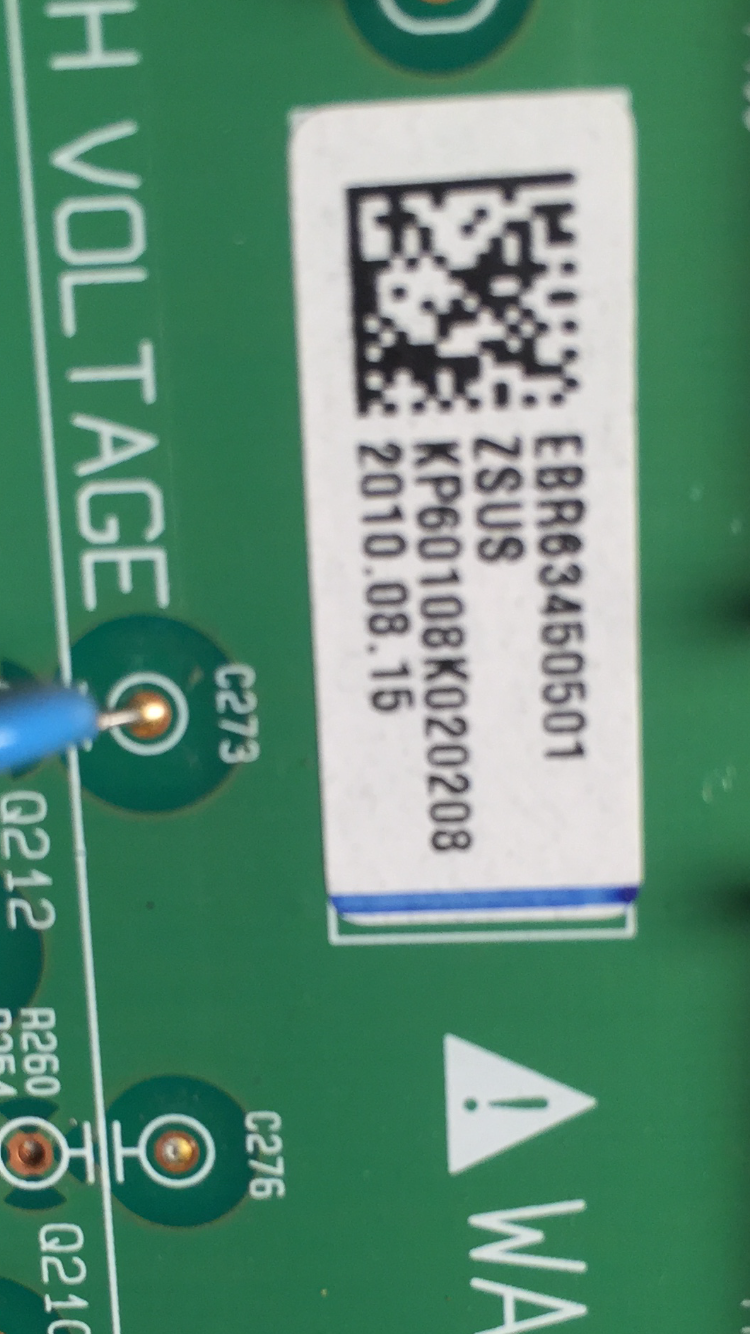

          Plugged it in this morning purposefully first with no signal preeent (meaning, I hooked no satellite signal through the HDMI ports nor any DVD player, computer, etc ...). The result was that there was a series of vertical bars that flashed on and off in sequence from left to right and back again. They were all of the scattered green pixelation nature, and varied in size from 12" wide to about 3" wide as they made their way across the screen and back. So, it was like a moving test pattern of sorts, wherein the tv was attempting to read or display an image one section at a time, but failing to do so. I'll try to capture a video of that.
          Going to try to post photos now from my phone, to give you more to go on.

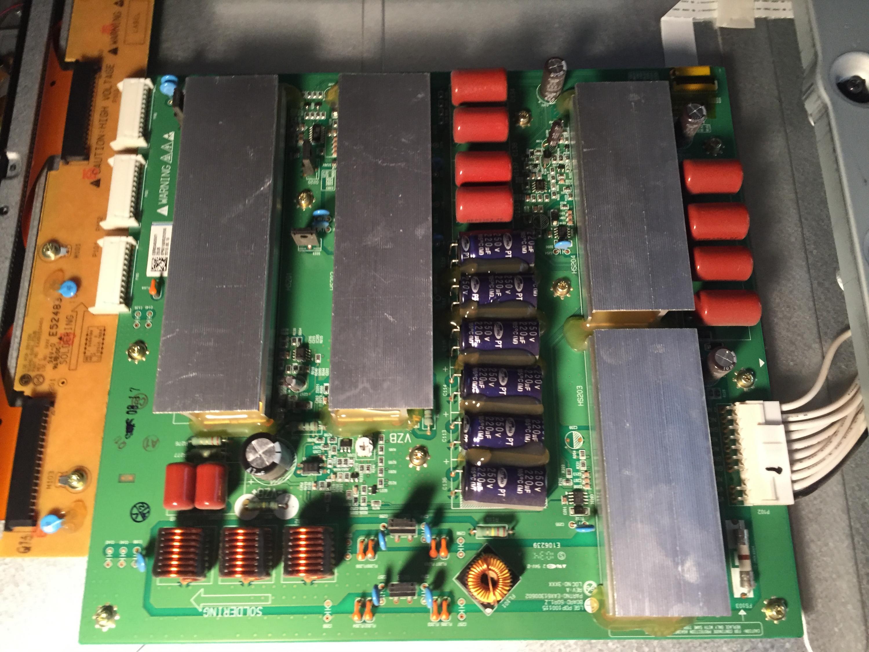

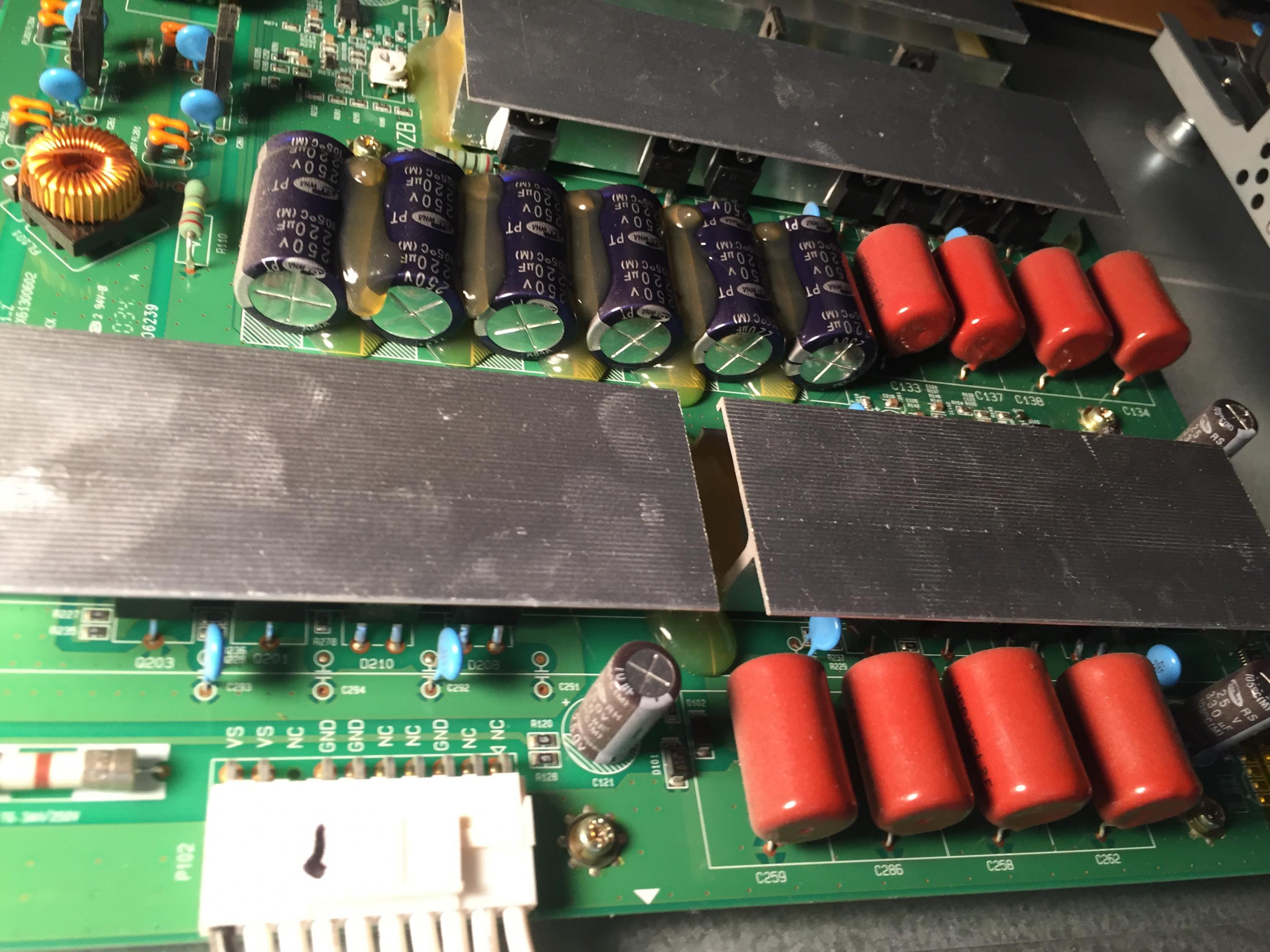

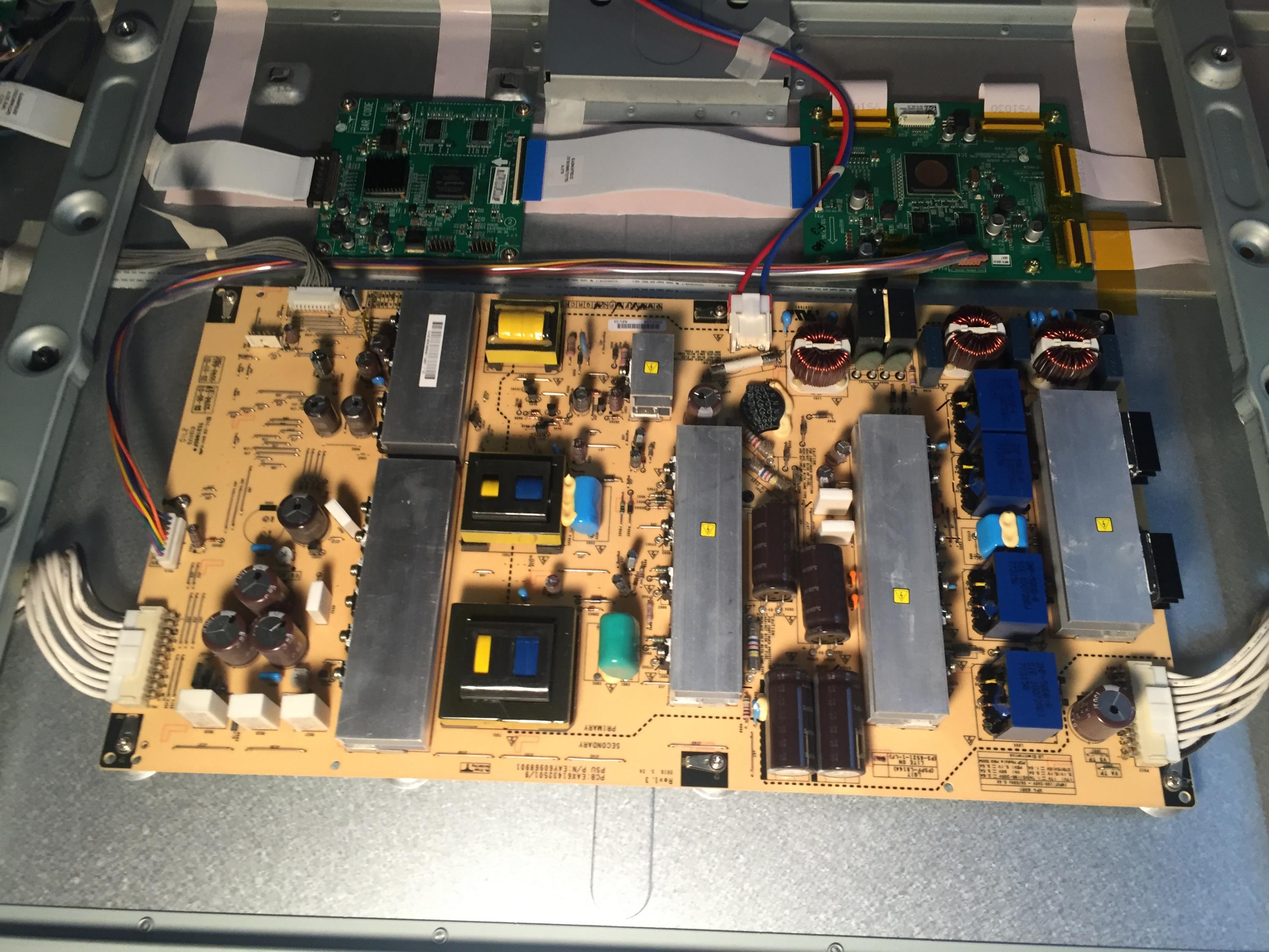

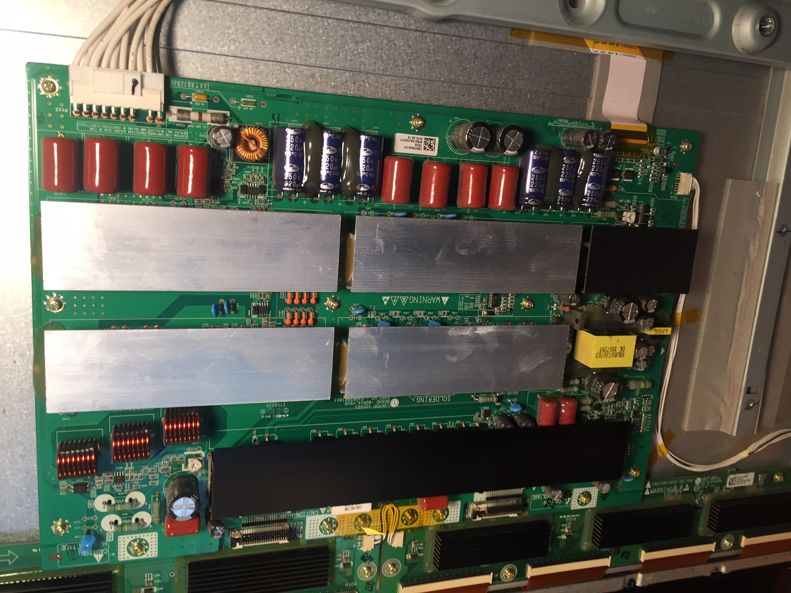

          • kca
            • Feb 2016
            • 529
            Re: LG 60PX950 ~ Vertical Pixelation Issue
            Three images of the Zsus board and one of the PSU.
            • kca
              • Feb 2016
              • 529
              Hmmm ..... not sure why the images I'm posting of late are still ending up upside-down, but let's ignore that for the moment.
              Hamie ~ Do you think the problem is completely isolated to the Zsus board? That would be nice, as they're only about $20 on Ebay.
              I see no bulging caps on the Zsus board (nor on any other board, for that matter), but I know they can still be defective.
              Can you walk me though what you mean by vsc, -vy and Zbias? I am assuming vsc is the reading of 202 I'm getting from the PSU directly into the Zsus. Is that correct? I'm not sure what -vy means. And if the ZBias is referring to the knob labeled as VZB near the middle of the Zsus board, I have yet to move that in either direction left or right.
              Thanks in advance for the help, Hamie and everyone, I really appreciate it.

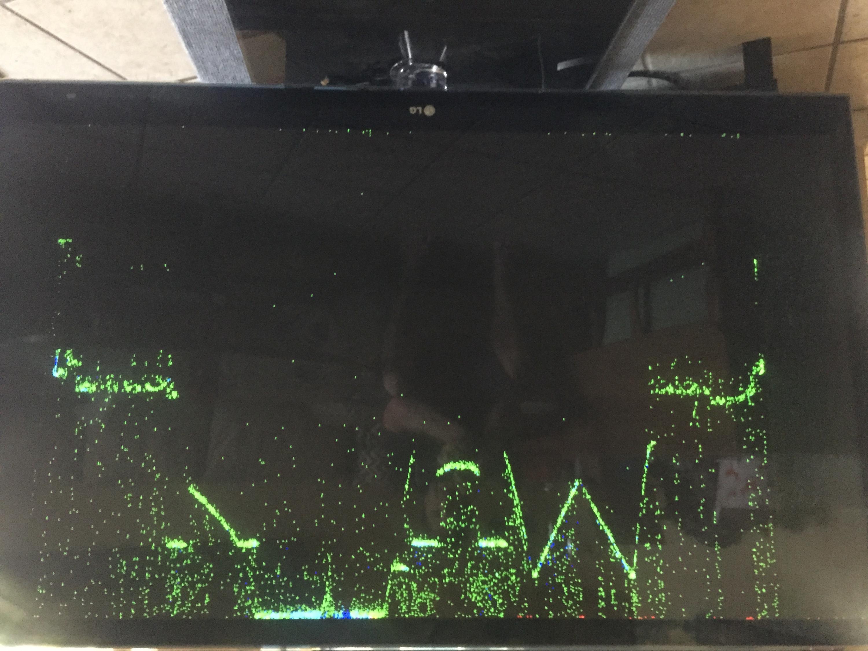

              • kca
                • Feb 2016
                • 529
                Here's a short video I just shot of the green "banding" I described up above. It gets cut off in the middle b/c my phone ran out of memory, but it gives you the idea. Not sure if it shows up clearly enough, but on the tv screen itself you can faintly see the LG logo and the words No Signal as the green (and white too) pixelation makes its way across the screen and back.There are also some blue pixels and a very few red ones involved.
                So, between the evidence of the LG logo brand and the outline of the word "MULAN" from the DVD I was using earlier (please see my first couple of posts), the image is attempting to come through but is being inhibited or prohibited by some fault or another. The "No Signal" message under the LG logo makes sense in the current scenario, because I purposefully have no source signal hooked up right now as I investigate.

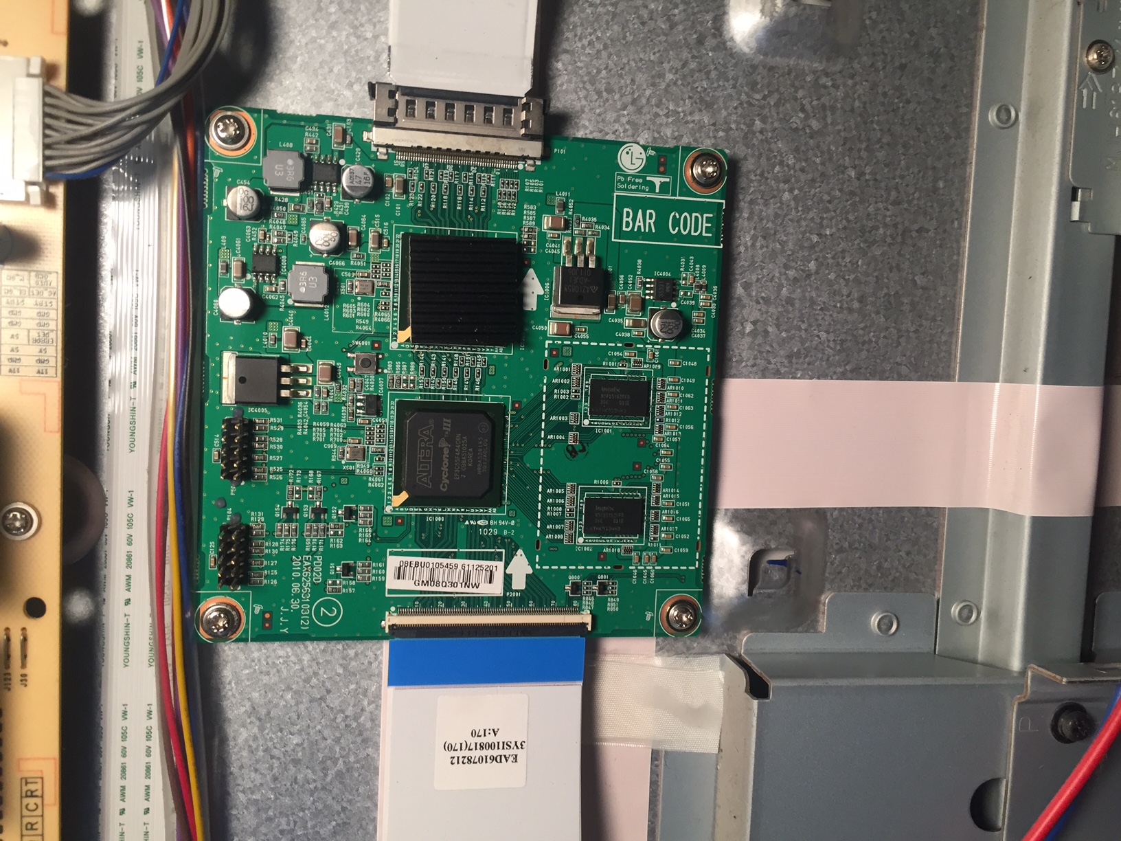

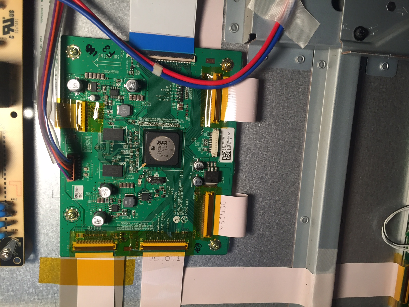

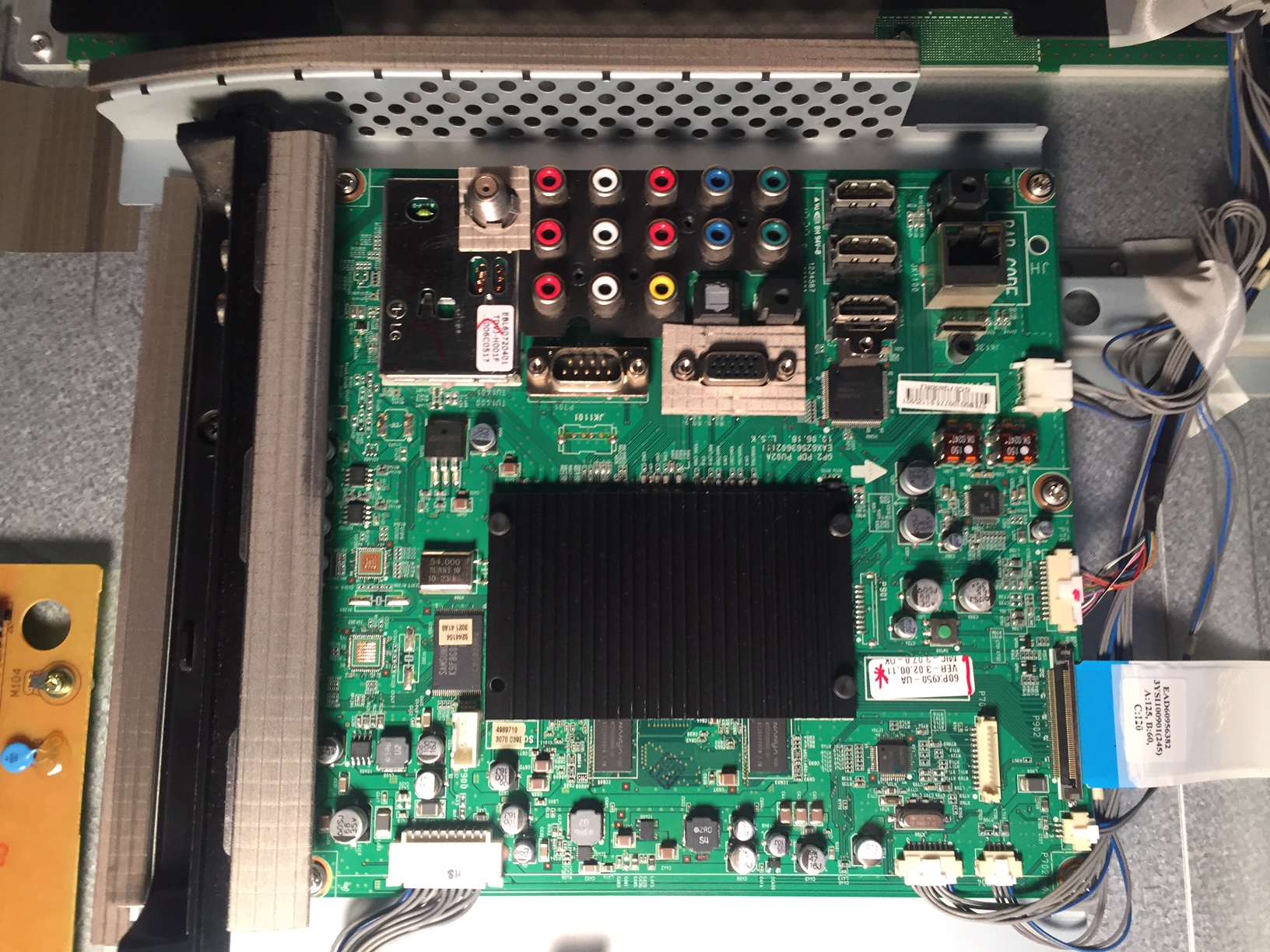

                      • kca
                        • Feb 2016
                        • 529
                        Other boards:

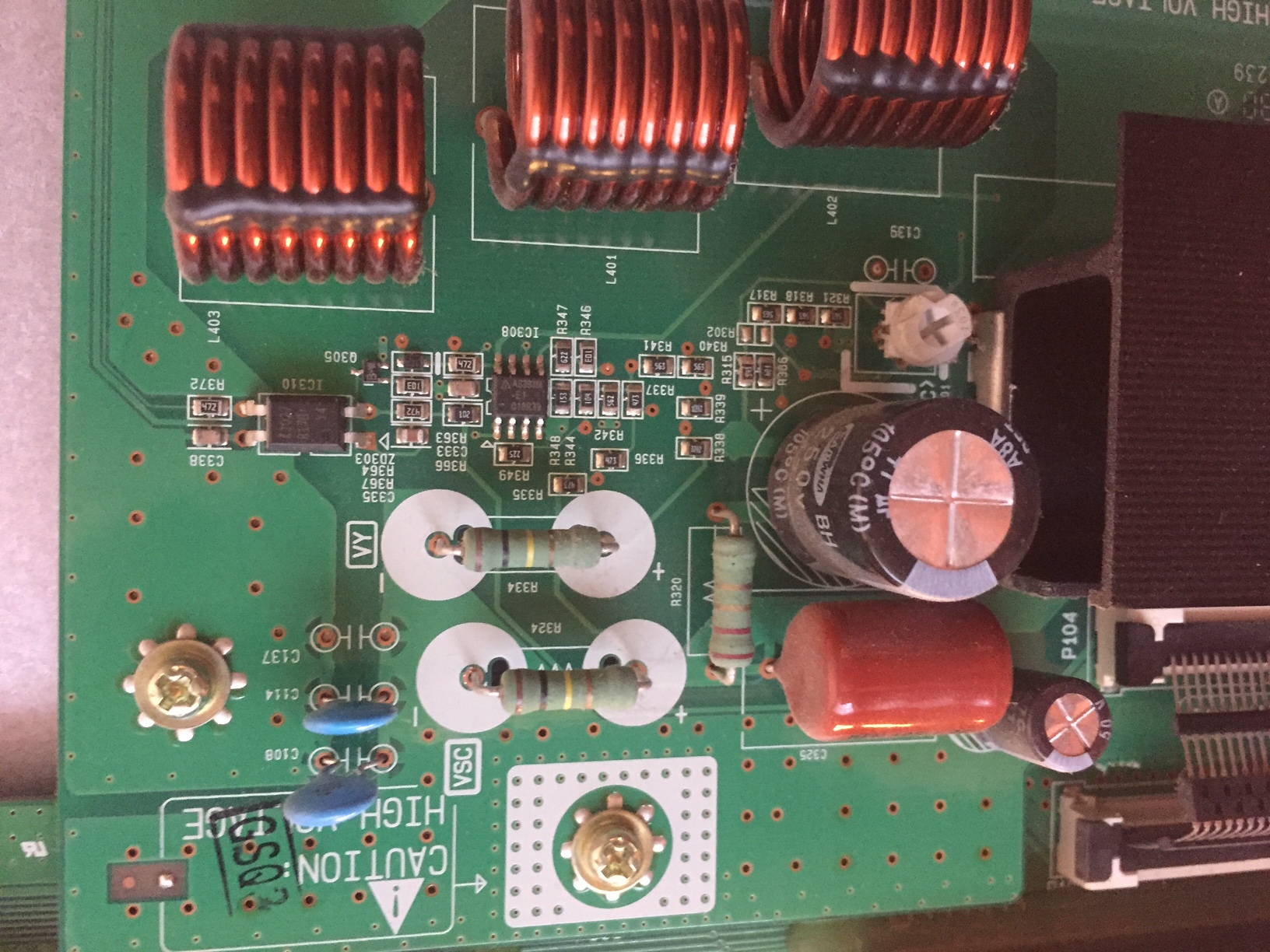

                        • Hamie
                          • Apr 2014
                          • 1383
                          Look on the z-sus
                          I can see a resistor marked VZB.
                          This is Zbias, measure ACROSS the resistor, post your voltage.
                          You should have similar points on the ysus for vsc and Vy.
                          Again there should be test points, measure across them.
                          Ie: Don't use the frame or screws for ground.

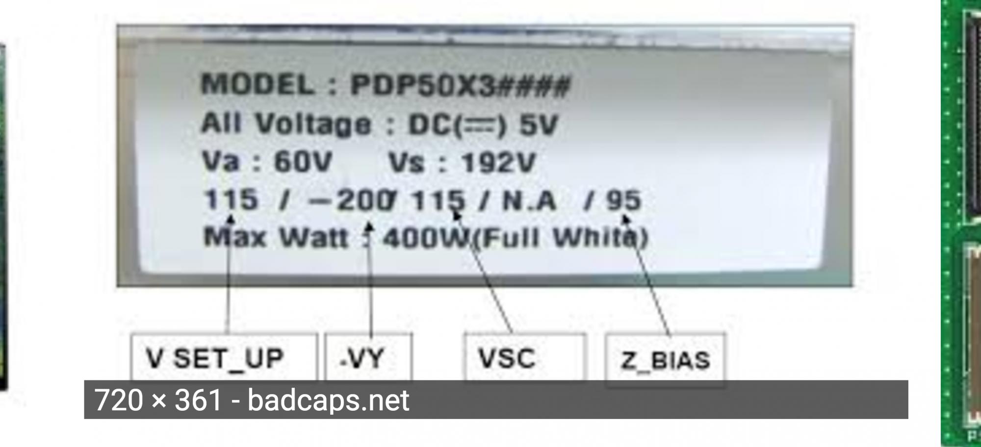

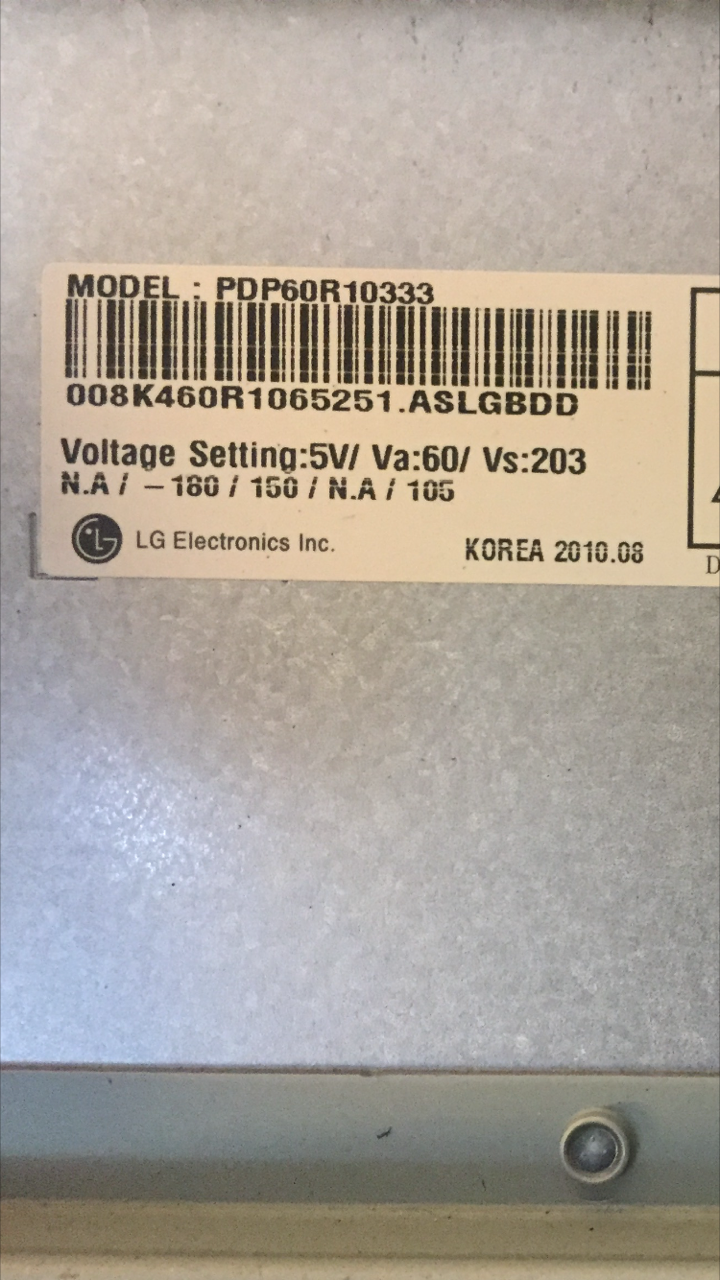

                          • kca
                            • Feb 2016
                            • 529
                            Hello Hamie ~
                            I found this post where you had helped someone before (see pic), and took your advice just now to get the readings across the resistors in question. Here are the results:
                            Zbias = 104 (reading on my sticker is 105)
                            VSC = 17.4 (reading on my sticker is 150)
                            and
                            -VY = 179.7, which I assume is really -179.7 (reading on my sticker is -180)
                            So, it looks like of the three the VSC is the only problematic one. Unless I measured it wrong, but I did the same to that resistor as I did to the other two.
                            Have you seen this before, where a reading on the VSC is approximately 1/10 of what it really should be (i.e., 17 / 150)? And, do you think that is a singular source of the picture issue or is there more at hand?
                            • Hamie
                              • Apr 2014
                              • 1383
                              OK so you either have a problem with the ysus or buffers.
                              Unplug the buffers so they nolonger are connected to the ysus.
                              Then retest vsc and see if the buffers are pulling down it down.
                              If not your problem is the y-sustain.
                              It might be easy enough to repair by hand if you can't find a replacement.

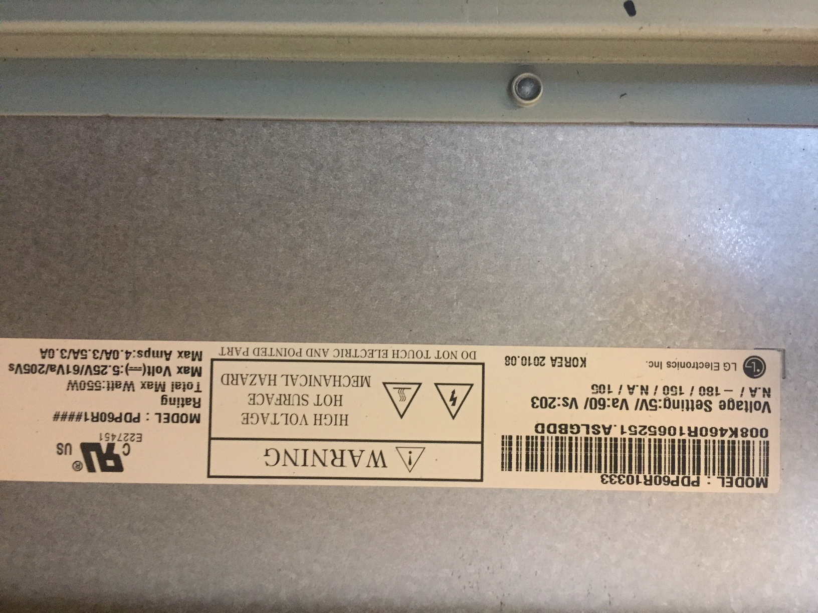

                                    • kca
                                      • Feb 2016
                                      • 529
                                      Images of the Voltage Sticker on this LG 60PX950 UA
                                      (see pics below)
                                      Hamie ~ Does the 150 number in this sequence represent the desired VSC voltage?

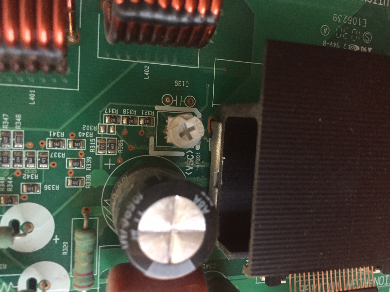

                                      • kca
                                        • Feb 2016
                                        • 529
                                        One more set of images below off of the upper-left hand corner of the YSUS that might be helpful. The two resistors are where I took the readings, and the close up of the VSC control knob sits just below the resistors and slightly off to the right.
                                        Might the VSC control knob need be adjusted? Won't mess with it until I hear back.
