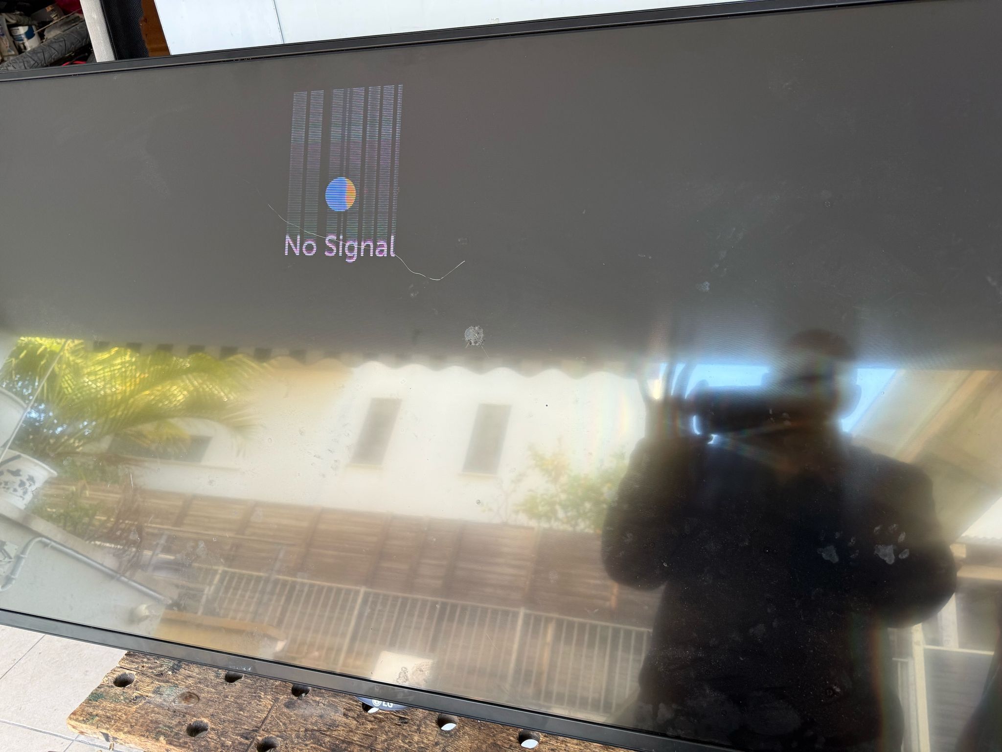

    Hi
    Asking for a friend.
    I'm used to black vertical line in otherwise good image - probable solution is a rubber to push and tighten the COFs bonding.
    but here its the opposite !
    TV has new T-con = same issue
    A missing panel voltage would have global effect
    So , what should one do ? how can I find where the fault is ?
    Thanks !

    Panel short it appears. I would say it's dead.

      Thx EazyBone
      Turns out the guy has 3 ( 3 ) of that Model with SAME issue. I asked him to note the production date , might be (emerging) known issue.
      For now , I sent him to look for fluctuating VGH VGL LCx..

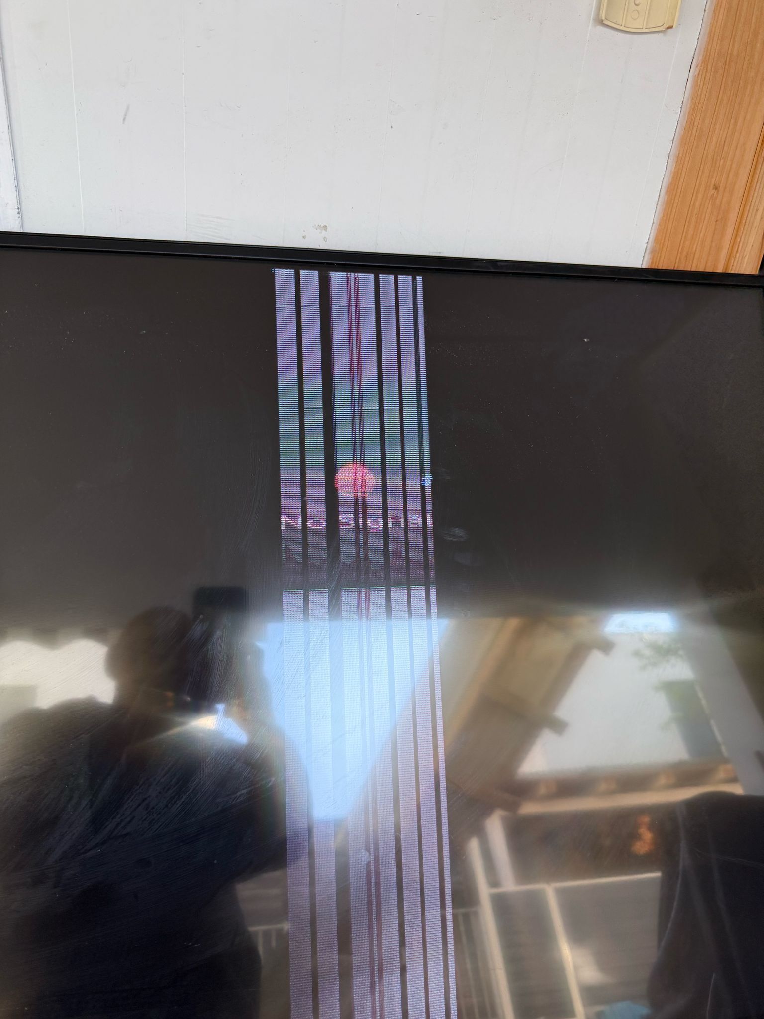

        this LG EBT64022702 Main Board with ONE SoC knowing issue with BGA at SoC

            It can, many things can make strange lines, bad tcon, bad cap, tvs diode etc.

              yes. exactly these lines at the middle are SoC BGA
                  Thx ! it does make sense because these are image ( production lines ) lines and not no_image ( usually dark / black ) lines.
                  Does reflowing work ? or is it a faulty IC ?
                  I'll try to reflow and report here

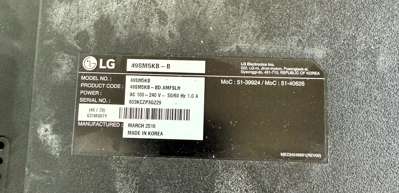

                      LG 49SM5KB
                      Reflow = No change.
                      New T-con .
                      Could it be Firmware corruption issue ( Logo appears etc ofc )
