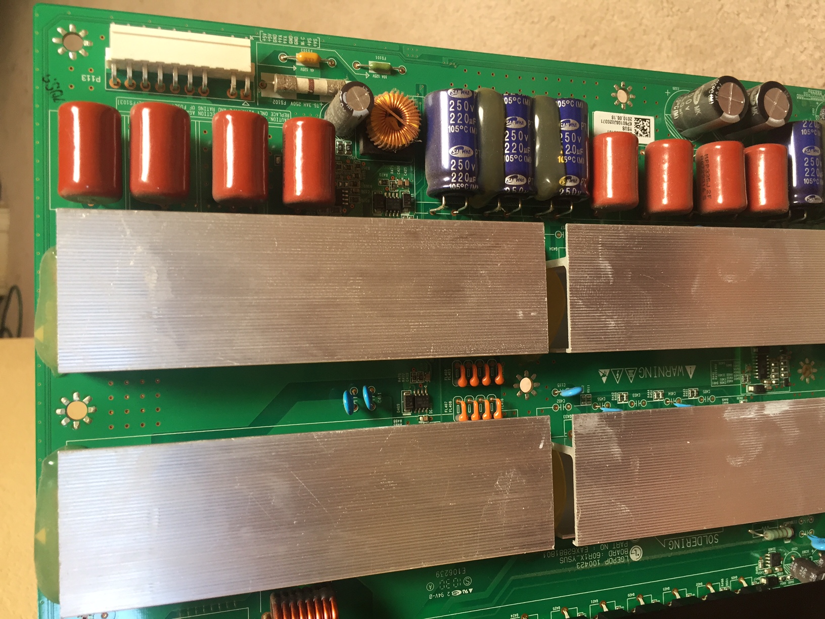

            From the information you've told us it would appear that your problem is the y-sustain.
            So pull the board out and take some good photos of the top and bottom sides.
            Check to see if any IGBTs or DIODES mounted to heatsinks are shorted. Check all fuses and fusible resistors to see if any are open. The main fuse will be fine since its getting power but there are more you'll need to check.
            Please don't start desoldering parts. If there's anything suspect just post it and someone will respond.

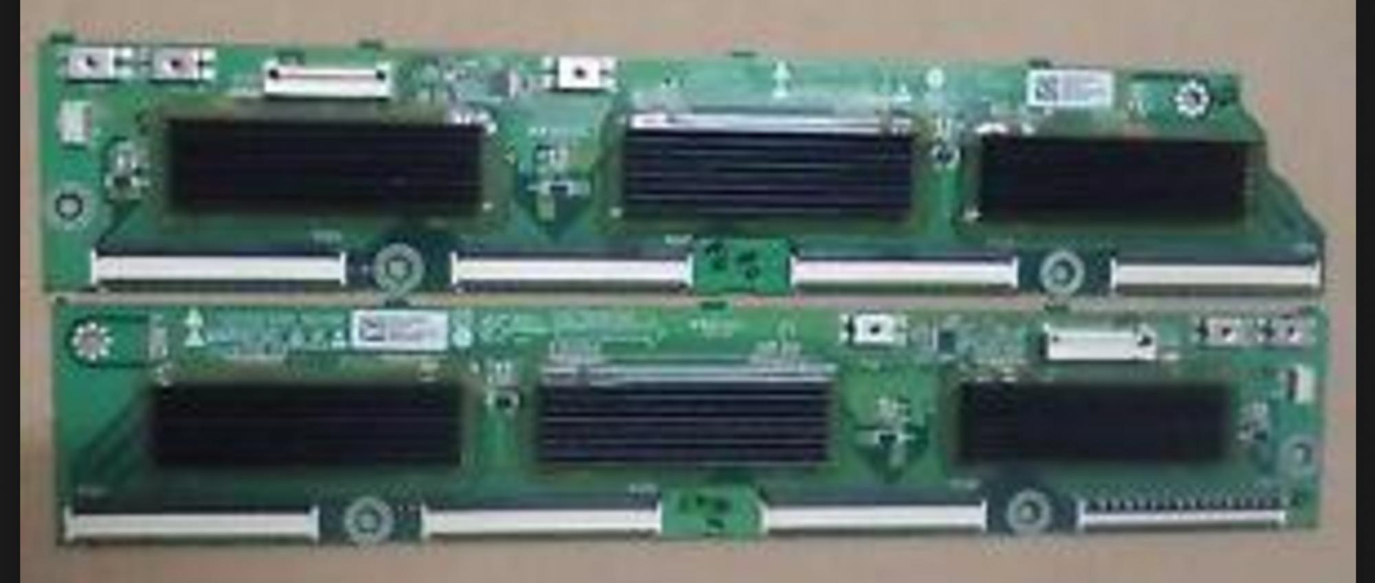

              As a side note, I disconnected the Lower Y-Buffer only this morning and powered it up. I expected to see the pixelation only on the top half of the screen, but in fact it started to run the same left to right sequence and the green pixelation still ran from the top of the screen all the way to the bottom. I only left this plugged in for about 10 seconds, as I didn't want to damage the upper buffer board or anything else.
              With what's going on re: the Vsc voltage, was this to be expected, even with the lower buffer isolated?
              And, there is a long/short, long/short followed by about 3 seconds of no light (then repeats) on the green light on the control board. Not sure if that's normal or if it's an error code. If it's the latter, maybe someone could point me to a listing of the error codes for this particular set.

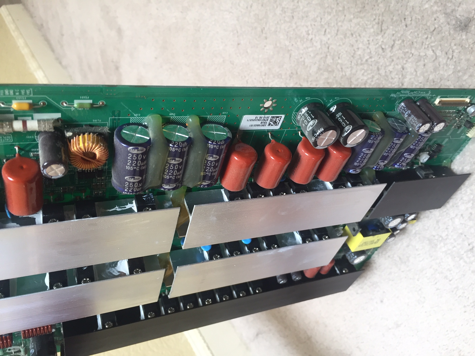

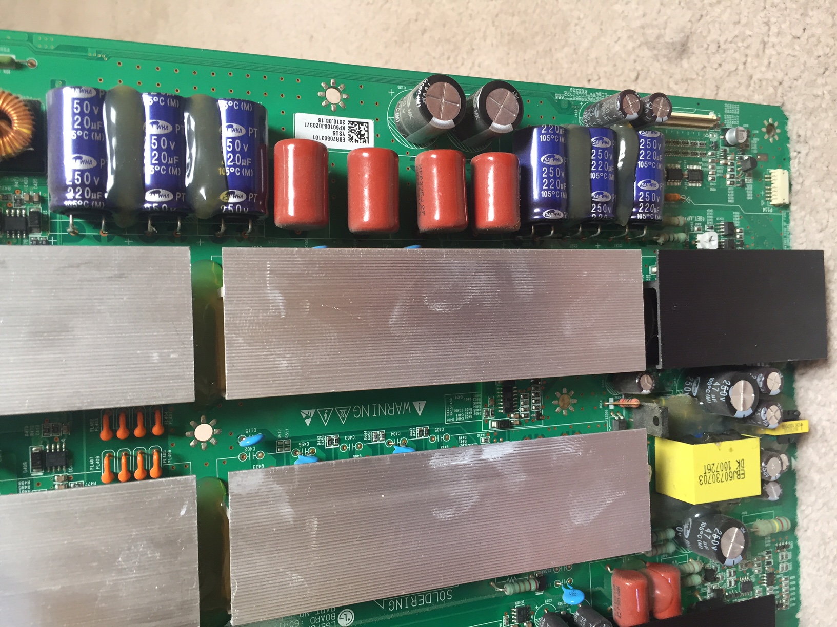

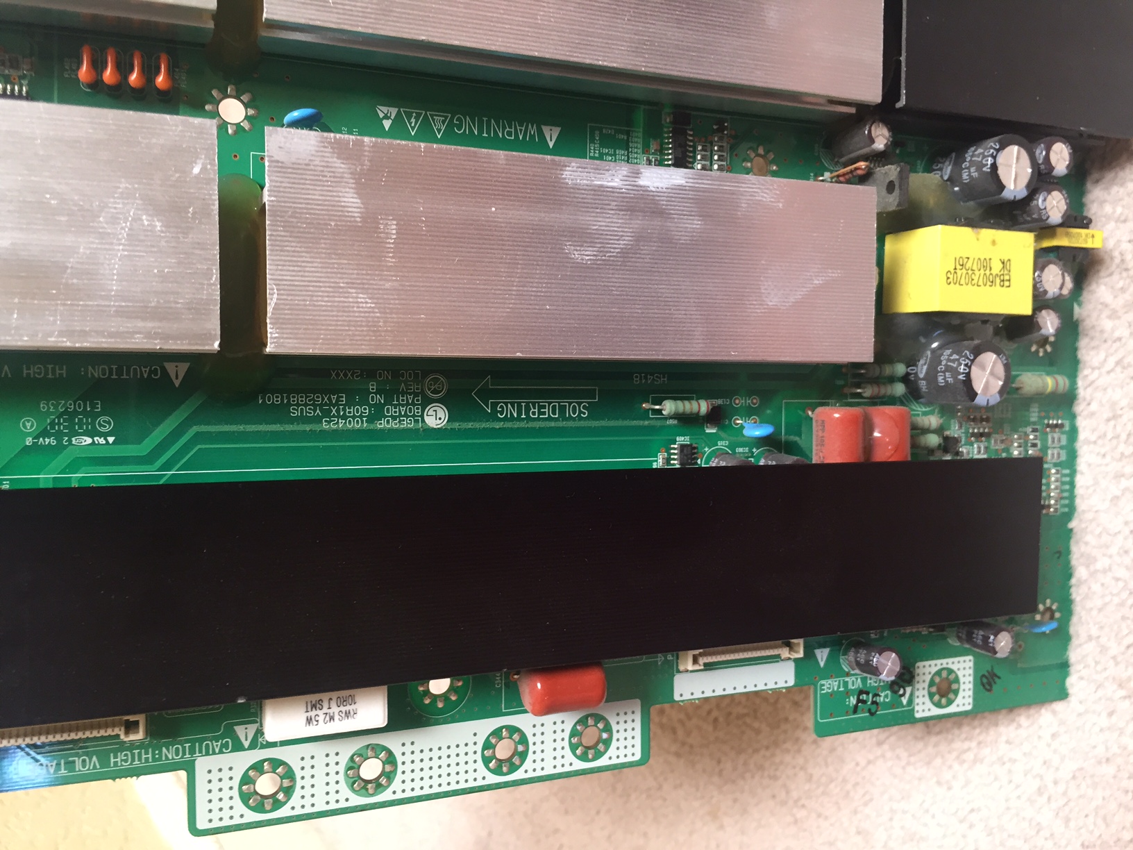

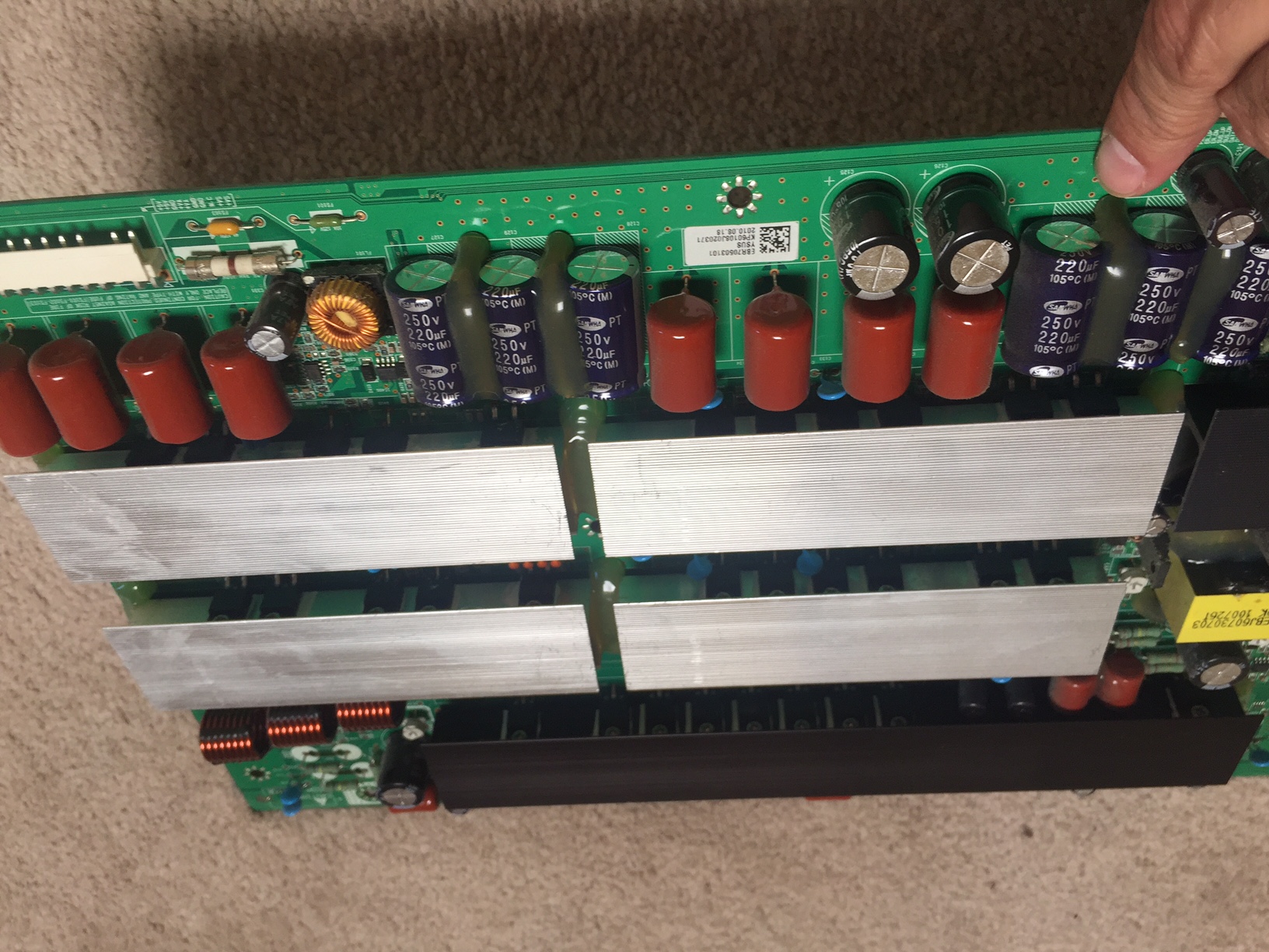

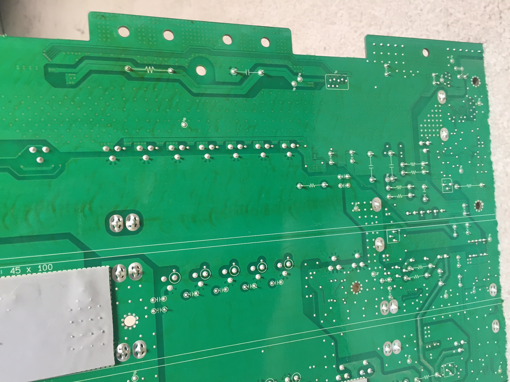

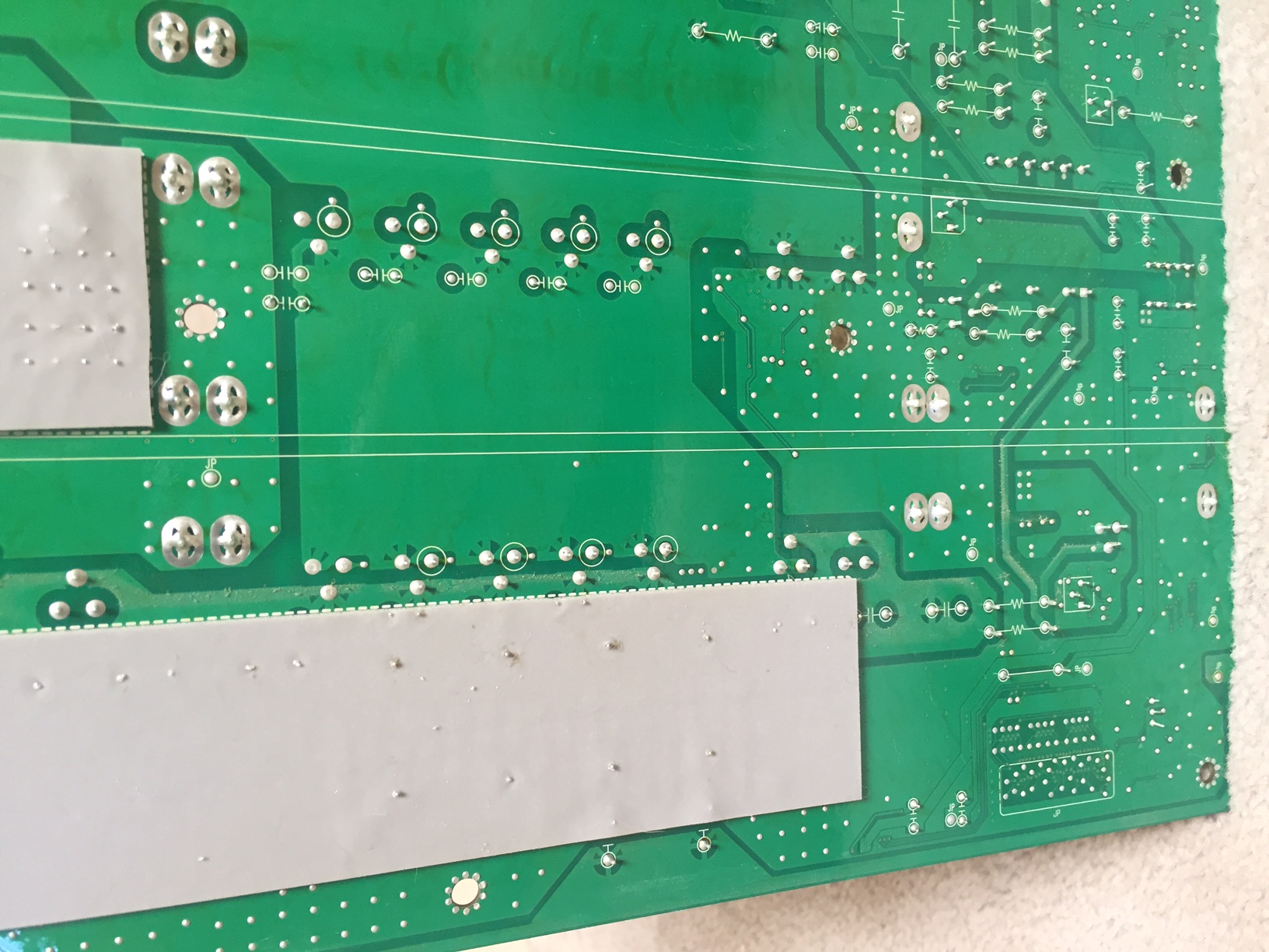

                Re: LG 60PX950 ~ Vertical Pixelation Issue

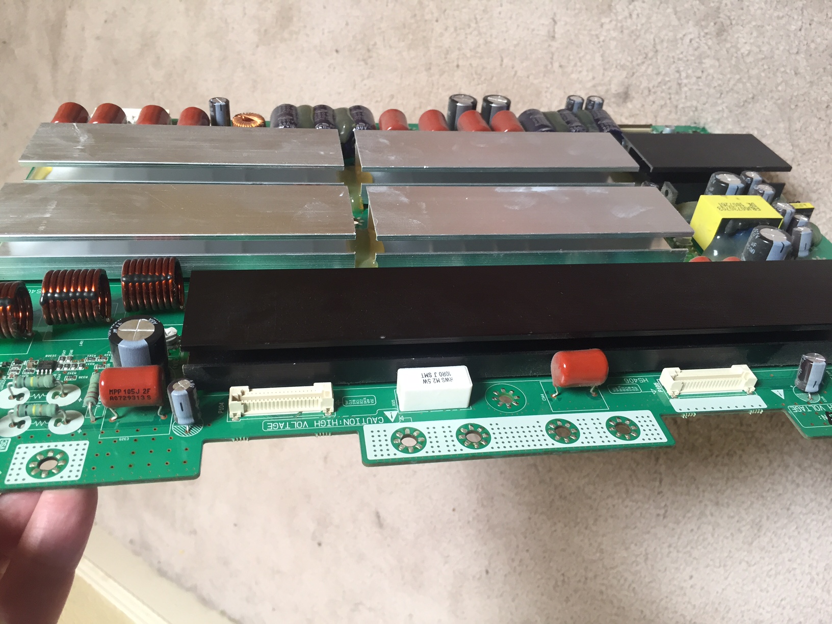

                Here are the detailed pics of the YSUS, front and back.
                Hopefully they will come through with the image right-side up.
                If anyone spots an issue, please let me know both where it is and how to diagnose/attack it. As of yet, I haven't had to go to the level of diagnosing any of the YSUS boards on previous sets I've worked on. So, I appreciate any guidance that can be provided. Thanks.
                • kca
                  • Feb 2016
                  • 548

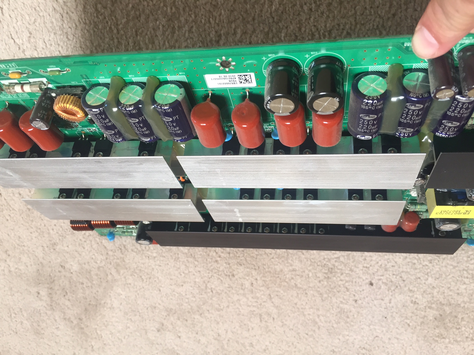

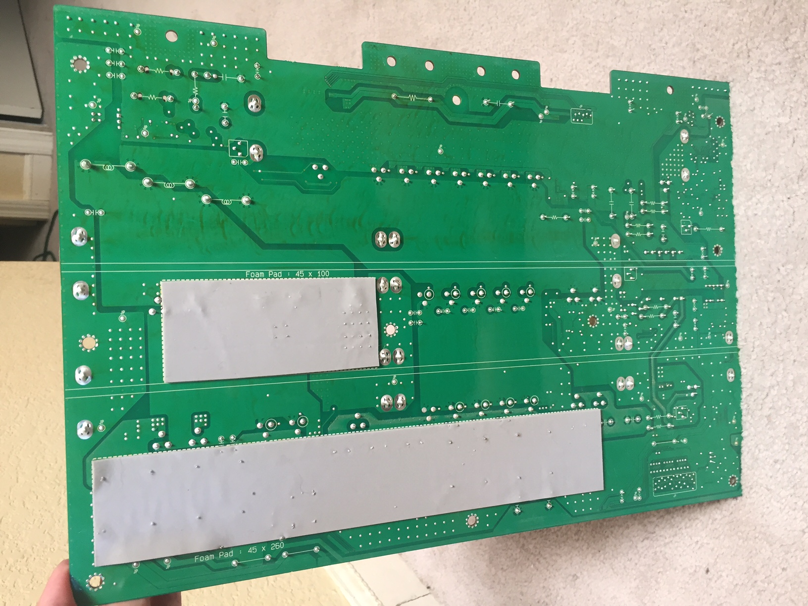

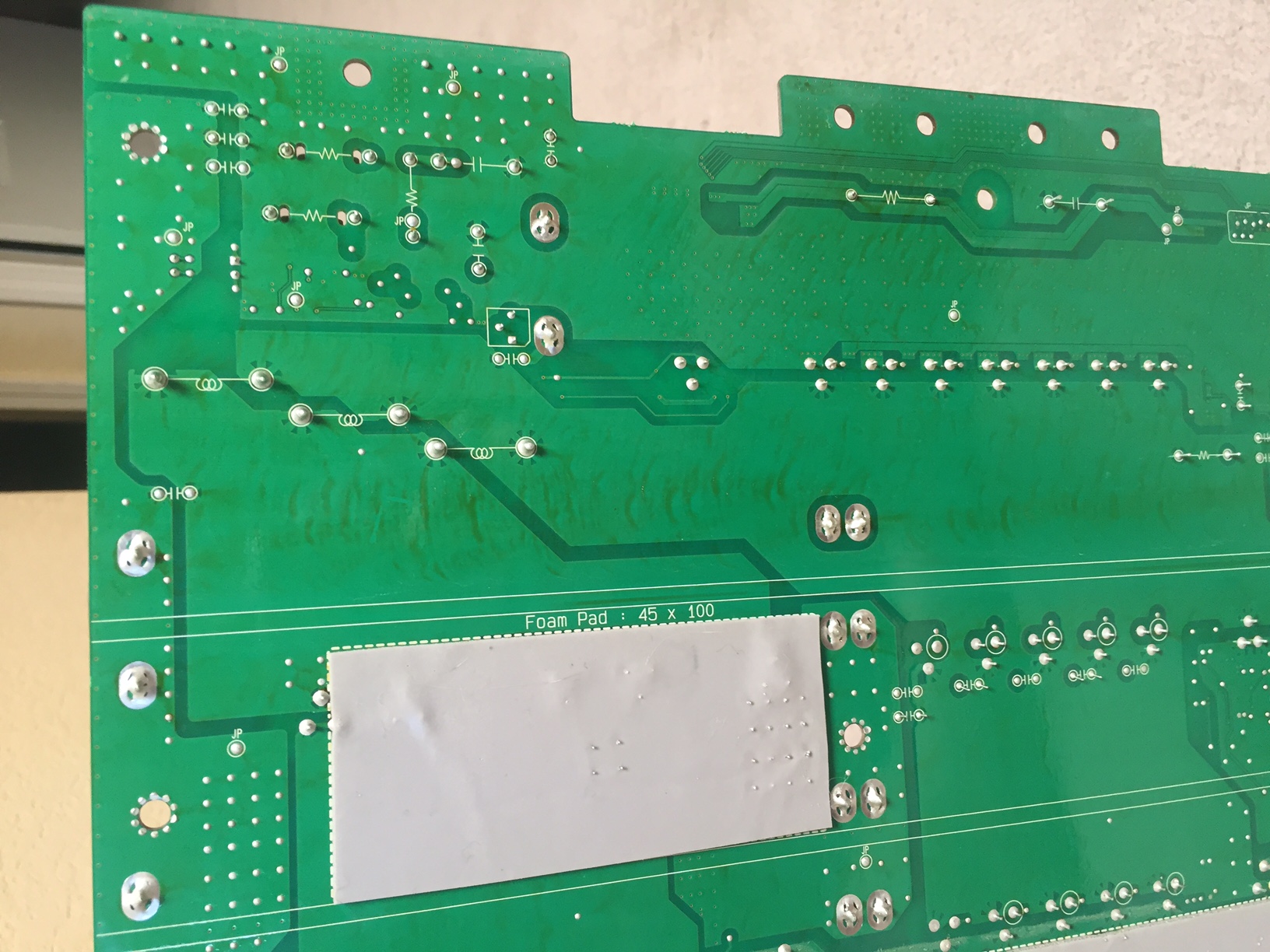

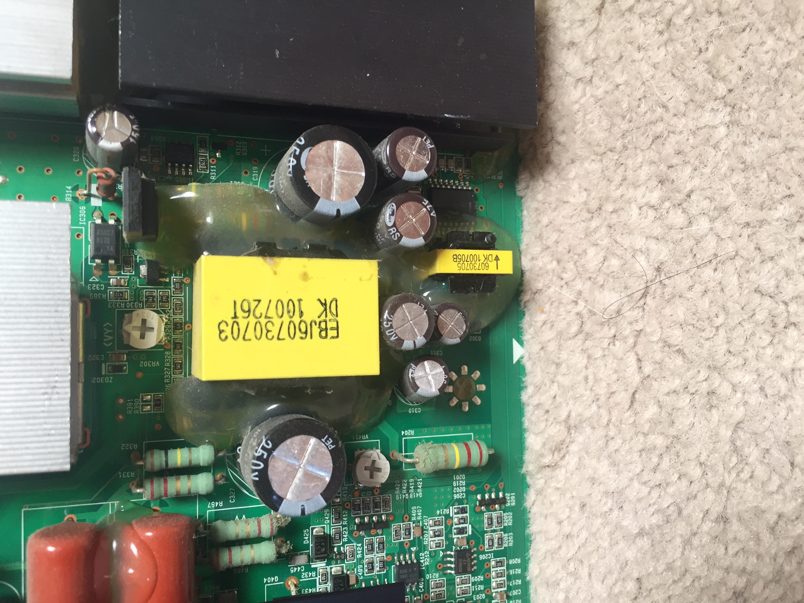

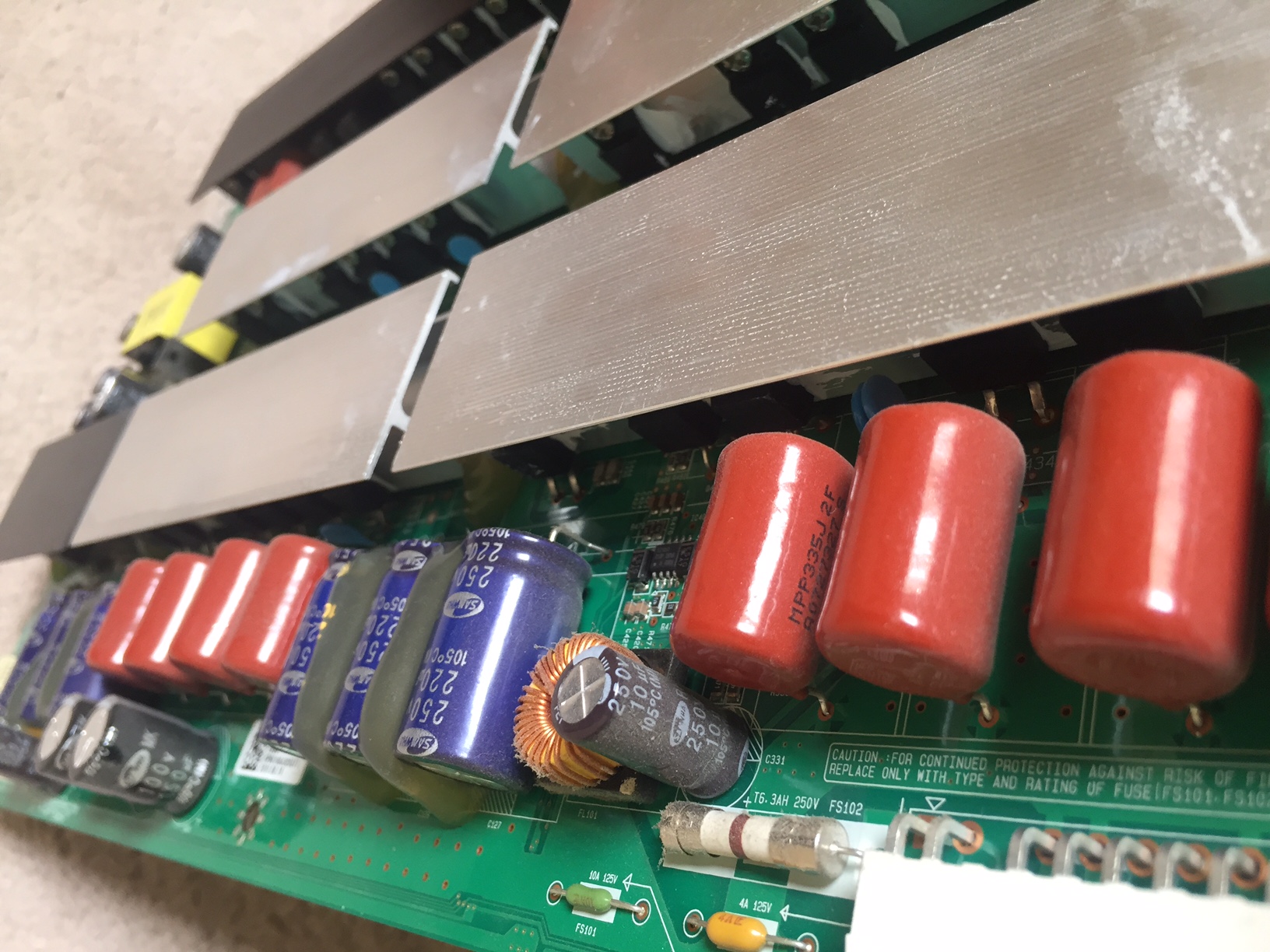

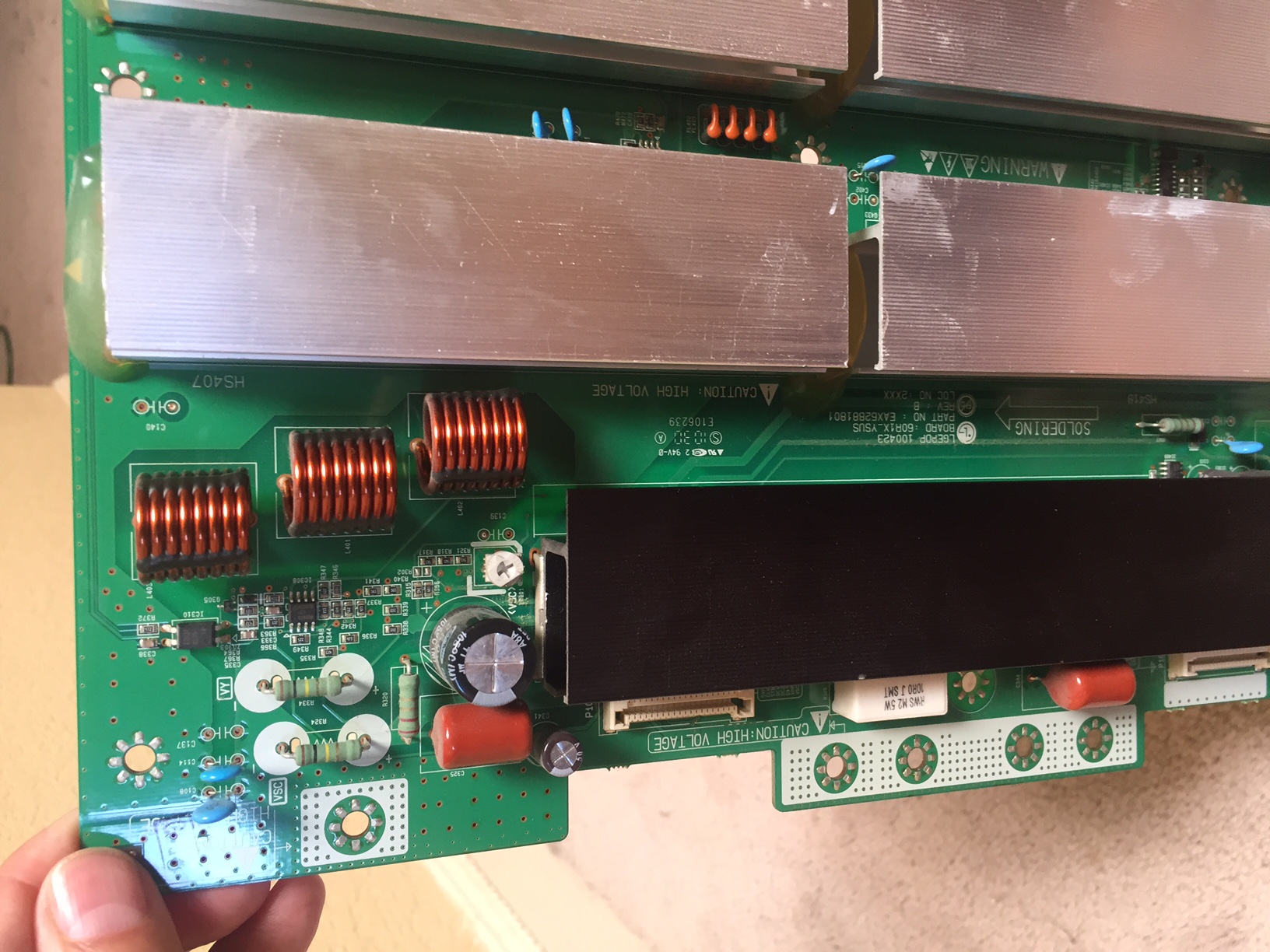

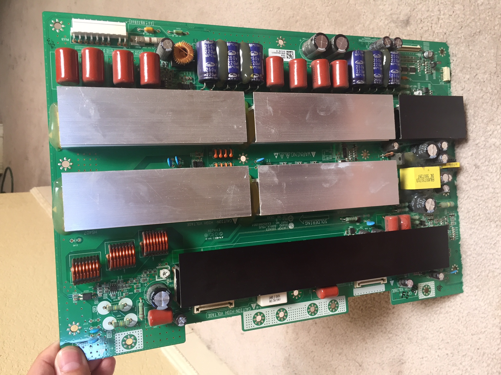

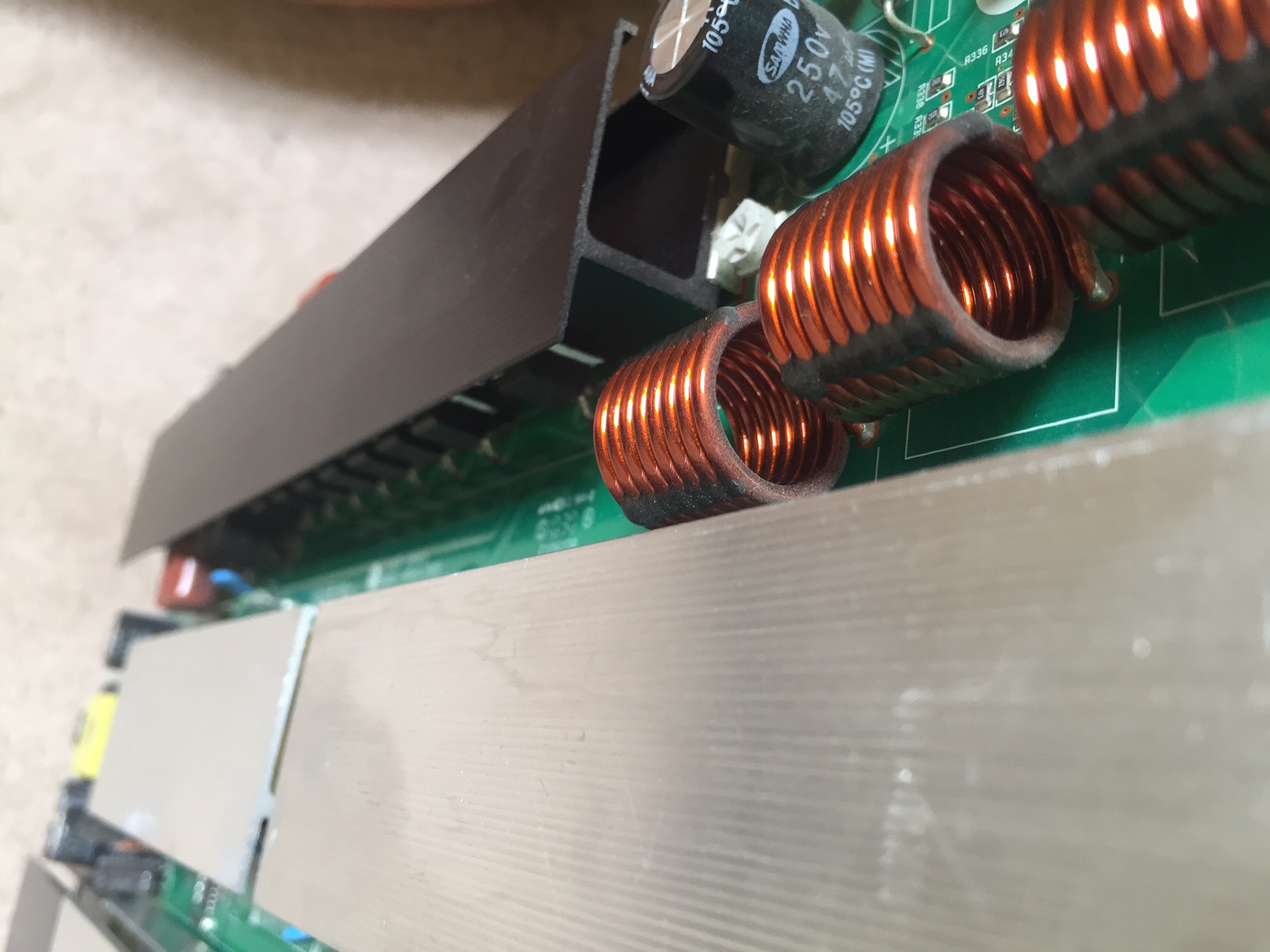

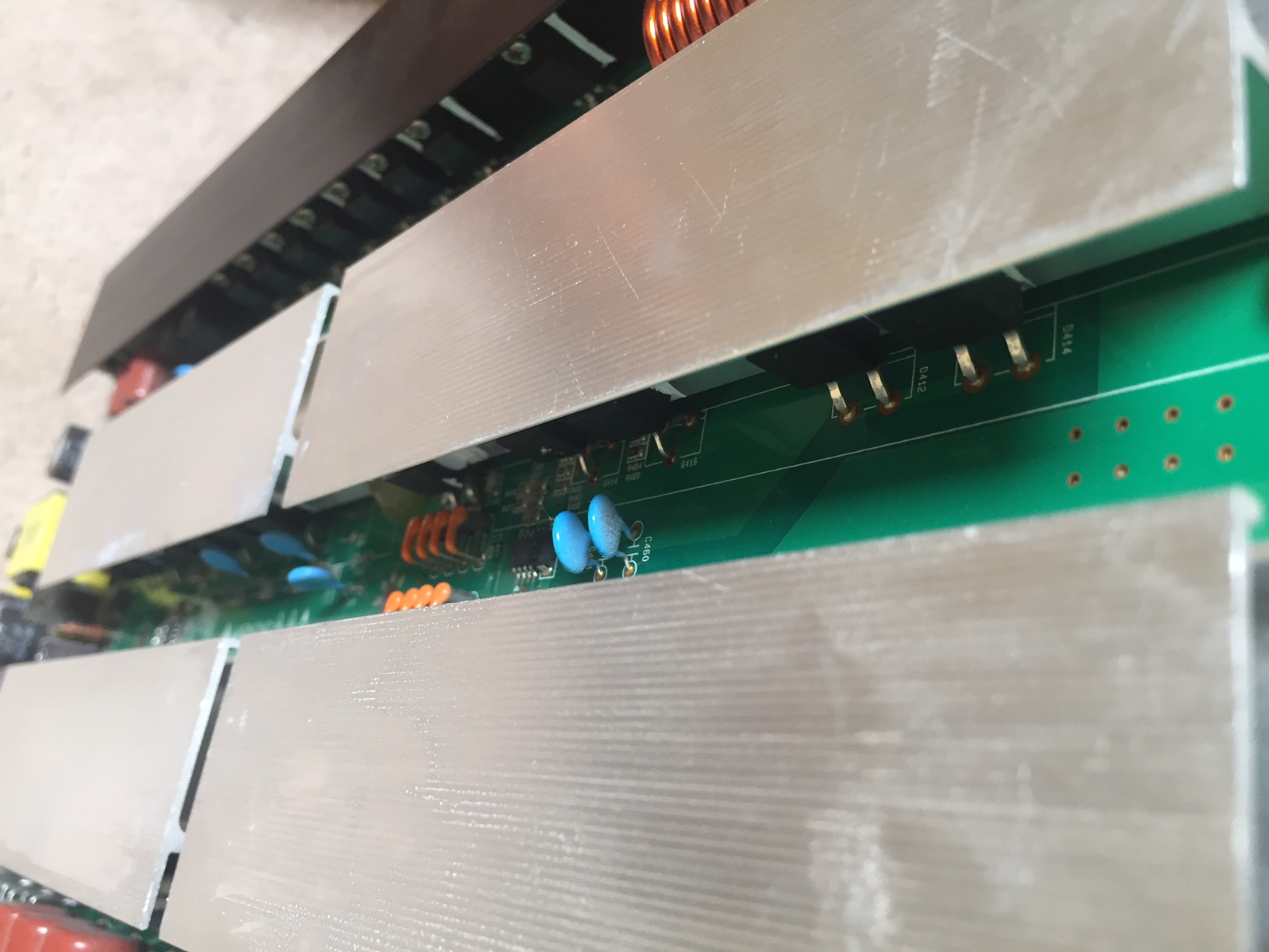

                  Well, it looks like all of the images above got posted with a 90 degree rotation to the left, but that's okay.
                  Here are 8 more images, taken from different angles:
                      I don't see anything that is broken or burnt on this YSUS board, but maybe someone else will. I also want to make sure that this problem is not really originating from the control board or another board, before attempting to fix the YSUS. Does the blinking code I mentioned above in Post #26 mean anything?

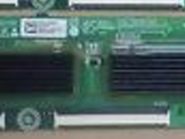

                      Another piece of info: Regarding the Y Buffer Boards, I placed the DMM probes onto the six, small black elements (see center of pic) that sit adjacent to the six IC's, and obtained the same readings on all six. Is this enough of an indication that the Y Buffers are okay or will they need to be tested further?

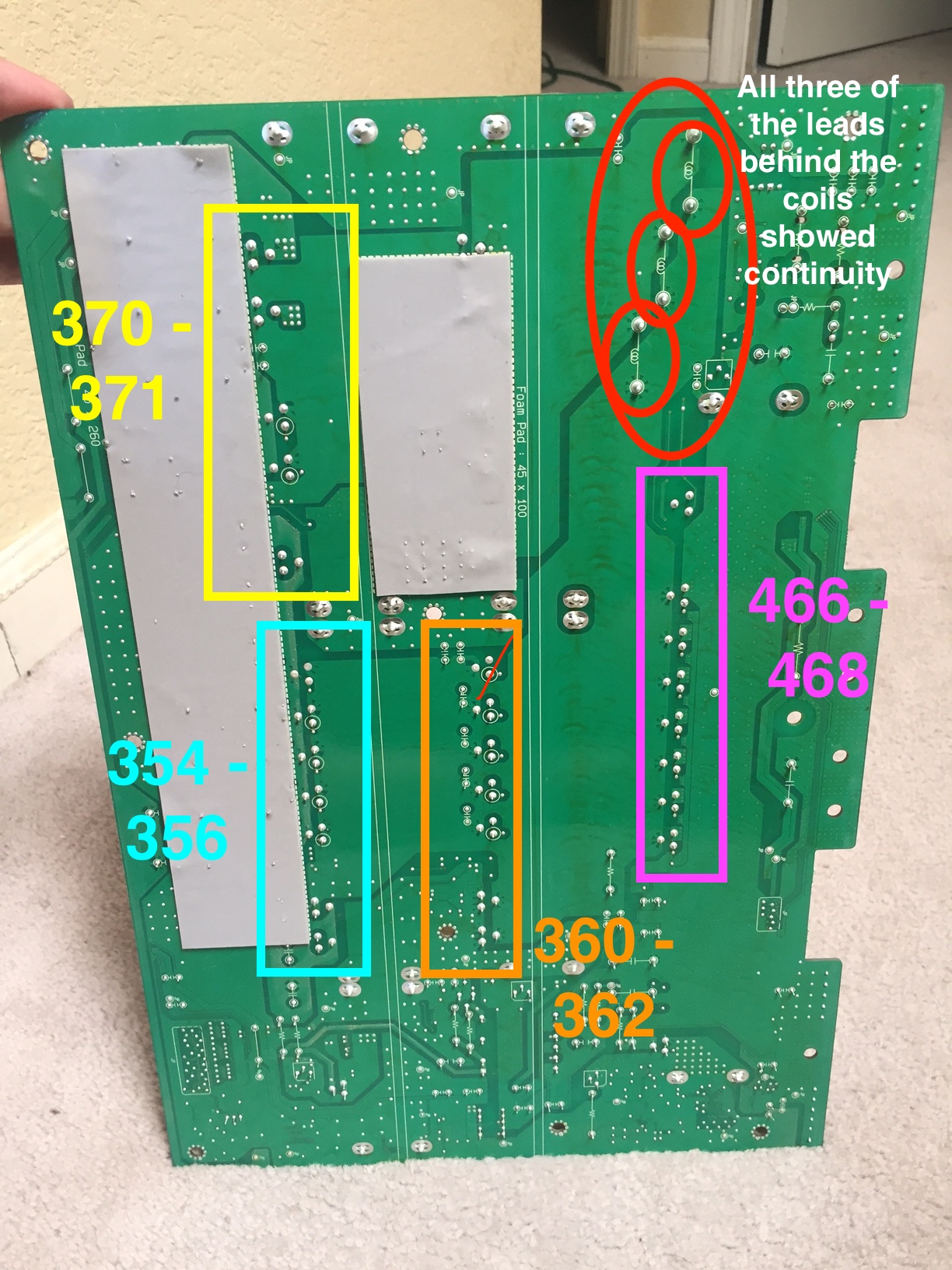

                              • kca
                                • Feb 2016
                                • 548
                                #35
                                Yes, it has a continuity mode where the touching of the probes produce a continuous beep.
                                I used that mode to test all of the fuses, which are all ok.
                                I also got the continuous beep (continuity) when I touched the leads coming off the three large copper coils. This was done with the board completely off the back of the set.
                                • Hamie
                                  • Apr 2014
                                  • 1383
                                  #36
                                  OK so everything attached to heatsinks, see if any of the IGBTs are buzzing in ALL directions. If any are they are almost certainly shorted.
                                  Make sure you test the ones under that thermal pad.
                                  You don't need to remove them from circuit. Just turn the board over and touch the pads
                                  Note: some might have 2 pins tied together so they will test shorted but may be OK.
                                  For now concentrate on finding one/s that are shorted in all directions.
                                  • kca
                                    • Feb 2016
                                    • 548
                                    #37
                                    And, I put the probes on the triangular shaped leads coming off the back where the heatsinks are. I tried to mark up a photo of the results. Here are the numbers I got:
                                    • kca
                                      • Feb 2016
                                      • 548
                                      #38
                                      The numbers in the image above were obtained with the DMM in the shared Continuity/Diode mode. See image below of the Sears Craftsman Digital Multi Meter I am using

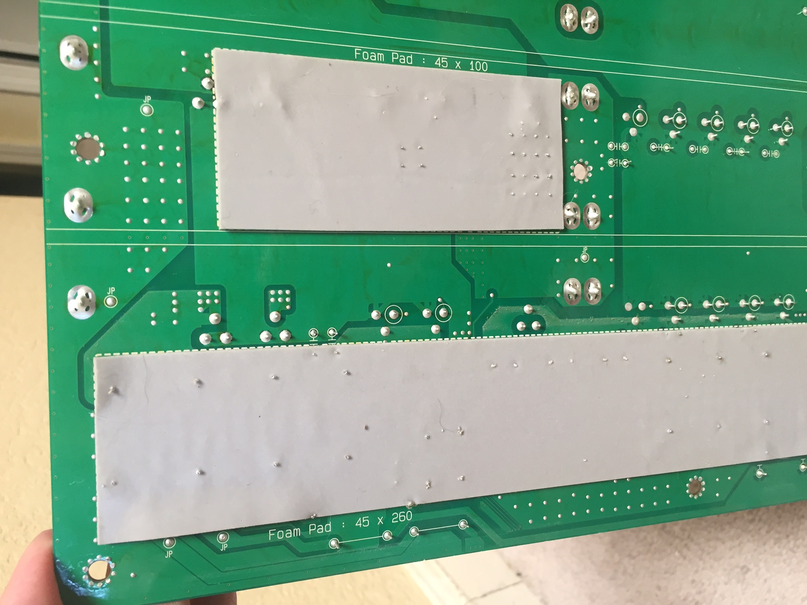

                                      • Hamie
                                        • Apr 2014
                                        • 1383
                                        #39
                                        Under the foam pad?
                                        You seem to be over complicating things here. We just need to know if any of them are shorted... Ie buzzing in all directions.
                                        • kca
                                          • Feb 2016
                                          • 548
                                          #40
                                          Nothing was buzzing, but I don't know how it would be as I have the board off of the set. Do you mean by placing the board back on the set?
                                          I didn't test under the thermal pad, but I will do that next. Are the readings I posted in the photo above the correct way to read whether these heatsinks are in working order? Or, am I off base? Nothing related to the heatsinks that I tested before produced the continuous beep, which would have happened if they were shorted, correct?
