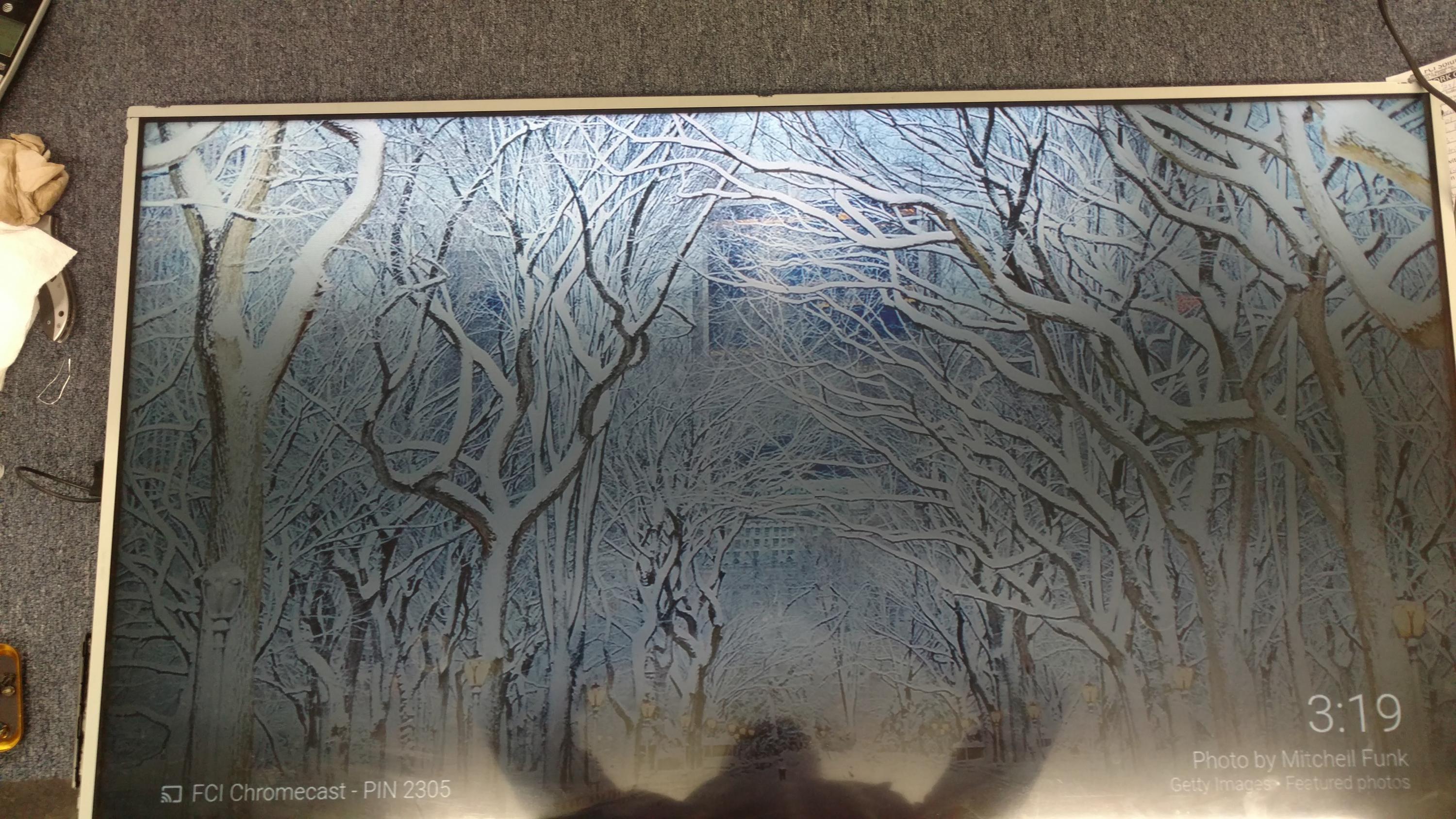

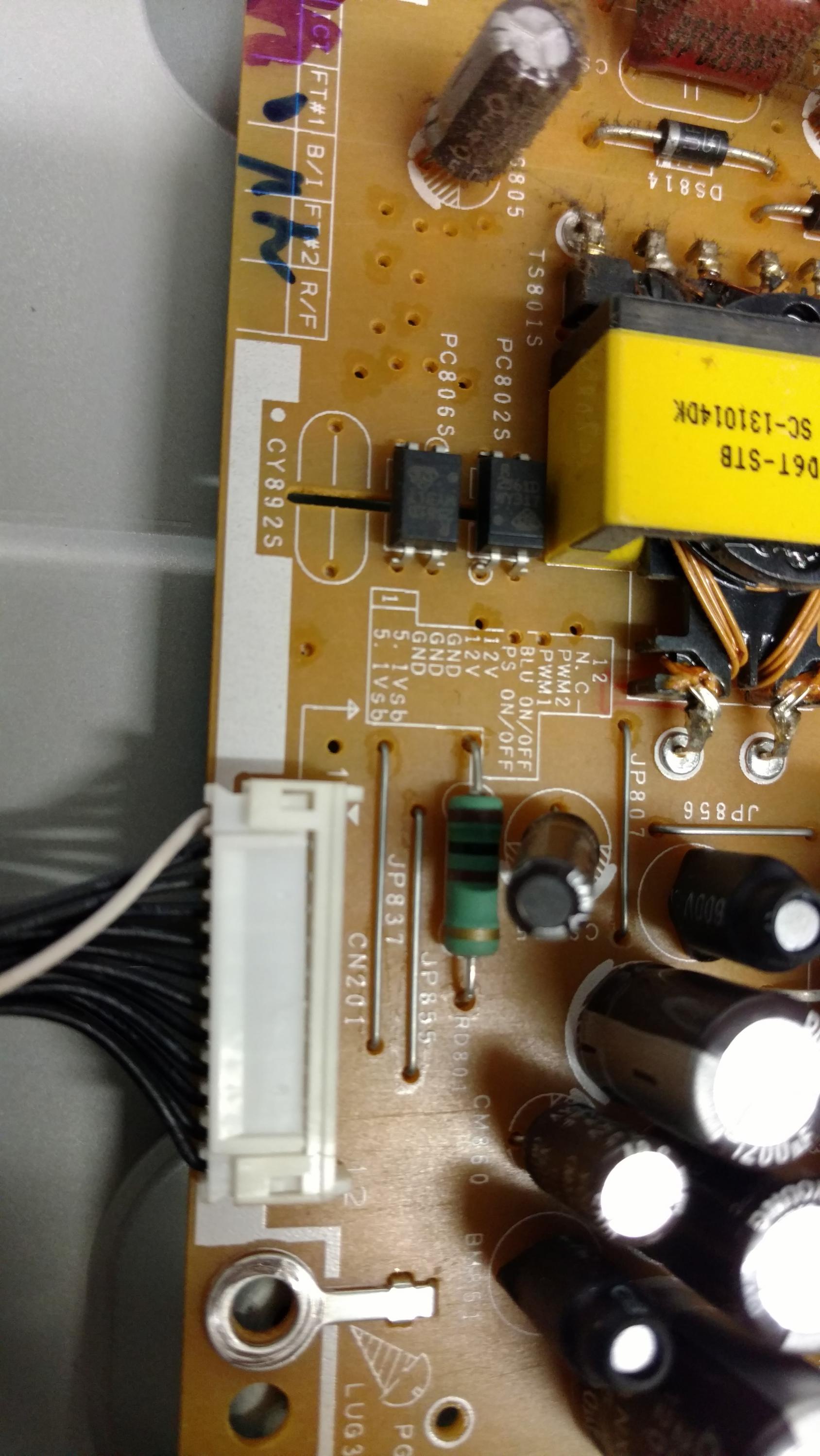

    I didn't have backlights to start so I tested with my led tester from shopjimmy and got 2 different voltage readings even though both strips lit up (with the tester - not the power supply). I took apart the panel and sure enough a bad led strip (was pulling too much voltage). I replaced it and with the tester am now getting 73.5v on one string and 72.5 on the other. But when I connect to the power supply just 1 string of leds is working.

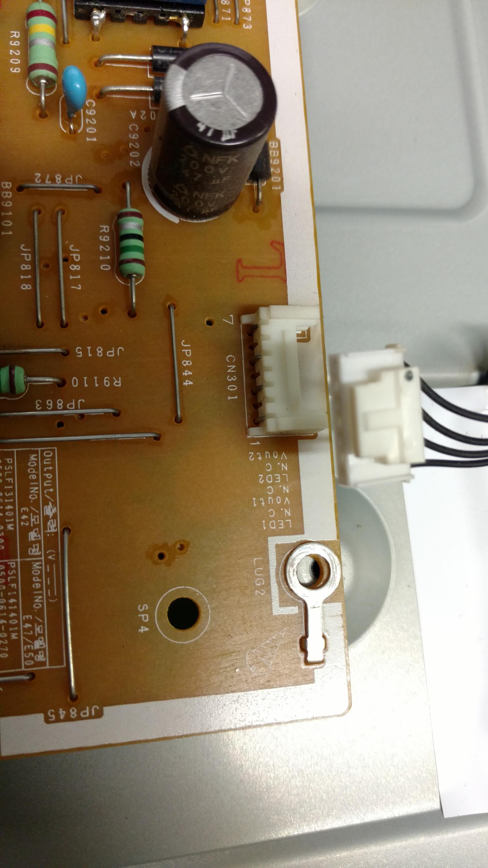

    When I power on the set, I put my voltmeter leads on the led connector on the power supply and get:
    Leds plugged in:
    Vout1 -- 120-130v fluctuating
    Vout2 -- 101v and stable
    Leds not plugged in:
    Vout2 -- 120-130v fluctuation
    So ... Any ideas?

    Re: Vizio E470i-A0 - FL test ok, half bl working
    Open circuit on V1, bad connection on that string
      You have two set of LEDs and two LED driver circuits, it sounds like one of them has open circuit, if you swap the LED connections, the symptom should follow.
        Ok but I think it's V2 @dskall as V1 is the side that's working. So I'll swap the connections in the morning and report my findings. Thanks guys.

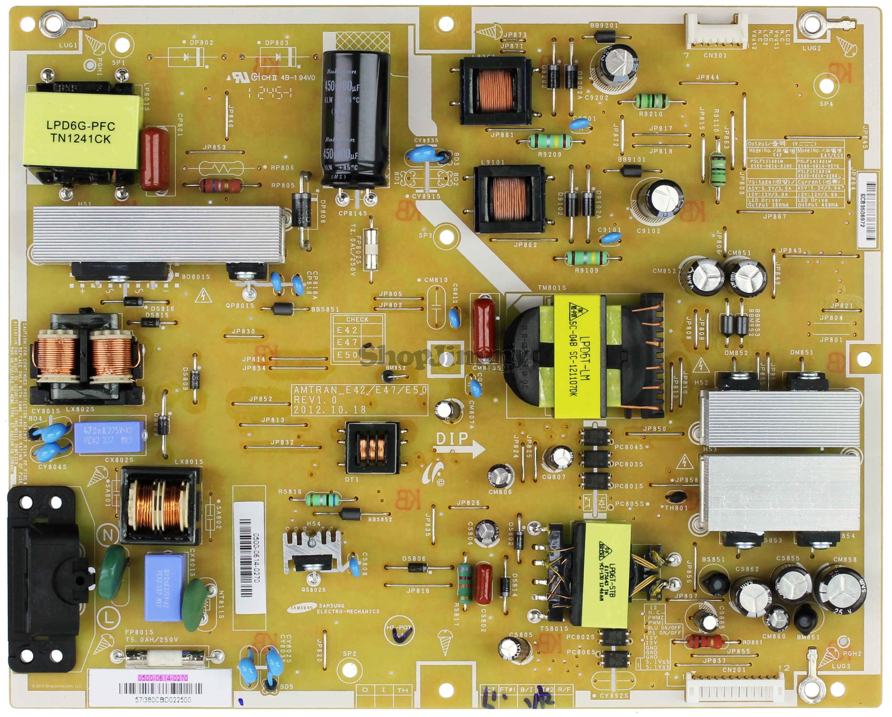

          Vout T1 should be the supply out that is connected to the Anode of the first LED in string one, the LED1 should the Cathode of the last LED in the string which is the return line of the LED string one which is connected to the Drain of the PWM ControlledSMD power MOSFET and then the current sensing resistor and then to GND return, if that string does have open circuit then you should see the Voltage on LED 1 PIN, same setup is applied to VoutT2 and LED2.
          It looks like your board:
          http://www.shopjimmy.com/vizio-0500-...upply-unit.htm
          Pictures provided by shopjimmy.
            Ok great I'll ck those FETs in the morning too. Thanks for the direction. I'm new at troubleshooting a power supply.
              I doubt that the MOSFET are bad they do not go out too often in that section since the typical current is only around 400mA at most, I am more interested in the Voltage of the LED return pins LED1, LED 2.

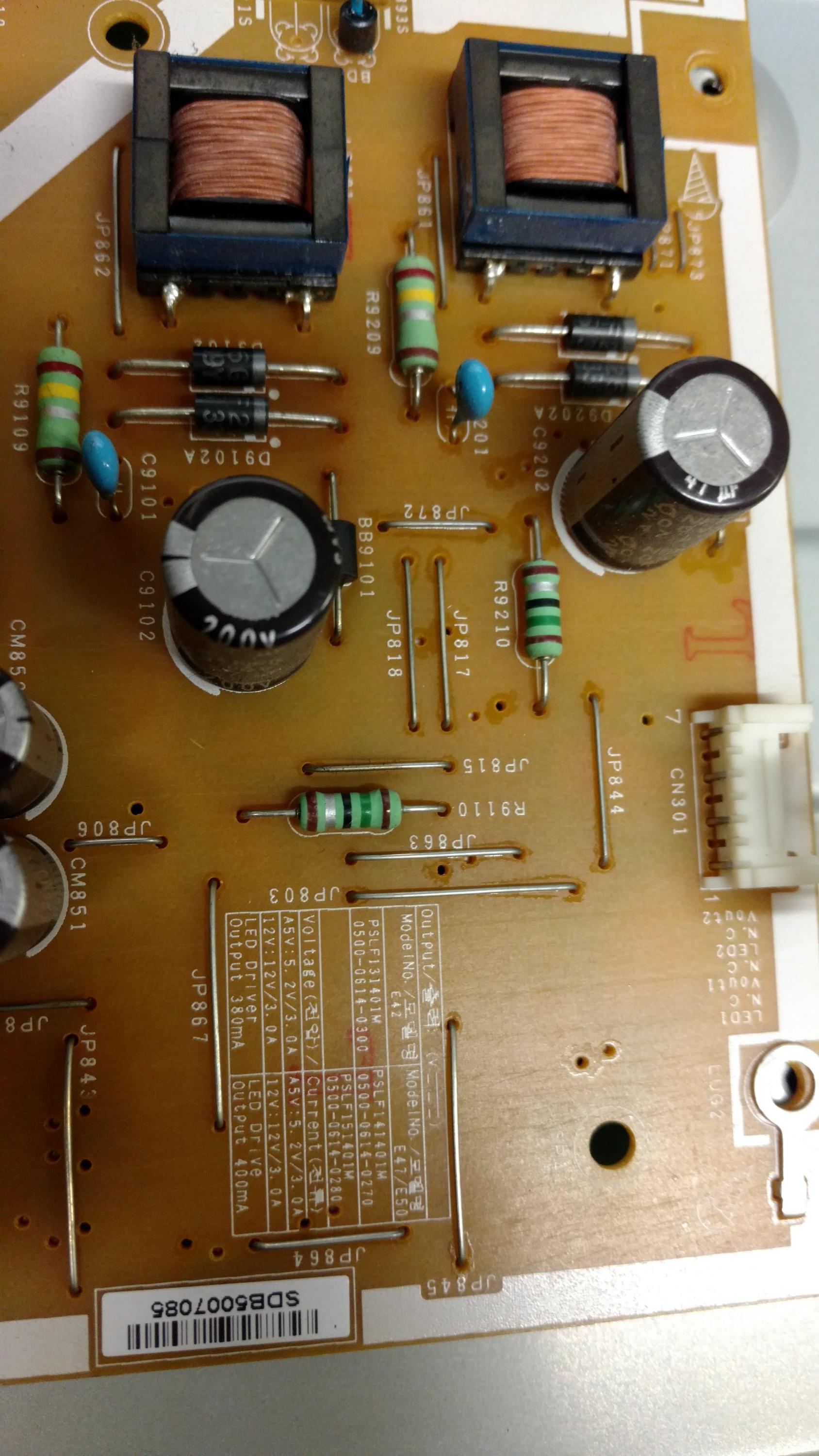

                You have quite a few 0 ohm resistors around the SEM5028 IC that you can check out with the set off using your meter set to ohms.
                  Also I should note that these sets like to have bad connections from the led to the strip. I've seen where LEDs oxidized underneath even though they test good with a voltmeter in diode check mode it doesn't necessarily mean that it's connecting to the board properly so in essence you have an open string
                    BTW:
                    Leds plugged in:
                    Vout1 -- 120-130v fluctuating = No load present
                    Vout2 -- 101v and stable = Has load present
                    Vout2 -- 120-130v fluctuation = No load present
                      @budm
                      With leds plugged in:
                      Led1 --- 60-68v
                      Vout1 --- 120-128v
                      Led2 --- 0.9v
                      Vout2 --- 101v
                      With leds unplugged:
                      Both Vout1 &2 are 128v and LED1 &2 are 0v
                      @dick_barton
                      the first set of resistors were 1.5ohm and the other set 0.4ohms
                        So the resistors are OK. Looks like a led fault.
                        • fcisolutions
                          • Jan 2017
                          • 205
                          Yes it was a bad led string. What threw me was the led tester showing near equal voltage readings. But when I went back in and individually tested each strip, I noticed one that would fluctuate.
                          Thanks to all that commented.
