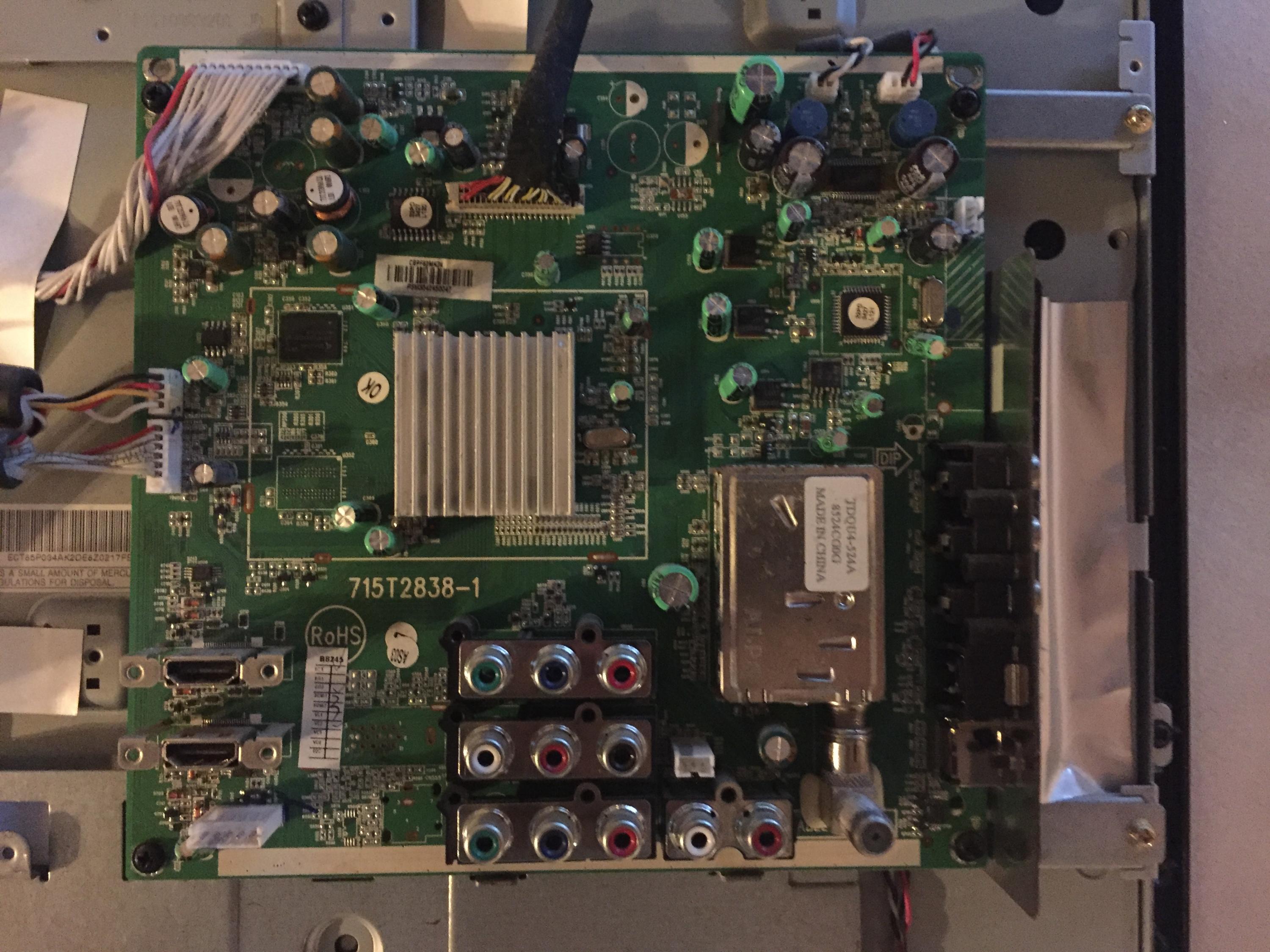

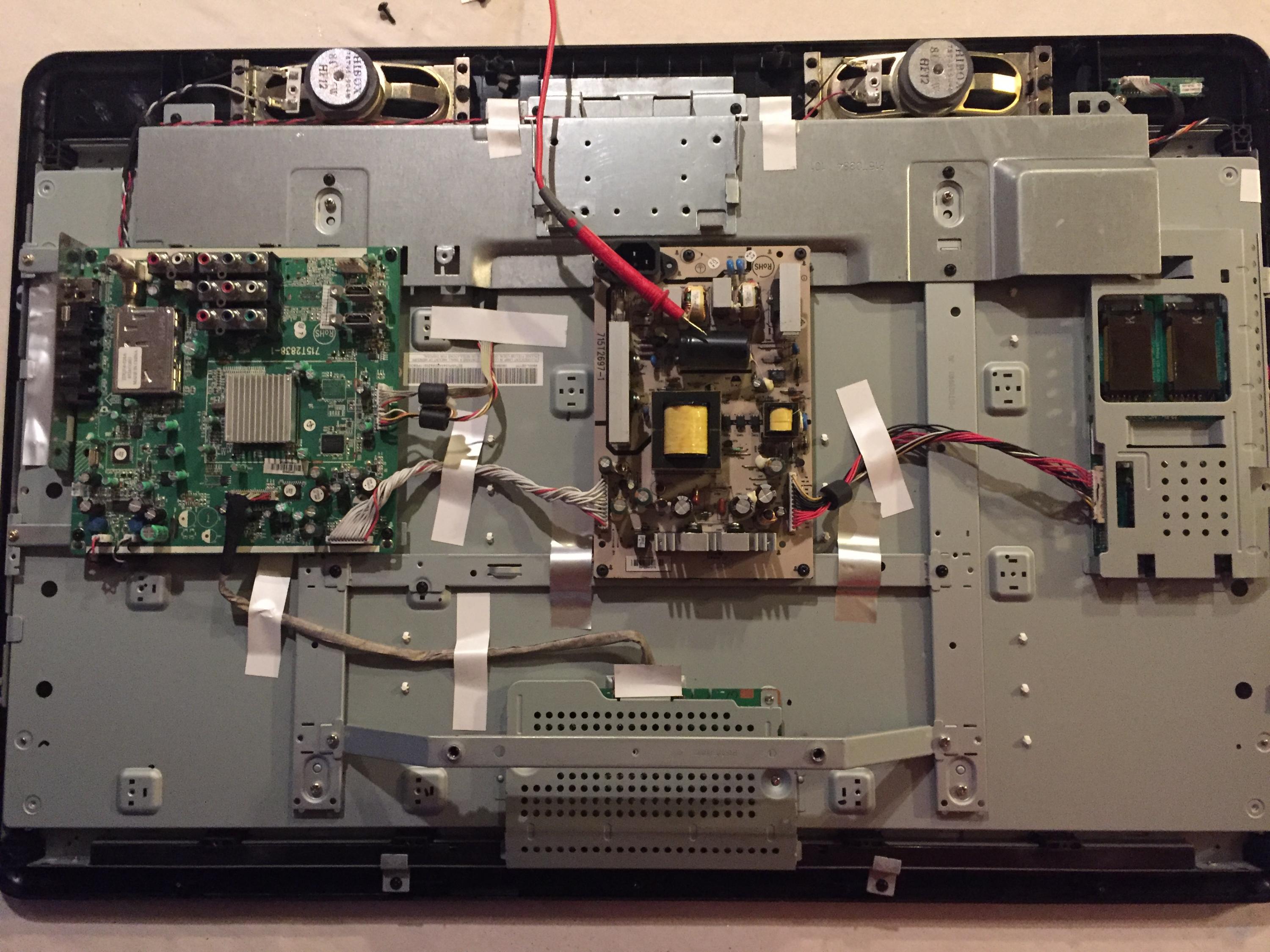

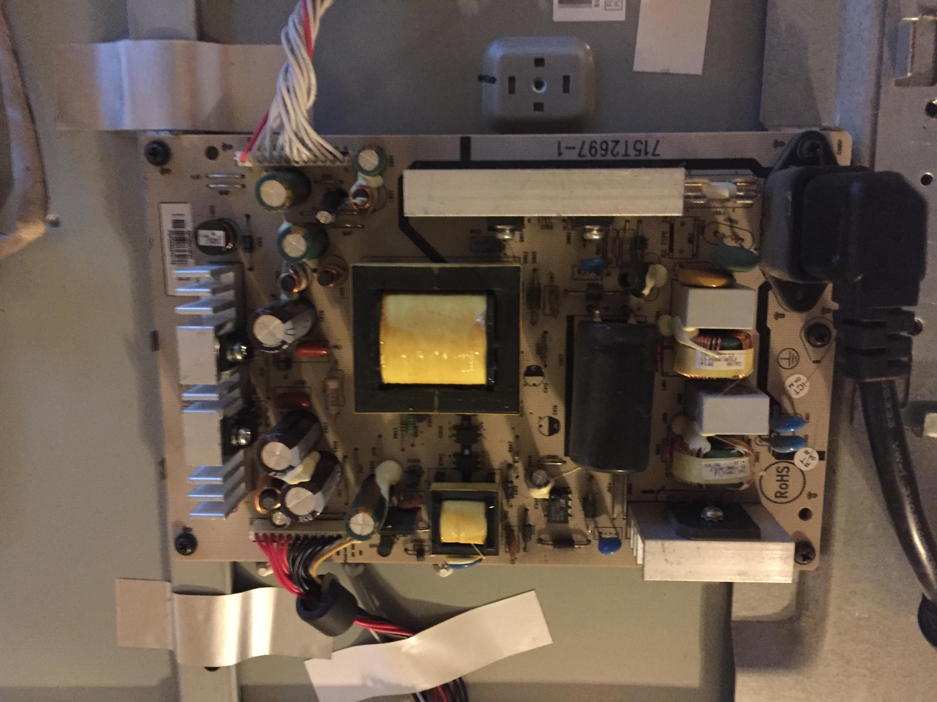

    First, we need good clear pictures of the whole back side of the TV showing all the board and then the pictures of the power supply board.
    We need to find out if you have dcv from STANdBY power supply or not.
    Do you know if you have about 165~170Vdc between the two legs of the large main filter cap in the primary side?

      Here are some pics. If you are talking about the big black "filter that my red probe point is on: it has 0 voltage either. Thanks for the help!

          Will need good picture of back of your power board. With no voltage on your filter cap you will need to check components from bridge rectifier BD901 back to your ac input. Double check your fuse in diode check mode with no power connected. I think your fuse is open.

                    I think this could be the schematic? When checking voltages on the HOT side (primary) use the negative side of C907 for the black lead of your meter. When checking voltages in the secondary, you can use the chassis metal for ground. Note the different ground symbols

                      The fuse tests good. Should BD901 be ac or D.C. Voltage? At what point does it become D.C.?

                        Usually inner two are ac outer two are dc

                          I'm not sure how you're supposed to test it. But, black probe to ground screw and red to each leg they all test about 120v ac. I get nothing when I test with black probe to one leg and red to others in ac...
                          D.C. Shows 3.4-3.5 when I put one probe on outside leg and other on outside
                          D.C. Shows 1.4 when I put one probe on outside leg and other on inside
                          D.C. Shows 0 when I put one probe on inside and other on inside.

                            Measure the DCV right between the two legs of that big cap.
                            You are working in the HOT side of the circuit so DO NOT TOUCH anything with your body or your hands!
                            BTW, fuse resistance is <1 Ohm, right?

                                Ok. I get 3.4-3.6 vdc at the big black capacitor that the red probe is on in picture.
                                With black probe on outside leg of rectifier in diode mode I get .4xx to other three legs. With black probe on inside leg I get .4xx to one outside leg and "1" to other two legs.
