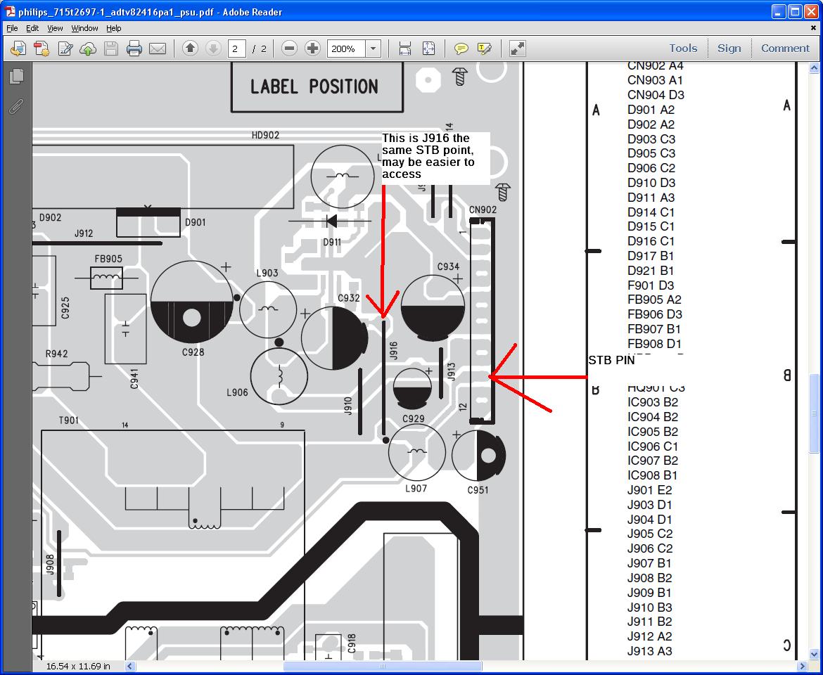

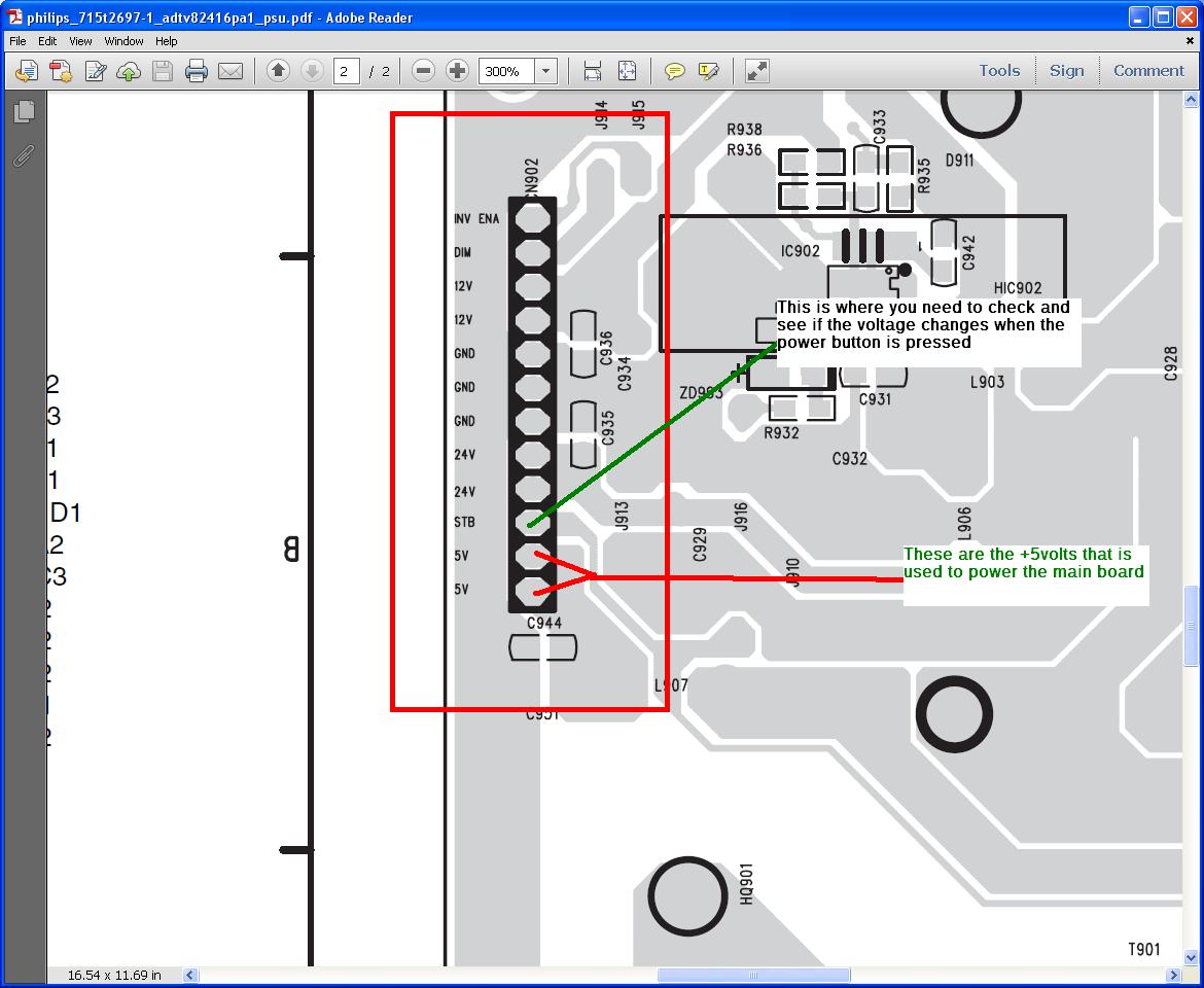

            lets try with pictures, The +5 volts is the stand by voltage. It is used to power the main board in a "standby" condition. This voltage is for the microprocessor which is waiting for an instruction from the "power button" When it receives the comand from said button the micro sends a signal (I believe 3-5 volts) to the STB pin (Standby_in) on the power supply. And that is what turns on the Full operation of the power supply giving +12 and +24 to operate the tv.
            So with black probe on ground and red probe on the STB pin on cn902 you should read 0 volts. When the POWER BUTTON is pushed, that pin should go to three to five volts.

                #67
                Re: Philips 32pfl3403d/27 no power
                Ok this is what I'm getting and nothing changes when I press the power button while holding the probes in place on any pin:
