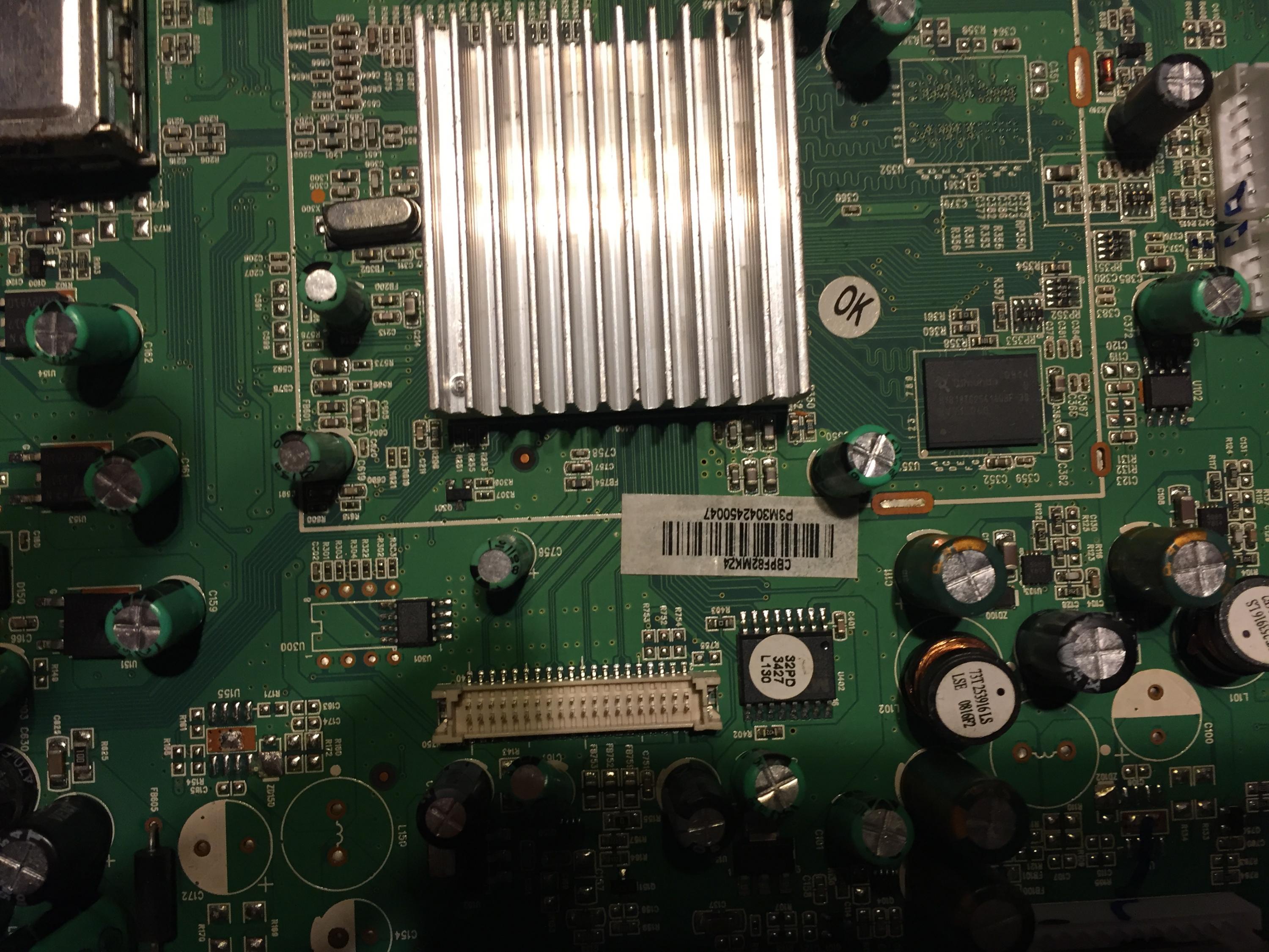

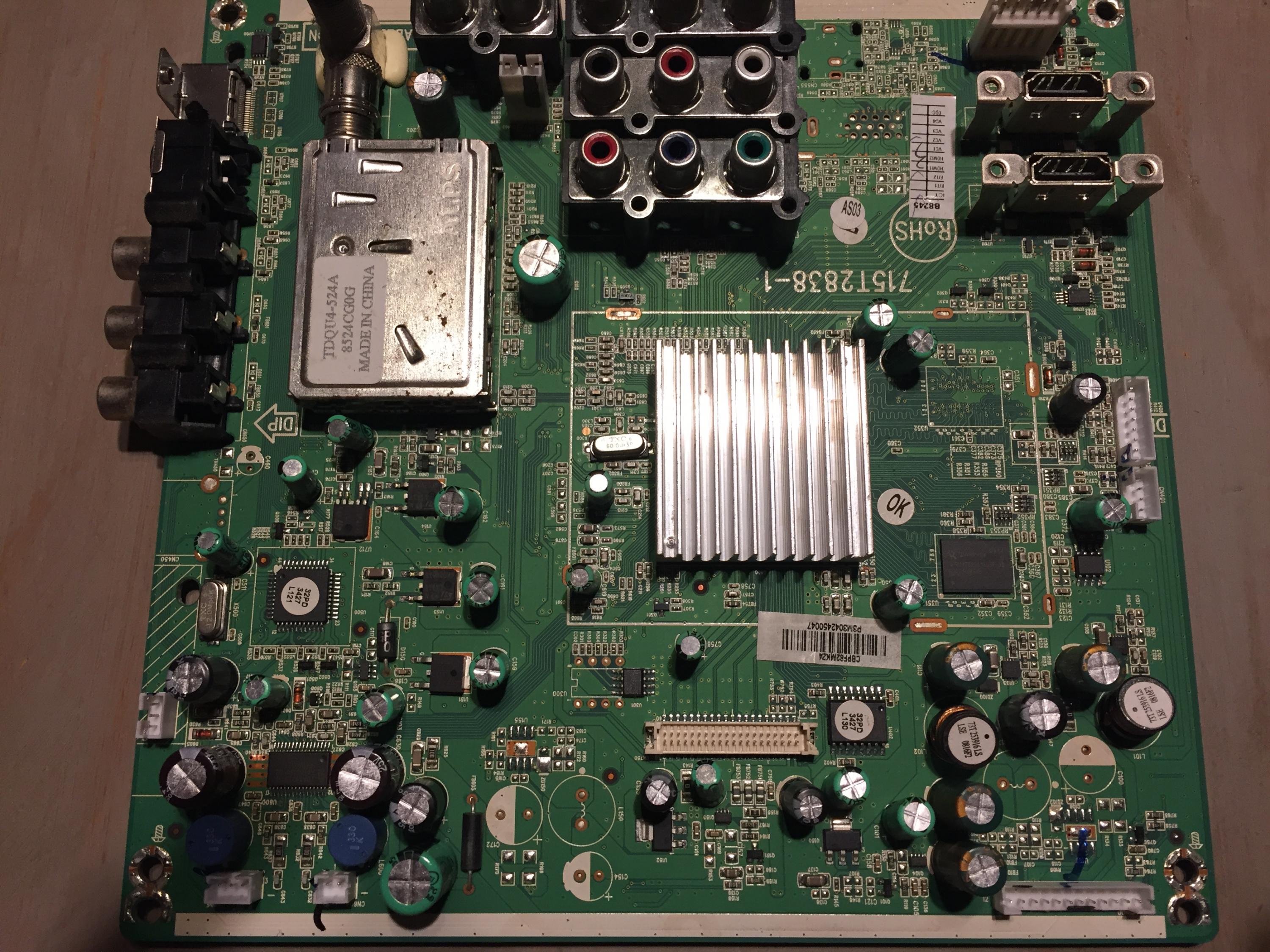

        Have you got a picture of both of the mainboards did you check when you brought your mainboard theat it matched with your lcd panel sticker too.
          #84
          Re: Philips 32pfl3403d/27 no power

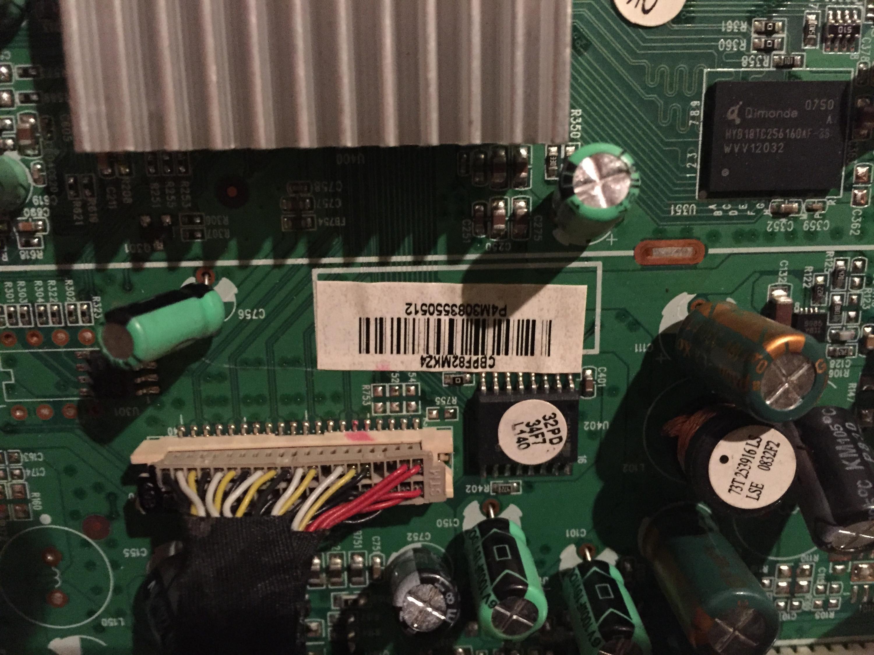

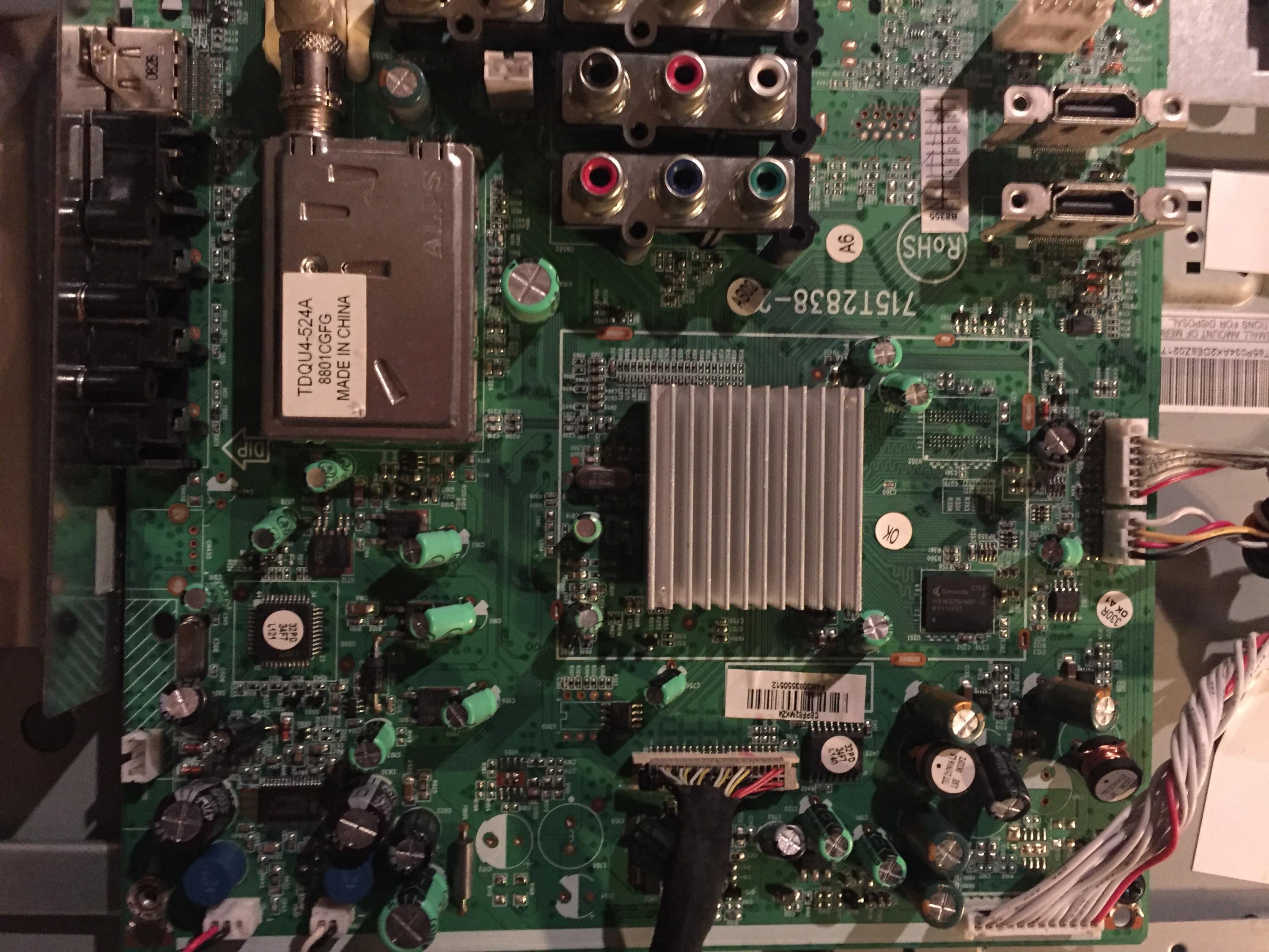

          I'm not sure where to check the number on the LCD panel. I will post pictures of both main boards. Thanks for any and all help!
          The two pictures with the connections plugged in is the new replacement board. The two pictures without connections plugged in are the original main board in the tv.
            #85
            the lcd panel sticker is usually white and stuck too the metal tv chassis.
            my guess its the wrong mainboard so maybe diffrent firmware etc.

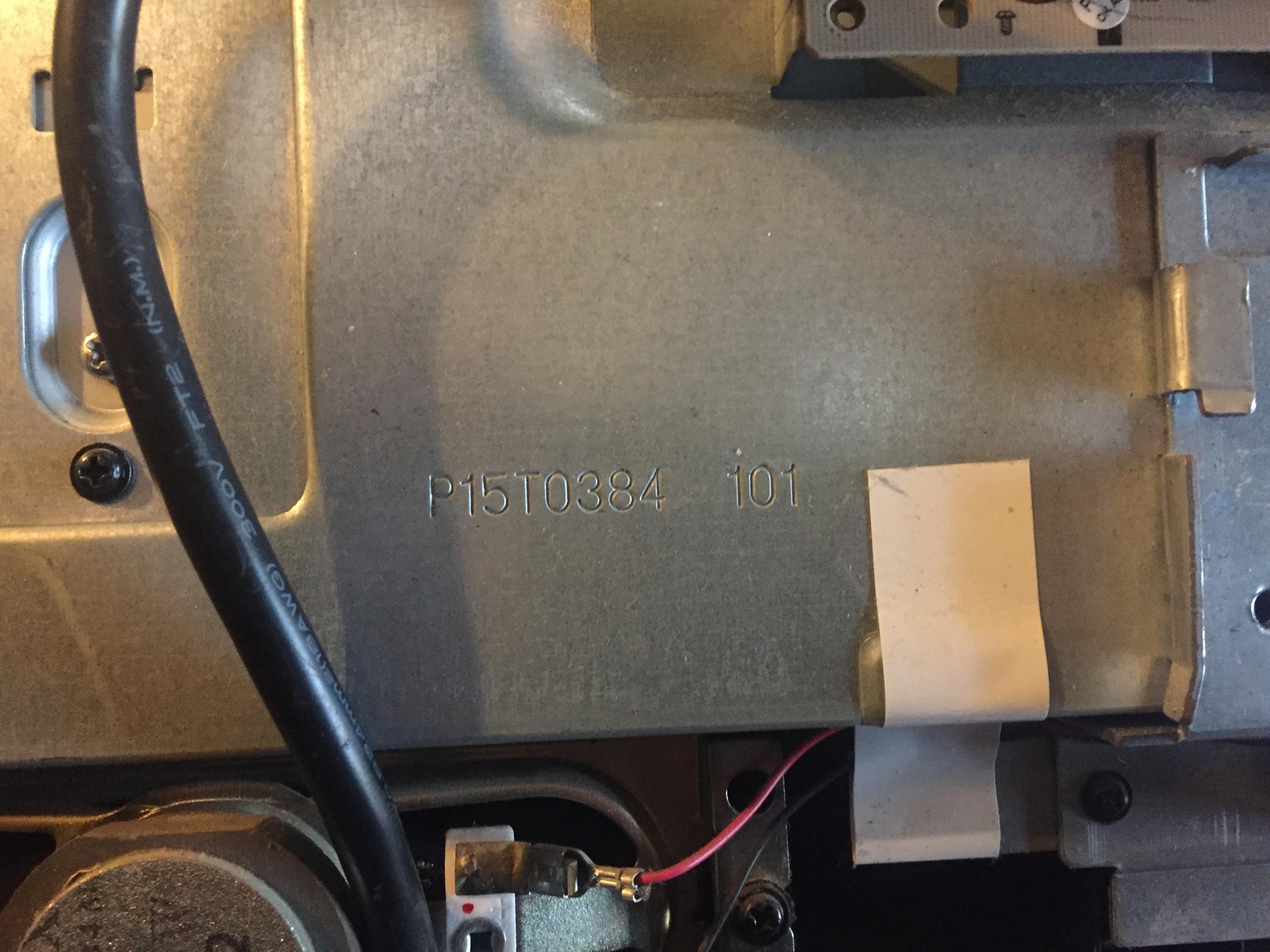

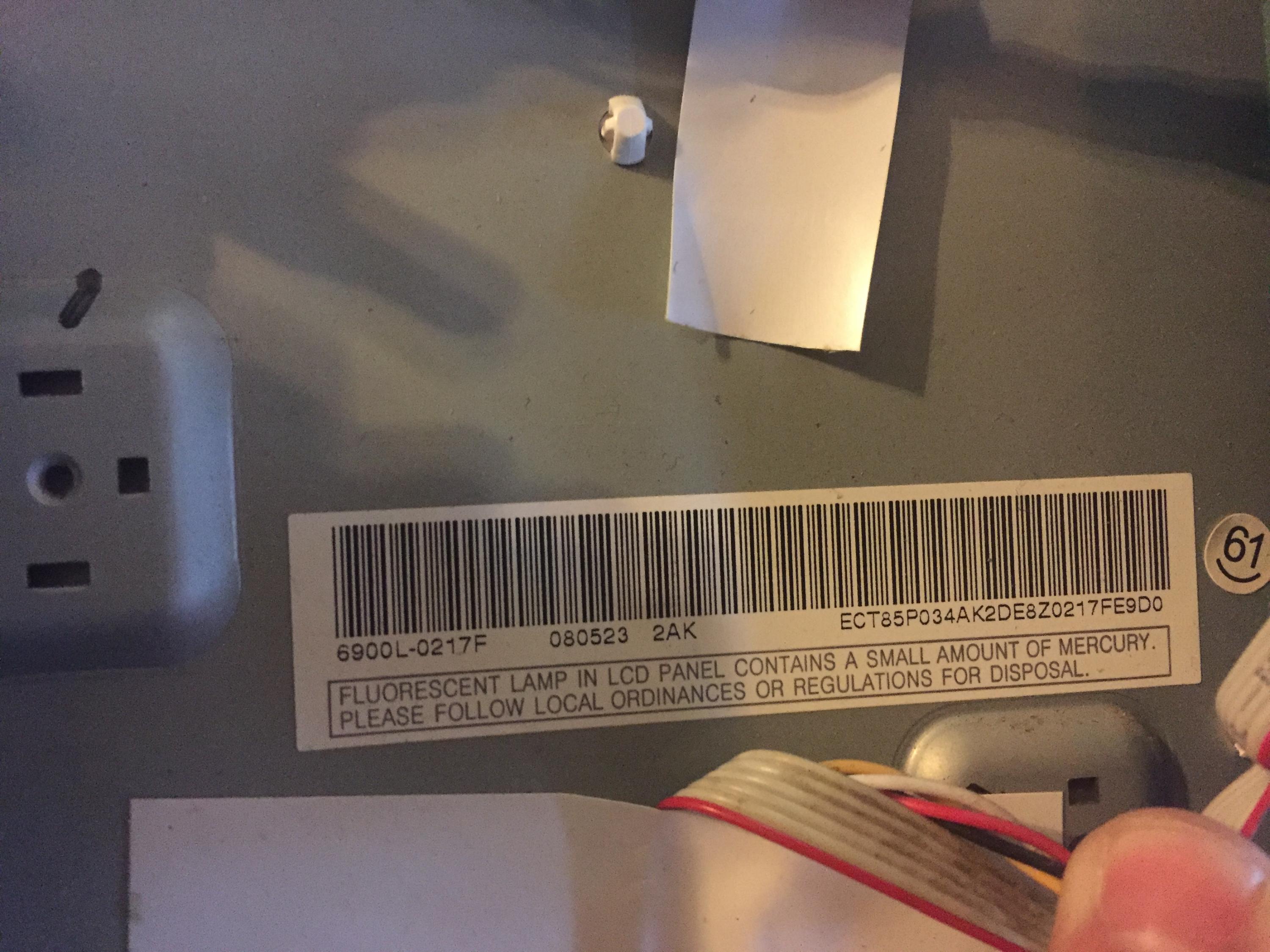

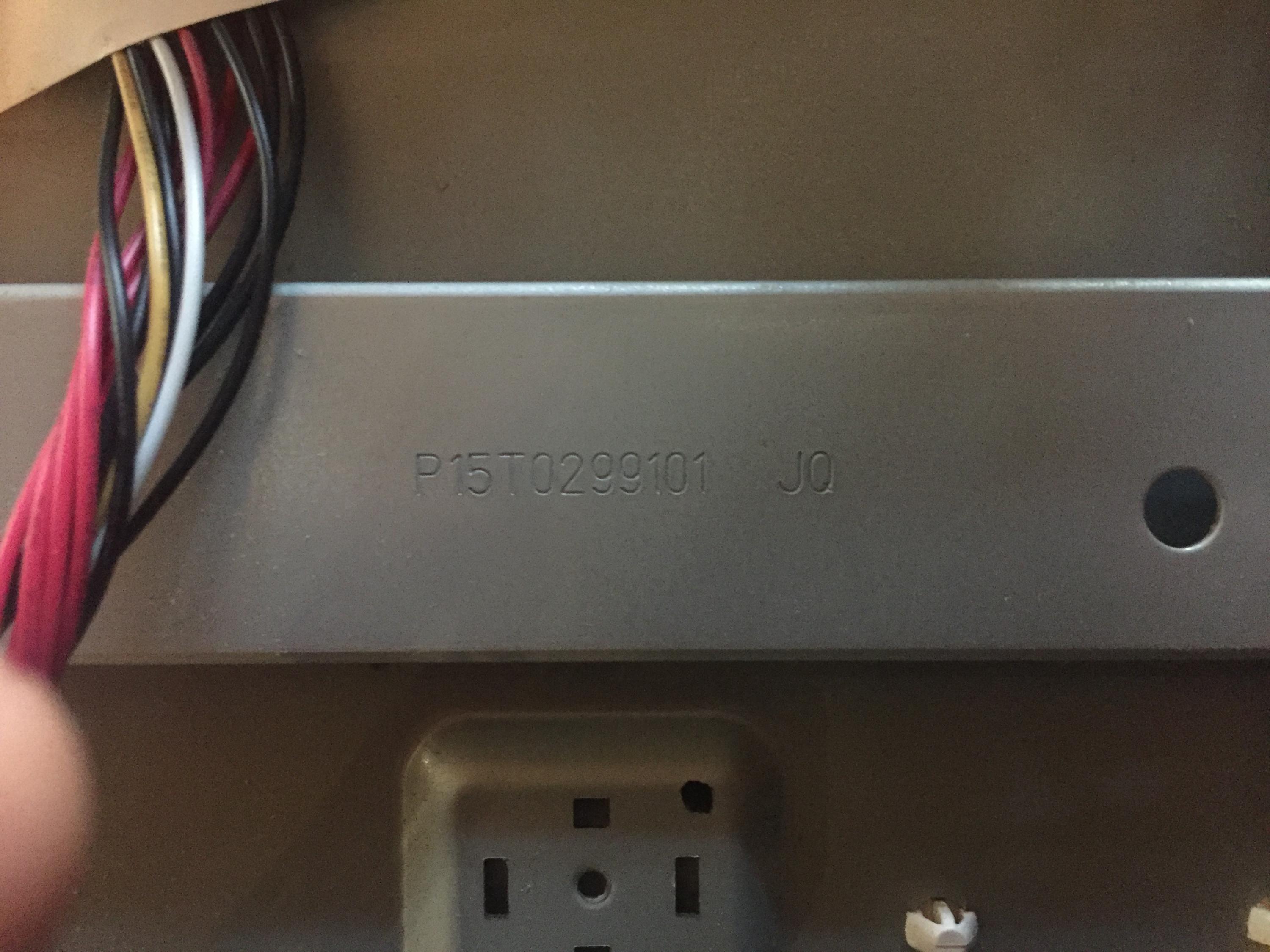

              These are the only identification numbers that I can find on the chasis. Are any of these correct?
                #87
                yes pic 2 is the lcd panel thats used usually when i buy a mainboard i look and see if it came out of a tv that matches my lcd panel etc
                maybe best to wait and see if other more experienced members agree this is probably the wrong mainboard for this lcd panel will the seller let you return it if it is.
                        Noticed there was a -1 on one and a dash -2 on other. Don't know if that makes a difference
                          #92
                          revision numbers i guess have changed even the white stickers on old and new mainboards dont match also the stickers on the ic just under the stickers dont match
                            #93
                            so do you think it is the wrong main board or do you think it could be another board that is bad?
                            according to shopjimmy all cbpf82mkz4 are the same. Also, according to the listing I purchased from it has both -1 -2 and -3 listed as compatible.
                              #94
                              is cbpf82mkz4 the blank pcb number befor all parts are fiited too it? thats why all cbpf82mkz4 are the same in that respect? hard too say im still learning myself but i always look for mainboards with all numbers matching the old board if possible.

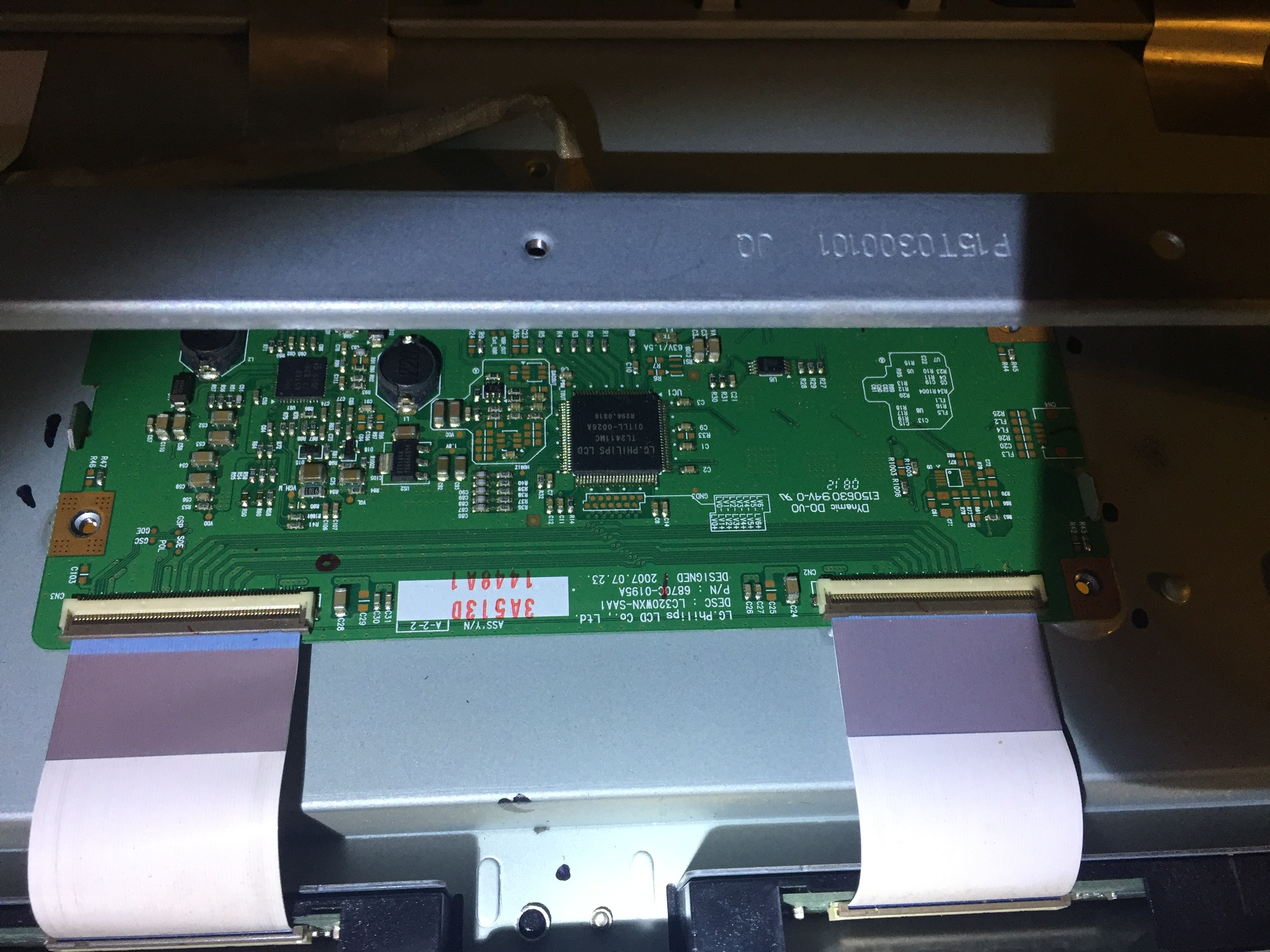

                                I have been doing a little research. Could it be the inverter board that is bad since I do get what I would call back light but no image? Is there a way to test the inverter board? Thanks.
                                  #96
                                  The inverter board is what supplies the voltage to the backlights so that seems to be working no image can be caused by the t con board have you got a image of it as theres a fuse on it that you can test voltage on it the t con board is under a metal cover top centre of tv
                                    #97

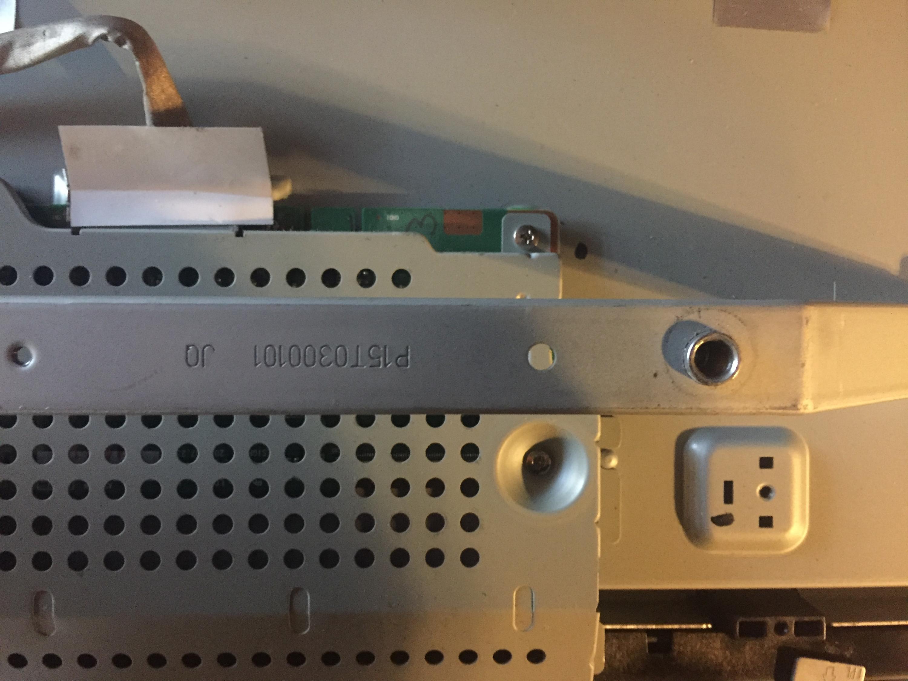

                                    Ok. I took the metal cover off and took a look at this board. I don't see a fuse. I tried checking the voltages acrosss the small copper points that are in the picture and got 0.8 v on all points with tv turned on and backlight on. I'm not sure what I should be getting. Any ideas? Thanks again!
                                      #98
                                      the fuse will probably be under the metal bar by where the lvds lead connects
                                        #99
                                        Fuse is above center connector on left side F1
