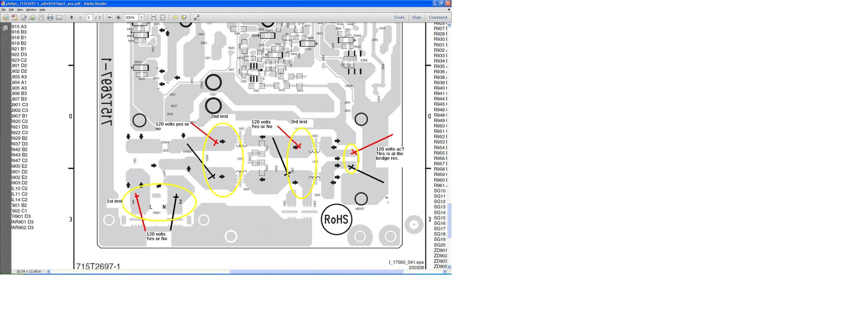

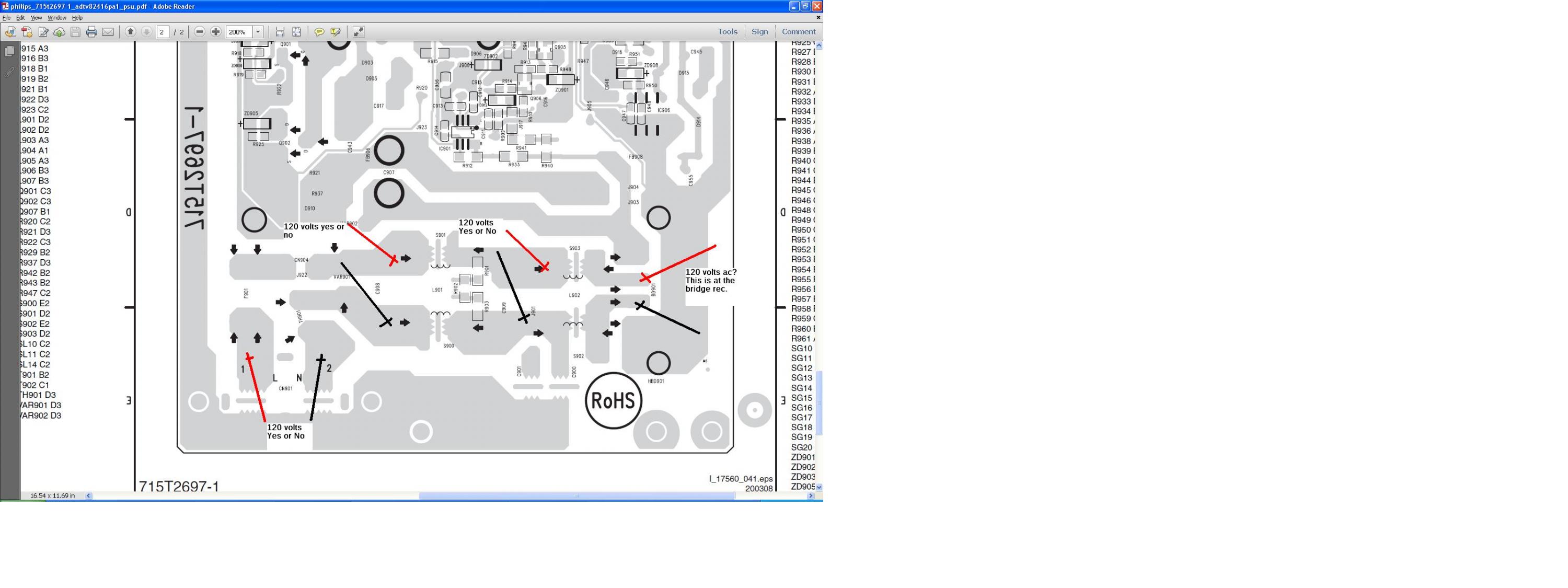

                    #49
                    Re: Philips 32pfl3403d/27 no power
                    If you remove the power supply from the tv and turn it over to expose the circuit traces. It should look like the picture
                    Place the board upside down on an insulated surface (use cardboard or a book)
                    Plug the power supply in and check for 120 volts at the ac inlet.
                    If you have 120 volts ac at the inlet then move your probes to the next spot where it says c908.
                    If you have 120 ac there, move your probes to where it says c909
                    If you have 120 volts ac there then check at the bridge
                    at any point you do not have 120 volts ac, your fault is between that point and the previous test point
                    Note: when you are checking be carefull and make sure the probes contact solder points and not the actual trace as the traces are usually covered with a green paint and you may not get a proper reading.

                      #50
                      So when testing for 120v at each point, should I place one probe on one pin and one probe on other pin of each individual component? Or, should I place black probe on a known ground and check each pin with red probe to see if it has 120v?
                      • R_J
                        • Jun 2012
                        • 9588
                        #51
                        Put the probes like I marked them on the picture, (see the RED and BLACK looking probes It does'nt matter if the red and black are reversed, your measuring ac volts
