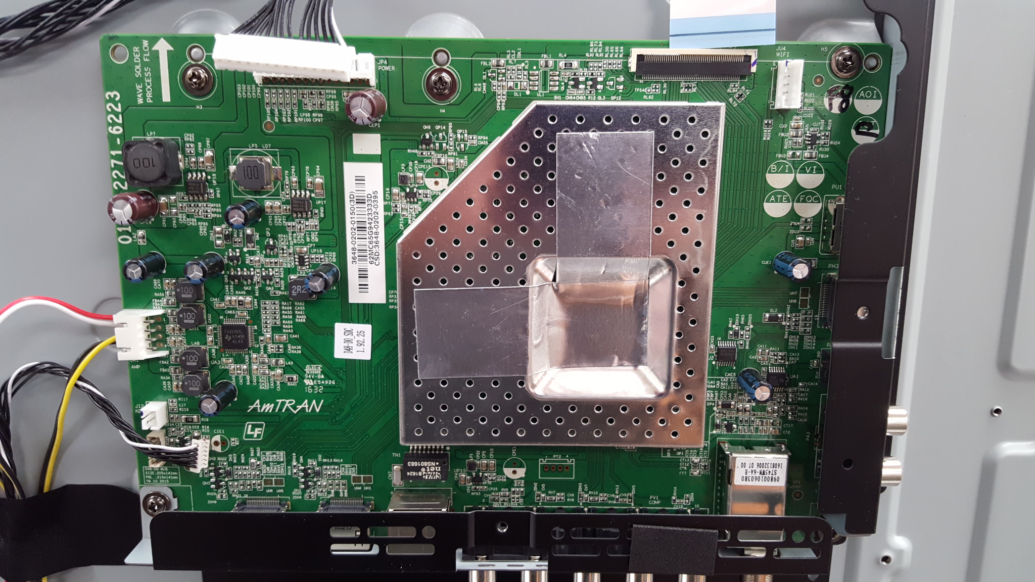

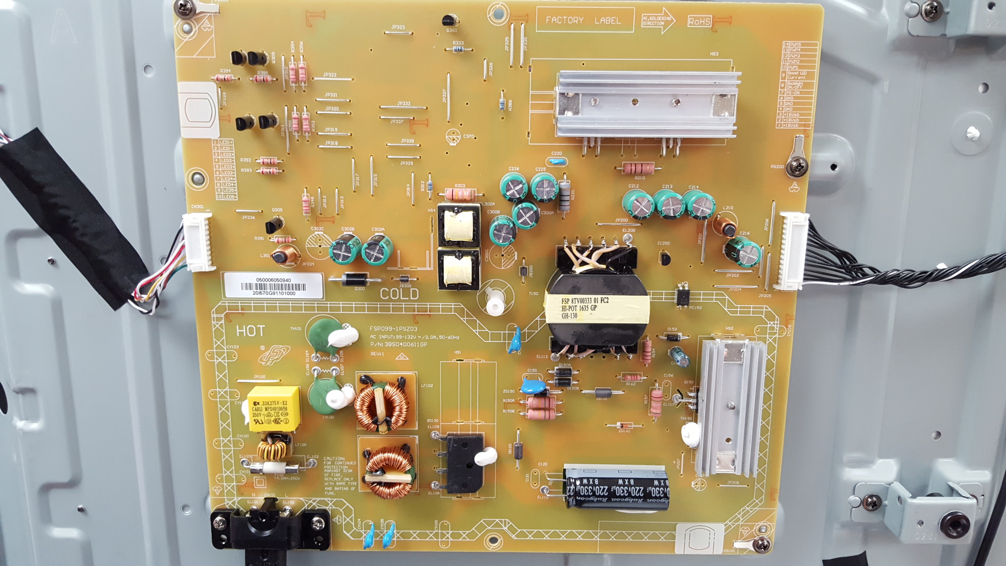

    Hello all,
    Have a Vizio D48-D0, 10241020222. S/N starts with LAUSTWBS.
    The TV powers on, backlights present, no picture (not sure if this TV makes a sound on power up, but no sound heard). No special blinking LED code on front panel. At power up, the backlights look bright, then for about a second, the backlights go out, then they come back on, but look a bit dimmer than they did at power up (no picture throughout that process).

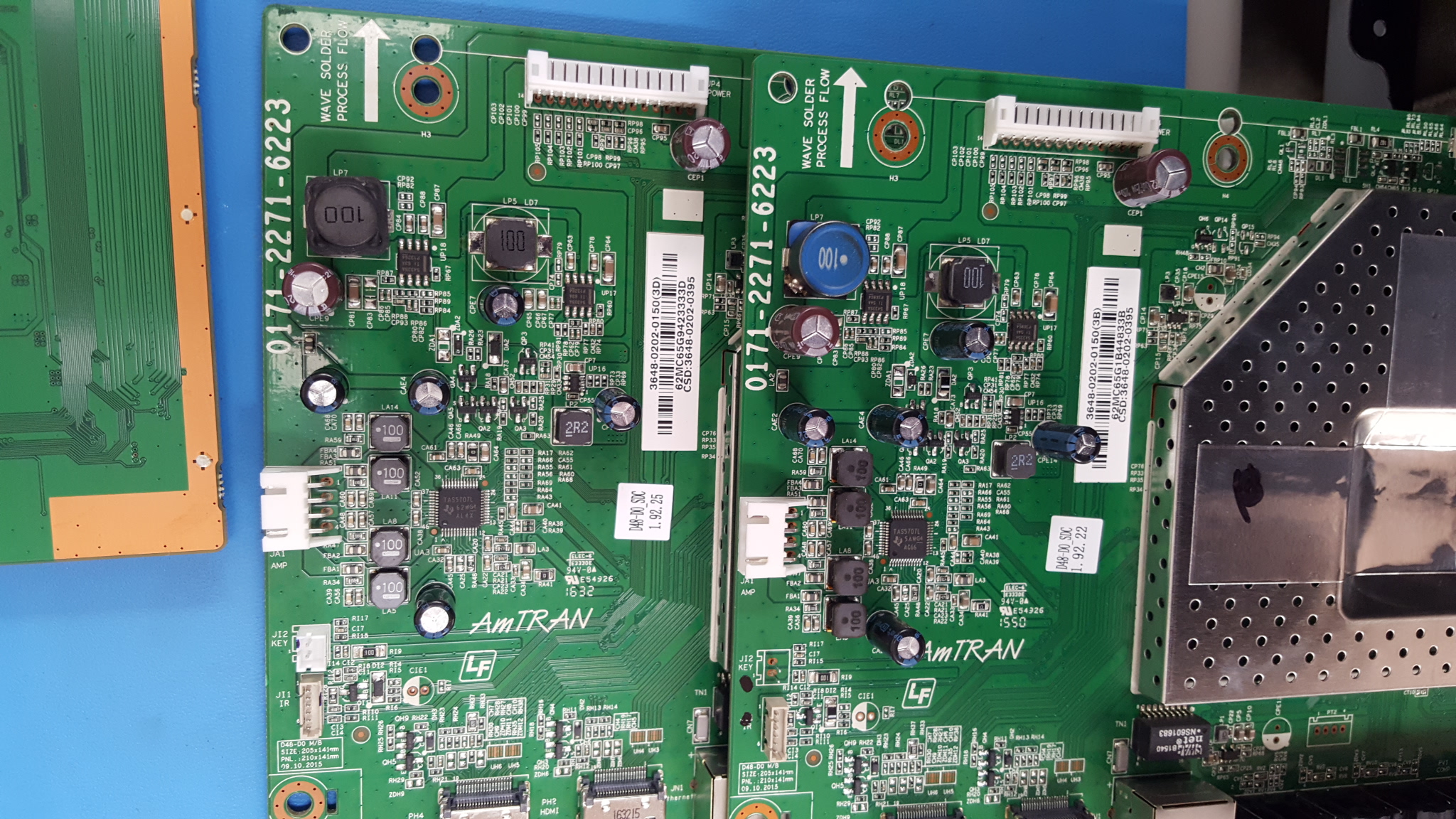

    The power board is a 0500-0605-0940. The main board is a 3648-0202-0395. ShopJimmy sold both boards for $50 total, so I ordered SJ-KIT-D48-D0-K1. Received the boards, listing said compatible with S/N LAUSTWBS, but the main board bar code had a slight difference. The original main board was 3648-0202-0150(3B), but the board from ShopJimmy is a 3648-0202-0150(3D). May that be the problem?
    I removed the old boards and put in the new kit from SJ. Here are the pin readings:
    NEW MAIN BOARD AND NEW POWER BOARD:
    CN301: LED1+: Pin 1: 63.7VDC
    CN301: LED1-: Pin 2: 1.8VDC
    CN301: LED2+: Pin 3: 63.7VDC
    CN301: LED2-: Pin 4: 1.8VDC
    CN301: LED3+: Pin 5: 63.7VDC
    CN301: LED3-: Pin 6: 1.8VDC
    CN301: LED4+: Pin 7: 63.7VDC
    CN301: LED4-: Pin 8: 1.8VDC
    CN301: LED5+: Pin 9: 63.7VDC
    CN301: LED5-: Pin 10: 1.8VDC
    CN201: PWM5: Pin 14: 3.3VDC
    CN201: PWM4: Pin 13: 3.3VDC
    CN201: PWM3: Pin 12: 3.3VDC
    CN201: PWM2: Pin 11: 3.3VDC
    CN201: PWM1: Pin 10: 3.3VDC
    CN201: Boost LED current: Pin 09: 0
    CN201: Backlight: Pin 08: 3.3VDC
    CN201: PS-ON: Pin 07: 3.3VDC
    CN201: GND: Pin 06: 0
    CN201: GND: Pin 05: 0
    CN201: GND: Pin 04: 0
    CN201: +18Vsb: Pin 03: 18VDC
    CN201: +18Vsb: Pin 02: 18VDC
    CN201: +18Vsb: Pin 01: 18VDC

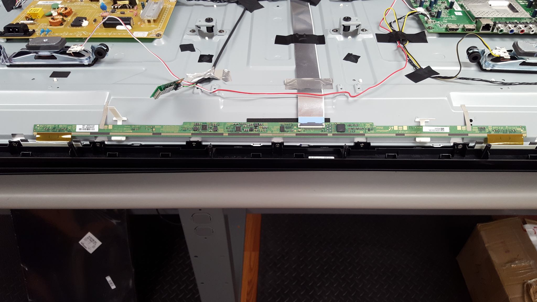

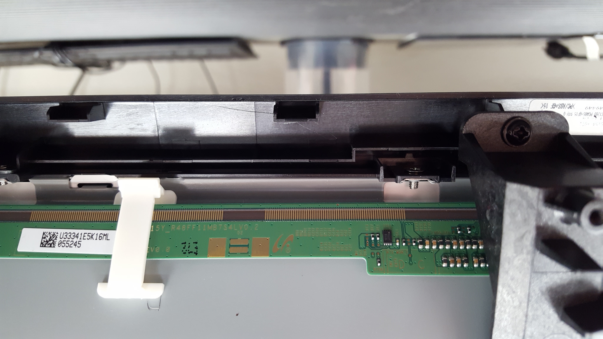

      I thought t-con too, however, there is no t-con (unless it's hidden really well). Original problem is same as current problem.
      • xeroextre
        • May 2013
        • 13
        Re: Vizio D48-D0 10241020222, backlight ON, no picture, new boards
        The part number stops before the parenthesis, anything after that is factory info and not relevant. The 12 digit part number (3648-0202-0150) is the same on both boards so it's the same part.
        So you have the same issue now as you did originally, no video WITH backlight on, it's highly likely that the display panel is bad since this model has no T-CON, and you've already swapped out the main board. The LED strips are working since they are on as you stated earlier. There's a small chance the main board we sent is defective, I'd say 10% or less.

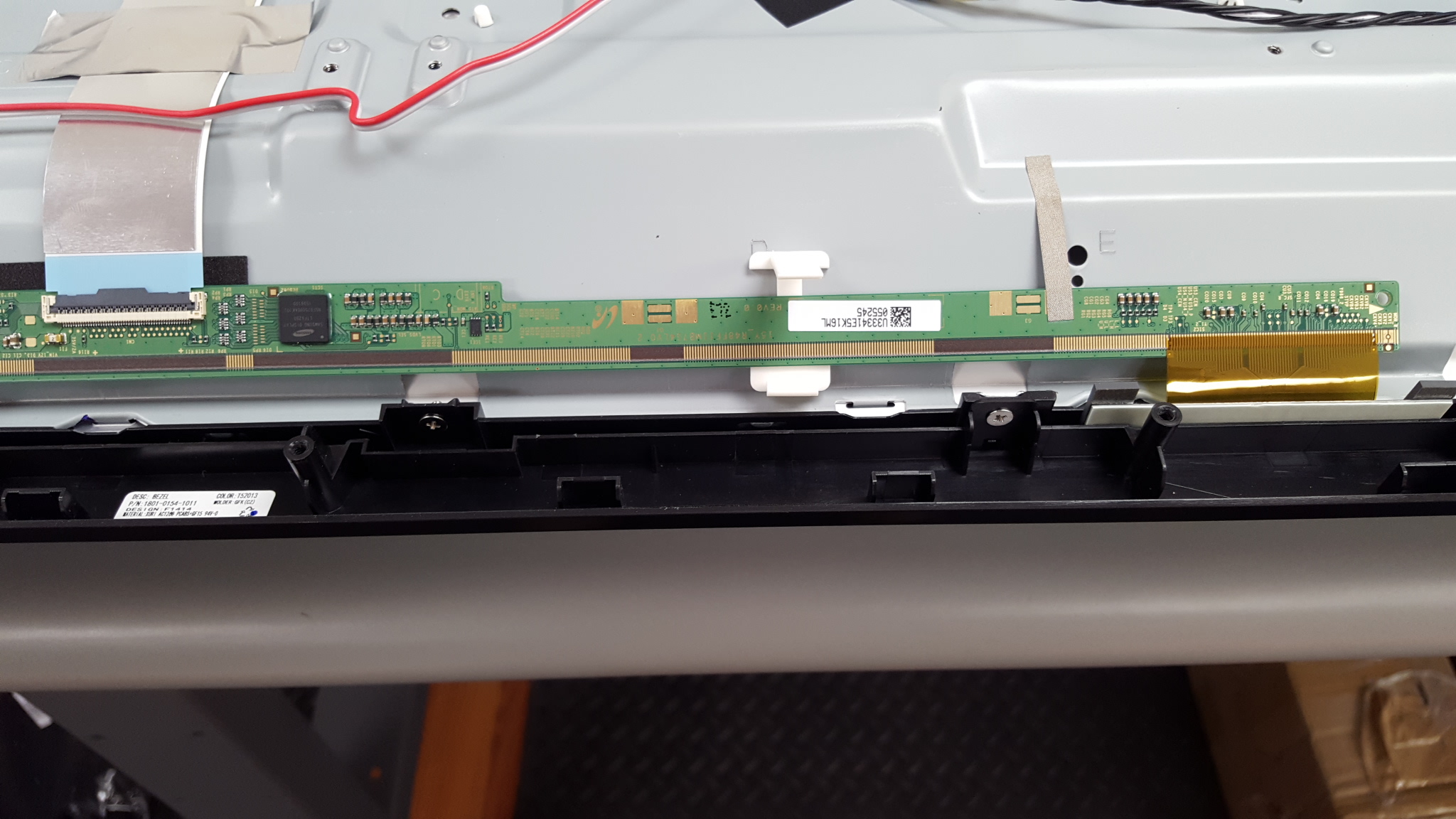

          The panel has integrated T-CON so there should be a SMD fuse the long board of the panel that you need to find out if it is getting the switched 12v to both ends of the fuse or not.
          BTW, what is the LCD panel model number?

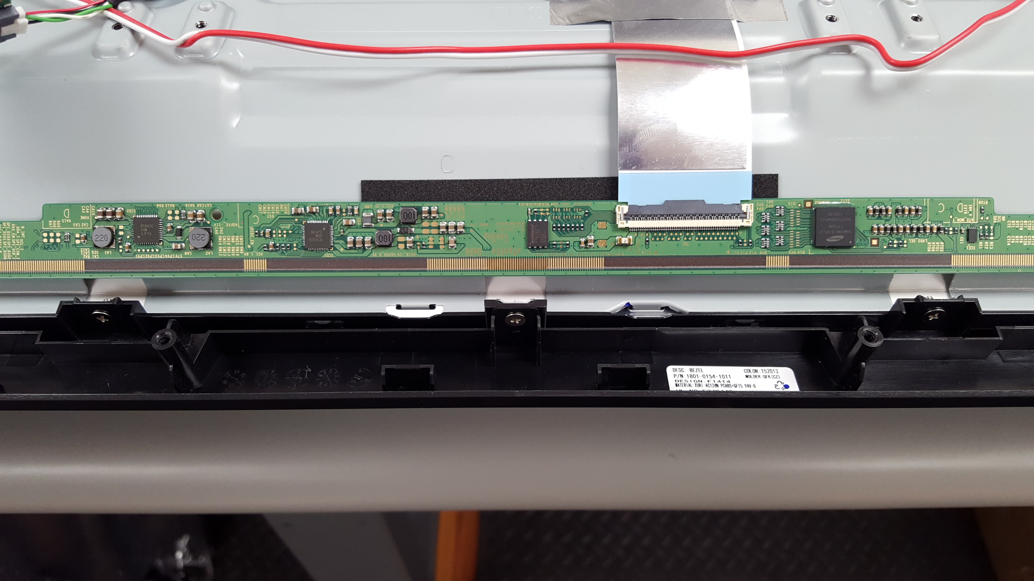

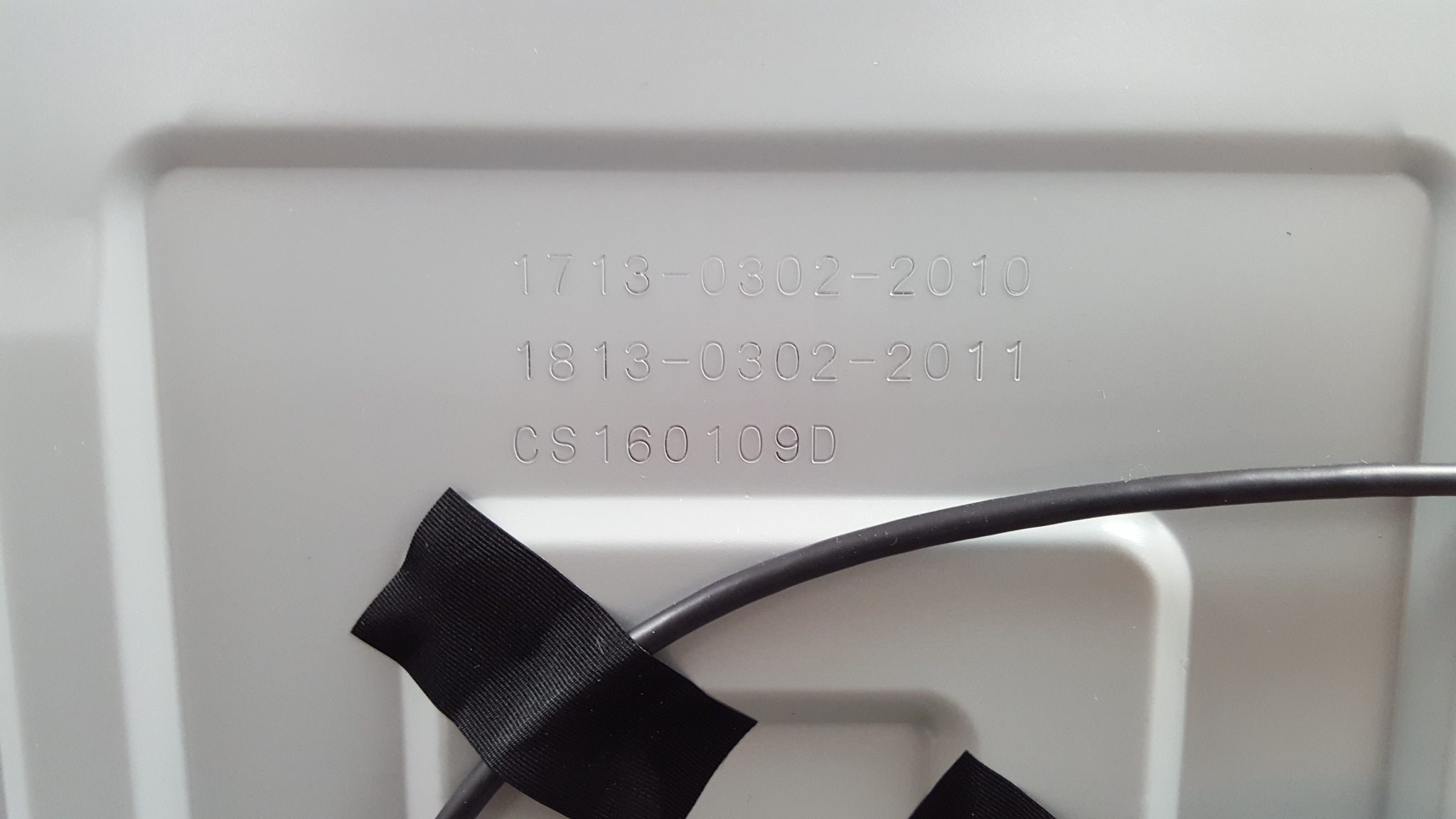

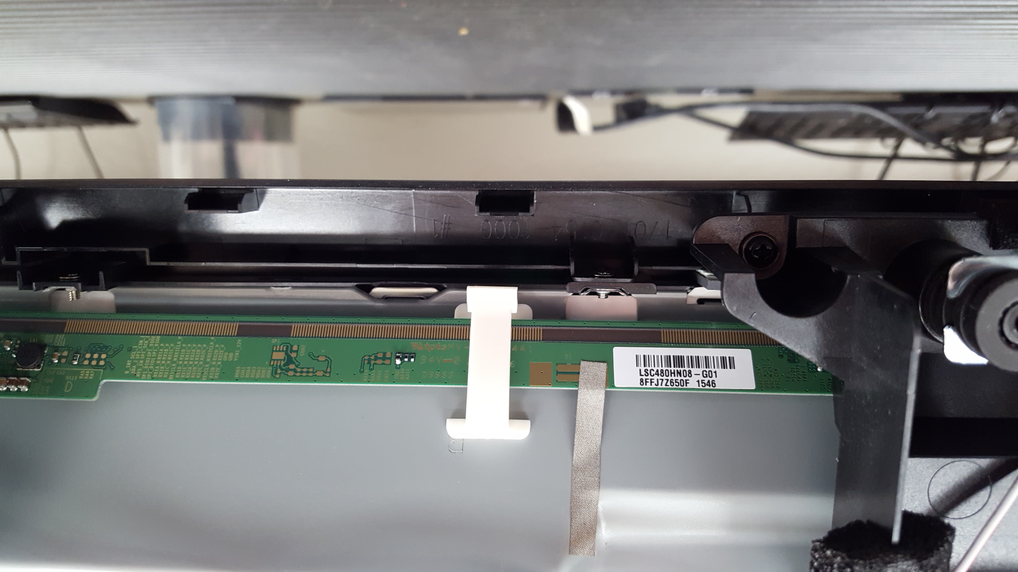

              Thanks, bud. I have 12.5VDC on both sides of the SMD fuse you mentioned. Not sure about the LCD panel number. Attached are some pictures, but I Google'd all the numbers and didn't find anything helpful.
              15Y_R48FF11MB7S4LV0.2
              U33341E5K16ML
              LSC480HN08
              CS160109D
              1813-0302-2011
              1713-0302-2010
              MV-0SE88441
              D99S3
              • Hamie
                • Apr 2014
                • 1383
                There are various test points on the board.
                Avdd_17v (obviously should be 17v)
                3.3v ( same as above.
                Then look for other points like sda, vgl, vone, voffe.
                post results of all the test points you can see.

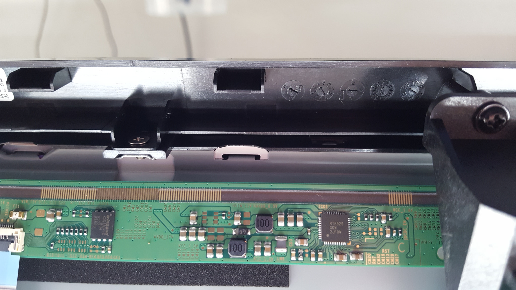

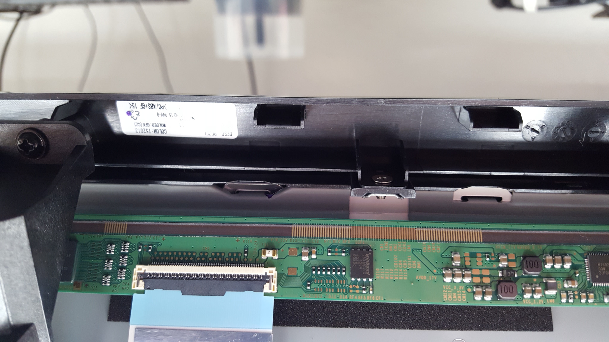

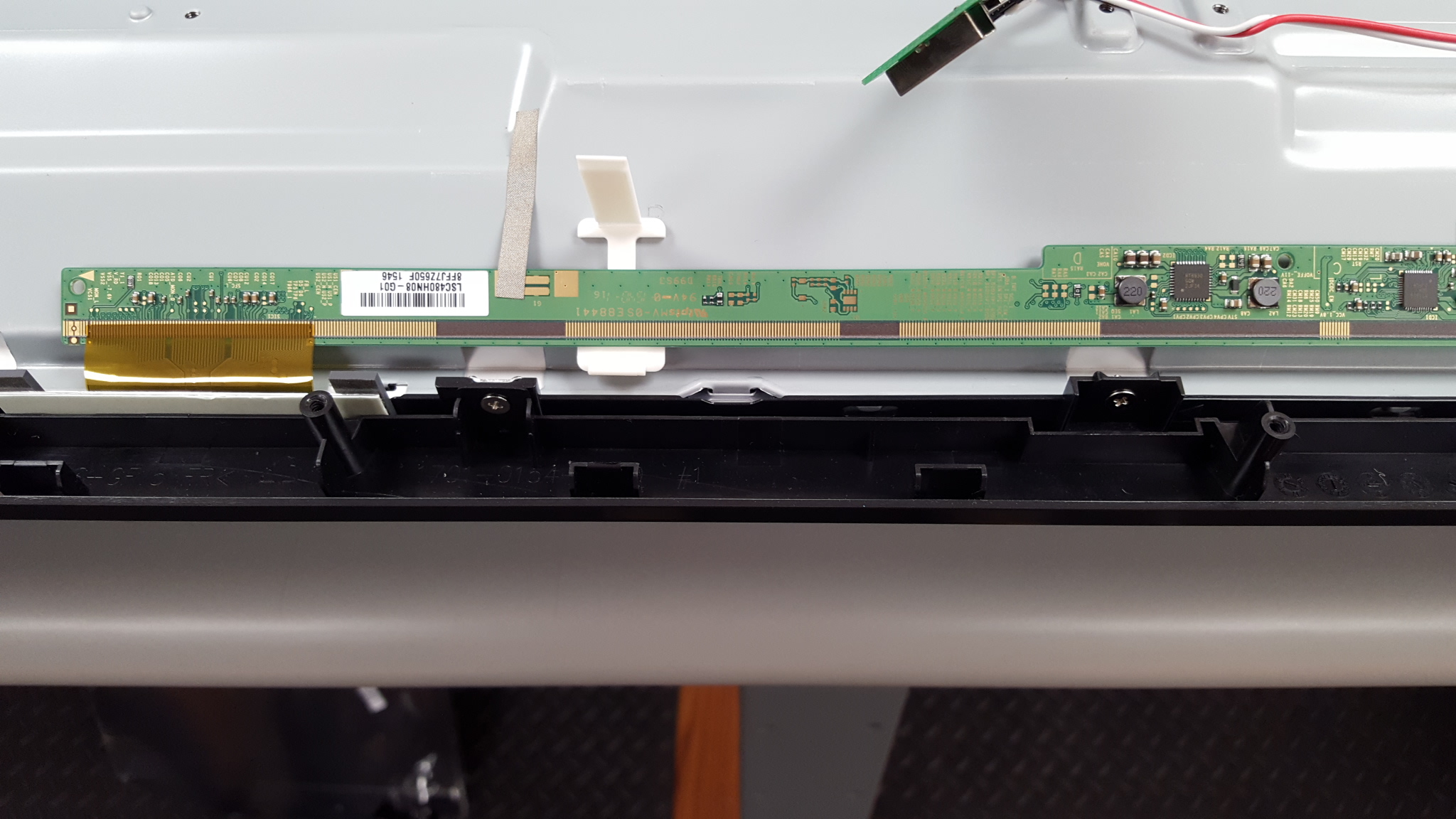

                    Hey Hamie, thanks for the info. Here are some better pictures and measurements:
                    AVDD_17V: 172mV
                    VCC: 3.3V
                    VOFF_-11V: 110mV
                    ATD_MON_T: 1.7V
                    ATD_MON_D: 13mV
                    VCC_1.8: 1.8V
                    WP: 3.3V
                    SCL: 3.3V
                    SDA: 3.3V
                    MON_L: 334mV
                    MON_R: 334mV
                    All of the other test points ranged from 10mV-340mV.
                    • Hamie
                      • Apr 2014
                      • 1383
                      OK so you have a problem somewhere.
                      I'd check all the smd caps and see if any are shorted.

                        Hamie, most of the SMD caps on that particular board are open, a few in close proximity to each other measure ~1kΩ. That was done in-circuit, though.
                          https://www.badcaps.net/forum/attach...9&d=1487372049
                          See those two ICs with two small inductors with '100', '220' on tops?
                          Those IC are part of switching power supplies that generate VGH, VGL, etc.
                          Get the P/N and look up the spec sheets so you can see if they are generating the Voltages or not.
                          Example:
                          http://tvrepairsolution.blogspot.com...lcd-panel.html
