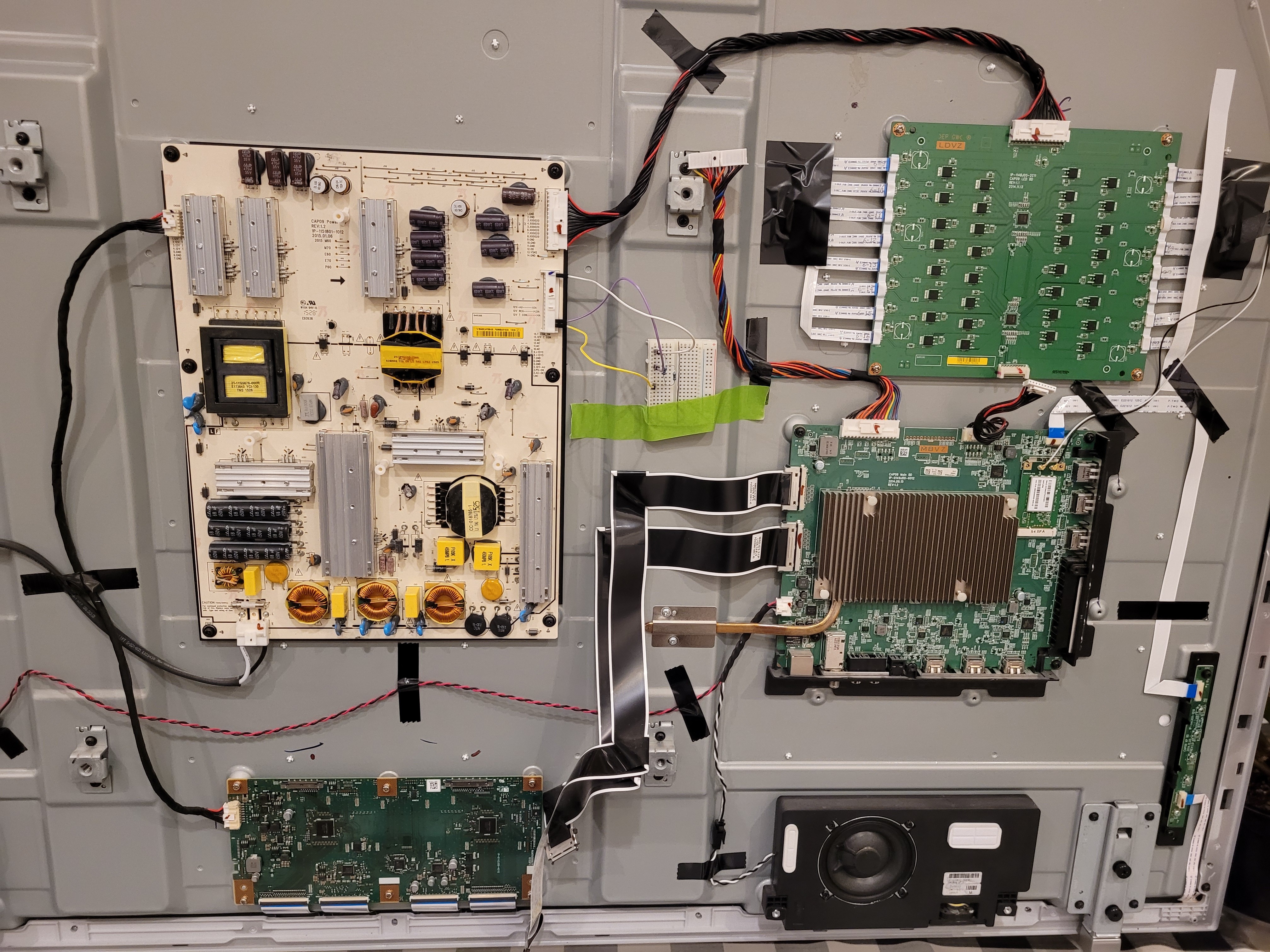

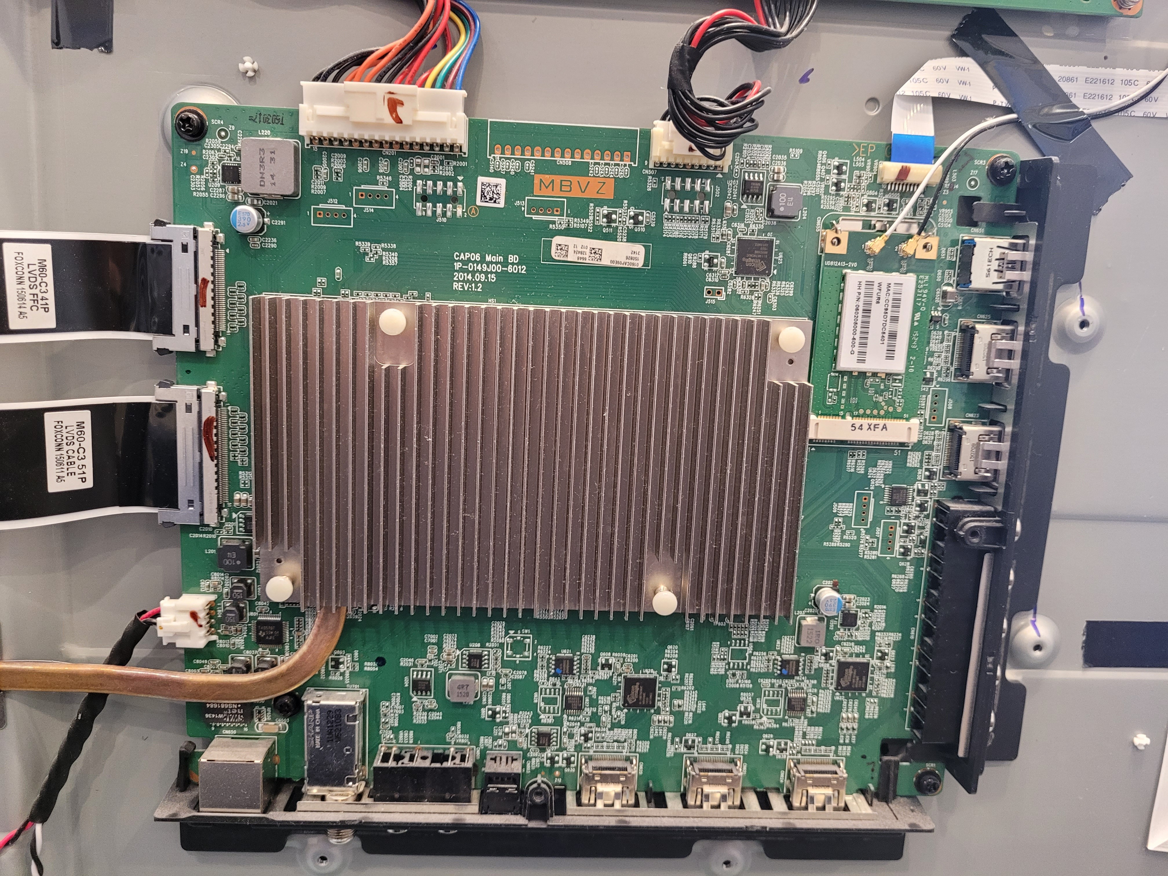

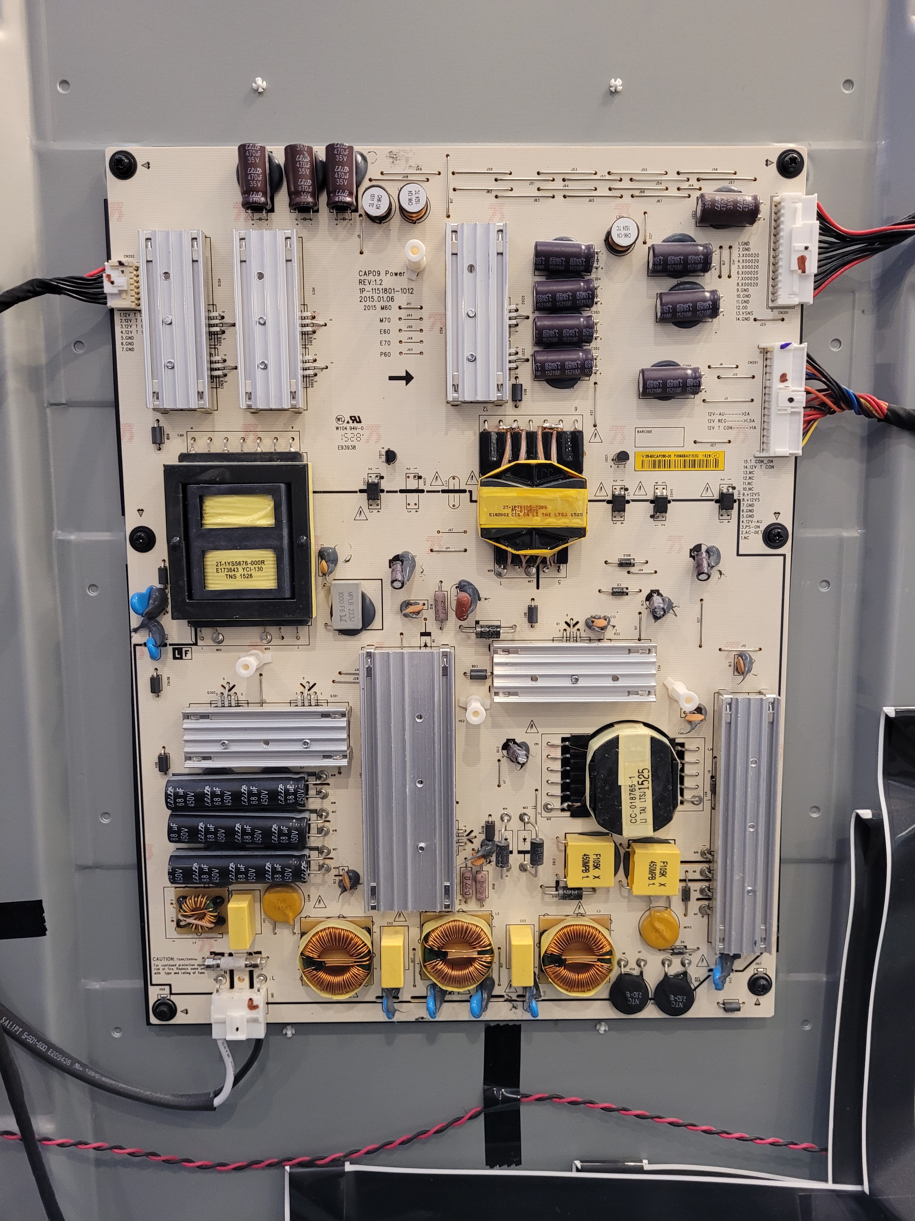

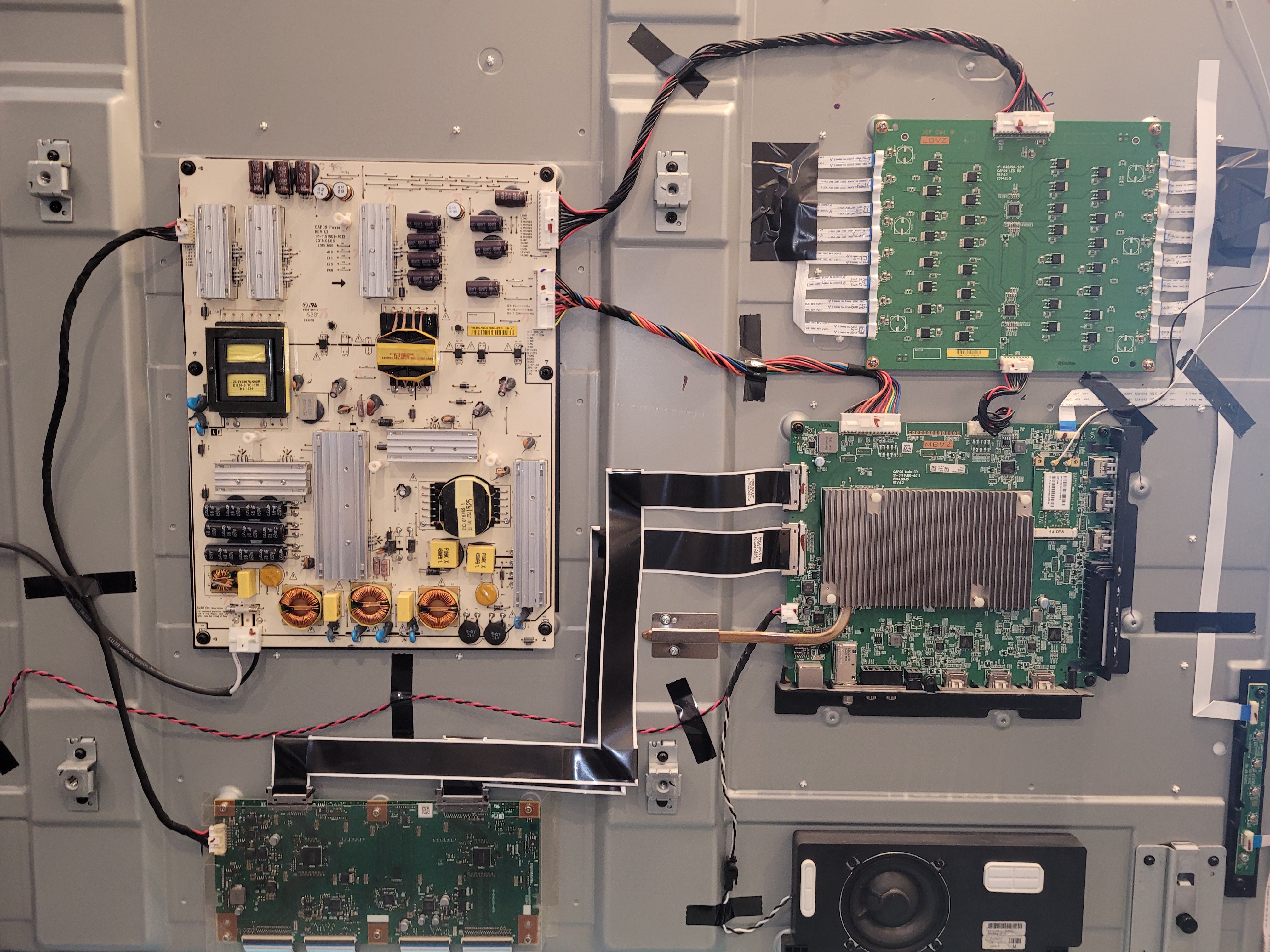

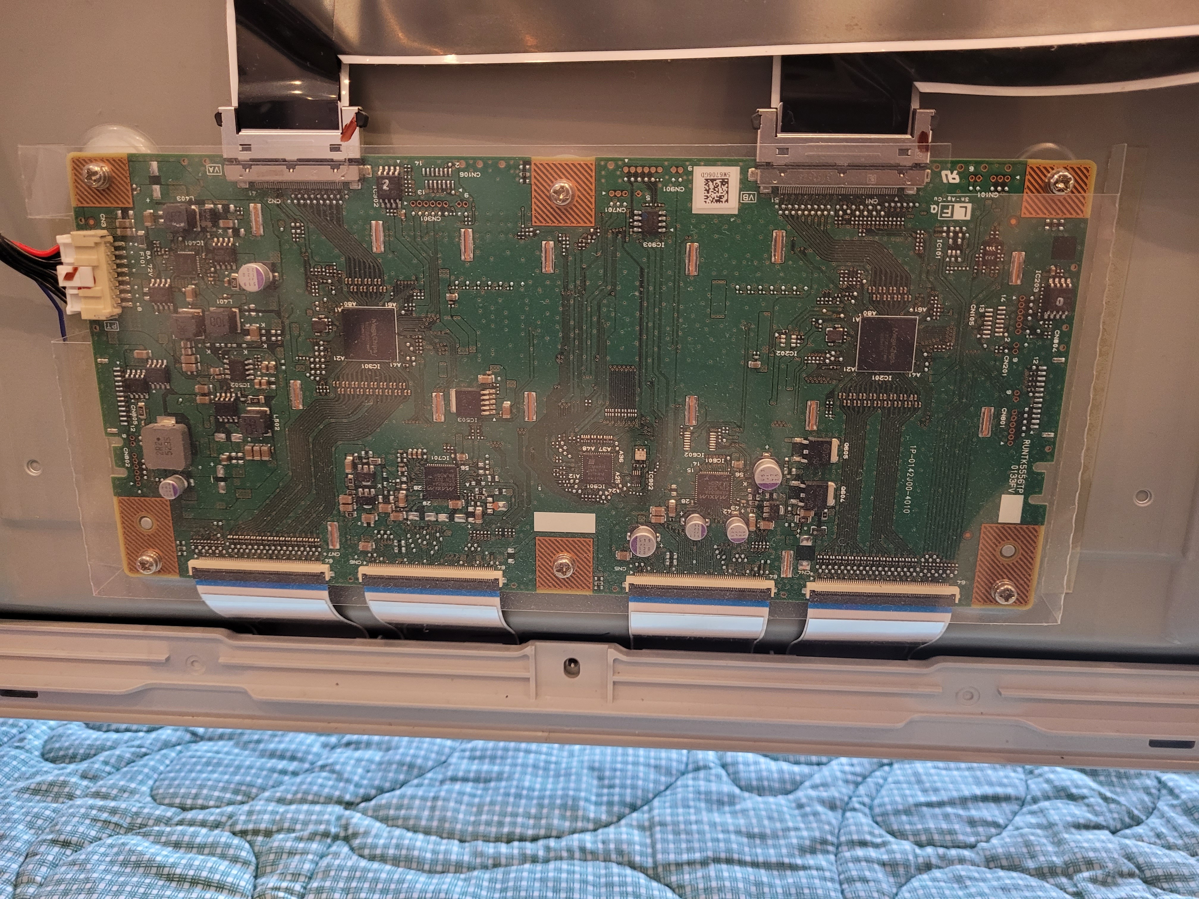

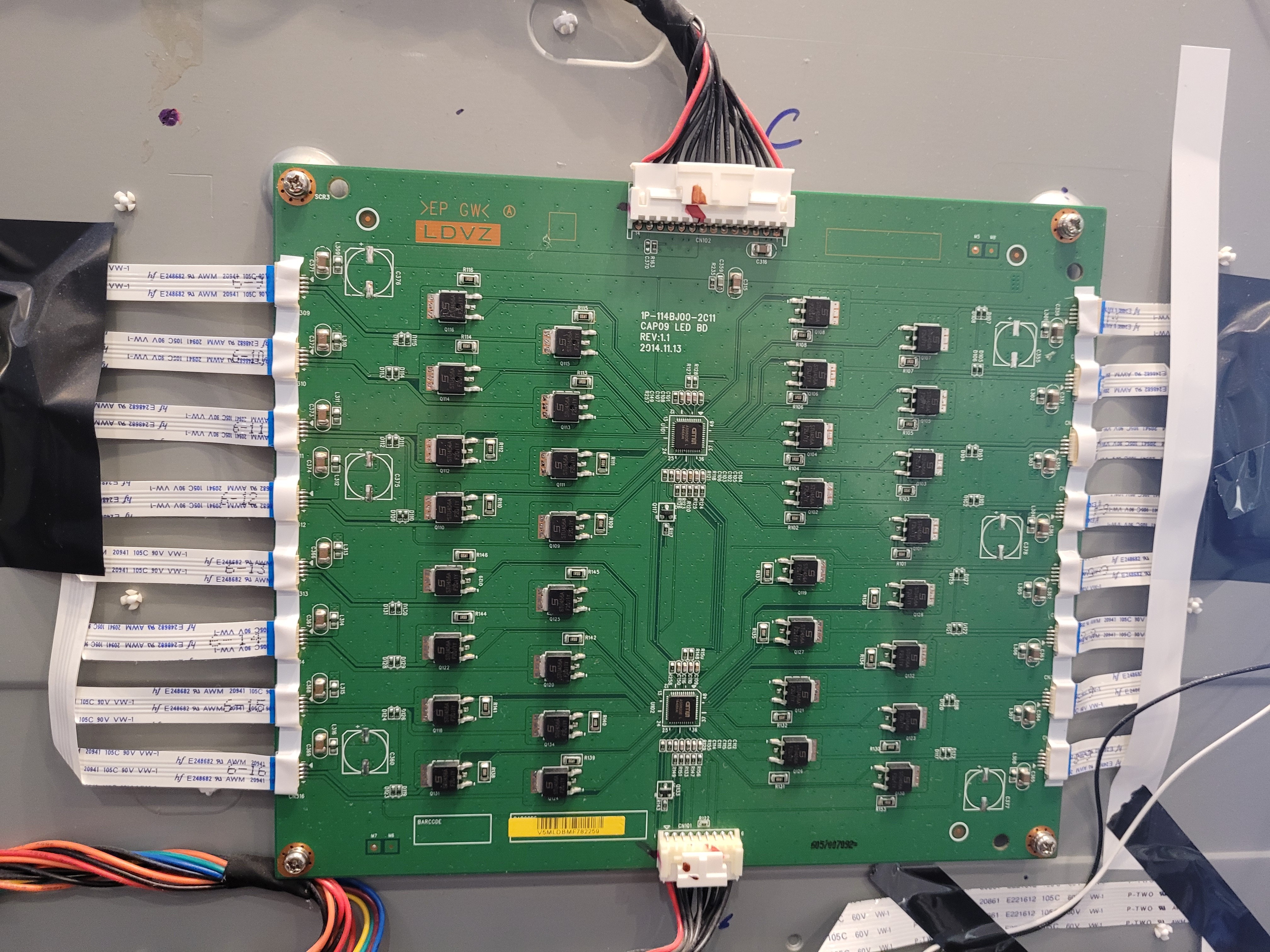

    So our beloved M60-C3 up and died the other day. I was not there, my wife mentioned that it came on, displayed the logo, then showed the right half of the screen white and fuzzy, with the left half of the screen ok. However when I got around to looking at it, the screen would not come on at all. The indicator LED will come on, then dim a bit. After a while, the LED might blink a bunch of times. I can't get it to be consistent to do that.
    So I've got the back off and am checking voltages. The capacitors on the power supply board visually check out. No bulges or anything. They all show 12v on the positive lead as well.
    On the power supply board, with the TV off, for the connector to the main board (CN201) everything is zero volts except for pins 8 and 9, showing 12v, and pin 2 (AC-DET) reads 3.9v. When powered on, pin 3 (PS-ON) gets 5v, and pin 4 (12V AU) gets 12v. Pins 8 and 9 remain at 12v. On the connector for the LDVZ board (CN301), pins 3 through 8 all ready 26v, and pin 13 (VSNS) reads 2.4v. The LED driver board itself, pins 3-8 are showing the 26v as well.
    The one thing that is strange to me is on the top left connector (CN202). Pins 1-4 (12V T CON) were always showing 0v, even when powered on. Even if I unplugged the cable from the power supply board. Except for one time. At one time during my testing, I could see that the screen had come on, displaying the half white fuzziness from before. During this time, I was reading 12vs on pins 1-4 on that CN202 connector. I can't tell if this means the TCON board is going bad, or if this is still a main board issue, which I was suspecting up until this point.
    Most of the symptoms that I could see seemed to point to a main board issue. But when I noticed that anomaly on the TCON connector, now I'm not so sure. Any ideas or other things I can check? I'm just going off a few threads here to see what others have tested, so I'm not sure if there's something else I can check.
    Thanks in advance!

    Clear focused pictures of each board and one of the whole back as to see how everything is connected.
    • paqman
      • Mar 2024
      • 20
      Sorry, my bad. I edited the original post and added some pics. Thanks!

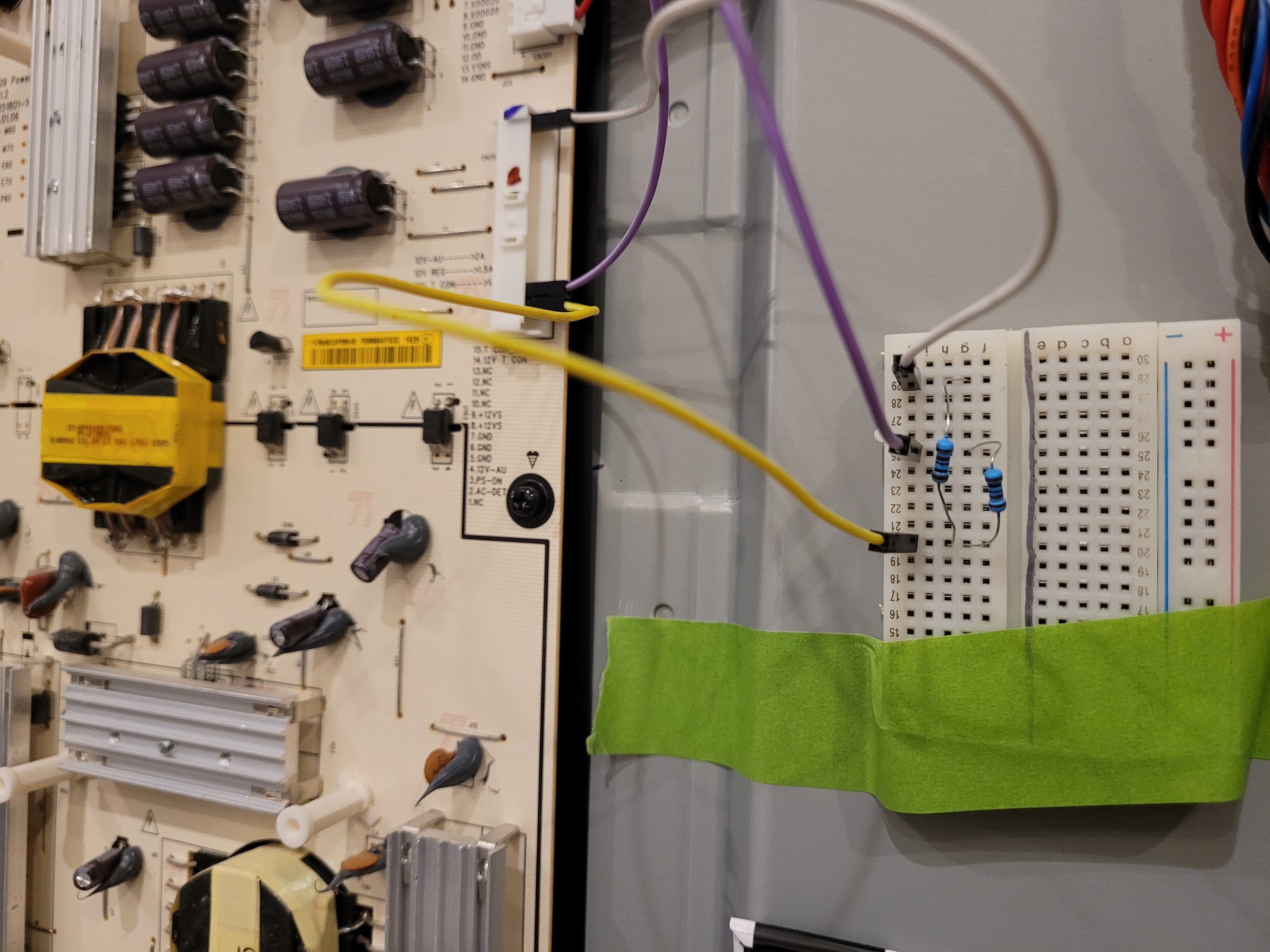

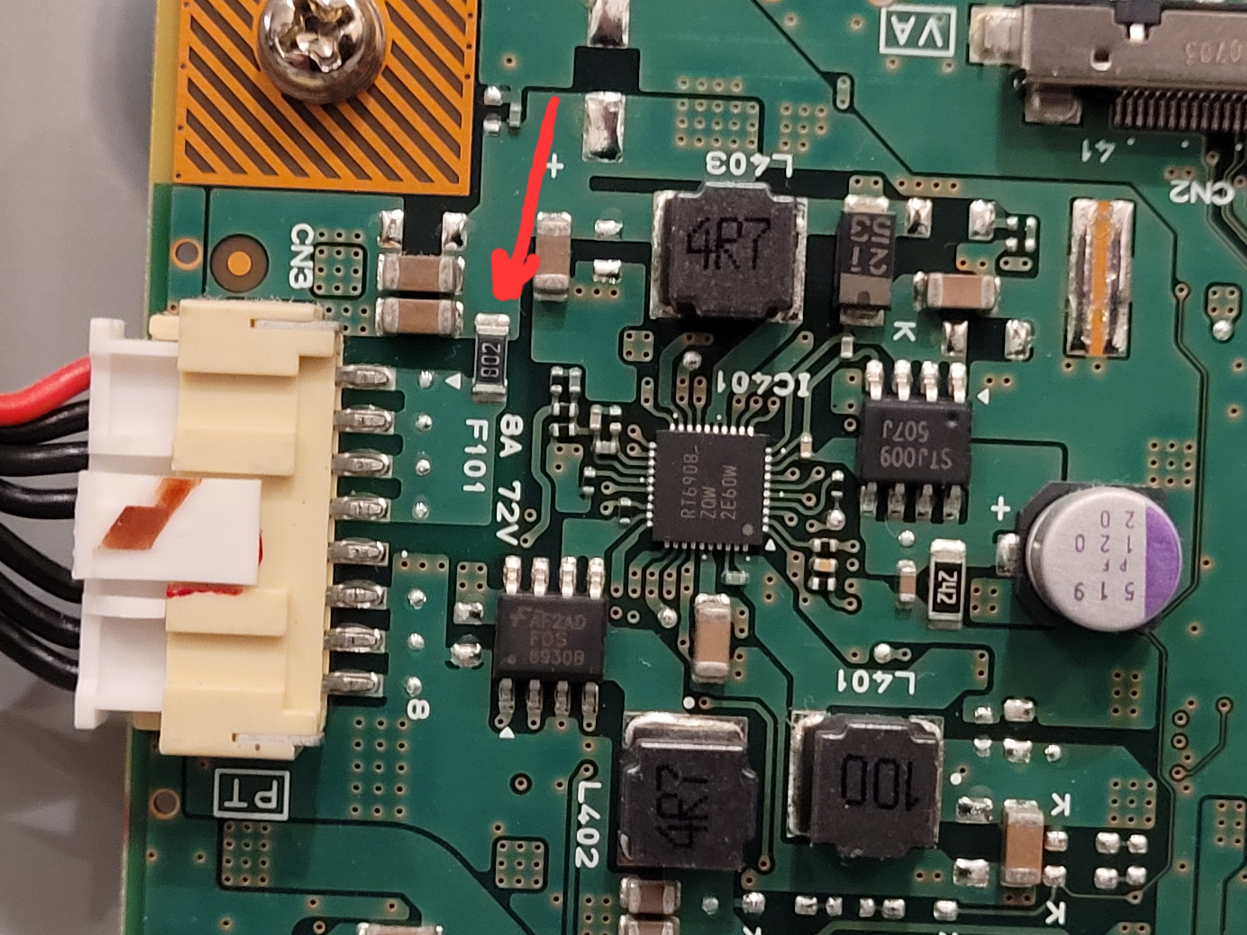

ID:	3228090 Click image for larger version
ID:	3228088 Click image for larger version
                            Sorry for the weird arrangement of pictures. (on mobile) In the one you can see how I connected the 1K resistors from pin 2 to 3, and from pin 2 to 15.
                            And then in the other image I pointed out the F101 fuse just to make sure I've got the right one. I plugged it in and I did indeed measure 12v at the F101 fuse.
                            The other pic shows all boards how they were connected during this test.

                            • Diah
                              • Feb 2013
                              • 6435
                              so the LED BL didnt come on at this test.. an no image at all on screen.... so we need now to configure the last test in other way..
                              all sockets / LVDS should back in place as original also the one which connect to mainboards.
                              we will slide out ( take it out from circuit ) the wire of pin 15 " TCON_ON) from the sockets isolate it so no short will be to chassis..
                              we connect pin 3 PS_ON via 1KR to pin 15 on boards only
                              power up the TV .. yours BL should now come on... check the image on screen if there are issue at panel or T-CON we will see it.
                              in case no image you need to do the test again at time you disconnect half screen ribbon once from the T-CON
