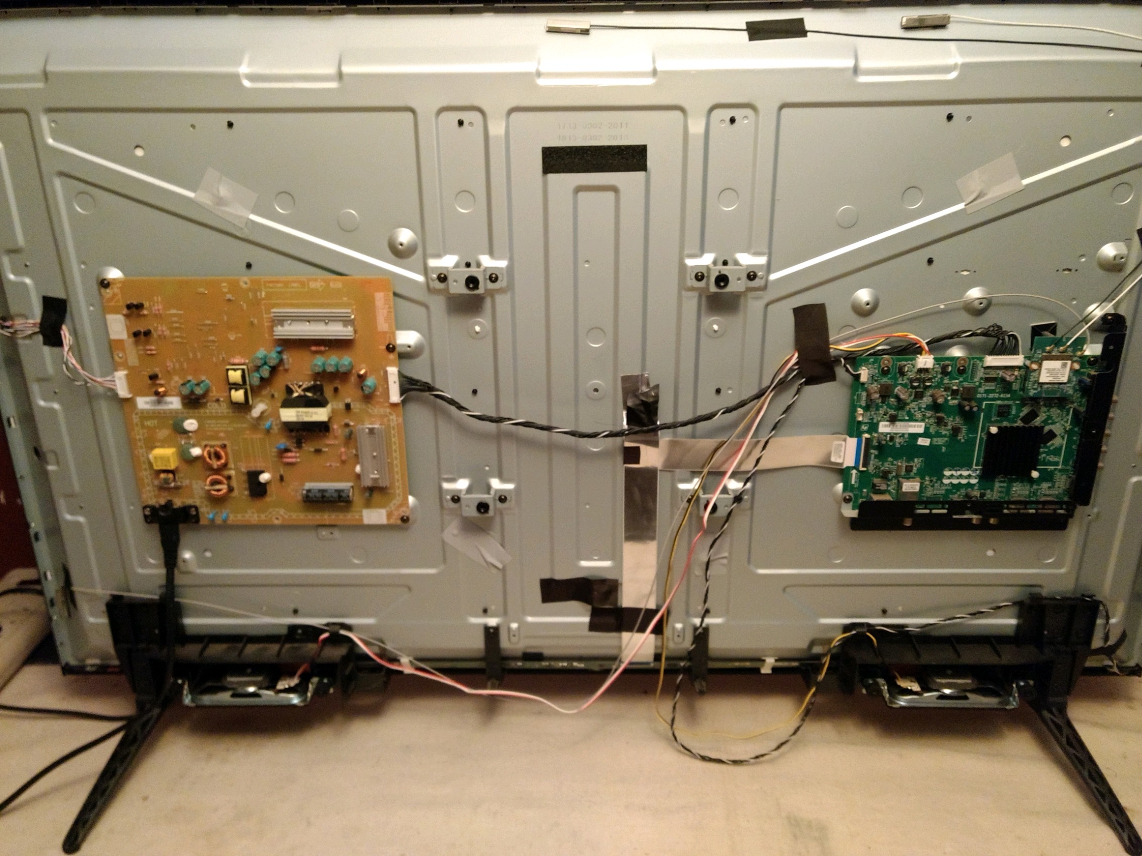

    Hello everyone, I've had this TV for almost 6 months now, just sitting in the fix-it room and it would be great to get this finished up.
    It sounds like the typical Vizio complaint….hit the power button, backlights flash, image on screen but no picture with sound…so what do I do? Order backlights from SJ without taking a single voltage reading. Apparently my “jaundiced eye” over-rode my need to do a diagnostic. This was a mistake.
    Install SJ backlights….problem still exists. Check all connections and connectors….no happy. When the backlights flash…they all flash….as if to say “way to go dummy”. Rows 2 and 3 of the LED strips are noticeably dimmer than the others tho.

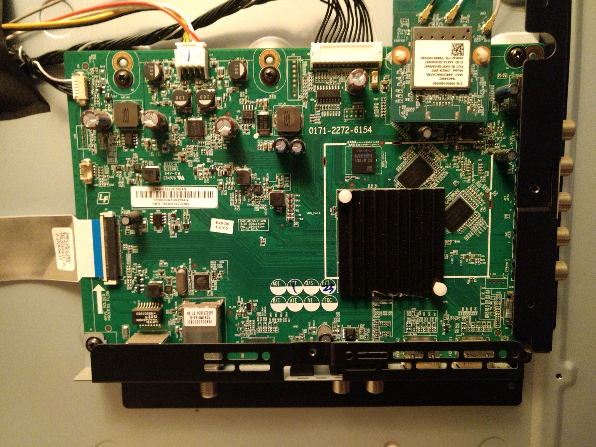

    What I see looks like either a PSU with something wrong in the LED boost circuit or a Main Board not outputting the correct PWM value to the PSU.
    What do you think guys? Is the PSU or the Main Board the culprit here?
    Pictures posted! Thanks everyone!

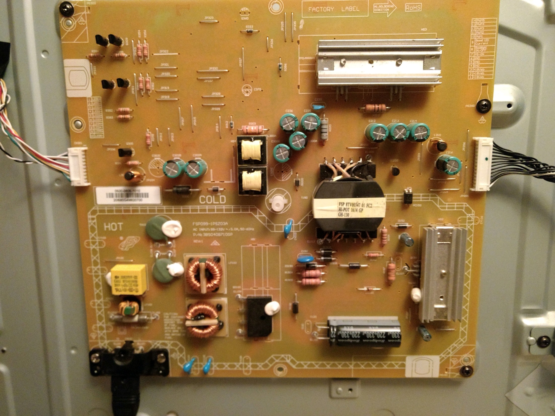

    The LED supply and Booster circuit is common to all strips. the led- is the line that is controlled. You say rows 2 & 3 are dimmer, but your voltage readings say something different.
    LED+ is common to all strips.
    led1 & led2 show 3.7 volts, led3, led4, led5 show 15v (I don't understand the 0 and 13v with tv off)
    The simple trouble shooting would be to exchange strip led2 with led3. If the voltage changed with the strip, then you know the problem is with the strip.
    On the power supply there are 3 (dual fets?) Q301,Q302,Q303. it looks like Q301 controls led5 string only, Q302 controls led3 & led4, Q303 controls led1 & led2
    It could be that Q302 or Q303 is bad. swap them around and see if the brightness of the two strips changes to, two other strips.

                    Both LED1 and 2 cathode trace to Q303 which is a PF610HV, as are Q301,2. There is no apparent number on IC300. I checked closely for a number using a magnifying glass and there is no number on it.
                    They call me......."threadkiller"
                    • R_J
                      • Jun 2012
                      • 9535
                      Re: Vizio E48-D0 Backlight flash, backlights/connections confirmed good.
                      Ok so led1- and led2- are connected together at the Q303 mosfet drain, Do the source pins go to ground through seperate resistors?
                      With the tv off do you still measure 0 volts on the led1,2- ? and 13v on led2,3-?
                      The ic could have a coating on it, you could try cleaning it with alcohol to read the number. sometimes if you look at it at abit of an angle you can read it better.
                      Did you check if Q303 is shorted Drain to Source? The two circuits [Q303 (Q309,Q308)] and [Q302 (Q307,Q306)] should be identical
