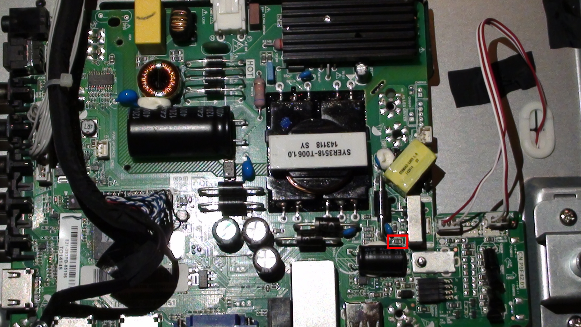

                        #71
                        Re: Element ELEFW40C won't turn on.
                        Originally posted by budm
                        Which parts are you talking about?
                        So what DCV do you have on the Cathode of that diode with ref to cold side circuit GND that you put the red rectangular marking in the picture?
                        There's now two pictures with red squares. The first red square is around the diode. I have 37.2VDC.
                        The 2nd picture with the red square ( https://www.badcaps.net/forum/attach...6&d=1486593073 )
                        That's the SMD component. When the power is unplugged from the TV, if I check the continuity, it measures 0.000 ohm. If that's an SMD capacitor, then I think I found a problem. But it might be an SMD inductor. It's in the same area as to where that diode is.
                        I just read your second message about how to test and I believe it's an inductor. There's a screw that has a grounding wire connected to it. I've been using that for my black probe and it works real well. I checked the continuity between that SMD component and the GND, both sides of that SMD component show resistance. That would mean it's definitely an inductor, right? Thanks for the tip on how to check!

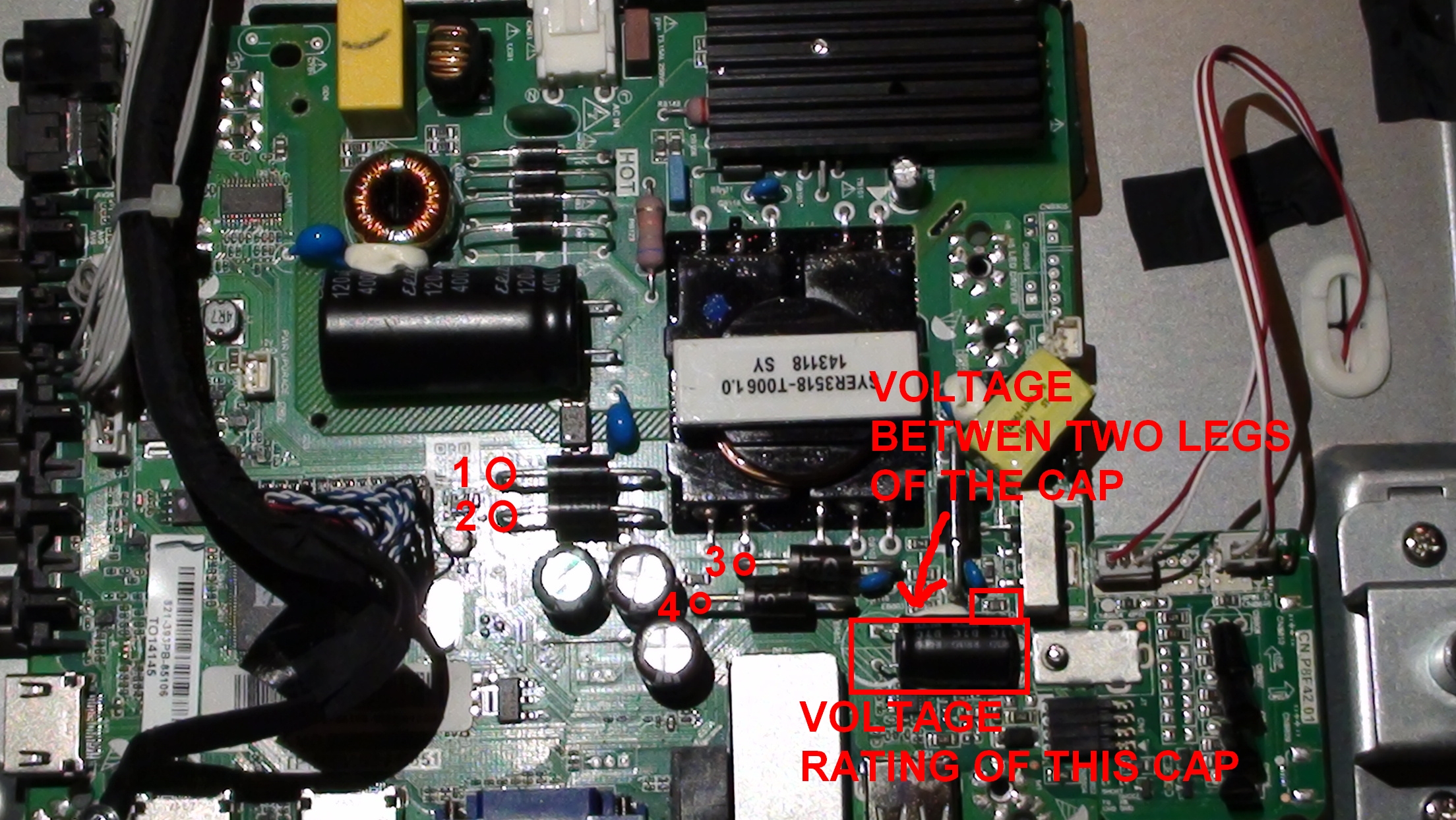

                                  Is the main filter cap that 400V 120uF capacitor? Tomorrow, I'll try to make one big picture for each side of the board, maybe things will be easier to see then.
                                  I found some pads that looked interesting though. One that says something like 1.35_STDBY, one that says something like RV5. There's one that says 3.3V but on the other side of the board, there's a header there and it says something about PWR_UPGRADE so I don't think that's to check if 3.3V is there. Anyway, just thought maybe those could come in useful for testing purposes.
                                  -- Law of Expanding Memory: Applications Will Also Expand Until RAM Is Full
                                    #77
                                    No need to do any probing in the primary side. We need to find out where the command pins/traces are to see if they are present or not in the cold side.
                                      #78
                                      Can you please do the super clear hi-res straight shot of top and bottom side of the WHOLE board?
                                        #79
                                        What are the DCV between chassis and the Cathode 1, 2, 3, and 4?
                                        What is the DCV MEASURED BETWEEN THE TWO LEGS OF THAT MARKED CAP?
                                        Also need the Voltage rating of that cap.

                                          #80
                                          I will try to do that today. I have a tripod, but on the view screen of the camcorder, it looks sooooo small, but I noticed when I transfer them over to the PC, they're a heck of a lot larger than I expect. This is a small board, so maybe just one normal picture will show us everything (one of each side). I'll play around and see what we can get.
                                          Is the main filter cap that 400V 120uF cap?
